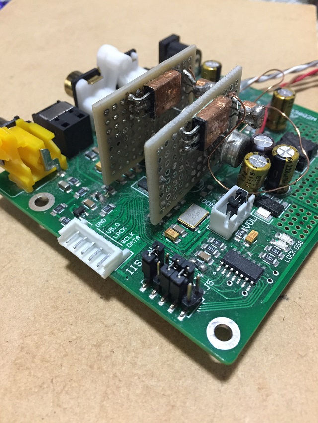

...I tried separated AVCC_L and R.
It improves field of sound and clarity...
Thank you for letting us know about your good result. We like to read user reports and see pictures of mods here, likely the lurkers do too
May I ask what circuit you are using for the AVCC regulators, do you have schematic you might post?

For modding the ES9038Q2M board of this thread, there is some info covering a output stage mod that can be downloaded from: Dropbox - Output Stage Instructions.zip - Simplify your life
There is also a schematic of a prospective AVCC power supply attached to post #3003 of this thread.
An output stage schematic with some alternate parts values, but the same multi-feedback differently summing topology was posted and is supposed to be of a Topping D30. I could post that schematic if you want.
There is an ESS document on their downloads page that discussed layout and other considerations I tried hard to comply with for my modded dac. The document also recommend the types of output stage and AVCC circuits we used here. It can be found at: http://www.esstech.com/files/4514/4095/4306/Application_Note_Component_Selection_and_PCB_Layout.pdf
In addition to those things, other possible mods to the dac board include a clock upgrade (typically to a Crystek 575 type 100MHz clock), and separate voltage regulators for DVCC, VCCA, and the clock (I used 3 each of LT1763 mounted on the back of the dac board - the ground plane side).
In addition to mods to the board itself, some people opt to add an AK4137 board for upsampling and or for hardware conversion to DSD. There are a number of such boards available on Ebay and or Aliexpress. Some have SPDIF inputs and some have I2S inputs only.
One thing we never did with AK4137 was to try a reclocker on its output. That would be implemented with a D-flip flop of the I2S signal before they come into the dac board, and it would be clocked by a divided version of the dac clock.
A divided version of the dac clock can also be used to clock AK4137 if desired, say, at 25MHz, although its not necessary it might help with sound quality. Recently, I found that the Chinese AK4137 boards can benefit from a dedicated low-noise LDO voltage regulator just for the AK4137 chip and the A/B I2S selector switch that feeds the AK4137 inputs (I mounted a low noise LDO on the back ground plane side of an AK4137 board and used it to power the sensitive chips - recommended mod).
Just remembered one last mod of the dac board itself, and that is to take over the I2C bus between the MCU and the dac chip. An Arduino or other MCU can be used to take control of the dac chip and reprogram it for improved sound quality (mostly by reducing DPLL bandwidth). Although ESS data sheets normally require an NDA, ESS seems to have quietly allowed the Khadas Tone Board folks to post one in their support documents. You might try Google or take a look around the Khadas downloads area.
By the time you are done, you can potentially have a very nice ES9038Q2M dac, but as you can see from the above a lot of work could be involved to get there (most people seem to mod until they have had enough of it or are satisfied with the sound quality they have and stop there).
