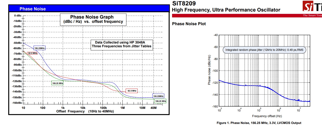

I would probably not use any of the clocks mentioned. If considering a particular clock there are a couple of things for look for on the data sheet.
(1) Clocks that are good for use with audio DACs are usually classified as
Ultra-Low Jitter. It often will say that somewhere on the data sheet.
(2) With the exception of the NDK clocks, all the other good audio DAC clocks I know of are specified for dB of jitter at various low Offset Frequencies. There is usually a little table or list in the data sheet that lists frequency offset and a dB number. The lower the number the better. They will all be negative numbers such as -80dB or -160dB. The best audio DACs usually are specified at offset frequencies down to 10Hz, some are even specified at as low as 1Hz.
On the other hand, standard clocks are not usually specified at all for offset performance below 10kHz. Standard type clocks generally should be avoided for audio DAC use.
Some clocks are specified down to 1kHz but that isn't really low enough to help predict good audio sound quality. Usually the reason the clocks are not specified at lower frequencies is because the numbers quickly start looking increasingly poor as frequency goes down. It is curve that looks a lot like 1/f noise that increases rapidly below some corner frequency.
Again, the NDK clocks they classify as ultra-low jitter or low-jitter are not specified at low offset frequencies but they usually perform exceptionally well there, I guess NDK may not want to test them or otherwise appear to guarantee jitter performance. Or as I mentioned previously, I think there is another thread here somewhere in the forum about the clocks and, IIRC, people do report getting a few bad ones in a reel.

The Crystek C3391 and C3392 is a good inexpensive choice. I think AMB.org for instance has used it in the past (and they're engineers all the way). There may even be feedback here if you search.
I'm far from a clock expert but the posts I've read from those who are advocate taking published phase plots with a grain of salt. I think we should be exploring more than just NDK and pricey Crysteks. The Fox Xpresso is also a very nice inexpensive clock. They are now owned by IDT but still available. Their phase numbers aren't amazing but I've used them multiple times and they sound great, especially for the money.
I think silab is not so bad compare to expresso and ndk.

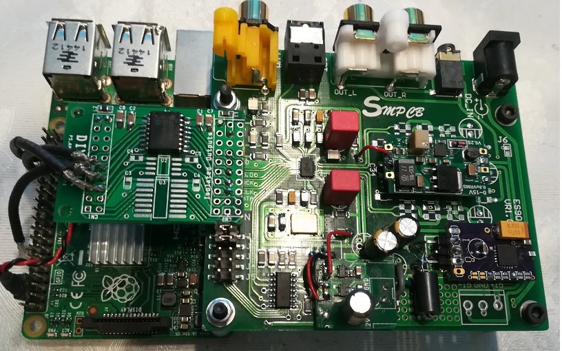

Streamer is in progress...Rpi -moode 4.1, I2S isolator, es9028q2m dac ...output stage test in future.
