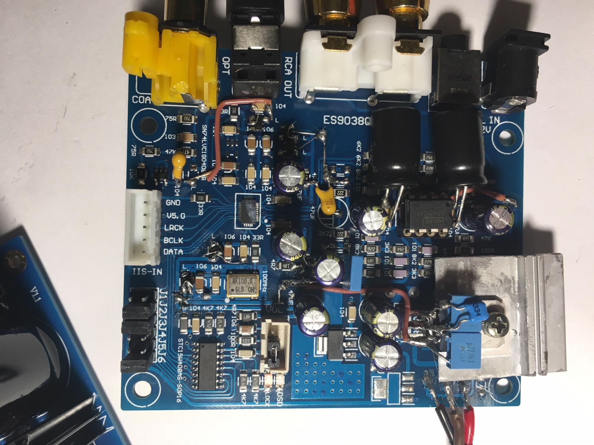

Finalized modding
Hi All,
I posted my results on a Hungarian site, but maybe it worth to share here too:
During the modding process I changed these:
1) I separated all the 3.3V power supply parts (6 were added altogether):
- removed the inductivities and put LM5907 (3.3V) regs.
- on my panel the main regulator was a 7808 and the LP5907 MAX Vcc can’t tolerate this, so I added a 7805 too.
- only the controller remained on the 7808 and ASM1117, so it is completely separated from the audio part.
- where it was necessary (2 places) I added 10uF capacitor (LP5907 requires 1-10uF) (these are tantallum (maybe MLCC would be better?))
2) I changed the OPA power supply to symmetric (2*15V)
3) I changed the OPA - extremely huge difference!!! to OPA2134.
4) I also added Nichicon 100uF capacitors to OPA power supplies (original ones haven’t been removed).
5) I removed completely the output capacitors (the symmetric power made it possible <5mV DC on the output (and Headphone AMP has input cap)
6) I added Nichicon 100uF to AVCC (original ones haven’t been removed)
The whole audio channel is: ARCAM 7SE CD (quite old), This DAC with an Aliexpress Power supply (LM317+TL431), Lehmann clone Headphone amp (only slightly modded, some noise filter cap on rectifier bridge), Hifiman HE400i headphone.
Sound:
Incomparable to the original (even I can’t recall how was it originally, but terrible at the beginning, so I couldn’t really listen it for weeks – when I found the HU side and collected some starting ideas).
Currently:
- Really nice details (new OPA, OPA power supply CAPs, power separation, AVCC Caps)
- Clean and strong bass (OPA power supply Nichicon CAPs),
- Clean and strong treble,
- Maybe a little bit too strong at high Mid.
Next steps: check if a serios power supply changes anything (Shunt reg).
See picture included (the AVCC Caps on the back)

Hi Szabolcs,
Just a suggestion: if you have Elna Silmic/Silmic II you can replace the Nichicon cap that you add to either AVCC or OPA. I guess it will tame down the mid high and give slightly wider and spacious sound stage.
I have some experience with audio capacitors (using OFC lead) from Elna, Nichicon and Chemicon, all of them have good sound quality but different in characteristics.
I just ordered a NDK SDA clock the day before yesterday. I choose the 49,152 MHz type. I will use the DAC with 96kHz SW upsampling, so I think this frequency might be OK - or any concerns?

Thanks a lot for your hint. My ELNAs unfortunately hasn’t wider the stage on AVCC.
You are completely right the strong hi-mid was removed. But in total the Nichicon gave back much more details.
Since I bought them on eBay they might be fake. ?? I had the same feeling with an OPA; just have received some LME49720HA. I was excited to test it but it was a disaster :-(. I will re-test it when the shunt reg is ready. But I’m afraid that mines are not real ones.
Try Nichicon kz this is my choice for es dacs. They give fuller sound and silk nonmetallic highs. At first hours sound will be darker and you would have feeling that highs are gone. But wait 10hours. Avoid lme49720 with Sabre it is headache. I have at least 15 different opamps and best for my taste are lme49990 and Ada4898-x one is bipolar other fet. Sometimes one sometimes other.
No problem, just share some using experience on capacitors.
I have no good experience with fake components (especially capacitors) that bought online too. To avoid potential trouble, I only buy from reputable stores. It might be more expensive, but at least I don't need to worry about the quality.
