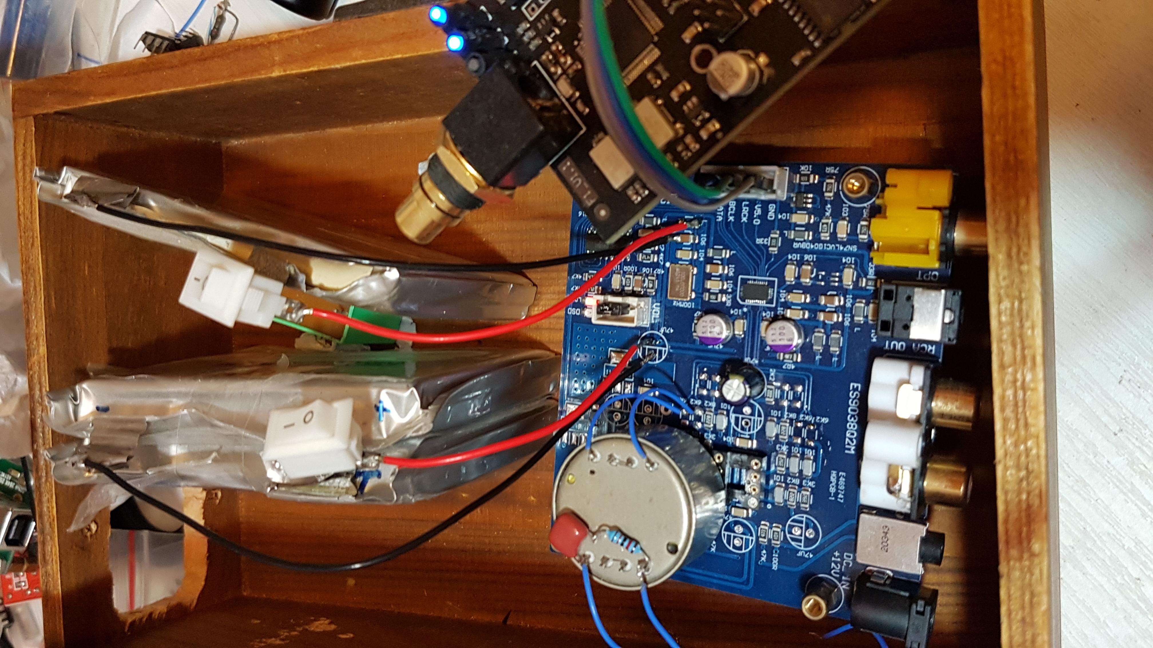

My lifepo4 battery powered es9038q2m board. One for oscillator and dual pack for rest.
I have removed most of the unused caps and replace those near dac.
Output is Jensen jt11 10k with 680ohm across +- dac out pins.
Testing one channel for now and sound very good.

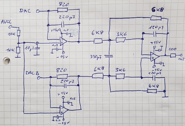

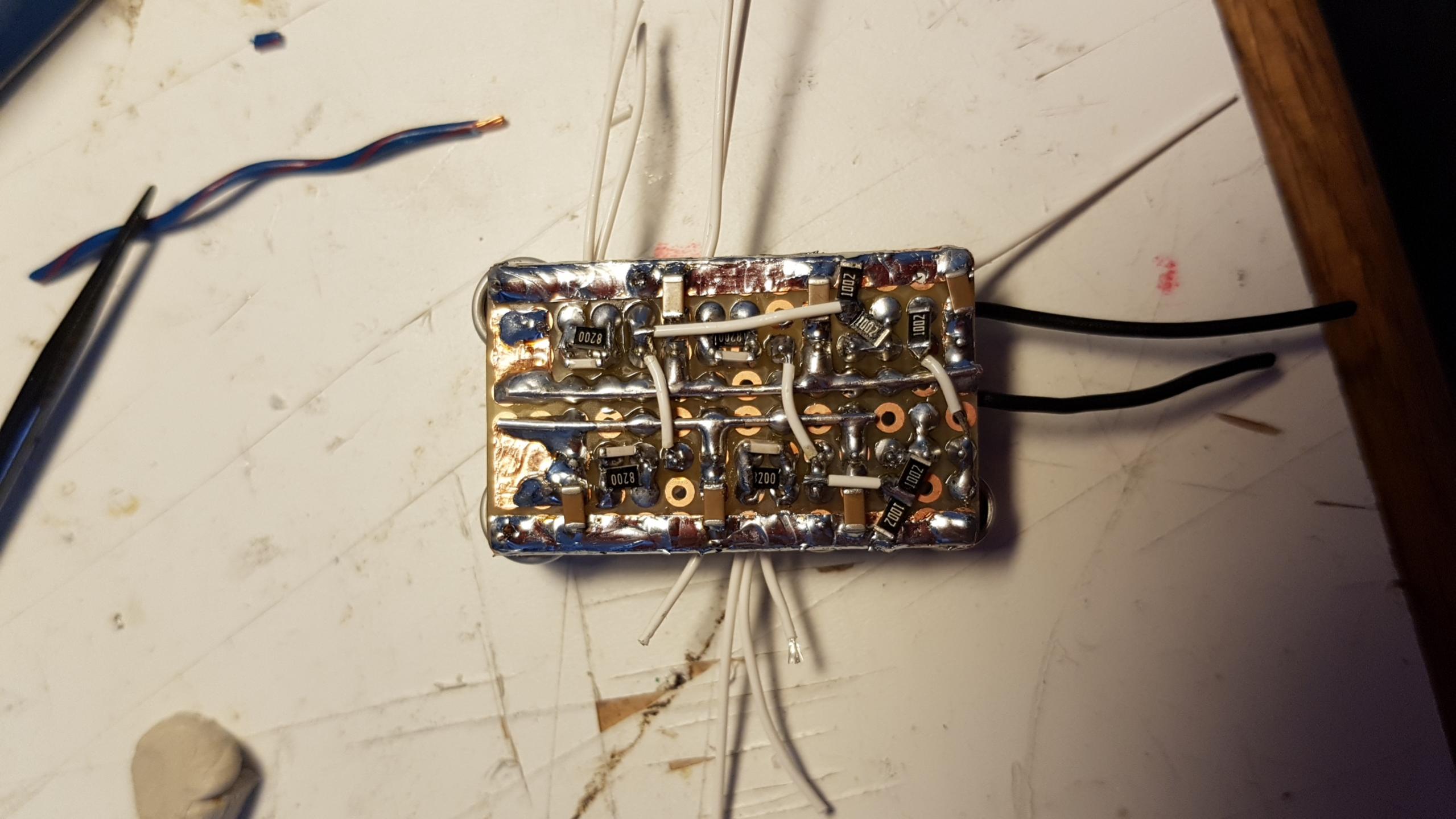

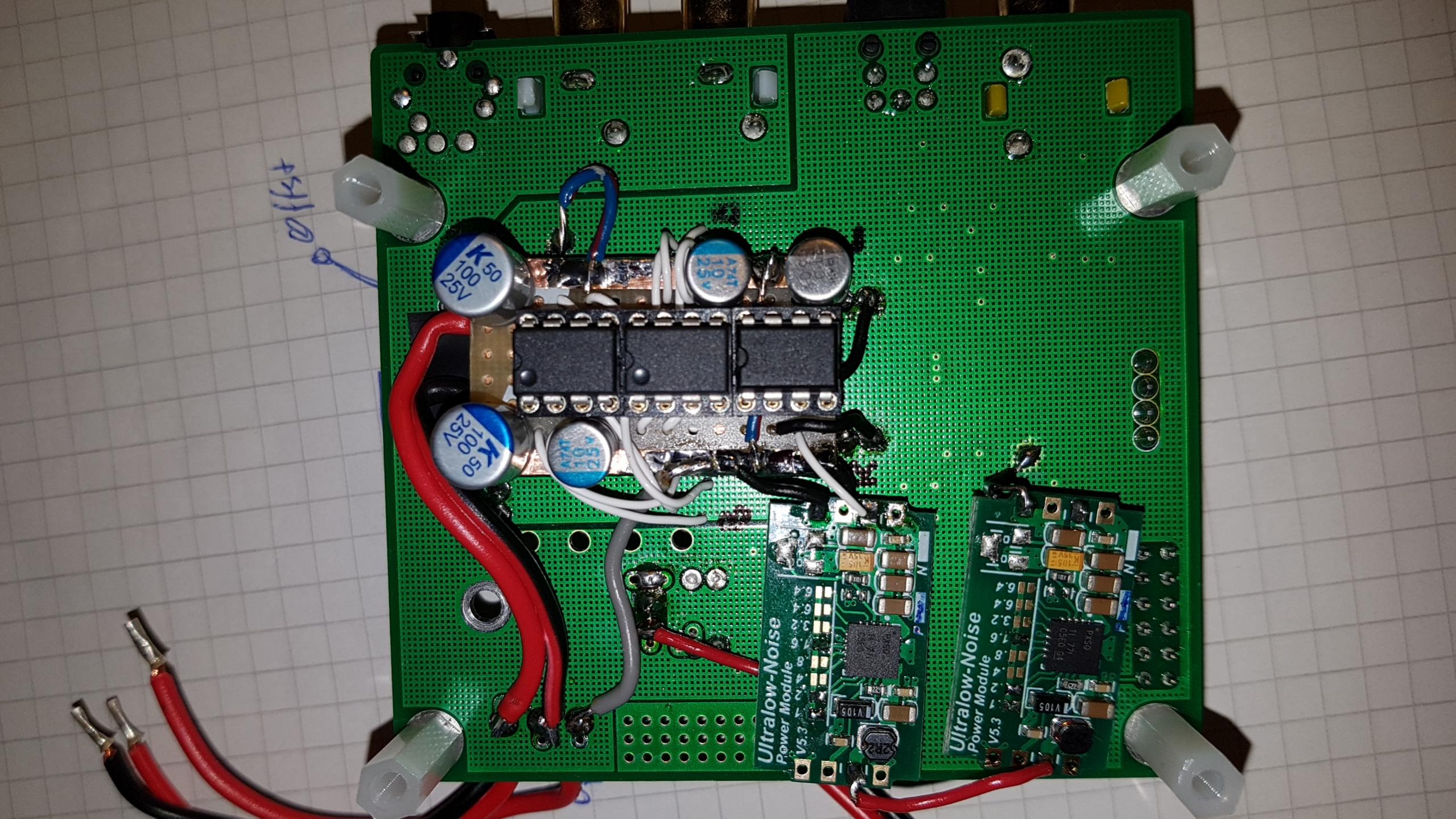

Hi all,
today I finished my new add-on board for i/v conversion and AVCC opamp stage. I choose same values as Mark (820R//220pF) and modified the existing on board differential circuit with thin film resistors and COG caps. The supplier wanted to test me and sent 0603 size caps - but with some copper film I could connect even these 4 tiny chips.
After first trial I was shocked - a big bang came out of my speakers and I thought that was it... I then shielded the i2s wired and checked all connections again. I placed a carton stripe between add-on board and DAC-board as I was afraid some solder points of the on board opamp connected through the isolation tape I already placed and connected some paths with the new add on board - and I guess this did it. No cracks anymore, no bang, but a stable sound coming out of my system now - and what a sound! Sound appears warmer now with more deep bass volume, a little as if AVCC caps were increased. But all that with a smoother and finer structure, that makes the sound more natural. At the same time it has more dynamic and I am more willed to turn up the volume - usually a sign for less distortion. I am quite happy with the result.
After a longer listening session I checked the temp. of the opamps and yes they were quite hot. No idea where this comes from - could it be the value of 820R and 220pF that you also use Mark? My 9028q2m board opamps stay quite cool with nearly the same design, but 330R//100pF for i/v stage, inverted differential stage (DACB line goes to inverted differential opamp entry while on ess circuit it is the DAC path) and no AVCC opamp stage.
Seems I also have to look for a cooling solution now...

freezebox, Great news! Good to see you make some progress. I agree that as the sound becomes more natural with less distortion it actually sounds better, but unless people hear it for themselves it can be hard to imagine what it is like.
Also, it was amazing to me at first when I found I could solder little SMD parts. Didn't think I was going to be able to do it before I tried it. Interesting how that works.
What I did to cool the opamps was cut off about a third of a heat sink and used the bigger 2/3s piece for the opamp: Amazon.com: Aavid Thermalloy 501200B00 Heatsink, Passive, DIP 14/DIP 16, Straight, Extruded Epoxy, 0.73" L x 0.25" W x 0.19" H, Black (Pack of 10): Industrial & Scientific
Stuck the heatsink onto the top of the opamp with some thermal tape like this: Amazon.com: Thermal Adhesive Tape (20mmx25 Meters 0.1mm thickness) Nicelux Double Side Adhesive Thermal Conductive Tape for Heat Sink of LED Light, PC and More, Electrically Insulated,1 Reel Pack: Computers & Accessories

freezebox, Also, I don't think the passive component values cause the heating. If anything it is likely a little low level RF that makes its way out the analog outputs. Maybe that's why ESS recommended circuit has so much filtering, to try to get rid of as much of that as possible before the analog signals leave the DAC board.
In addition, the LME49720 data sheet says the opamps can run at up to 85 degrees C. That's pretty hot, 185 degrees F, too hot to hold your finger on. Personally, I feel more comfortable with the heat sinks.

I have already sticked some heatsinks you can buy for Raspi PCU. They are adhessive and the small one fits perfectly to opamp, but probably too small for the power which is dissipated.

Any further idea what could be the reason of this hot opamps? Could the analog ground be separeted from digital ground as most of us modders use at least 2 different PSU for analog and digital anyway?
I don't think the heating is related to the power supply or ground. For one thing, my AVCC LME49720 opamps run slightly warm, but much cooler than the same LME49720 opamps used in the output stages and connected to the same power. In addition, I did some experiments with moving around power ground returns without seeing any measurable changes in anything. Nothing audible changed either.
The only explanation I can think for us to both see the same heating effect would be some low-level rf coming out of the dac outputs that go into the IV opamps, as I said. There probably is some, only a question of how much and what does it usually do to LME49720 opamps. ESS would not have needed to add all the low pass filtering if there wasn't some RF to attenuate.
As long as you have the 33pf caps on the differential stage and some little heat sinks to make your finger feel better when you touch the opamps I don't think there is anything else to do at this point. Also, because SQ is good, and my DAC measured quite well at Richard Marsh's, and also because the opamps are rated to run at up to 85C, I don't think there is reason to worry at this point. In addition, since ESS recommends LME49720 opamps, and assuming some heating is normal, chances are ESS doesn't have much concern about a little heat well within the opamp specs either.
That being said, I will keep an eye on it and see if anyone else reports any different circuit behavior. If one turns up that runs cool, that would certainly be reason to investigate further. Probably not going to happen though, seems most likely the heat is normal for those particular opamps in this application.
Only concern is we might not want to take chances that we might heat up anything in a big downstream power amp. That could be good reason to favor use of the recommended ESS differential stage circuit with all the filtering for the single-ended outputs. That would be true regardless of the particular ESS recommended (or other) opamps chosen for use in DAC output stage mods.
The 9028q2m board with I/V stage I have has a quite similar circuit as I currently have. My current schematic is shown below. They use 2x 4k7 for voltage devider for offset voltage and use 330R//100pf in I/V stage. The opamps do not run hot on this board. It has a seperate ground plane for digital parts as far as I can judge it. The reason why I did not implement the ess recommended circuit was, that the feedback resistor in I/V stage is very huge and I was not sure for which DAC chip this was designed. As 9038q2m has double inner resistance as 9028 and on my 9028 board they use 330 Ohm, 820 seemed reasonable to me.
But probably it is the 9038q2m chip that produces some RF noise and 9028q2m does not...
Regarding the feedback resistor for the IV stage, it depends on the DAC chip (and depending on chosen AVCC supply voltage) for the maximum output current it can produce. If the opamp is able to source or sink that much current, then the resistor just determines how far the opamp output voltage will have to swing up or down at full current. If it is within the output voltage range of the opamp then it should work.
Resistor size also affects noise produced in the first stage which usually sets the noise performance for the rest of a circuit. Once noise in the audio band is there it will pretty much be there forever. The resistor also affects voltage output of the first stage. Depending on the opamp, distortion may vary with output voltage swing so the resistor could have some effect on distortion performance.
The resistor and cap in parallel with it form a low pass filter with a corner frequency at 1/(2pi*RC). The first thing that gets affected in the audio band depending on the chosen corner frequency is phase shift at 20kHz. Setting the corner frequency at, say, 50kHz might cause audible phase shift at lower, audible audio frequencies, so the corner frequency is usually set at maybe a few hundred kHz for Hi-Fi purposes.
Regarding opamp heating, hard to say how much 9028Q2M vs 9038Q2M affects that, and how much ground plane(s) design affects that. Both things could potentially have some effect. While separate ground planes would be great, we are stuck with the combined ground plane for this DAC board. Despite that, it is possible to get good distortion numbers with some care doing mods.
