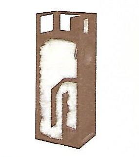

Are there any drawings for the ESS TL enclosure? I've searched the web but could never find anything.

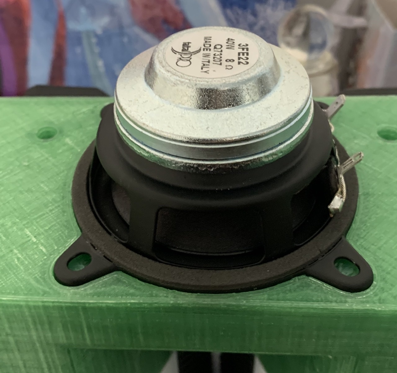

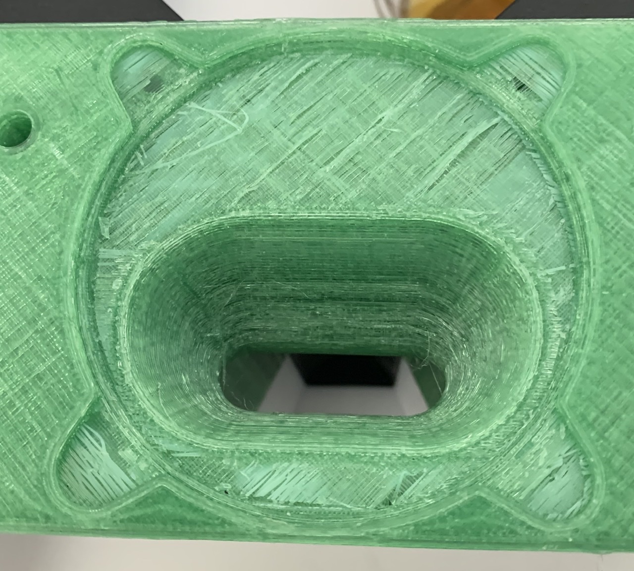

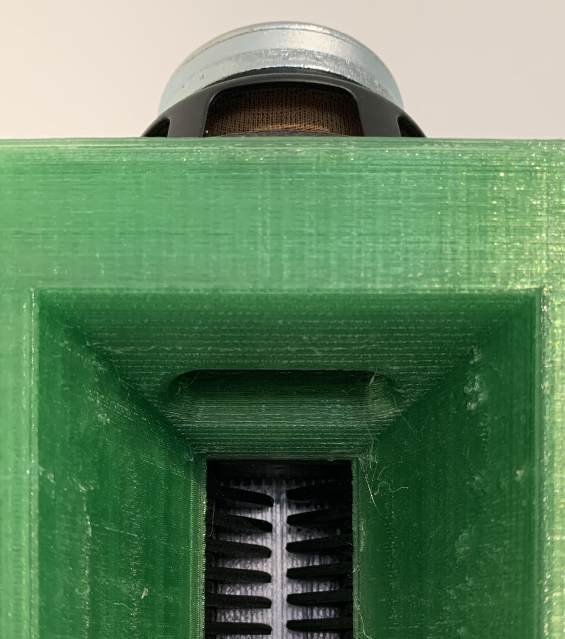

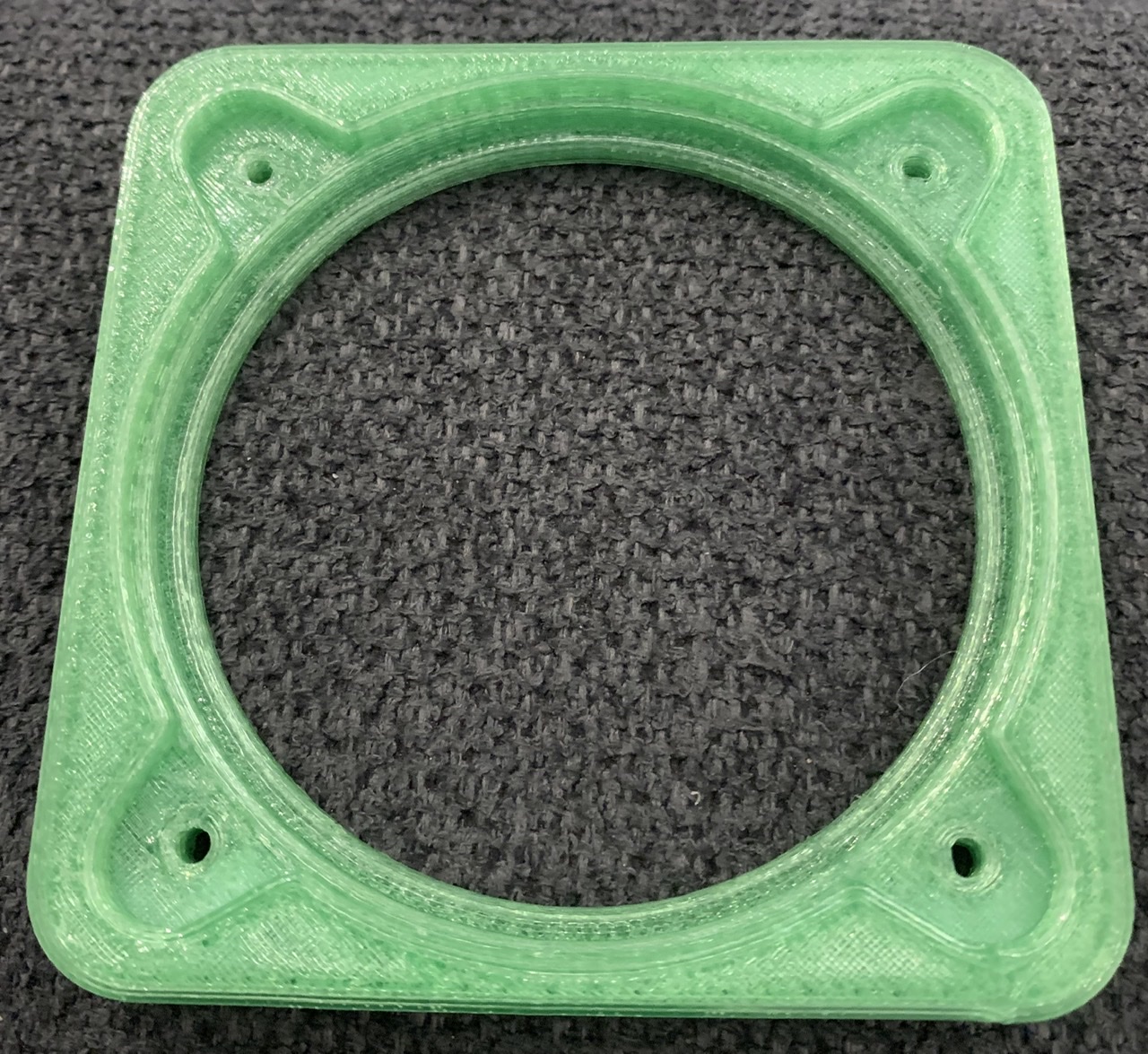

Hi thermcul, I have not printed anything since post 102. I had some failed prints and I entered the dangerous zone of printer tweaking. Almost ready now to print the 50x30 adapter. If the inner dimensions will be perfect, I will release both 50x30 and 60x40 models. I also got delayed by the idea of incorporating a mount for 3FE22 driver as midrange into the model, so that one could be mounted on each half.
For the horn front, I plan to make my own Excel sheet to calculate the angles. If I fail, I will model the horn in 3D and measure🙂
My nozzle was clogged, so I installed a 0.5 mm nozzle for faster prints. I now printing shield frames. Once I get my Al bed carrier, I will continue with this project. The acrylic holder is bending and I cannot level the bed properly for larger prints.
I tested new material - recycled PET (G?). It needs higher temperature, but it feels stronger than regular PETG. This is a test print for correct sizing of the 3FE22 mounting interface. I need to dismount the speaker from another project tomorrow.
Here is my test print. It needs to be printed in two parts, the 3FE22 mounting surface looks ugly, my printer is not yet tuned to make nice bridges with this material. I tried to turn on the fan, but it cooled the nozzle too much and ruined my first print. I will add some square holes for square M4 nuts. I will try to set up some measurements with the test print and a cardboard horn.

turk182: If you set the iron to the usual maximum 220 °C, this plastic will not soften enough I am afraid. Actually, the surface is smooth enough, only the bridges look awful. It would work as it is now, the loose threads would need a bit of filler or maybe just paint so that they would not vibrate.
xrk971: Thanks - I tried to get as close to the AMT as possible. Actually, it was the Nano Trynergy thread that pushed me a bit forward to move on with this project🙂
Pharos: The Heil diaphragm looks like it can handle it.
