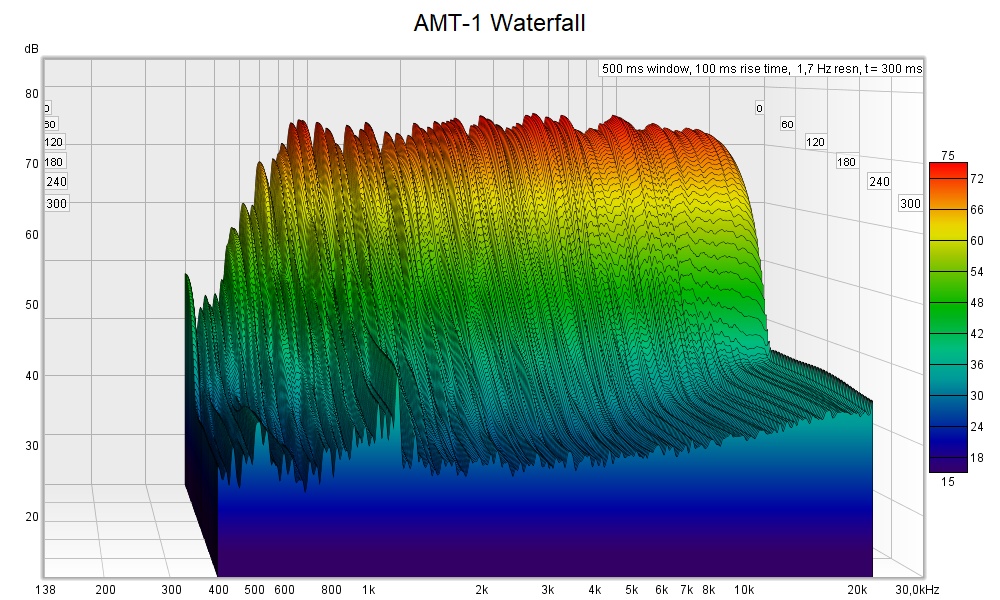

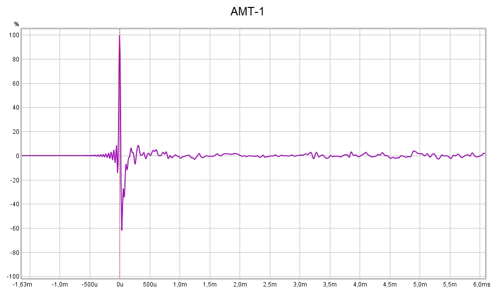

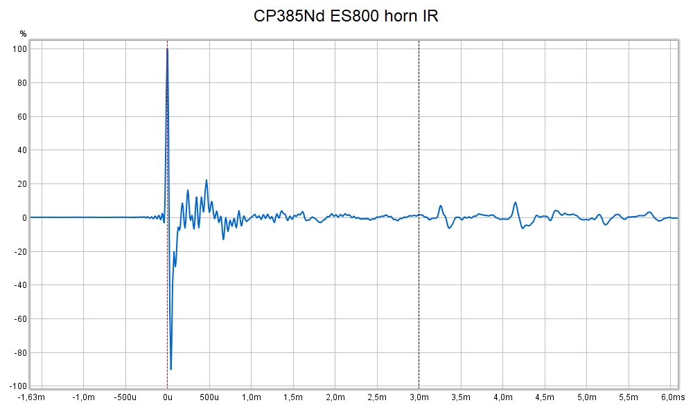

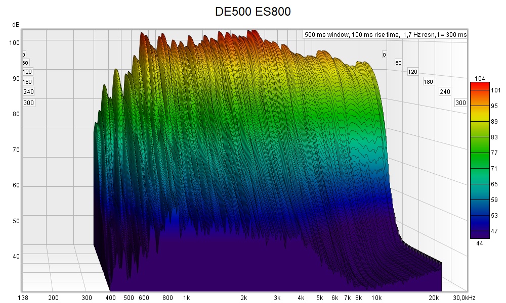

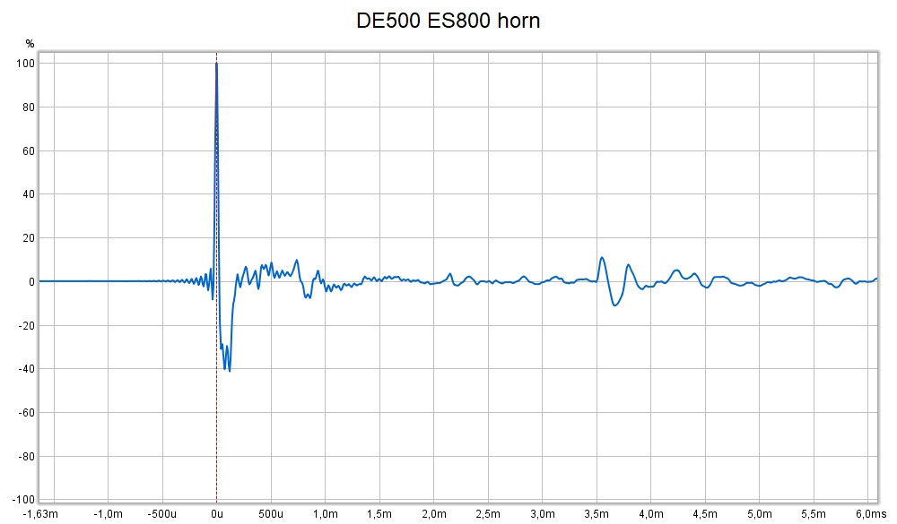

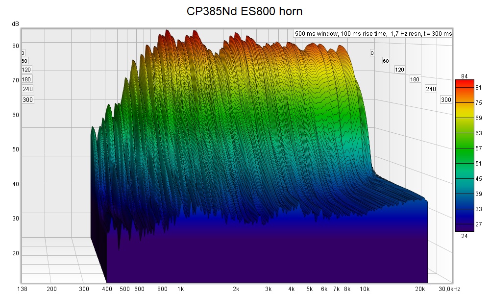

Hi ! can you do a complete Cumulative Spectral-Decay plot maybe for all the tweeter working range ?
anyway it would be telling to compare this impulse response with the one from a more conventional driver used to cover the same audio range. Maybe it is not that different ? usually dome mids/tweeters have big magnets and light diaphragms .... they are naturally fast. Settling time can be an issue ? ... maybe 🙄
I only compared to my other measurements of compression drivers on horns. I do not know how to make a proper CSD plot in REW, I only can do the waterfall. Here are three measurements to compare. The AMT just looks as the best to me (not by much).
Thank you very much indeed for these extremely valuable plots. Yes it looks like the Amt driver is really the best at least at the testing level ... i am a little unimpressed by the compression drivers. I really do not have any idea if the guilty for these little ripples are the drivers or the horns 😕 ... maybe both 🙄
Amt driver is the winner ! Thanks a lot again, gino
There might be some slight leakages in case of the CP385Nd since it does not have a gasket at the front. The DE500 is not bad at all, it sounds great, too
Unfortunately i know almost nothing. We all know the ideal behaviour and actually the Amt driver with this testing conditions approaches the ideality very very much.
I have only the feeling that this test is very very telling ... very.

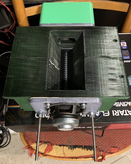

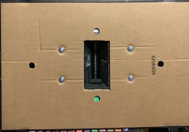

Test unit for first measurements is built up. All held together by two M6 threaded rod, with some polyfil inside the 3FE22 cover, which are almost exactly 0.75 l each. All mounted to a corrugated cardboard baffle.

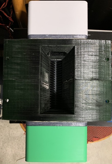

To be a bit more specific. I noticed that the acoustic low pass of the 3FE22s is around 1.35 kHz, so they should blend in perfectly with the AMT. Paralel combination has higher sensitivity than the AMT and the series combination has a strange distortion peak in the measurement, I hope it is just a glitch. I need to print the horn now, but my large printer is out of order at the moment.
3D printing a large horn brings in large problems, so I decided to get my own CNC to cut foam for prototypes and plywood for final speakers. Since 2D cutting is much easier than 3D, I think one of the first things built will be a dipole speaker with AMT and Deltalite II 2515 I have laying around. With minimal baffle for the 15" and a minimal holder for the AMT. Large CNC'd horns will follow later - starting with something that could seem as waste of machine time - by cutting out and milling angles from flat panels for a bwaslo style synergy horn.
