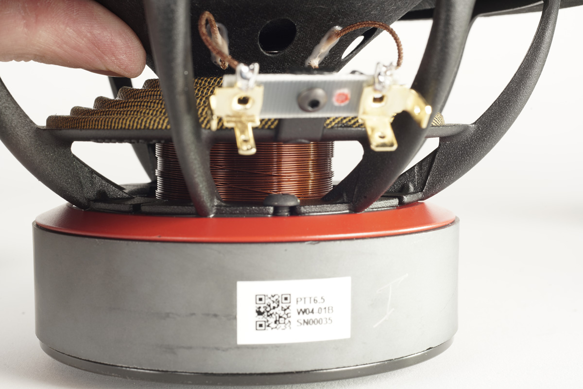

Thats a very unique coil. Perhaps to make the BL integration more linear vs cone travel.

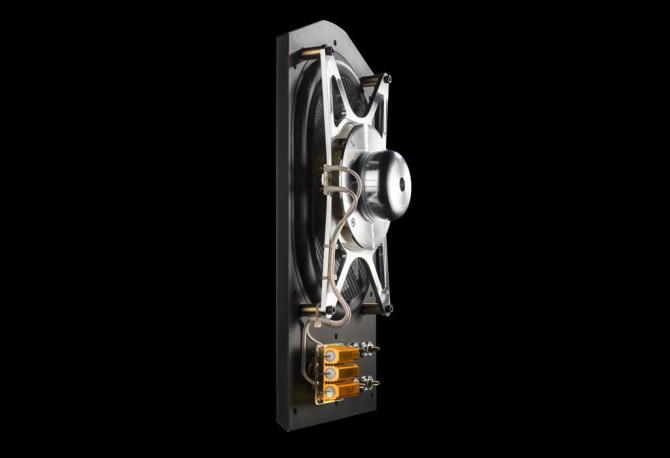

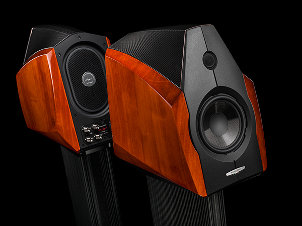

The sonus faber extrema speaker uses a woofer tied to a variable number of resistors:
"The Extrema adds a neat twist to the tale: here the B139 is not just a diaphragm but the complete bass driver complete with motor coil and magnet. While careful schemes could be devised for bass damping using acoustically resistive apertures, Sonus Faber has exploited electromagnetic damping. They place a desired resistor across the auxiliary woofer's motor coil; damping energy appears in the moving-coil and is dissipated in the resistor.
Sonus Faber has gone even farther in their exploitation of this principle, providing user-variable bass damping in the ABR range, effective over an octave centered on 50Hz. No less than five switch-selected positions are available. This is only too easy to accomplish once the working principle has been adopted. The step resolution is fair enough at 1.5dB once the ABR output is integrated into the main response. A mass-loading cylinder has been applied to the B139's diaphragm to lower the resonant frequency."
(from Sonus Faber Extrema loudspeaker Page 2 | Stereophile.com )
Not sure how that actually works ?

When compared to the Purifi PTT6.5 it is not so much comparing apples to oranges as apples to hand grenades. The bass is so much deeper and output capabilities so much higher what happens below Fs is really only an issue with movie low frequency effects. In music everything is covered.

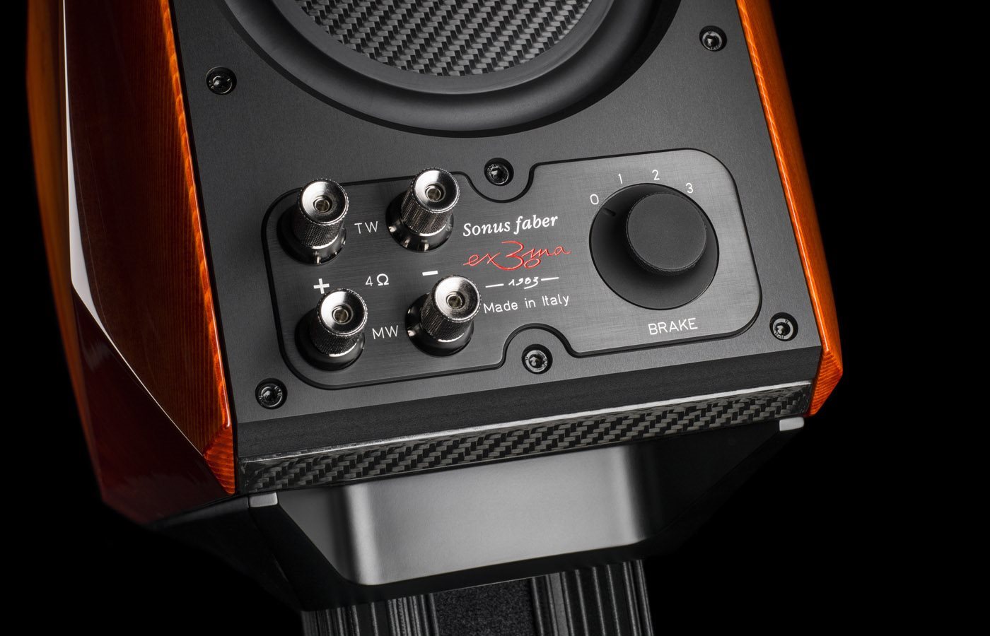

Note the knob labeled ‘Brake’ on the rear panel. On the shot of the disassembled rear panel we see the voice coil of the PR connected to that knob (selector switch) and three anodized gold power resistors. When the brake knob is set to ‘0’ the resistors are disconnected and no added damping is added to the PR. As hidjedewitje notes it will ring, I would prefer the word resonate, to the maximum extent it’s mass and suspension compliance allows. As the Brake knob is advanced 1, 2, 3 more electrical resistance is placed in series with the PR’s magnet and voice coil. Now the voltage generated as the PR vibrates is dissipated across those resistors. This will resist movement of the PR. As a result lower bass will be reduced and more damped. I would guess the audible effect is depending on room acoustics and your personal taste you can adjust the bass to be rich, dry, or very dry. I judge it as a very cool complication, admittedly expensive but I tend to discount costs that implement a clever idea.

Note that with the extrema approach the rear firing speaker with attached variable “brake” is not wired to the cross over, only the resistors are wired to the terminals.
