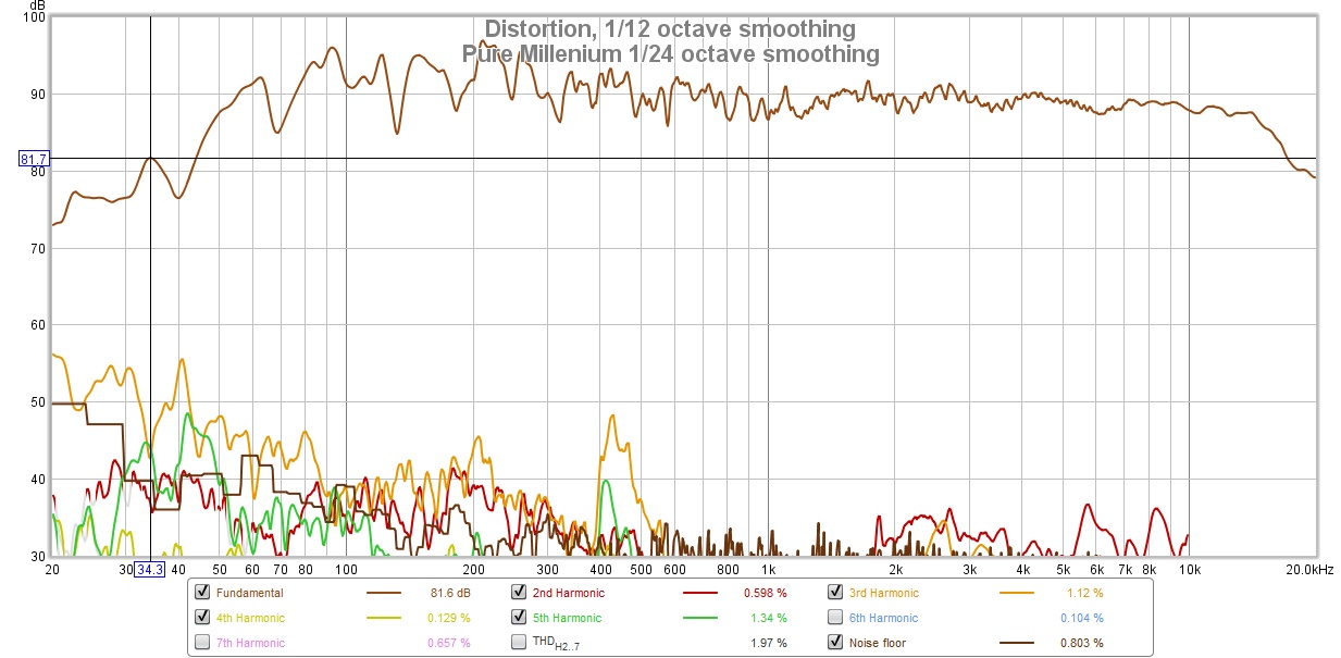

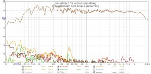

From my point of view; the original PTT6.5 driver has better bass than many 8", or even 9-10" drivers, and a midrange that leaves nothing against the best 5" drivers. And all in a 15-20L box.
No sweat reaching 100dB with 12V input (40W in 4 ohms): Klippel verified here: Purifi Audio PTT6.5W04-01A 6.5 Inch Woofer Review
For running full tilt @100W applied and 10 mm x-max you can reach 105dB per speaker. In stereo that's 110dB.
Even at 90dB average (LOUD!) I've got the 20dB of "headroom" for the peaks...
So basically you have a speaker smaller than a typical 6.5" 2 way but as good or better than a 8/5/1" 3-way. And you only need 40-100W (into 4 ohms to achieve it); easily achievable by a good solid state or class D amplifier.
The distortion levels are vanishingly low, I couldn't figure out what was going on- turns out I hadn't turned the screws all the way in for the tweeter!

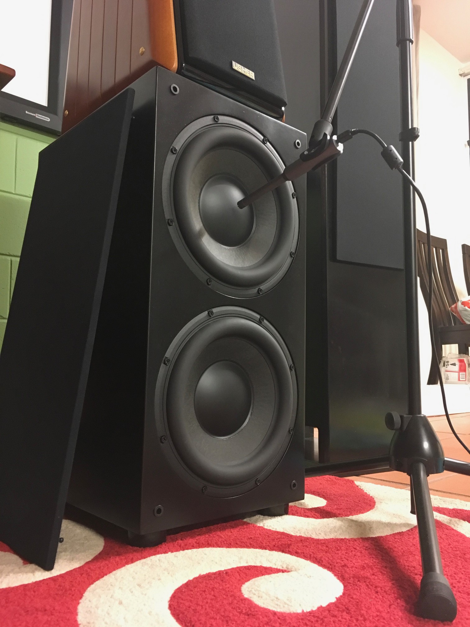

I have a pair of subs using 2 each long excursion 10" drivers in sealed too small (= overdamped, the way I prefer to error) enclosures. I brief experiment using them below my Fi16s was fun and something to return to one day.
I had a quad of 10" woofers powered by 1kW per side, with anechoic F3 of 23Hz. Lower distortion than the SDX-10 but also lower excursion (12mm vs 18mm)
I had it dialled in for an in-room response down to below 20Hz. It probably went lower but microphone is not accurate to the single digits.
They are good for shaking walls down with dinosaur stomps, explosions, rocket launches, and mortars going off but for music I turn them off.
Sometimes it's good to try these things just to experience it. So you know you never needed it.

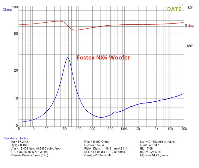

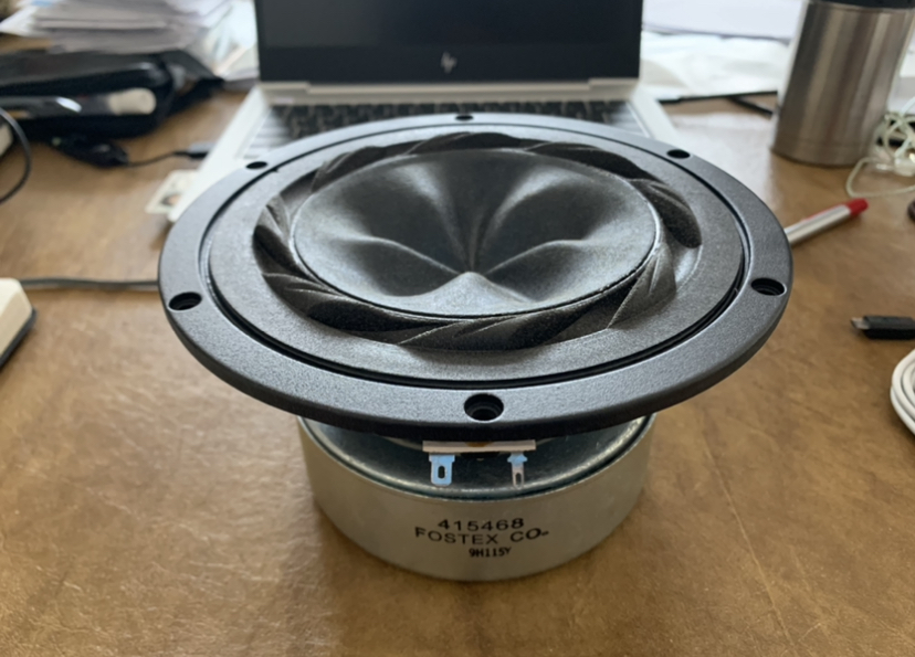

I recently got a pair of Fostex woofers that were used in the NX6 monitors. These were made a long time ago. Anything look familiar?
They were only $20ea. Poor man's Purifi?
Glad someone got these. I was eyeing them but I am in Europe. These are awesome. Leave them full range and add tweeter first order at 10khz as Fostex does with the NF1 passive. Or use them up to 5-8-10kHz with whatever crossover you prefer.
The NX6 was not successful but not because of lack of quality. Don’t underestimate this $1400 pair (back then) of monitors or its woofer because you got a spare for $20 - you just got bargain deal. Even at $100 they are still deal.
The FW168hr cousin is €415/$500 (in Europe-audio) and the new Japanese Alnico mode with the same technology is like $2000 🥸
The FW168hr woofer with the same technology: https://www.fostexinternational.com/docs/speaker_components/pdf/fw168hprev.pdf
I have a few pairs of the NX6 monitors and the original NF1 versions. They are worth it. And the woofers are way higher quality than most of Fostex’es speakers for diy lines.
Here are t/s parameters of the woofer of the NF1. I believe this one will be quite similar:
Fs = 55, Hz
Qms = 2,183
Vas = 10,71 liters
Cms = 0,589 mm/N
Mms = 14,21 g
Rms = 2,249 kg/s
P-Dia = 120, mm
Sd = 113,1 sq.cm
Qes = 0,487
Re = 6,2 ohms
Z = 8, ohms
BL = 7,906 Tm
Qts = 0,398
no = 0,353 %
1-W SPL = 87,68 dB
2.83-V SPL = 88,78 dB
Hope that helps

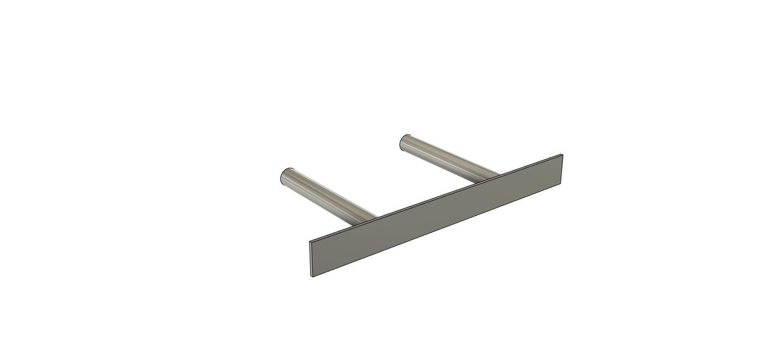

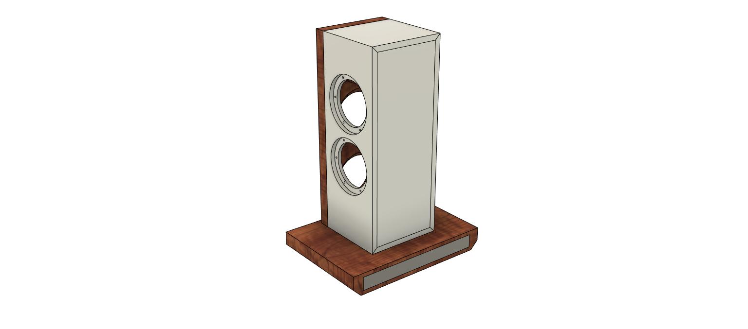

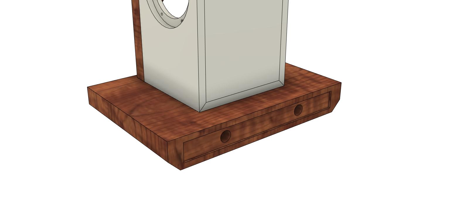

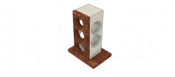

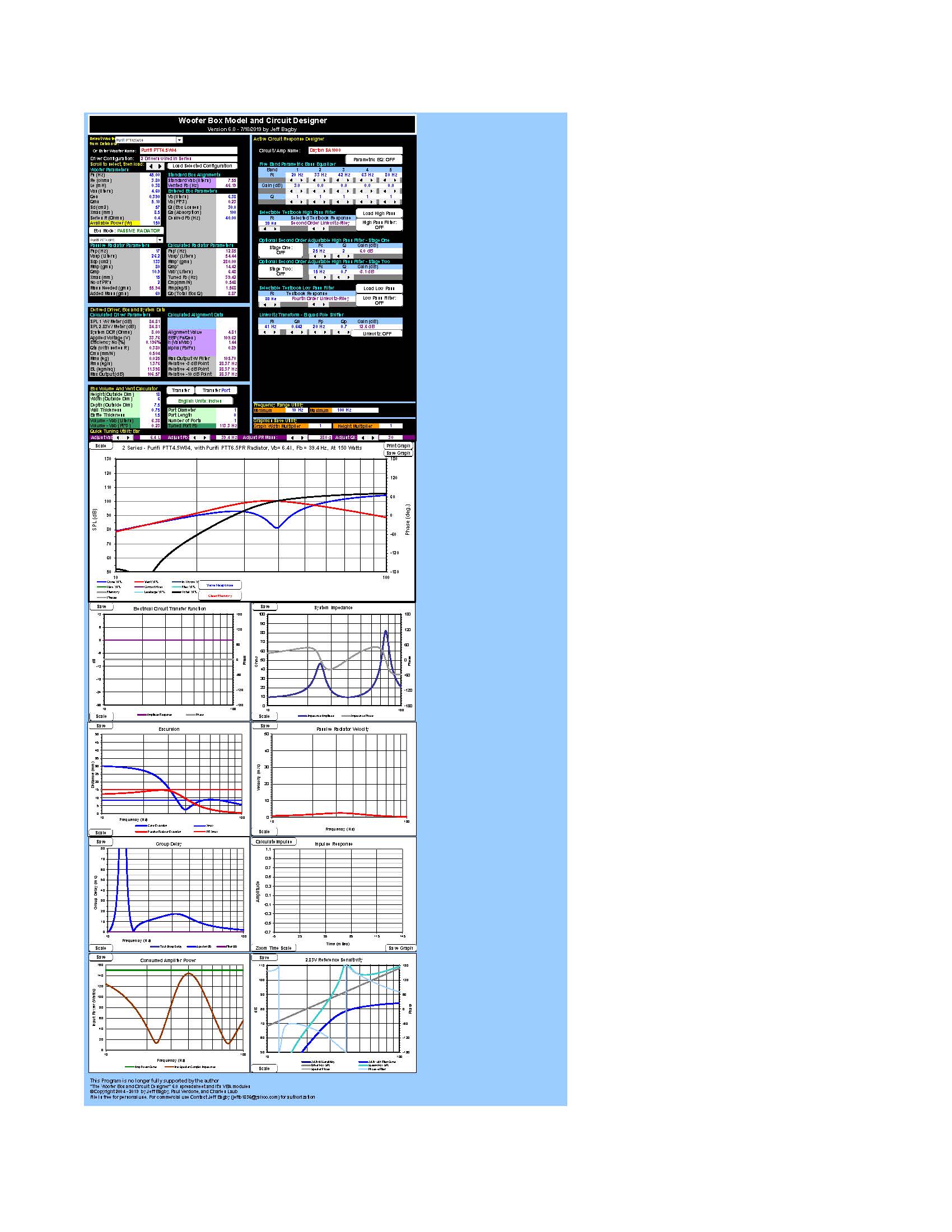

I picked up 4 of the 4" drivers with plans to build a pair in a 2.5 way TMM using the Scanspeak Illuminator Beryllium tweeter on the high end. I'll be mounting these on some floating shelves for use in my business. The 4" models well with a pair of the matching PRs so I have eight of those (four per box, two per driver). Fingers crossed!

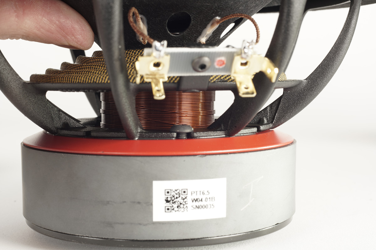

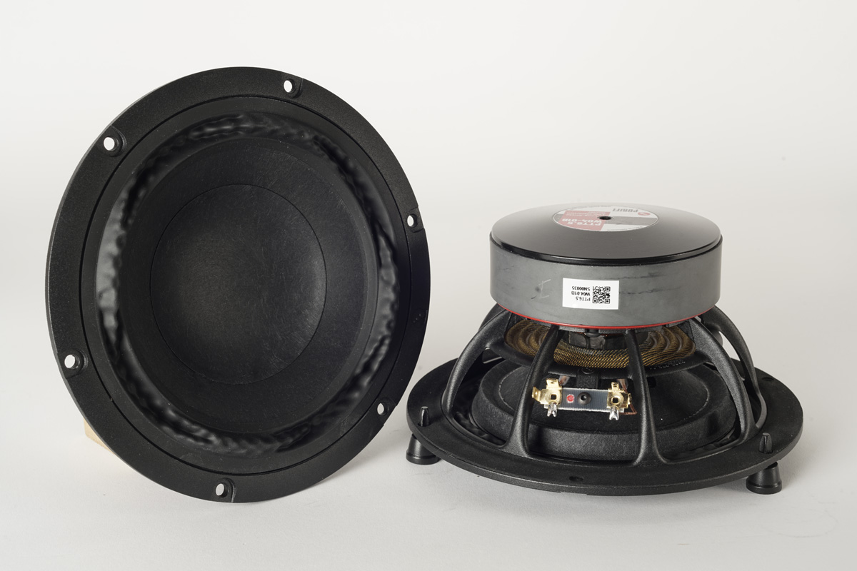

Troels Gravesen has posted his review of the Purifi Audio PTT6.5W04. 6 inch, 4 Ohm driver.
Purifi_PTT6.5WO4
Nice close-up pics showing some of the PTT6.5's unique features.
![voice-coil_1200.jpg voice-coil_1200.jpg](https://www.diyaudio.com/community/data/attachments/813/813165-05871f0fffed188af71ec6f7c5dedffe.jpg)
Purifi_PTT6.5WO4
