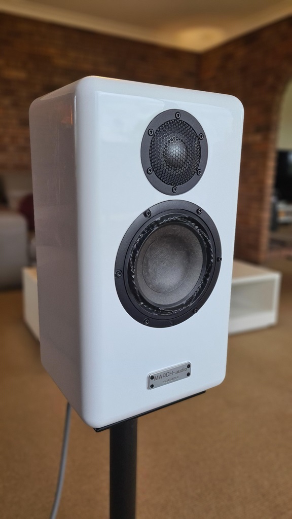

The Sointuva (Finnish for musical harmony) is based on the Purifi Ptt6.5W04 woofer, PTT6.5 PR passive radiators and the Bliesma T34B-4 Beryllium tweeter.

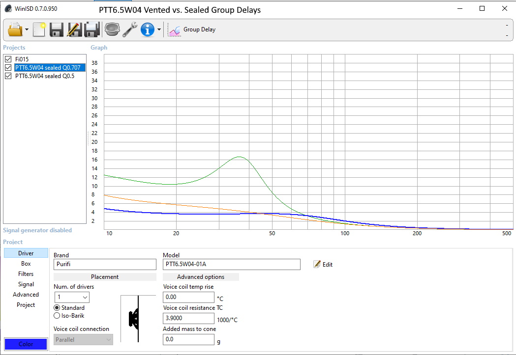

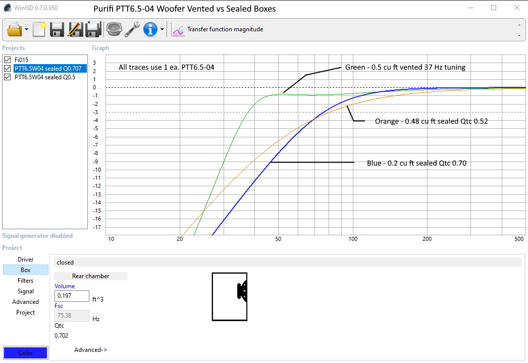

Speculating about “thoughts on how to enclose the Purifi 6.5 while offloading the low bass to some woofers at 100-150hz, in a floorstander?” My first thought was PTT6.5W is designed for vented, I’m enjoying great success in vented (actually passive radiators) so why go sealed. Firing up WinISD there was a route that appeared I find interesting. The screen captures I attach illustrate this. These show sims of one PTT6.5W in first maximally flat vented and then two sealed boxes with the common choices of Qs set to 0.5 and 0.707. The Group Delay shows the typical swing at tuning frequency vented boxes show and the flatter delay that characterizes sealed boxes. Recall there are varying opinions on the audibility of the vented boxes’ low frequency phase shifts. With Group Delay out of the way onto the frequency response sims.
The green trace shows a vented 0.5 cu ft box tuned to 37 Hz, approximately the SPK5 Purifi application note design. The orange and blue traces are the sealed box sims for the common 0.5 and 0.7 Q sealed alignments. First one sees for a 2-way this is certainly a vented box speaker. Nobody wants to pay $250-$300 for a 6” woofer that’s down 3 dB at 90-100 Hz. HOWEVER in mainframe99’s and others who want to explore 3-ways or 4-ways –3 dB at 90 Hz is just part of the crossover. Personally I am so enamored (fanboy – yes) with Purifi bass I am loath to give up my Purifi bass 30-100 Hz.
And then I noticed something interesting. The vented box is 0.5 cu ft (15L) and the Qtc 0.5 sealed box is 0.48 cu ft. (13.8L). BINGO there’s my path if I ever get around to a 3-way with PTT6.5W (not likely watch this space for what I have been busy with). It is not that uncommon to see midranges in vented enclosures these days, perhaps others have thread this path with other drivers before us. So my suggestion is a 3-way with PTT6.5W in a 0.5 cu ft (15L) sub-enclosure vented out the back with some means to seal off that port. Something like a plate with gasket and four screws to really seal off that port (see https://www.diyaudio.com/forums/multi-way/352063-exploring-purifi-woofer-speaker-builds-48.html#post6383932). Now once the prototype is running in the listening room one can experiment actually with three configurations. First PTT6.5W vented midrange. Second PTT6.5W as sealed midrange. Third with loosely stuffed port PTT6.5W as aperiodic (lossy sealed) loaded midrange.

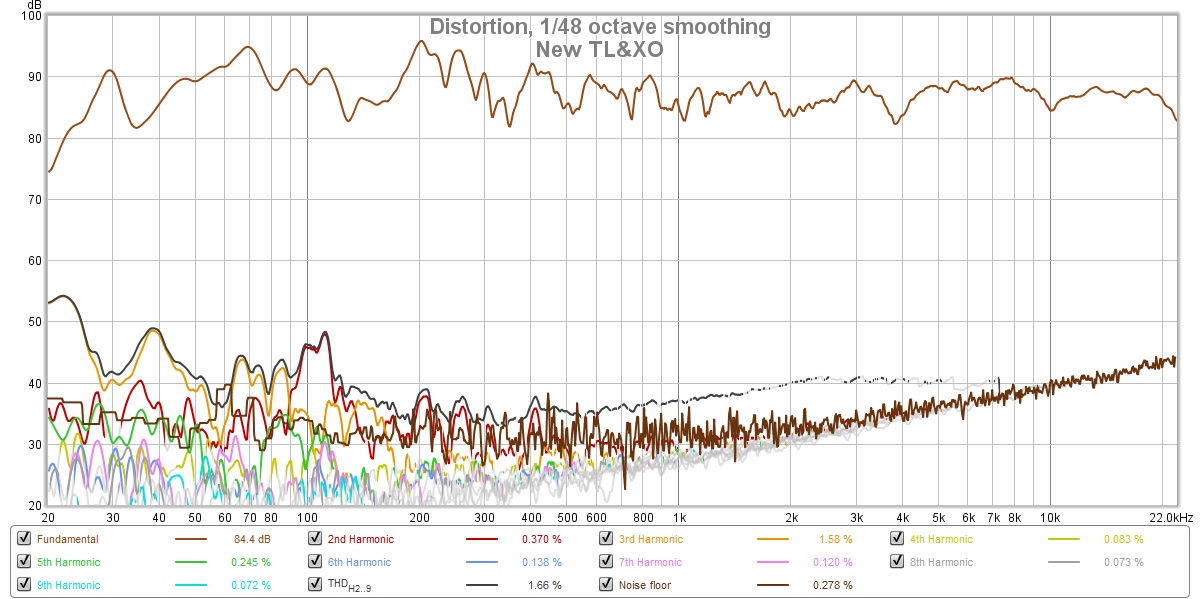

That’s the same conclusion that I had, the driver is badly damaged. Probably the voice coil or suspension is out of alignment. That impedance peak (split with anomaly) near 55Hz looks nasty and a DATS sweep on the bare driver would probably have been more instructive than proceeding with the whole review. A PTT6.5 should not be making 3.5% THD at 86dB. That’s crazy way off from specs or other people’s measurements. It’s like C&D receiving a McLaren after delivery from UK that looks like it was in a wreck and proceeding with the car evaluation after asking their local mechanic to fix it without a manual and then proceeding to test it and write the report.
In my PTT6.5 TL, I measured -50dB THD at 2.0Vrms and 0.5m. You can probably extrapolate that to -44dB at 2.83v and 1m as the driver is operating well below its Xmax. That’s about 0.6% THD. Although a TL is in general, able to get bass with lower distortion than a bass reflex box.
868143d1597513796-simple-passive-harsch-xo-using-ptt6-5-rs28f-waveguide-ptt6-5-rs28f-wg300-tl-xo-hd-2vrms-0-5m-jpg
Finally, a big tell tale that something is very wrong was this statement: “ There was a big miss though and that was any kind of physical bass response. Even at much elevated levels, you could barely feel the bass.” Complete antithesis of what the PTT6.5 seems to provide for all other reviewers. Real bass that kicks hard.
