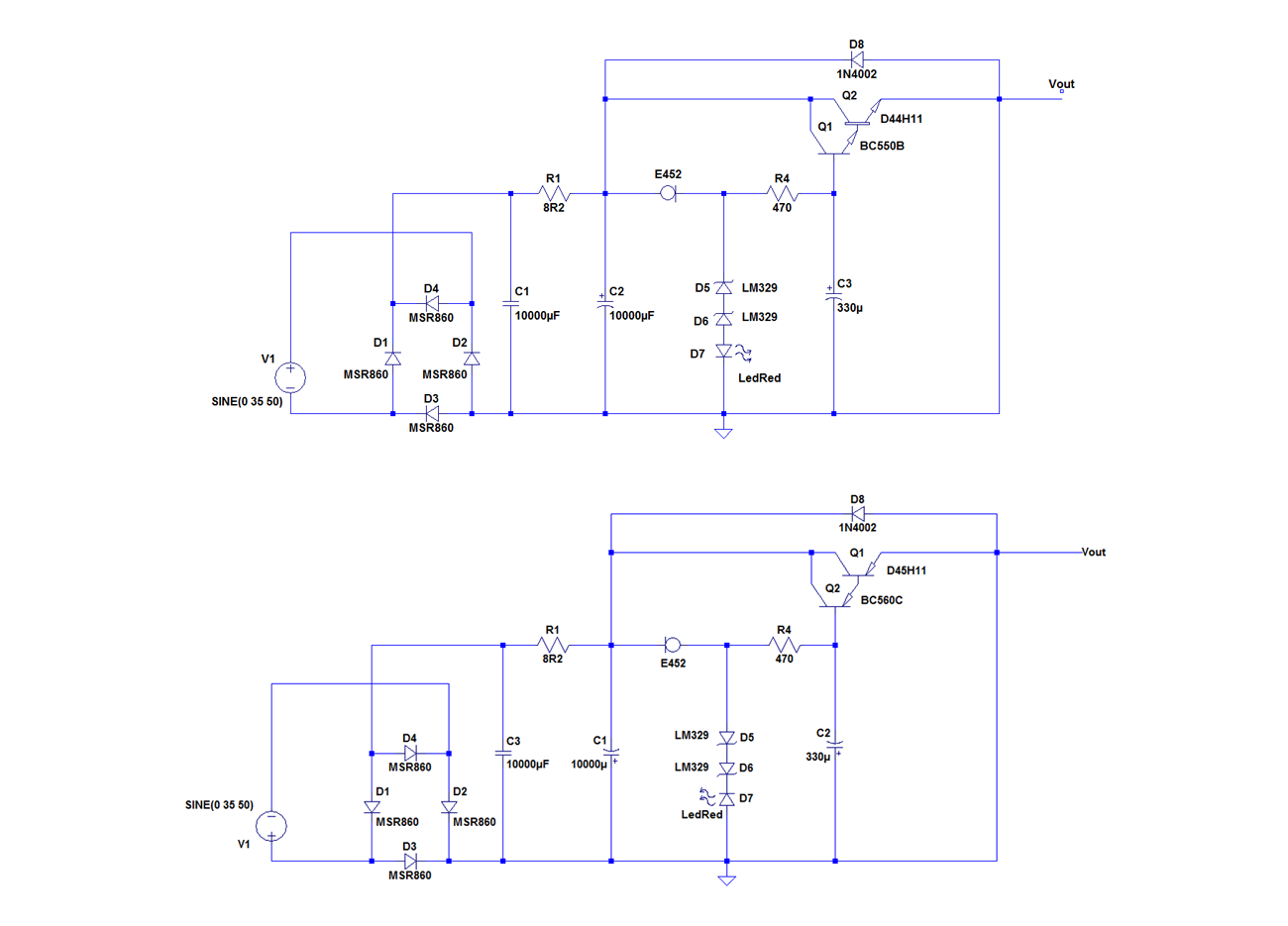

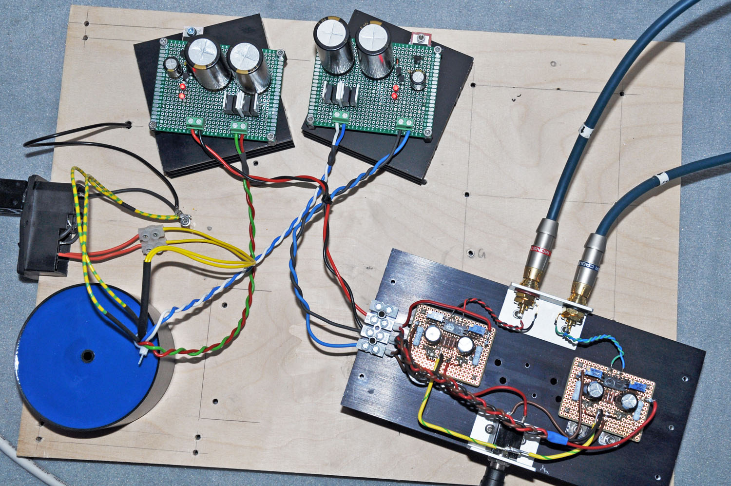

Schematics of the cap multipliers attached. I am using a string of two LM329 and two red Led's in my build to arrive at 16.4V.
The transformer is a custom wound toroid with two shields and 2x18.5V, so plenty of overhead. No mechanical hum, no noise.
Sinks of the supplies are temporary of course, didn't have anything better at hand 😉 Final wiring will also be nice and tidy.

Thank you Stixx for posting your schematic and photos.
Your circuit actually looks easier to build than I first imagined.
A few questions:
1) Are the LEDs 3mm or 5mm red?
2) What are the wattage ratings for the 2 resistors?
3) Is E452 a current regulatory diode?
E-452 Semitec | Mouser
4) Since I can not get a 18.5V transformer, would any changes need to be made to use a standard 18V transformer?
Thanks...

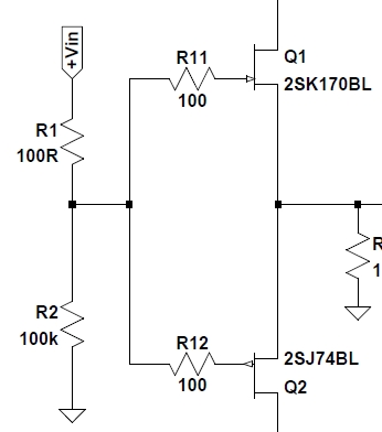

Patrick,
Something I've been wondering about...if using this amplifier with say a 10K volume pot on the inputs, are both R1 and R2 needed, or just R2 to establish the input impedance of the amp?
Thanks...
Same. No difference.
Time to learn to use LTSPice, as Stixx did.
Yes.
No change if you do not want more than +/-18V rails.
Just R2, close to the JFETs.
Patrick
By inserting the Zeners and LEDs you have created a voltage regulator rather than a capacitance multiplier.
Patrick

Schematics of the cap multipliers attached. I am using a string of two LM329 and two red Led's in my build to arrive at 16.4V. .................
.................................I thought Stixx could answer the questions I addressed to him about his power supply,..............
Stixx does not know what he posted.
Why wait for him, it appears he does not understand why his sch is not a capacitor multiplier?
read this again
"I am using a string of two LM329 and two red Led's in my build to arrive at 16.4V"
That makes it a voltage regulator.
