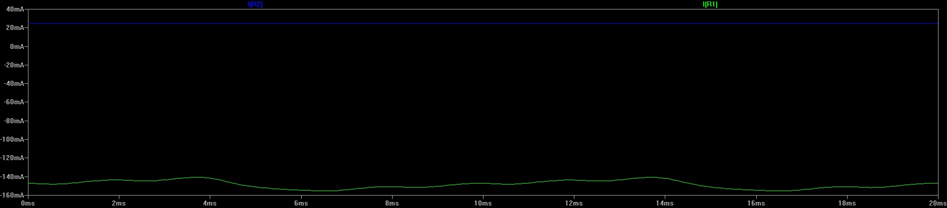

Hi ammel68,
Actually it will only take about 15min of your time.
Download and install the program.
Linear Technology - Design Simulation and Device Models
Open the file from post #236
http://www.diyaudio.com/forums/atta...p-stixx-cap-multiplier-load-reg-amplitude.asc
Run (Click the "running man")
That should open up a new window that looks blank.
Now the option for "pick visible traces" will be available in the menu bar.
Clicking it will bring up an option screen. Highlight I(R1) and press "ok".
You should now see a waveform in the new screen that shows the current running through R1 (a max of around 156mA).
P=I*I*R=(0.156A)(0.156A)(8.2Ω)=0.2W, so 1/4W here.
Now for the fun part.
If you left click a part on the schematic you can change the value. Here I changed R2 to 1K. Now I=25mA, so you will need 3/4W if you do that. (R1 is still 8.2Ω)
