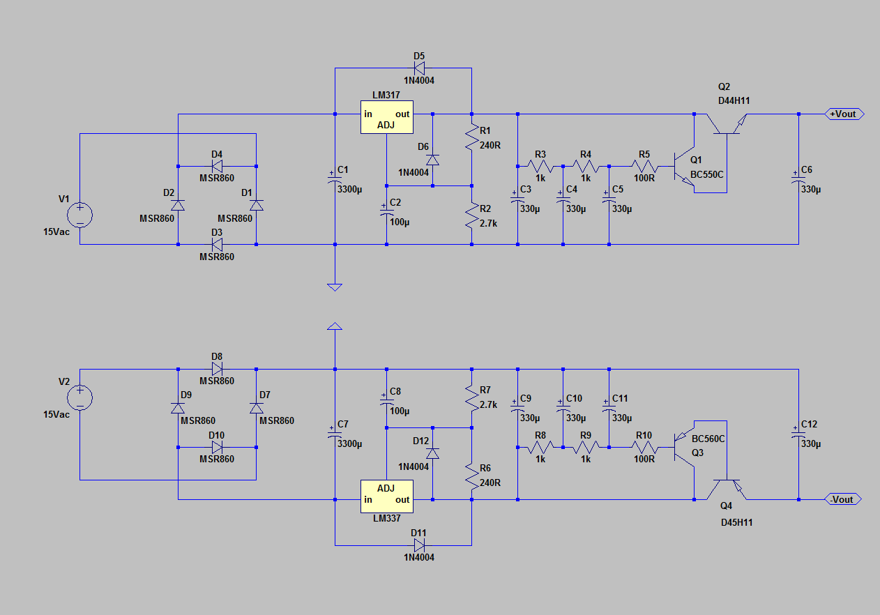

> I'll actually rip out the supply from my existing Tortello's 'zen-like' headphone amp ....
That's just a normal LM317/337 PSU, not ?
If I am not wrong they cannot take low ESR caps at the output.
Patrick
By 'rip out' I meant remove and put aside. What I'll be doing is building a new pair of PS as you suggested, and putting them into the existing case together with the F5 HA boards and a couple of toroids.....I have confidence that the results will be acceptable (and hopefully wonderful
Yes, the existing PS presently in the case use Tangent’s TREAD boards using stock LM317AT etc..
Bear in mind what I said about low ESR caps with 317/337.
You may wish to consider placing a cap multiplier as I described before between 317/337 and F5HA.
1) It will lower the output noise of the 317/337 substantially. You hear more details against a darker background.
2) It will provide high bandwidth power to the F5HA.
3) It will also isolate the 317/337 from the load at those high frequencies, when the 317/337 becomes inductive.
Patrick
Patrick
Will do.....ie per post #60. That was exactly my plan!
You can do post #60.
But it will dissipate double the power because of the shunt leg.
So you need 30VA transformer per channel, plus double the heat sink (about 12W per channel).
On top of that there is no reduction in noise of the 317/337.
(But still worth trying).
The one I referred to in #135 is something like the attached.
Patrick
Patrick
I plan to use similar PSU for headphone amp.
My plan is using CRC filter before 317/337 for additional ripple filtering, and use K multiplier (Keantoken) instead of C multiplier, performance (from his page):
Input rejection: +66db/-54db or +2k/-500
Output impedance:
112mR at 25mA
45mR at 50mA
27mR at 100mA
20mR at 200mA
17mR at 400mA
Excess output inductance (in inches of wire): at or below 1.
Output current: 1.4A max continuous. 20-400mA max for linear operation.
Output voltage: Limited to the Vcemax of Q1, but see Other Adaptations for a version for any voltage.
Voltage drop: ~1.8V (can be less but this gives good operation)
Max input ripple before saturation: 1.5V pk-pk (0.46Vrms on an AC multimeter)
I'll do it with 2 PCBs, first RAW DC CRC finished and second (317/337 => K-multiplier) in works.
Probably overkill but why not
First PCB additionally have transformer secondary "Hagerman" snubbers & rectifier diode snubbers (R+C or C only).
- F5 Headamp ?
