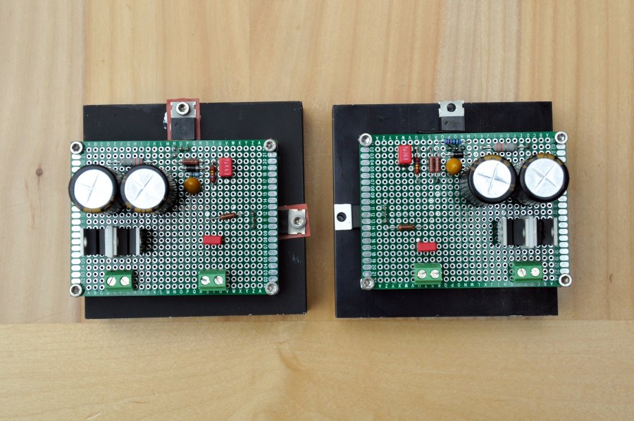

Patricks proto F5 has been playing music for a while now with several simple psu's to try... now I am planning to eventually case it up with a permament supply.
For that I have built a bipolar supply of Nazar regs, both working trouble free and outputting around +-15V (they are within 1,5% of each other).
The sharp eye will notice that they are not 100% mirror identical, but good enough for now. Filtering is CRC with 4700uF-3R3-4700uF. SMD parts are underneath.
Now need to get a custom made 2 x 18V transformer (actually don't need to but want to

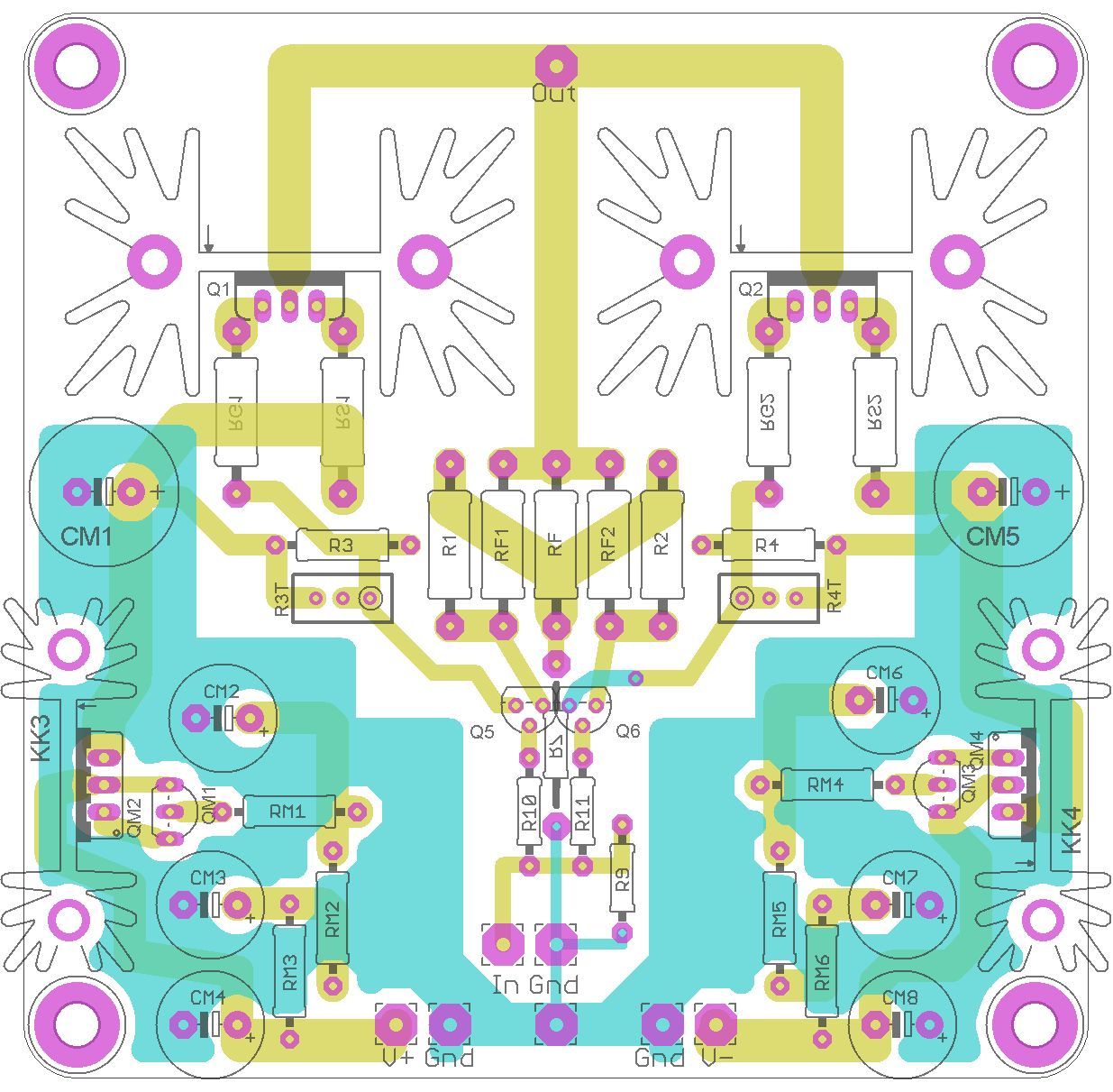

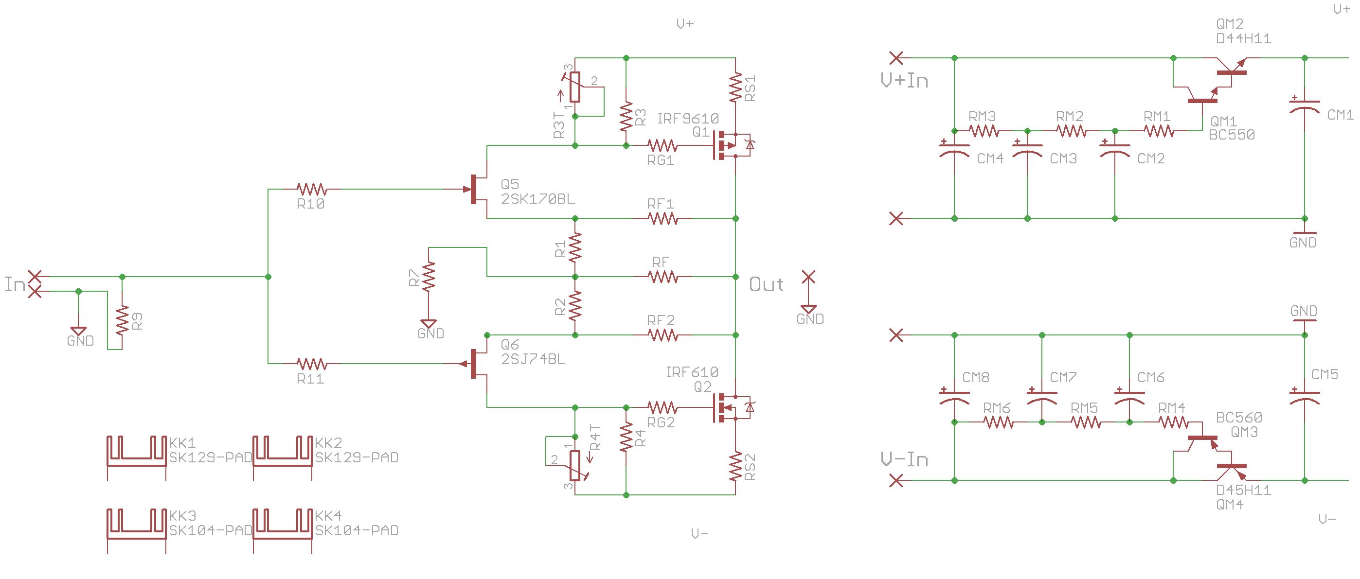

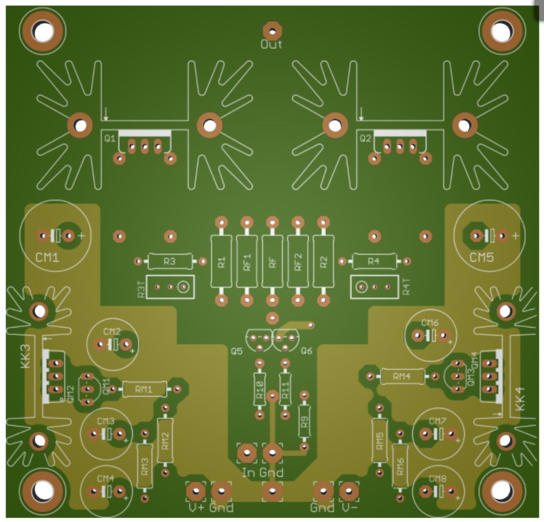

P.S. If interested, I designed simple single layer pcbs for both solutions, F5HA+Nazar and F5HA+Cap multiplier, that can be etched at home.
Thank you Massimo for asking, but I see no need on my side. I have the F5 and Nazar boards already P2P, and I will build the
cap multiplier as well which can be squeezed on an even smaller board.
F5 boards go on the heatsinks on each side of my planned case that will be plenty big, also to support the demands of either psu.
I hate vero hacking, so...
Dimensions 10x10 cm.
Darlington Cap mutiplier added on board. Power comes from Raw DC CRC board.
This heatsink is 6.5 K/W, cca 20 deg up, cca 3W per FET, 200mA*15V?
