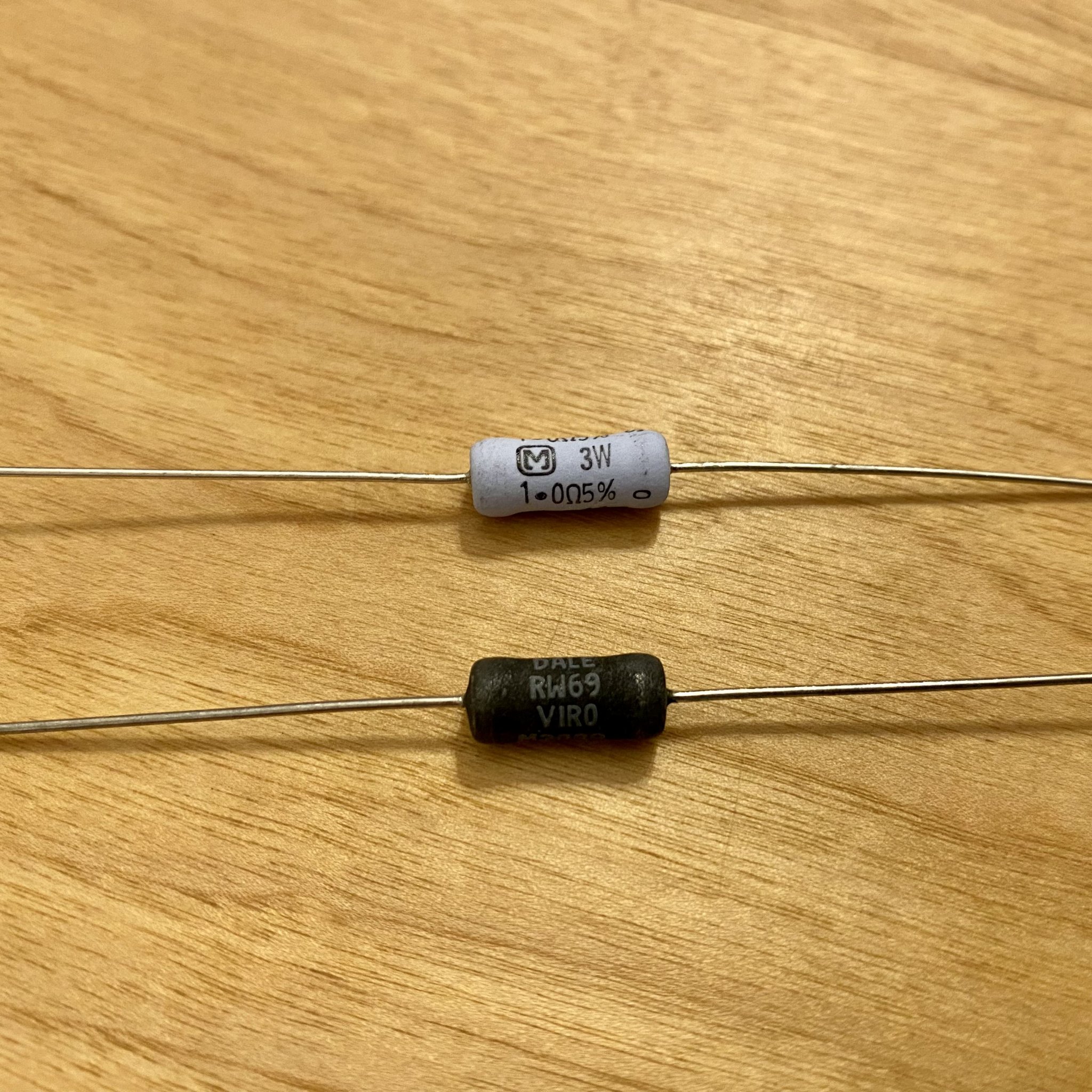

Hi all,
I'm in the process of building v3 monoblock version and need a substitute for R17-R24 (1 ohm 3w). The v3 BOM suggests using 71-RW79U1R00F, which is currently out of stock.
I have enough of 667-ERX-3SJ1R0 or 71-RW69V1R0, but I wanted to confirm prior to stuffing whether either would work and if one was preferred over the other.

If there is, it's probably out of date with all the parts shortages and obsolescence.I am planning to build the turbo v2 is there a bill of materials out there for mouser or digikey
The schematic is always the best place to start.
Use the V3 schematic, obviously you just omit the last 2 pairs of output devices.
Do cascode.
Many people have been omitting the 'turbo' diodes lately. I think it's a good idea. Makes for more stability and an easier build overall.
Do cascode.
