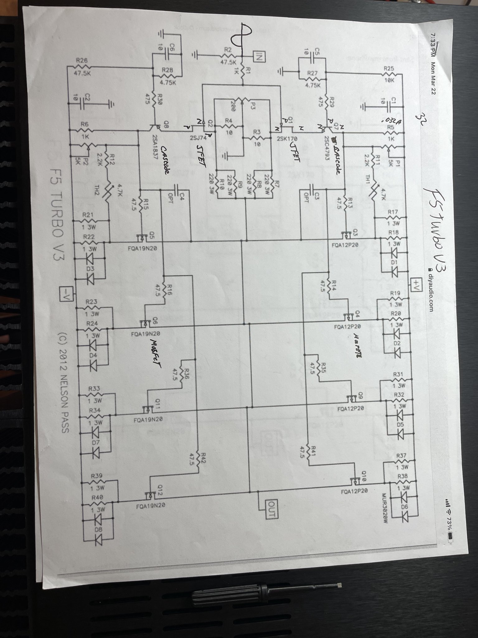

I’m at the end of my rope with my F5Tv2, can anyone help. As mentioned earlier I replaced all the Mosfets with matched pairs for a F5Tv3 monoblock at some point in time. For now, it’s stills stereo amplifier. I can’t keep a stable bias and offset on one of the channels. As soon as I get it set at 350ish mv and 0ish offset, I’ll come back and check it and I may be at 370mv bias 40mv offset so I’ll re-adjust and check it, 20 minutes later holding, 20 minutes after that I may be back up or perhaps down to 330mv and -15mv offset. And the adjusting process starts again. Any thoughts or direction is greatly appreciated.
I’d like to add to this that the slightest turn of P1 or P2 will sometimes make a swing of 20/30mv up or down. This is totally different than the operating channel.
As a note, the other channel is biased at 352mv/-2mv offset and holding.

.032A, is 32mA, which seems extremely high. Can you double-check this? This would certainly point to a problem with the JFETs or their input connection. Remember a JFET without an input is effectively a short, or close enough.
I would use C3 and C4, in addition to small capacitors (around 470pF-1nF, whatever's in your junk box, if you have both, try the higher value first) across the 220R resistors. They are not shown in the schematic, but alluded to in the article as well as the guide. There's no footprint for those, far as I remember, so they can be tacked on to the resistor legs..
Bias drift is usually related to temperature differences between either input or output parts. If you spent a lot of time changing devices without results, maybe you should be looking at the source resistors. MOX usually have very, very high temperature coefficient and this is very good for high bias amps to proetct the output devices, but they can also be notoriously diffifcult to get matching for. Even the slightest drift, even from natural convection, can cause variation in your setpoint. You can verify this by blowing over the resistors to see the effect of this first hand.

Sangram I will check those values I’m assuming across R5 & R6? The .32a notes on the schematic was on there from the initial build when I was having some issues. I’ll recheck those values. I also have 1NF caps installed on the output boards. Are you saying to install caps across resistors R7-R10?

You said .32 in the above post, the notes on the schematic say .032A. Are you reading voltage, or current?
Current cannot be measured at that point, it has to be extrapolated from the voltage reading across the 10 ohm JFET source resistors in the input stage. Seeing the confidence of the schematic notes, I assumed this is what you did. Measuring the voltage at the point you noted is pointless as we do not know the resistance value, unless you measure that (with the amp off) and then divide the voltage reading (with the amp on) by it.
With P3 at mid position, the source resistor is 9 ohms and much easier to extrapolate current from. Usually 6-8mA is what you are looking for, so about 50 to 70mV.
A single cap across each of the two feedback chains is sufficient.

that being R7 and R10A single cap across each of the two feedback chains is sufficient.
Ok, thank you. So I’ve done some checks.
Across:
R5 4.39v resistance amp off .589k/7.45ma calculated
R6 4.7v resistance amp off .581k/8ma calculated
R3 64.4mv
R4 69.5mv
whats storage is the resistance has remained constant at .589 across R5 but R6’s value is still dropping.
I’m going to have to pick up some caps to throw across R7 & R10

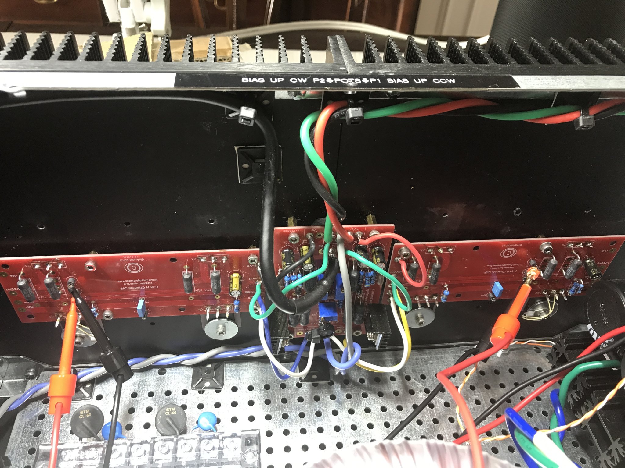

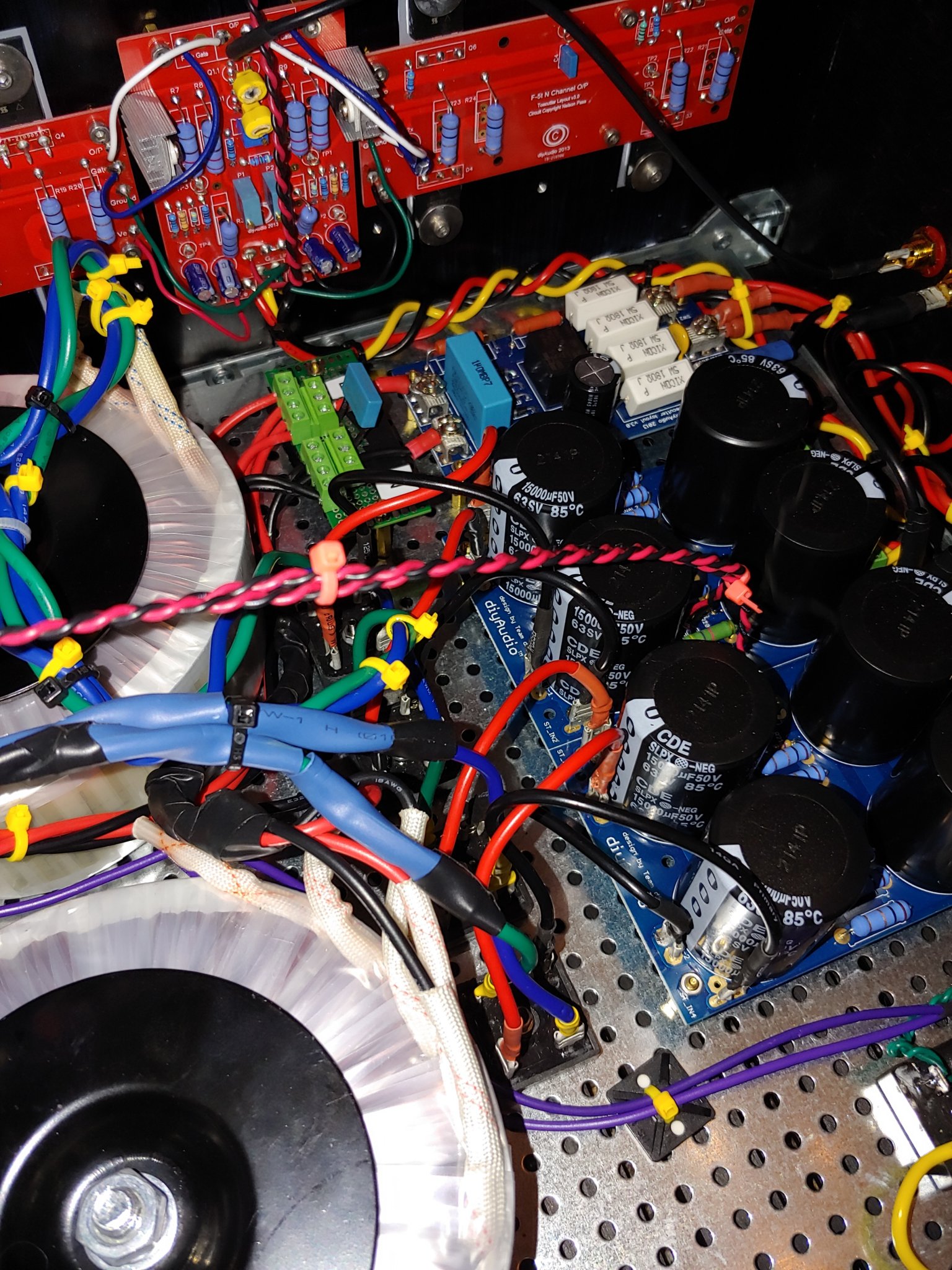

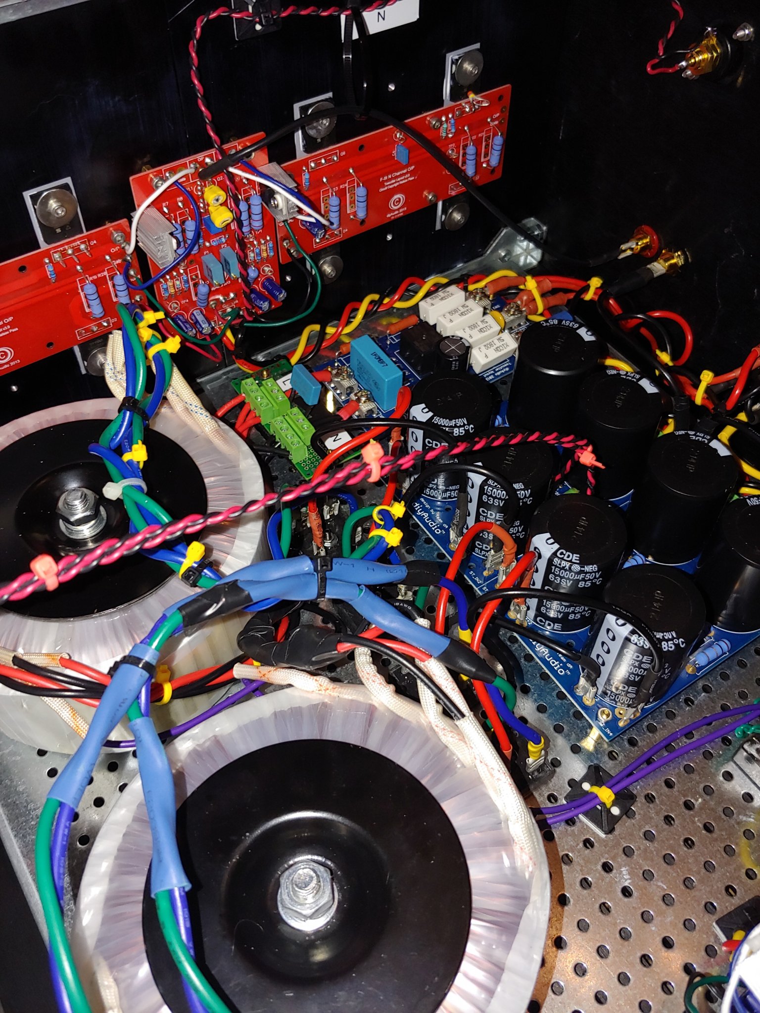

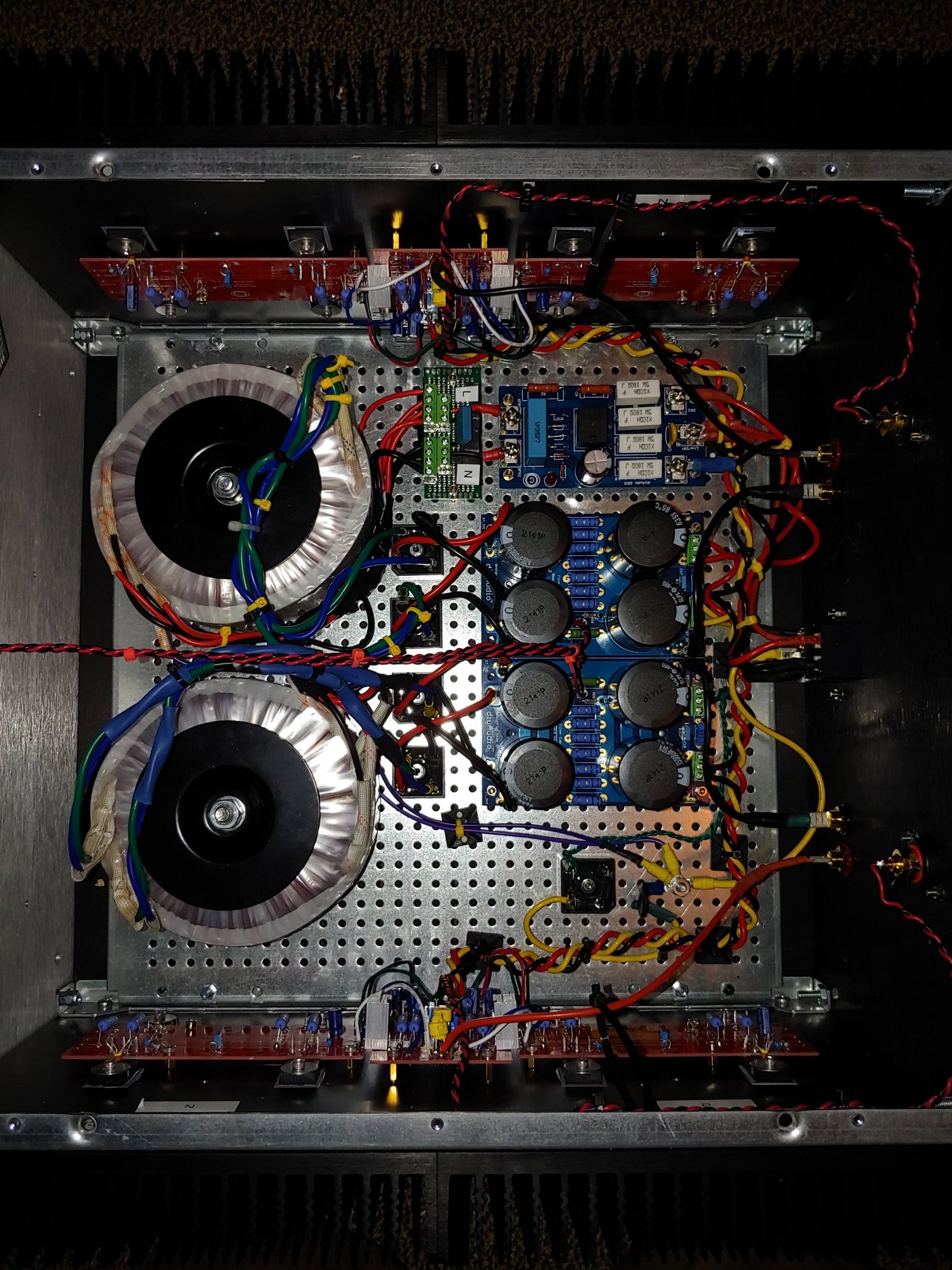

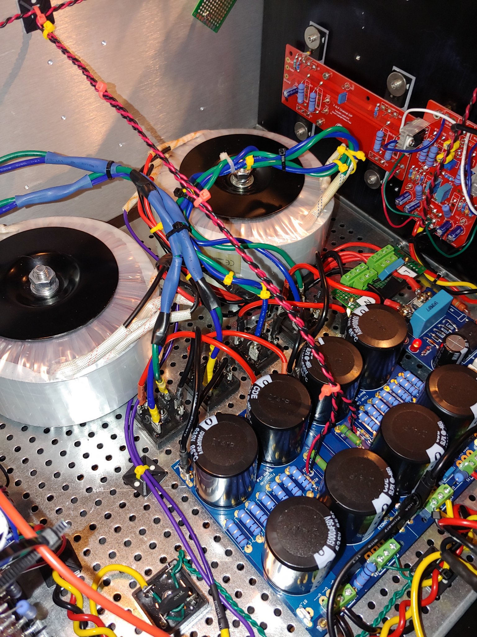

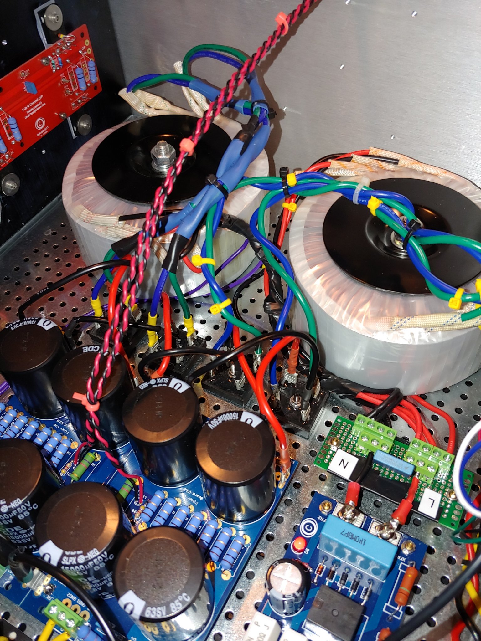

Update on my power supply issues.
I have installed a second 400va transformer in the chassis and I am using each transformer to power the different rails. Photos attached.
So far so good, I have 34.9vdc negative on the negative rail and 34.9vdc positive on the positive rail. P1 and P2 are dialed to 0 ohms in preparation for biasing the amp. So far there is no mechanical noise coming from either transformer. I had to make a little junction board in order to connect all the power leads for the transformers.
When you buy the 5U chassis, you think you'll never fill it. Think again. It's getting crowded in here.

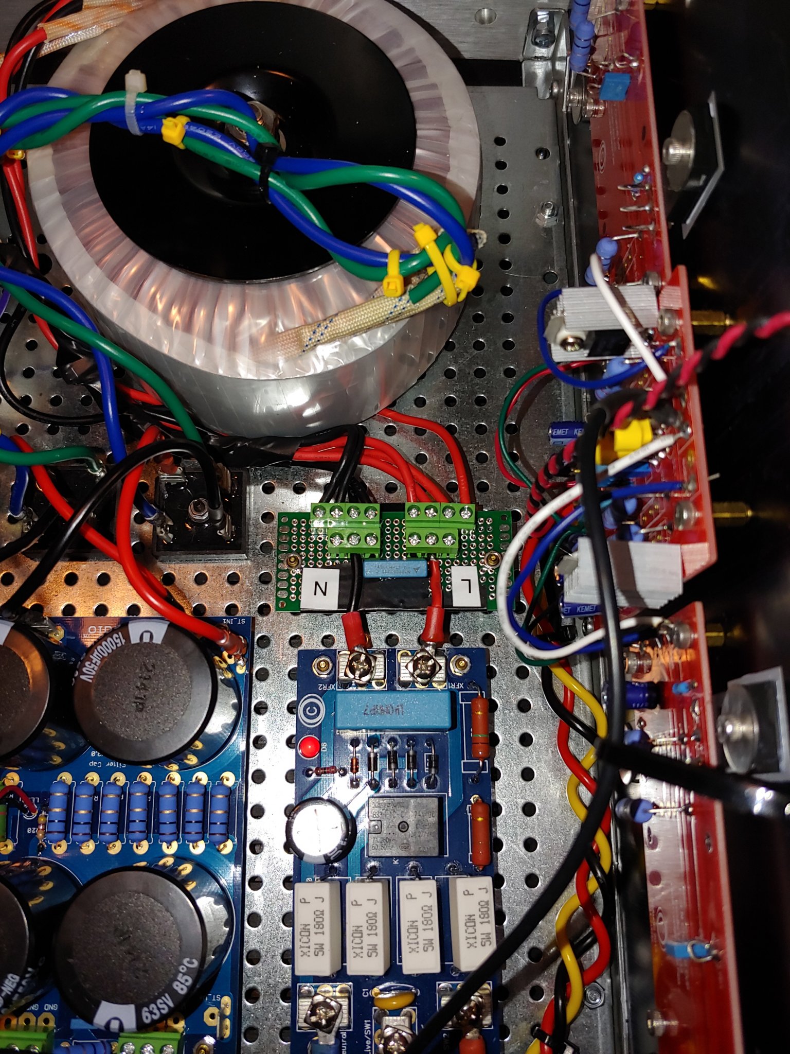

As you can see each secondary output from each transformer feeds it's own bridge rectifier (2 for each transformer). Then each of the secondaries are fed in parallel to the corresponding rail on the PSU board. This allows each rail to get the 24vdc input with the full 400VA from each transformer. The PSU board then converts the output up to 35vdc positive and negative at the output of the PSU to feed the channels of the amplifier.

You could double the PSU as well and use one per channel. Put the 2nd one on top of the other, looks like there is enough hight available.
With dual secondaries per toroid, you could get a dual mono setup and double the filtration for even better bass response.
Looking very nice!
Looking very nice!
