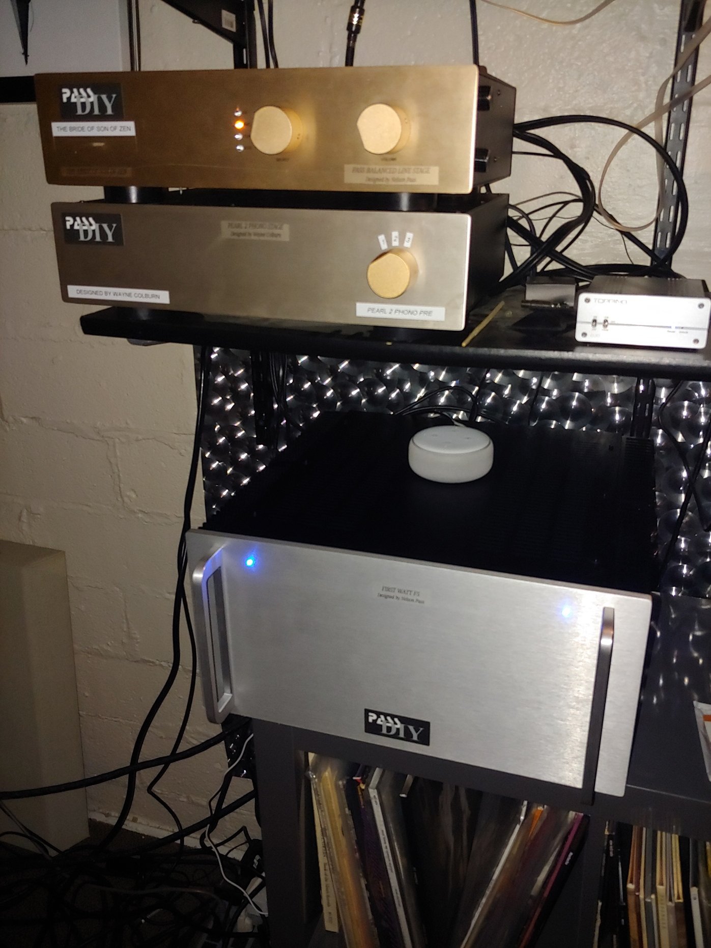

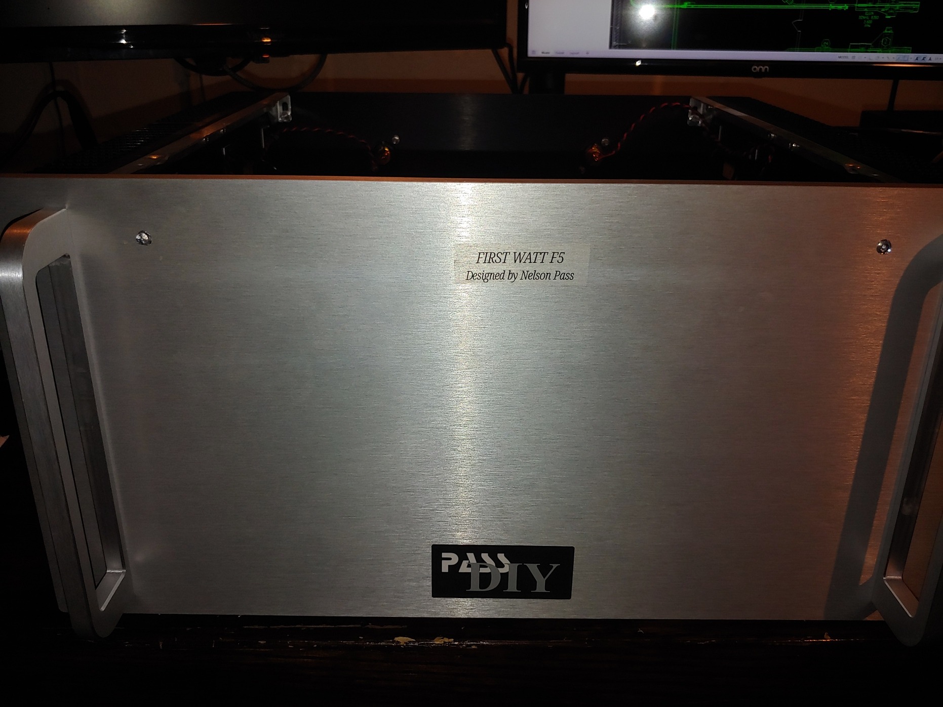

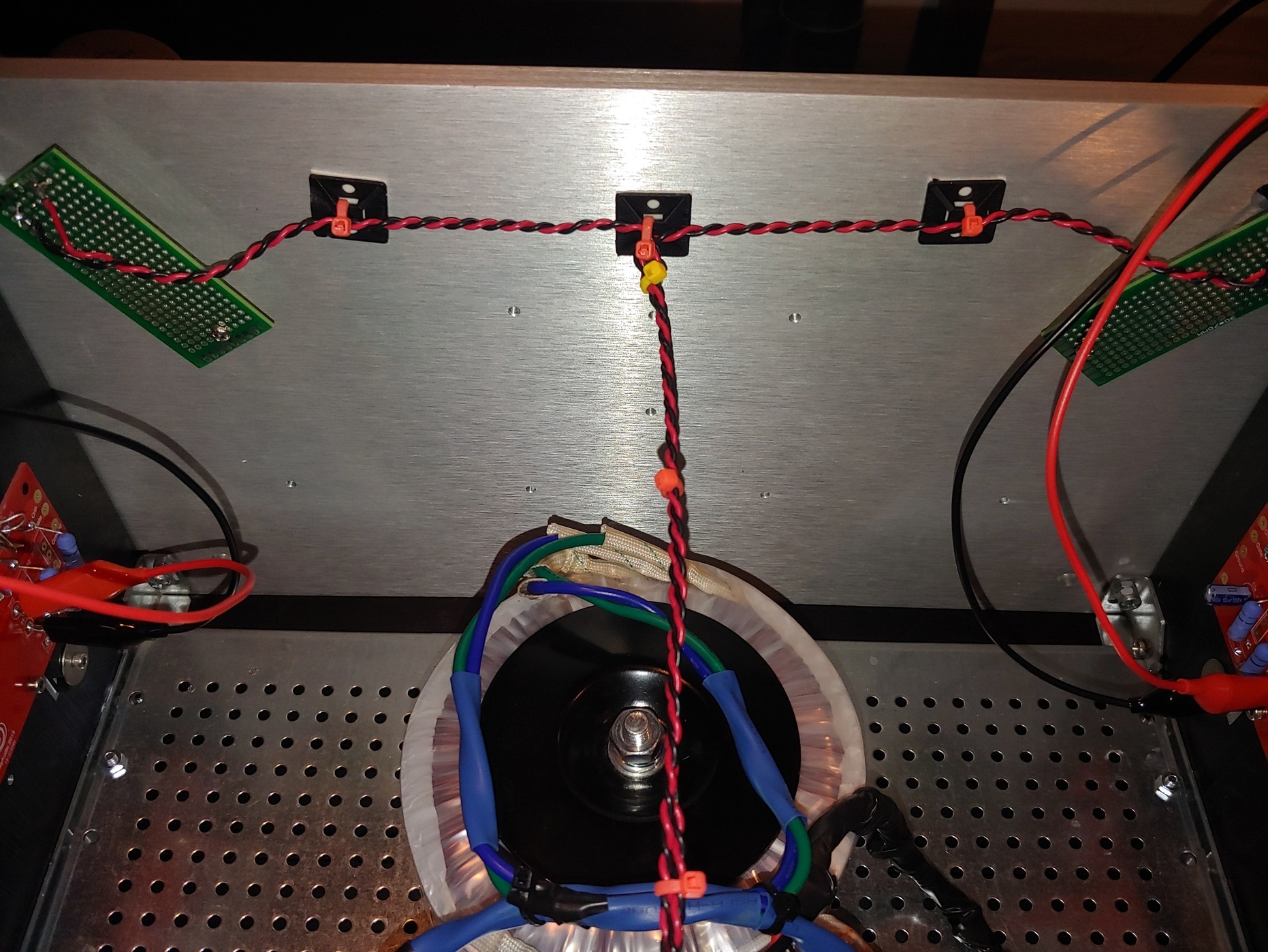

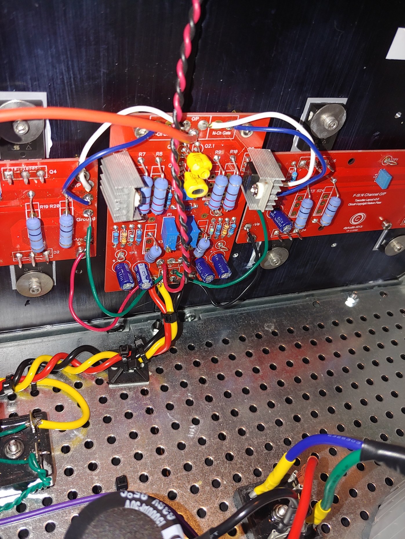

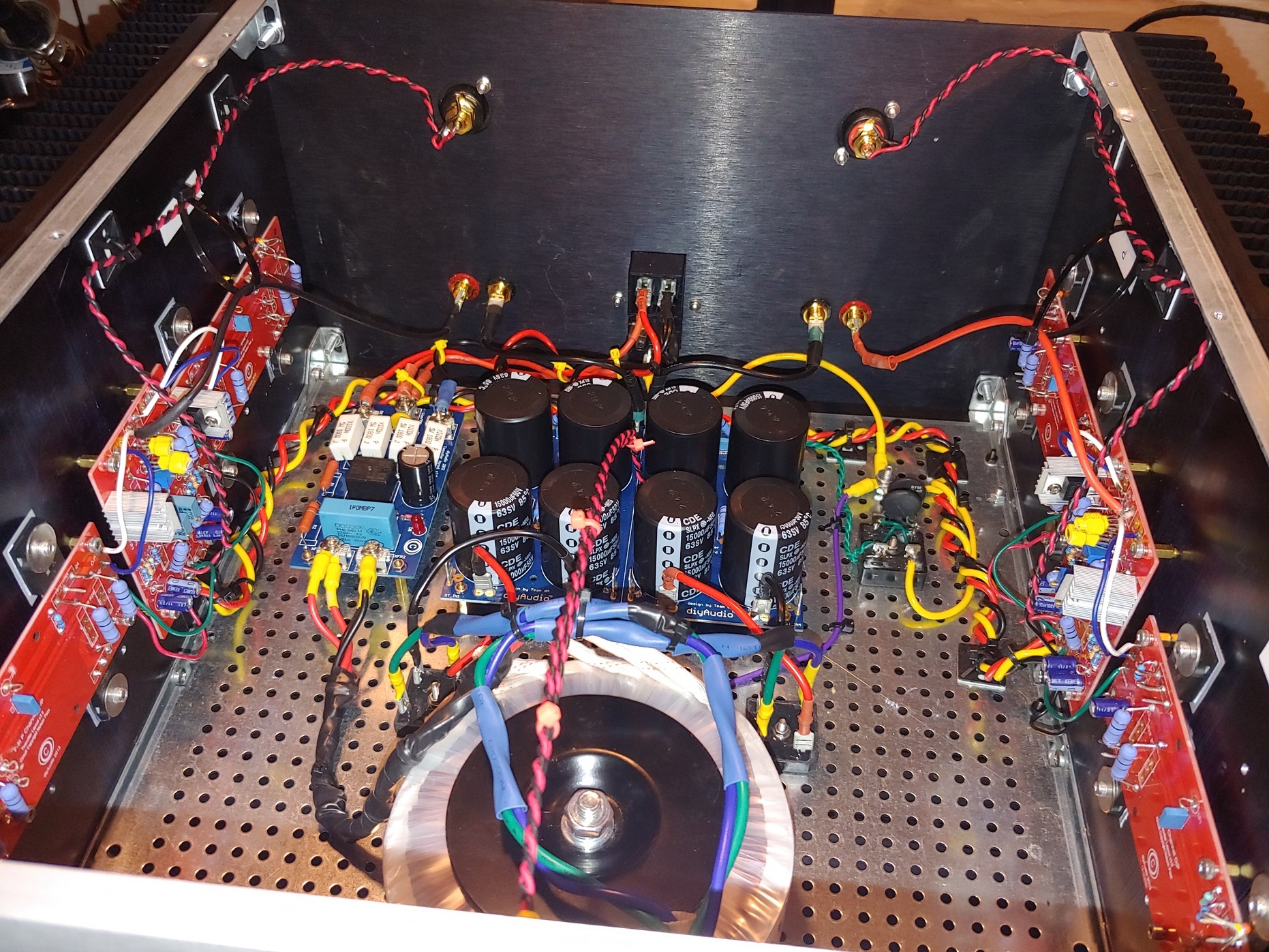

Finally finished my F5 turbo. It's been a journey. I had significant problems with hum which I traced back to a combination of transformer issues and dc pollution on the mains
I couldn't get a 600VA (AN-6224)transformer to behave properly on my mains. I tried a 500VA 2x24v (AN-5224) and it wouldn't work properly either. I built a DC blocker and that made some difference, but not enough for a listenable amplifier.
I finally tried a shielded 400VA 2x24v (AS-4224) transformer and it is working perfectly. No more hum.
If I were to attempt to rebuild this amp in the future I would not choose a large VA transformer (too unpredictable) and instead I would use either an AS-3224 or AS-4224 in dual power supply configuration i.e. a separate power supply for each channel only connected at the main star ground.
It works out a little more expensive but a lot less problems I think. All these transformers I sourced from Antek inc. here in the US.
I've included some photo's of the finished build.
I'm going to run the amp in using the 400VA transformer for a while to see how it performs. If I have problems I will switch to a dual PSU solution.

^ The cans are brilliant IMO, I have several. However, they don't likely prevent the type of hum they're describing. I think they had actual mechanical hum from the transformer itself vs. EMI causing hum by coupling with the signal or DC supplies etc.
The shielded 'AS' Antek's may have less mechanical hum (compared to their 'AN' brethren) or hum less with DC on the mains b/c of the shield itself and it's electrical function along with a general theory that they're wound tighter / packaged more tightly / have the gauss band for additional support. I don't know for certain that's true, but it makes sense to me. Also, smaller transformers seem generally less likely to have mechanical hum unless oversaturation of the core is what's causing the hum. That's not likely in this case since they actually went to a smaller VA transformer (and just given the specs of the transformer vs. the amplifier).

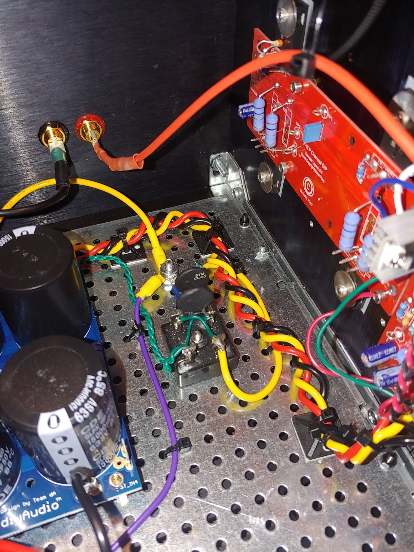

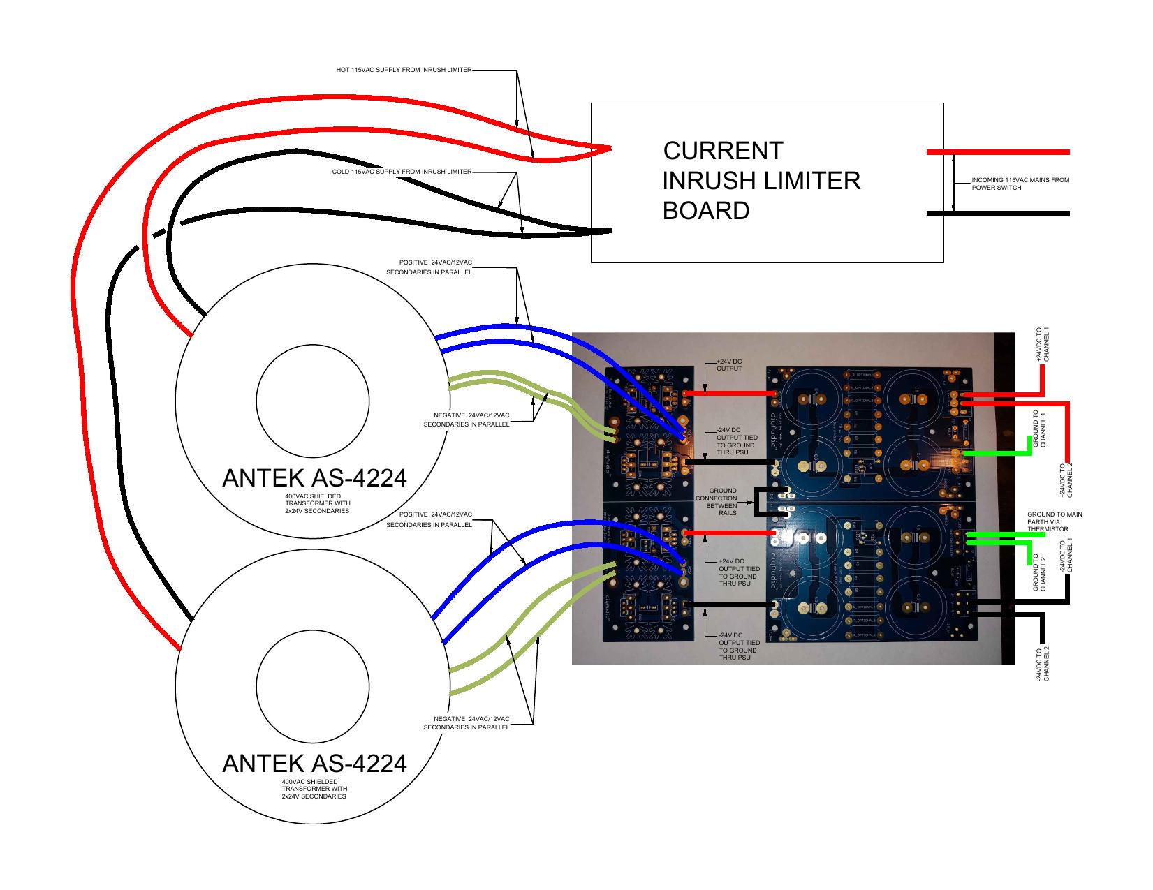

I've had an idea for a solution to my power supply problem.
I was watching the video of the diyaudio implementer on youtube where he is building an Aleph J amplifier. He had an interesting solution to his own transformer issues. He was unable to source a transformer of the appropriate VA rating and secondary voltage so he bought two 250VA 2x18v transformers and wired the outputs from each in parallel and used one transformer to power the positive rail and the other to power the negative rail of the power supply. In effect he was supplying 250VA to each rail for a total of 500VA.

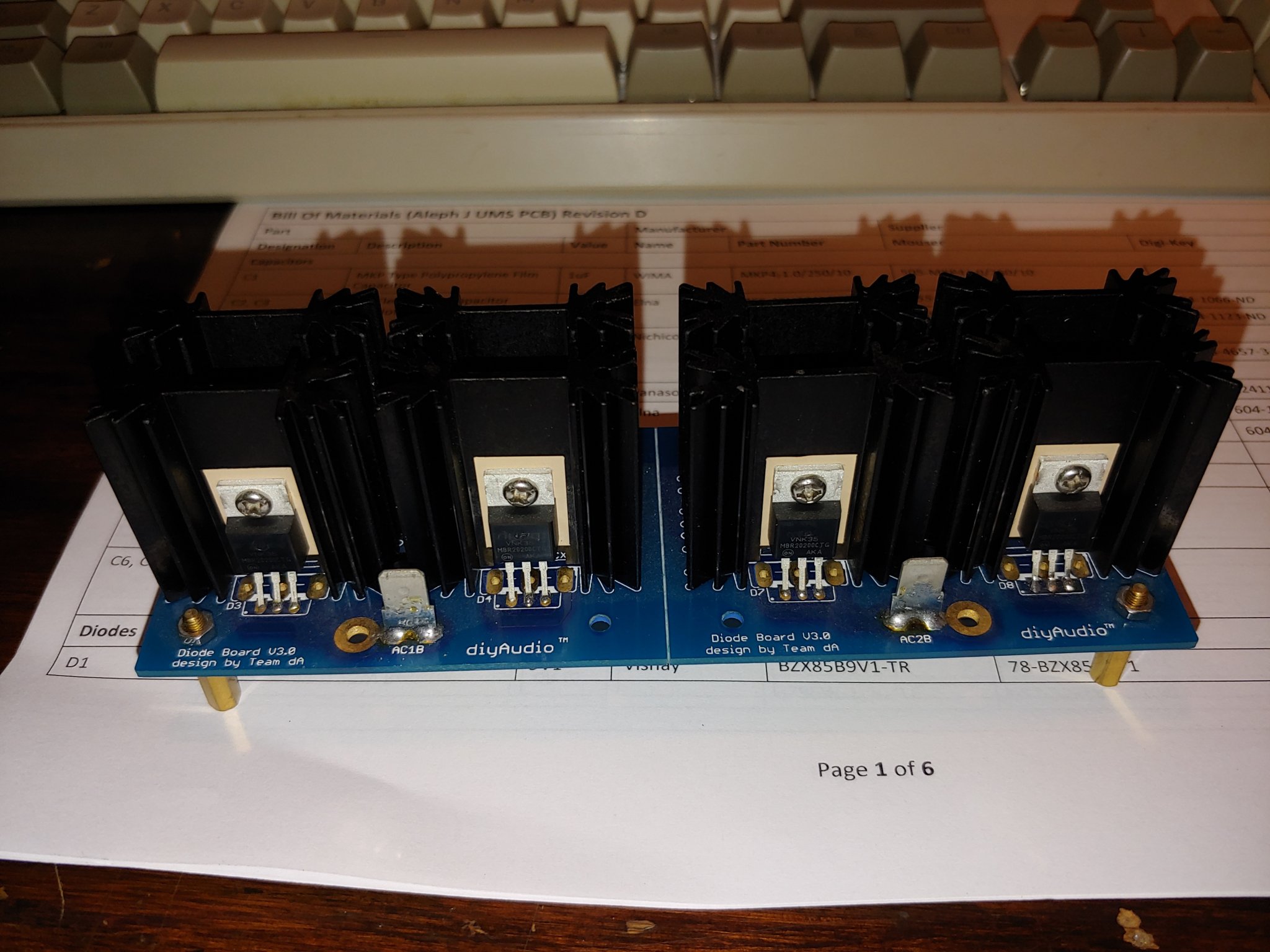

He used two bridge rectifiers and tied the secondaries together. I'm not going to do that, I think I have a more elegant solution. From a previous project I built up the rectifier boards from the universal power supply but I never used them. They've sat on a shelf for the last 3 years gathering dust. I've included a photo below and if you look at where the transformer feeds are attached - AC1B and AC2B there are holes for attaching transformer feeds in parallel (on the other sides of the heatsinks are located AC1A and AC2A). At the moment I have a blade inserted in the holes for 'faston' connectors, but I can remove them.
I happen to have a second AS-4224 transformer in another project (BA-3) that I'm willing to put into the F5 Turbo.
So it's going to be a kind of quasi dual mono power supply unit without having to build a second PSU board, and as a bonus I will have a total of 800VA for the PSU
What does everyone think? Will this work? Or am I going to experience other negative outcomes?
Thanks in advance

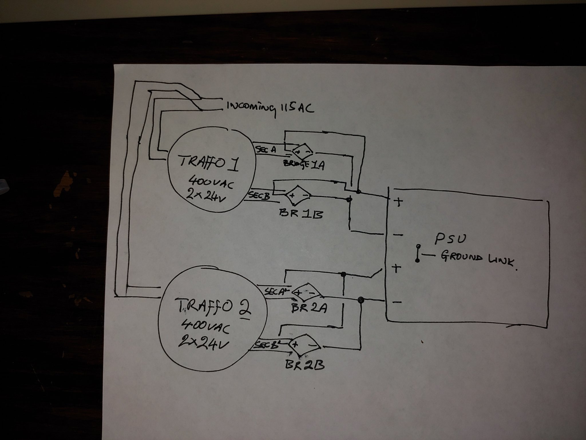

I've sketched up a drawing showing what I mean, as I don't think I explained it very before. The only reason I'm considering this scheme is I have been unable to get any un-shielded transformers over 400VA to operate reliably. Have a look and tell me where I'm going wrong. If this can work it saves me having to build a second PSU board and move everything in the chassis to make space for it.
I don't think I understand how one transformer can load the other when the only connection between them is through the ground which is connected to the main earth
I don't have too firm a grasp on this.. admittedly. ZM is much better at explaining.
Seeing your diagram, you're correct one would not load the other.
Thinking it through... it may be that one secondary being slightly different (not guaranteed, but maybe) could act as a load to the other if they're not perfectly wound.
Either way... mine is speculation. ZM actually really knows this. I just guess a bit based on my very limited knowledge.
Hope it all works out.
I see transformer secondaries connected in parallel to bridge rectifiers in the diagram in post #1,729. That can be a problem if the windings and voltage ratios of the two primary/secondary winding sets are not exactly identical. If the transformers are bifilar wound, then they probably are identical. If they are not identical, then bad things happen.
Having said that, I think Antek transformers are bifilar wound. But you can't go wrong with separate rectifiers for each secondary winding.

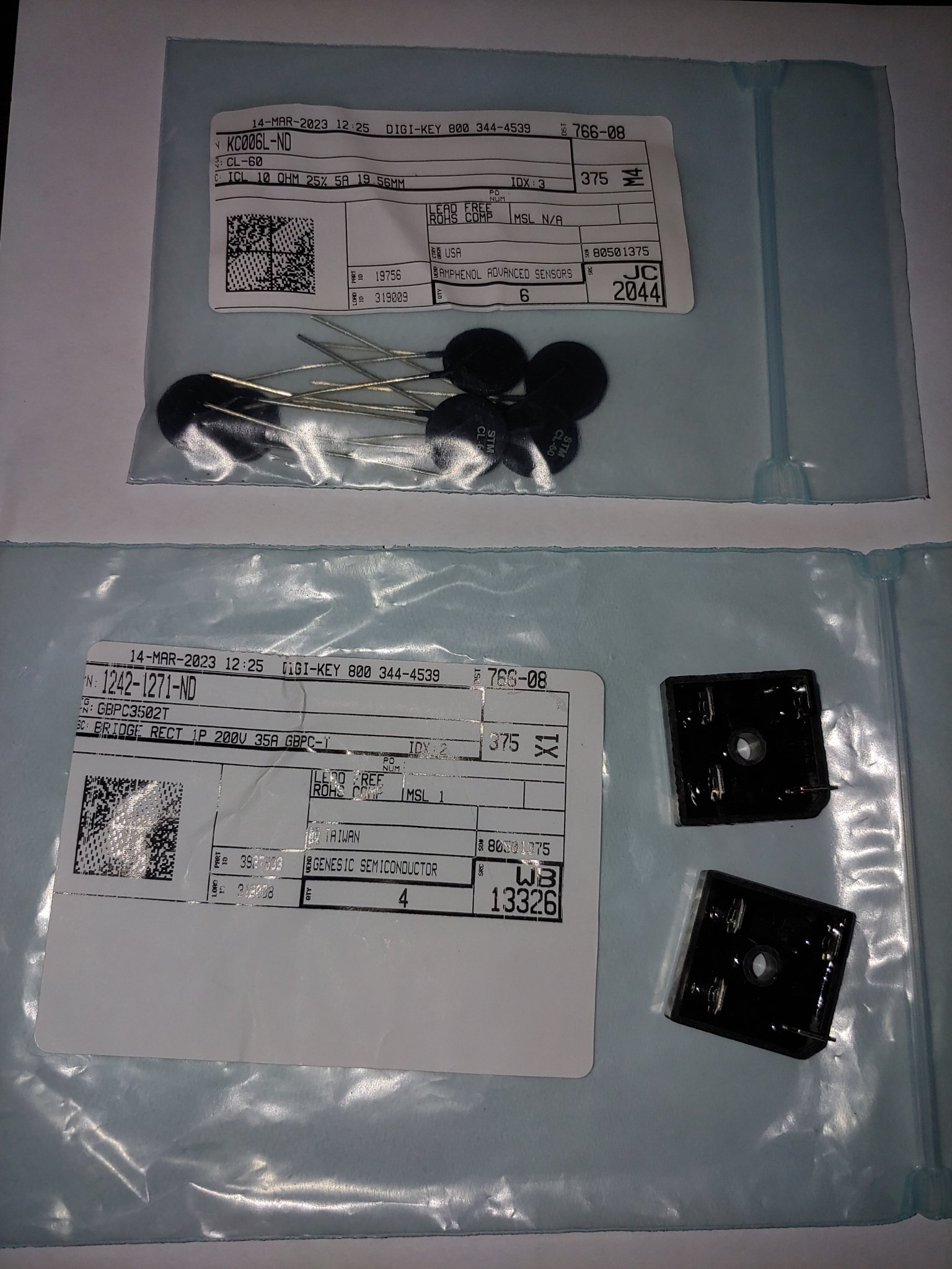

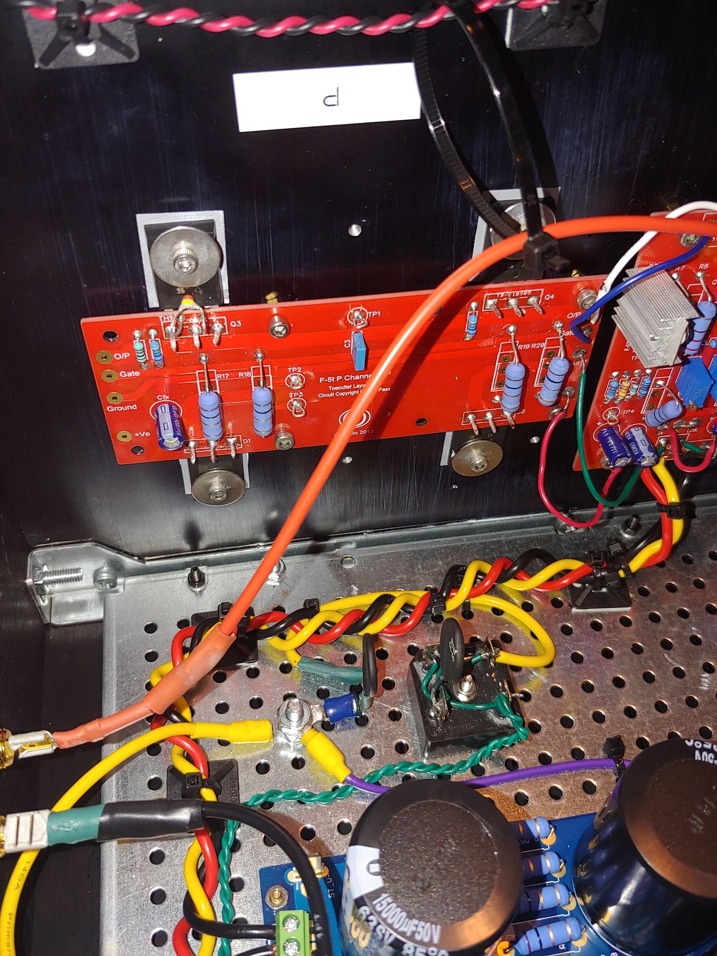

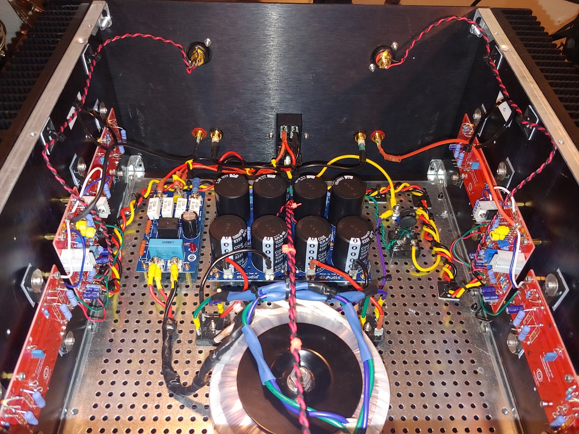

Luckily when I was building the F5 Turbo PSU, I included 'faston' blades for all the + and - inputs on the psu. Check out the photo. It shouldn't take long for me to upgrade the PSU setup. I'll get to it in the morning. Photos to follow.
