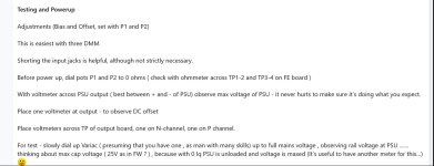

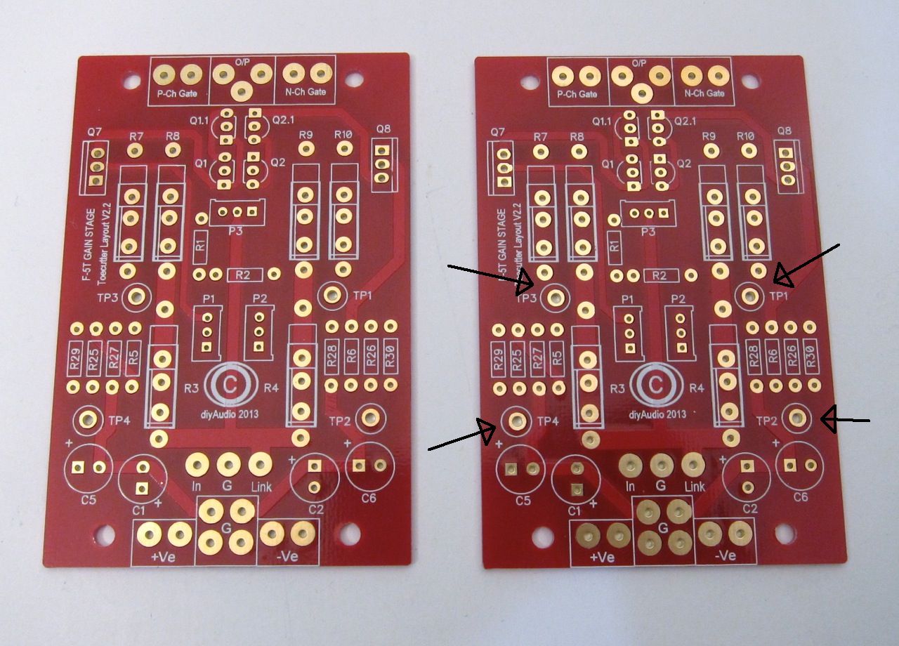

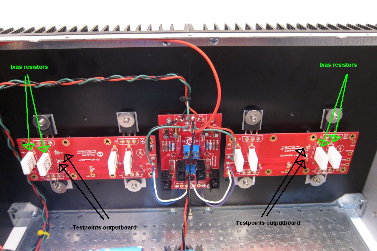

I am still not clear on the biasing. Where in the circuit diagram are TP2 and TP3? I do not see a 0.5 ohm source resistor in the circuit diagram. What ID number is that resistor. Would be very helpful and appreciated if an example to calculate the bias voltage is given.
I assume you are getting this reference from post #1 and/or #2. It's recommended to quote or directly say where you are finding information b/c there multiple sets of test points; one set for the front-end boards and one set for the output boards.
My guess within the context that seems most relevant ... TP2 and TP3. Those test points, I believe, should be the equivalent to measuring across a pair of source resistors on the output boards. Someone with more direct knowledge can confirm. If you have the boards already, you can measure for verification.
Two 1R resistors in parallel => 0R5 - See schematic.
Hello RF Phil,
in the schematic aren't the testpoints. You measure the bias over a pair of 1 Ohm resistors (=0,5 Ohm - as IAIMH pointed out). You measure
the voltage from one leg to the other leg of the bias resistor - or you use the testpoints on the outputboards of the F5T.
And check the resistance between the testpoints of your frontendboard - very important before start-up. This is all described by 6L6 on the first page of this thread.

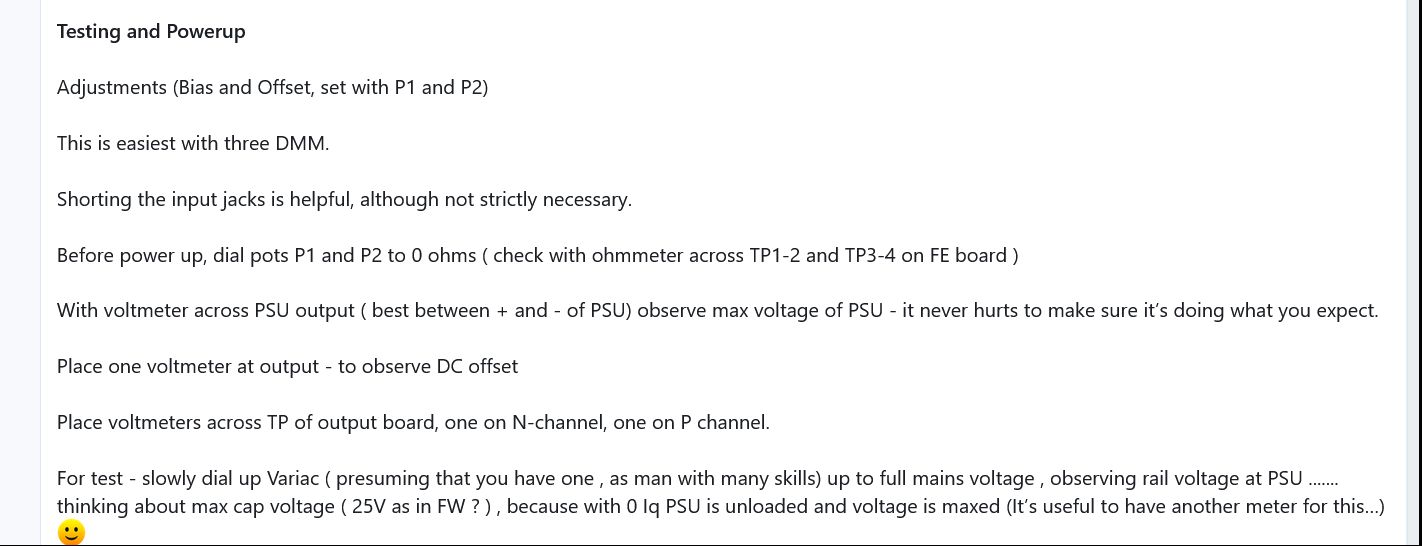

  • Turn P1 and P2 back to where you have 0V at the test points. You can measure the resistance prior to power up also. See biasing procedure posted by 6L6.
  • Start the biasing procedure again. Report back.
Reporting back, I am following 6l6‘s procedure on the first page of this article. I am using the variac bringing up the voltage slowly with multiple meters connected monitoring each. I turned both of my pots P1 & P2 down to 0 ohms on test points TP1&2/TP3&4 on the FE board. I haven’t got to the point of turning the pots for channel A because I haven’t been powered it up yet. Let me add, prior To this blunder, this amp has been working for 2 years flawless. Thank you in advance.
