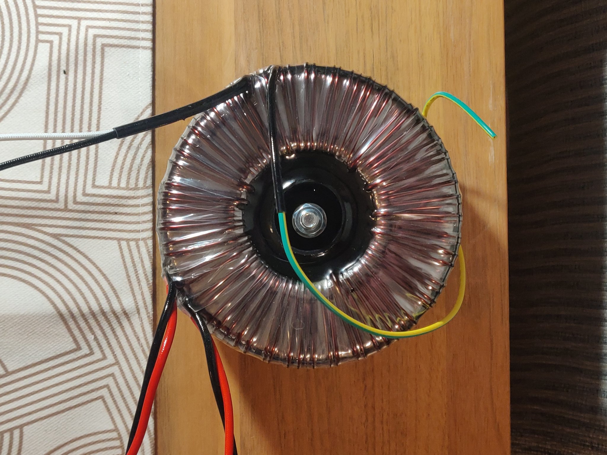

Hi everyone, newbie diy builder here on my first project ever for this F6 🙂
I have stuffed all PCBs and am in the process of wiring the power supply. I realized the transformer I bought only has one set of primary wires (see picture attached: black and white wires). This prevents me from setting up the thermistor as indicated in the schematics. What does that mean in practical terms and is there a way to make it work? Should I just get another transformer with dual set of primary wires?
Thanks a lot for all your past and future comments which are a giant help for beginners like me.
Arthur
That looks like a decent transformer. It Ok to just use a single thermistor in the primary wires (either hot or neutral). I prefer the CL-70 for inlet current reduction. They will get warm in operation.
Thanks a lot for the quick feedback! So just to rephrase I should put a thermistor in series with either hot or neutral wires, and because it's not in a dual primary wires config you advise a CL70.
Make sure you tie the green/yellow safety ground wire to the chassis separately next to where the AC inlet is.
Duly noted, I'll tie it on the chassis, separate from the other ground wires.
