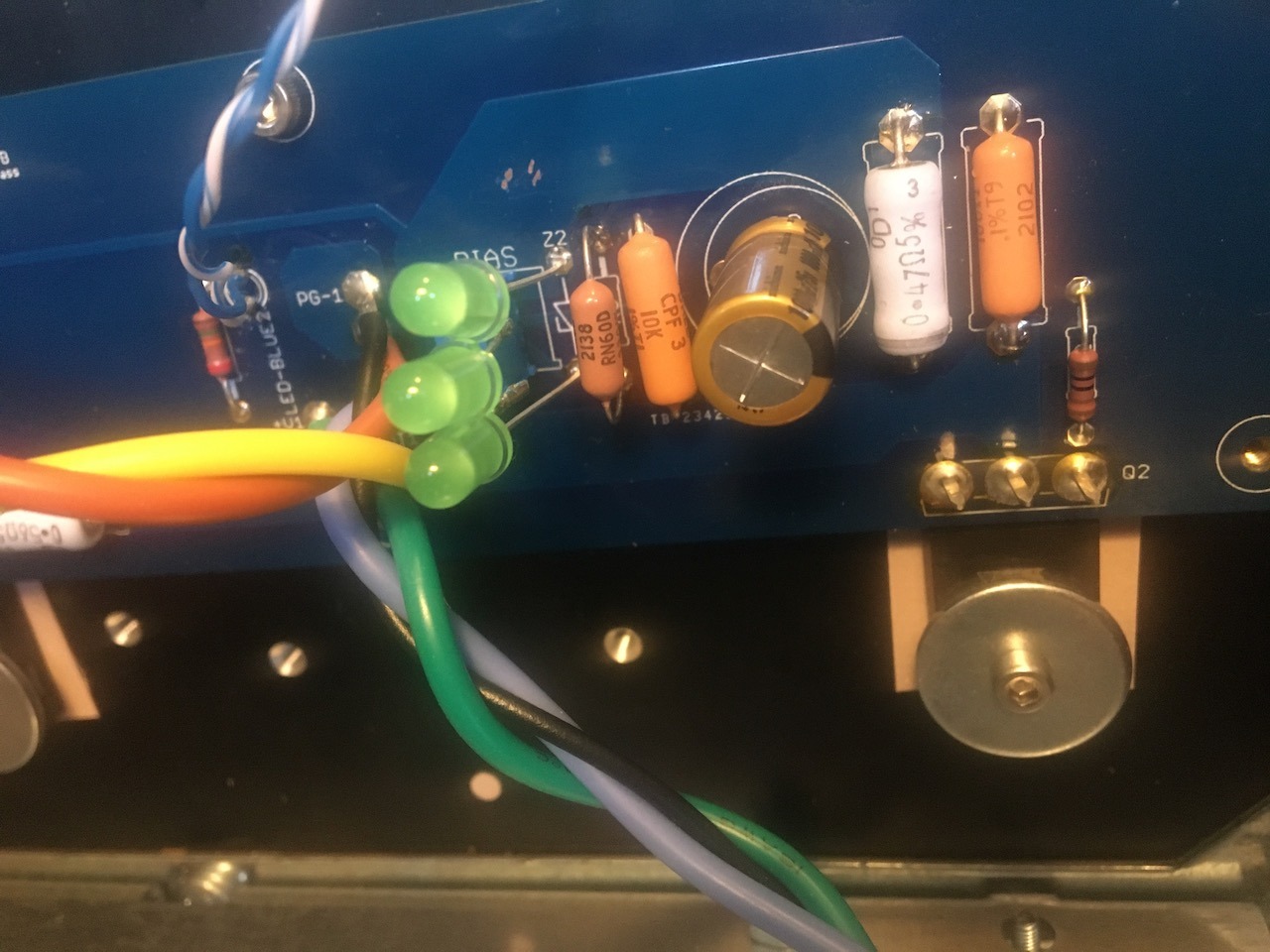

Also I completed the picodumb mod by installing the LEDs but I am still having the problem I just described on startup. All the solder joints are clean and not shorting, all wires are where they should be. I am kind of afraid to leave the amp turned on for any length of time to take measurements while this channel is connected for fear of doing further damage. I'm kind of up a tree. Not sure what I should be looking for at this point.

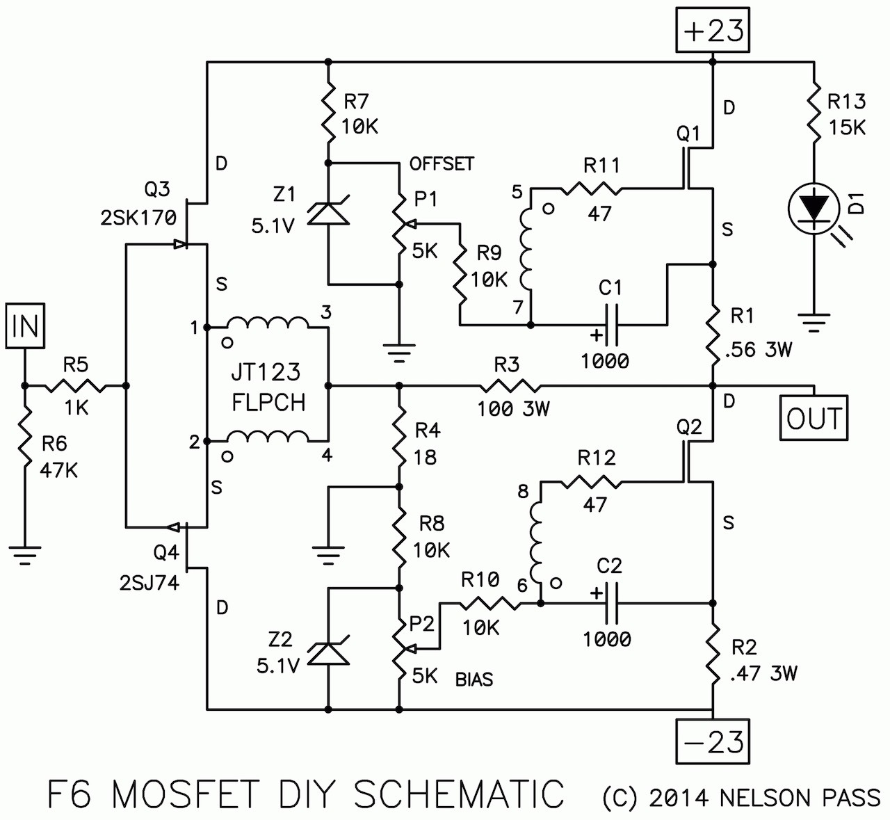

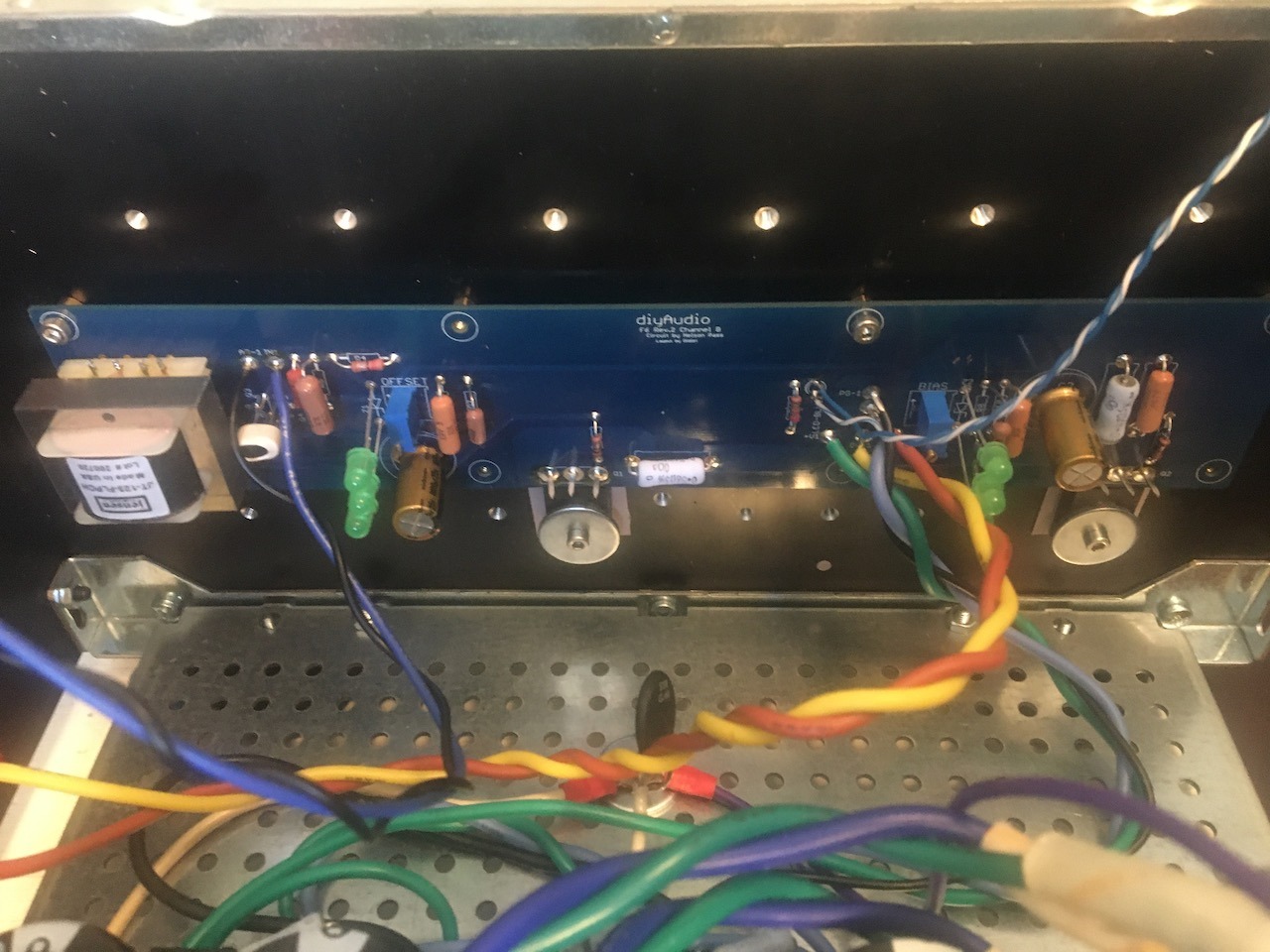

F6 Trouble Shooting
Schematic:
AMP
![Image 4-12-22 at 11.31 AM.jpeg Image 4-12-22 at 11.31 AM.jpeg](https://www.diyaudio.com/community/data/attachments/951/951769-98997dc157eef783f84eba53601a40be.jpg)

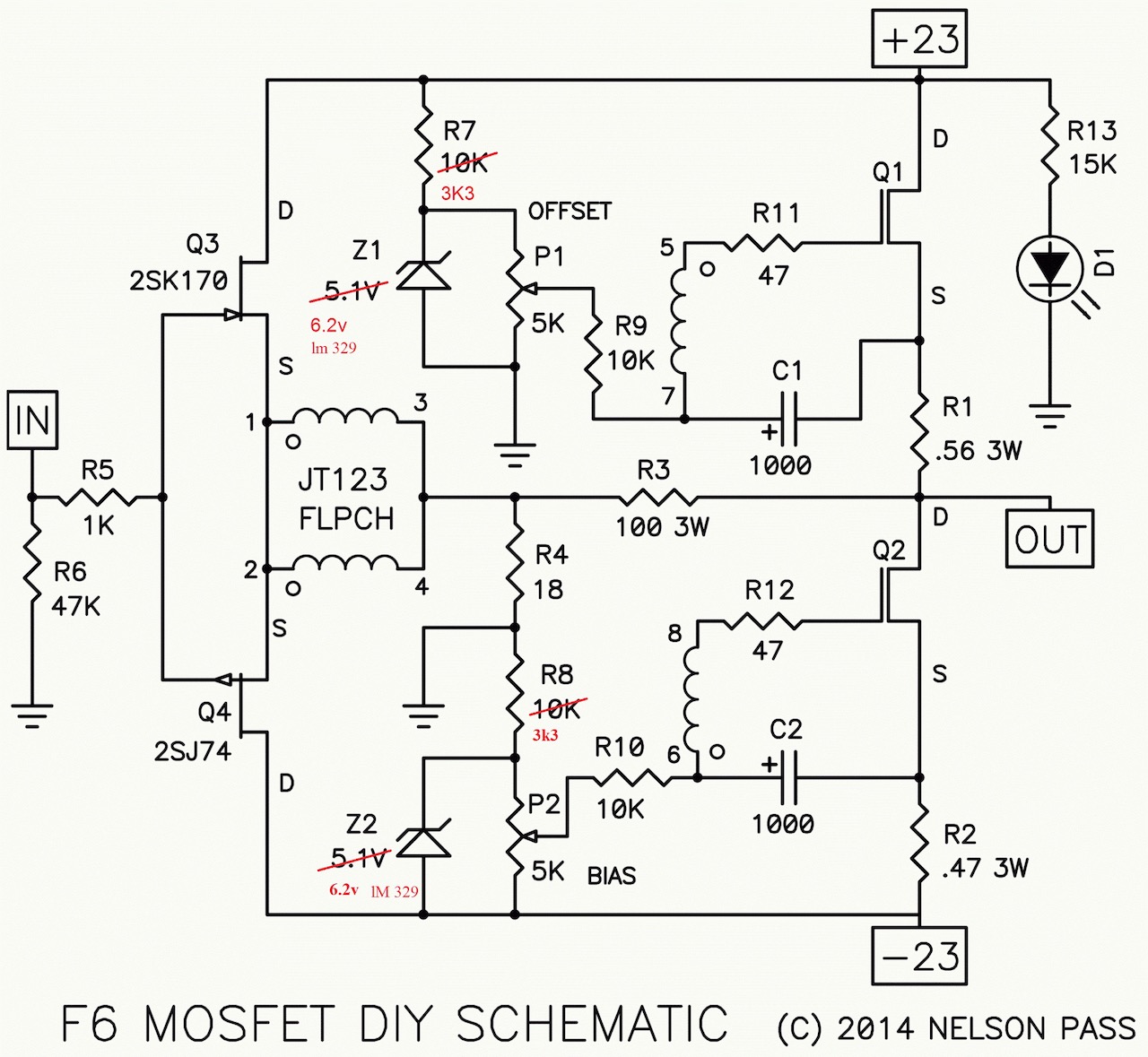

Modified (PicoDumb Mod)
![Image 4-12-22 at 11.32 AM.jpeg Image 4-12-22 at 11.32 AM.jpeg](https://www.diyaudio.com/community/data/attachments/951/951770-f227807f29628d86dcdaf0081b854608.jpg)
Potentiometer setting:
These are Bourn 20 turn 5k pots as in 6L6’s list of materials. Upon startup I learned that turning them counter clockwise allowed more current to flow (decreased resistance). So clockwise increases resistance. You can tell when you reach the end of their range by a small clicking sound they make while being rotated.
Current Situation:
Left Channel is configured as shown in the first Schematic.
Bias (voltage across 0.47 ohm R2) 0.2 v
Offset (taken at speaker leads) .05 v
Right Channel taken after installing 3.3K resistors but before adding LEDs as in 2nd schematic.
Bias (voltage across 0.47 ohm R2) 0.52 v
Offset (taken at speaker leads) 4.71 v
Then one of the slow blow 2.5 A fuses on the AC inlet blew at startup after doing some measurements. The amp was not
on the dim bulb tester at that time.
After fuse replacement the power supply and the left channel seem to behave normally when started with dim bulb tester but when the right channel is added the bulb stays brightly illuminated and I have not allowed the amp to remain on for more than a few seconds. So no further measurements.
Procedure going forward:
If I understand your instructions correctly.
1. Disconnect left channel
2. Remove IRFP 240 mosfets from right board.
3. Power up right board (can be off heatsink) from power supply and confirm operation of pots (measuring resistance up and down) and take voltages across R2 or at mosfet source pin and gate pin and at speaker terminals (bias and offset respectively)
If there are other problems on the board that I have not detected is there a list of expected voltages that I can compare against to pin down the source of the problem?
4. When all is good re-install mosfets, attach to heatsink
5. Startup on dim bulb tester and if all looks as it should move off dim bulb and fine tune bias and offset.
Sound like the plan?
Questions:

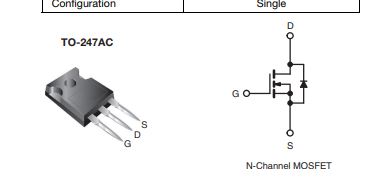

Can I expect the 3 LEDs to light when the mosfets are removed? Despite careful effort , they did not light during my brief startups following installation and might need to be reversed. But right now they may not be lighting because of another as yet un-identified problem in the circuit.
The Mosfet gate pin is the middle one, I believe? How can I be sure which is the source pin on Q1 and Q2? Is the source the one closest to the resistor R1 and R2 respectively?
Pics:

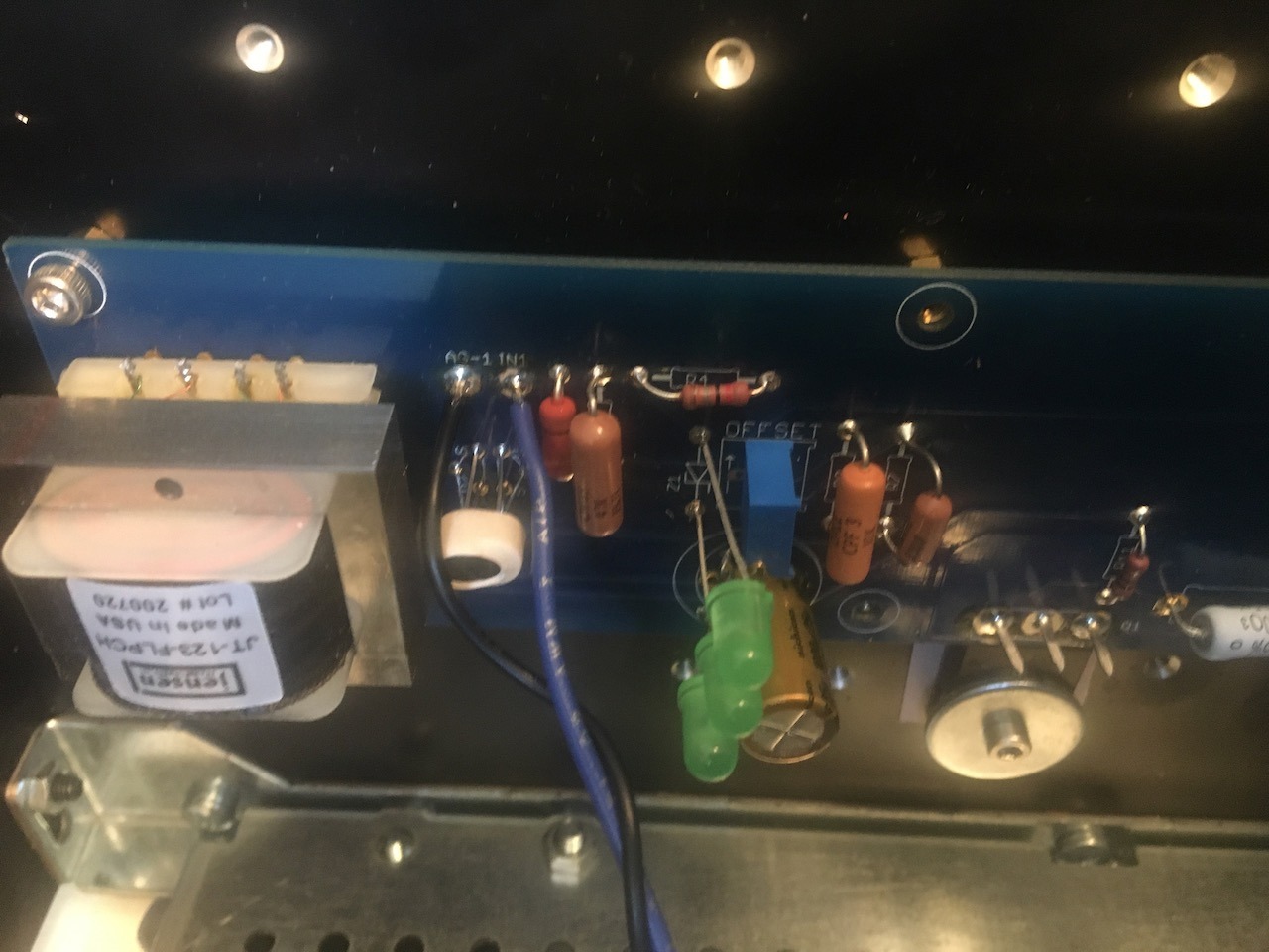

Here are some pics of the board under consideration:
![IMG_1377.jpeg IMG_1377.jpeg](https://www.diyaudio.com/community/data/attachments/951/951773-5da13f5f96d7a6add54e767b5edbde13.jpg)
![IMG_1376.jpeg IMG_1376.jpeg](https://www.diyaudio.com/community/data/attachments/951/951772-e3b0586f96fa887e57c215849c278c0b.jpg)
![IMG_1375.jpeg IMG_1375.jpeg](https://www.diyaudio.com/community/data/attachments/951/951771-f8aabe2bfc2805168a8bfc5fb93a55c8.jpg)

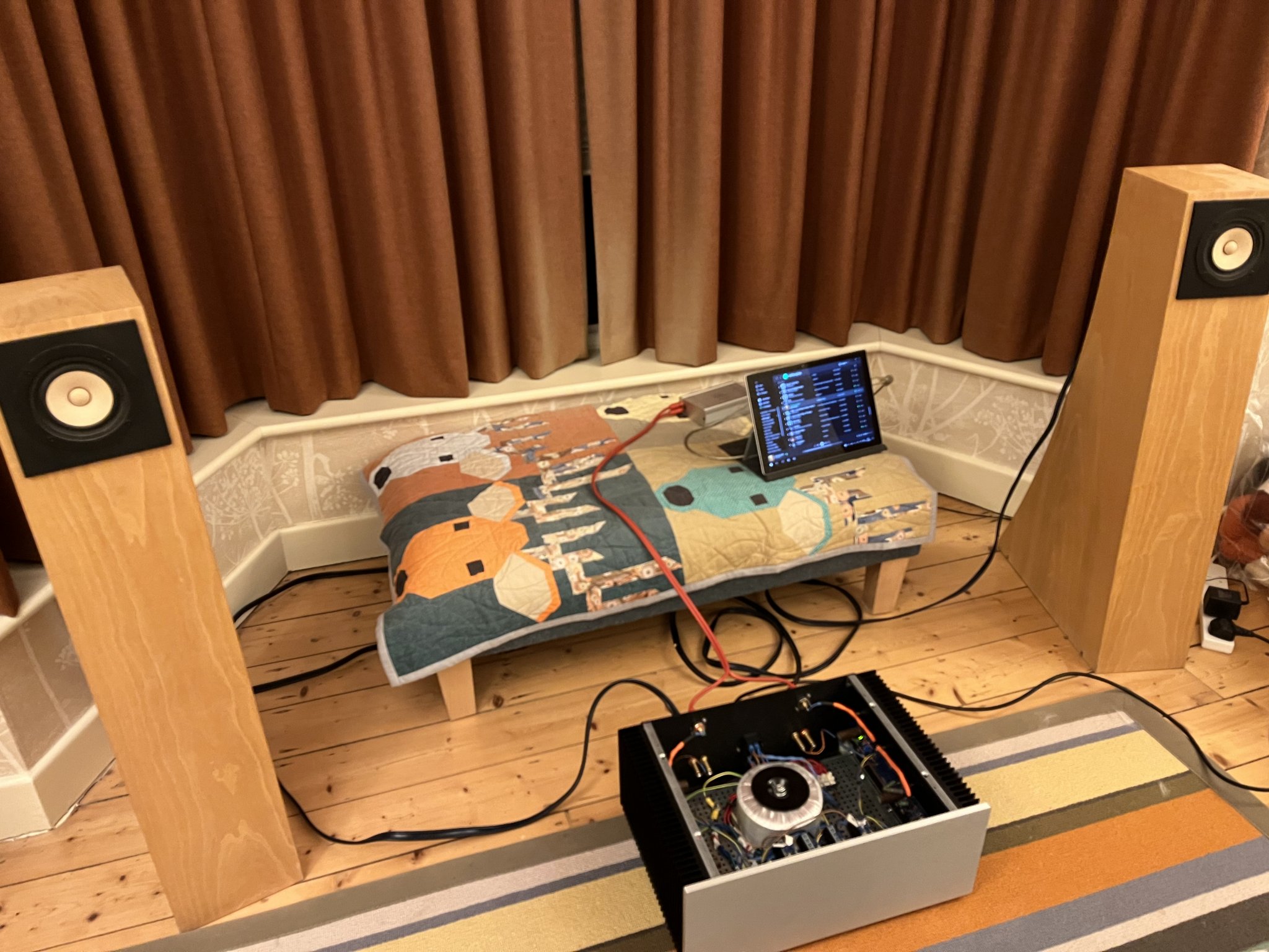

A topless glamour shot for you, sod the early night!
Spotify through the DAC into the amp, volume on the computer. FH3s with CHP drivers (not on optimum position and will epically fail WAF, but the boss is away). The bass is amazing 🤩 currently mellowing out with The Dead.
A bit of cable tidying and rebias to nearer 0.60 and fit the posh feet. I will post in the completed builds. 👍🤩😎😁

Bruce, you should also test the mosfets since they weren't properly attached to the heatsink and you had a blown fuse.
Your step 3 above should be by measuring the voltage across the two outer holes for the gate and source pins. But before that you need to fix the string of LEDs to that they light up and that you measure about 5-6 volts across them.
And you need to turn down both P1 and P2 so that the voltages across the gate/source pin locations are low (close to zero).
