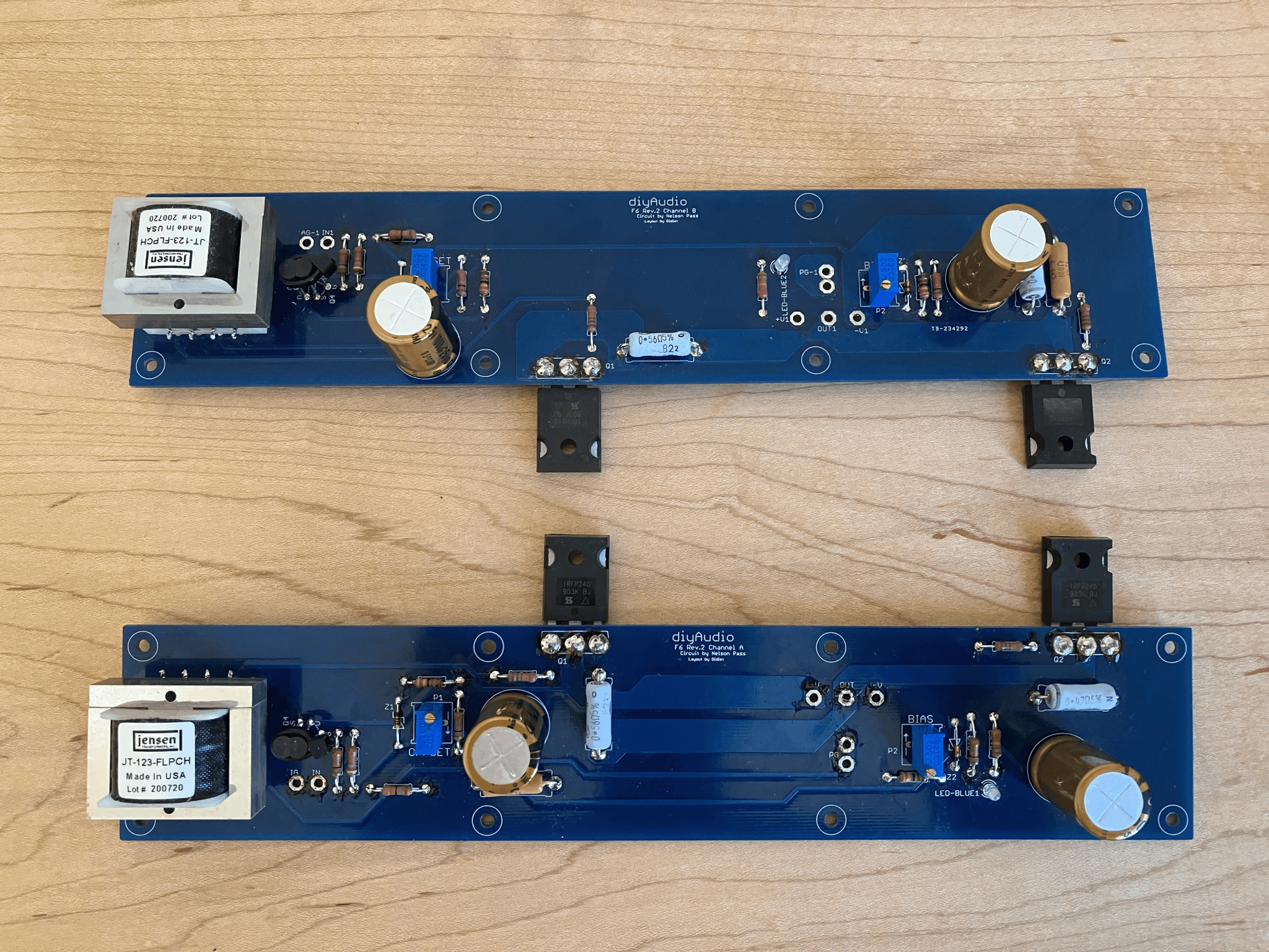

Then install the 2nd set of F6 boards to try balanced:
![tempImagewq4CRt.gif tempImagewq4CRt.gif](https://www.diyaudio.com/community/data/attachments/953/953533-686db8cdea98437673dfd497d00ea02b.jpg)

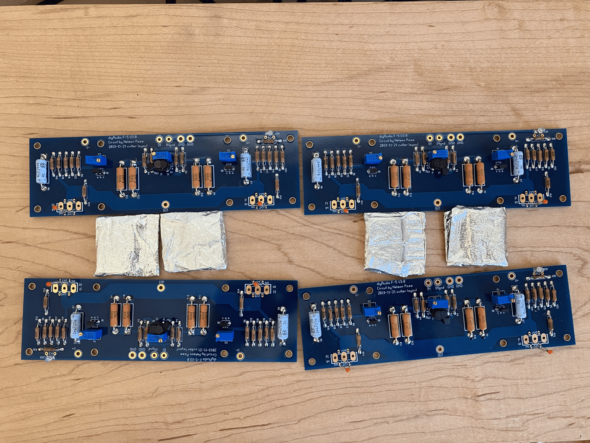

And if that doesn't work (i.e. too much offset I can't adjust for or don't like the bass response) then throw some F5 boards in to try:
![tempImage1kwitS.gif tempImage1kwitS.gif](https://www.diyaudio.com/community/data/attachments/953/953534-b1b72e07594103b7ae148850ebb09f5b.jpg)
And I'm still contemplating a pair of F4s but would need a voltage source.

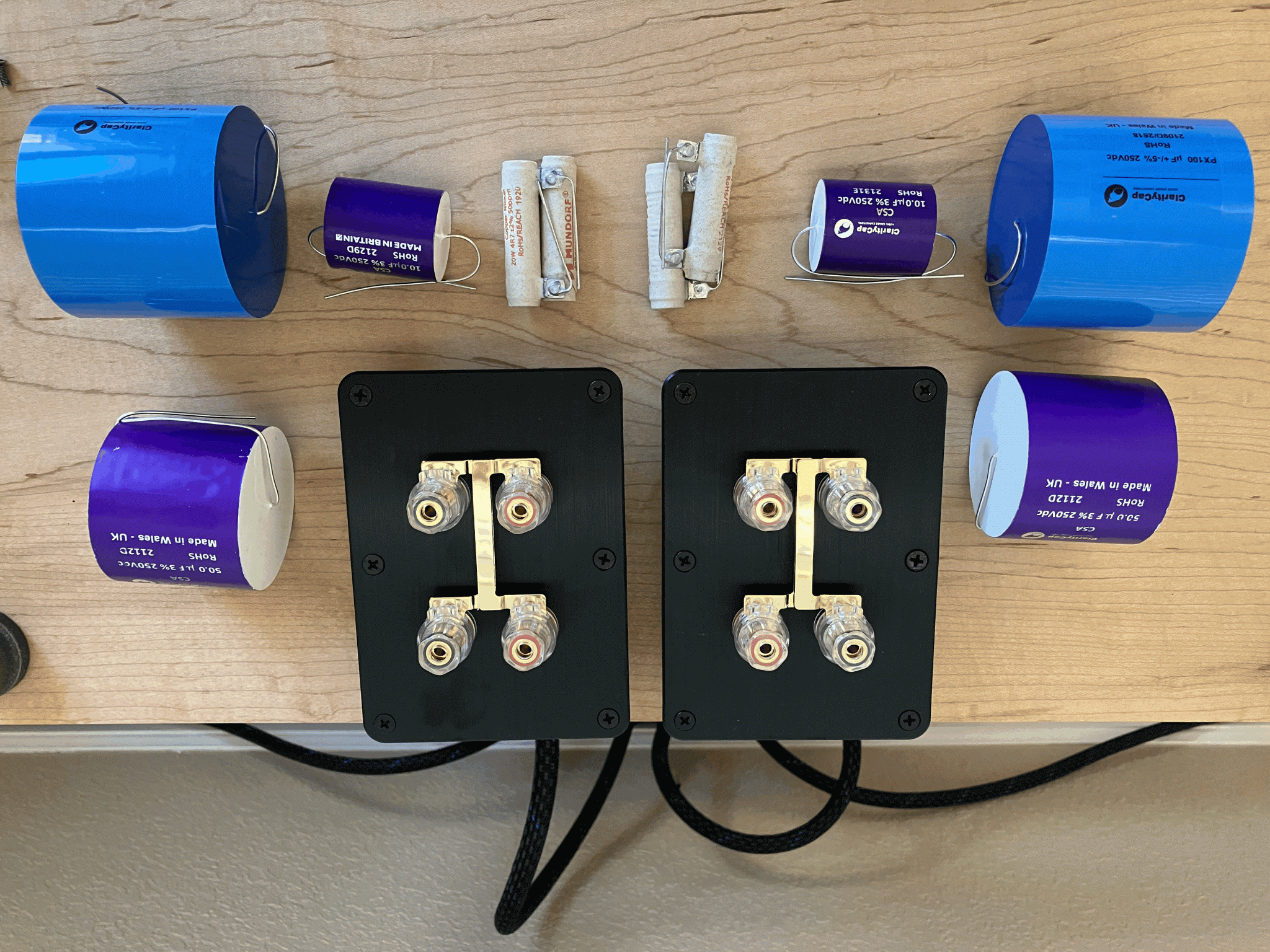

While I'm contemplating the F4s, going to upgrade the crossovers in my Halcyons (still needs some big coils):
![tempImagerr1Ngm.gif tempImagerr1Ngm.gif](https://www.diyaudio.com/community/data/attachments/953/953535-42a91d67324fdeee3a26d1ee2cf026b7.jpg)
Then after all that, with all the channels of amplification I'll have, contemplating active crossovers on the halcyons.

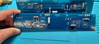

Hello,

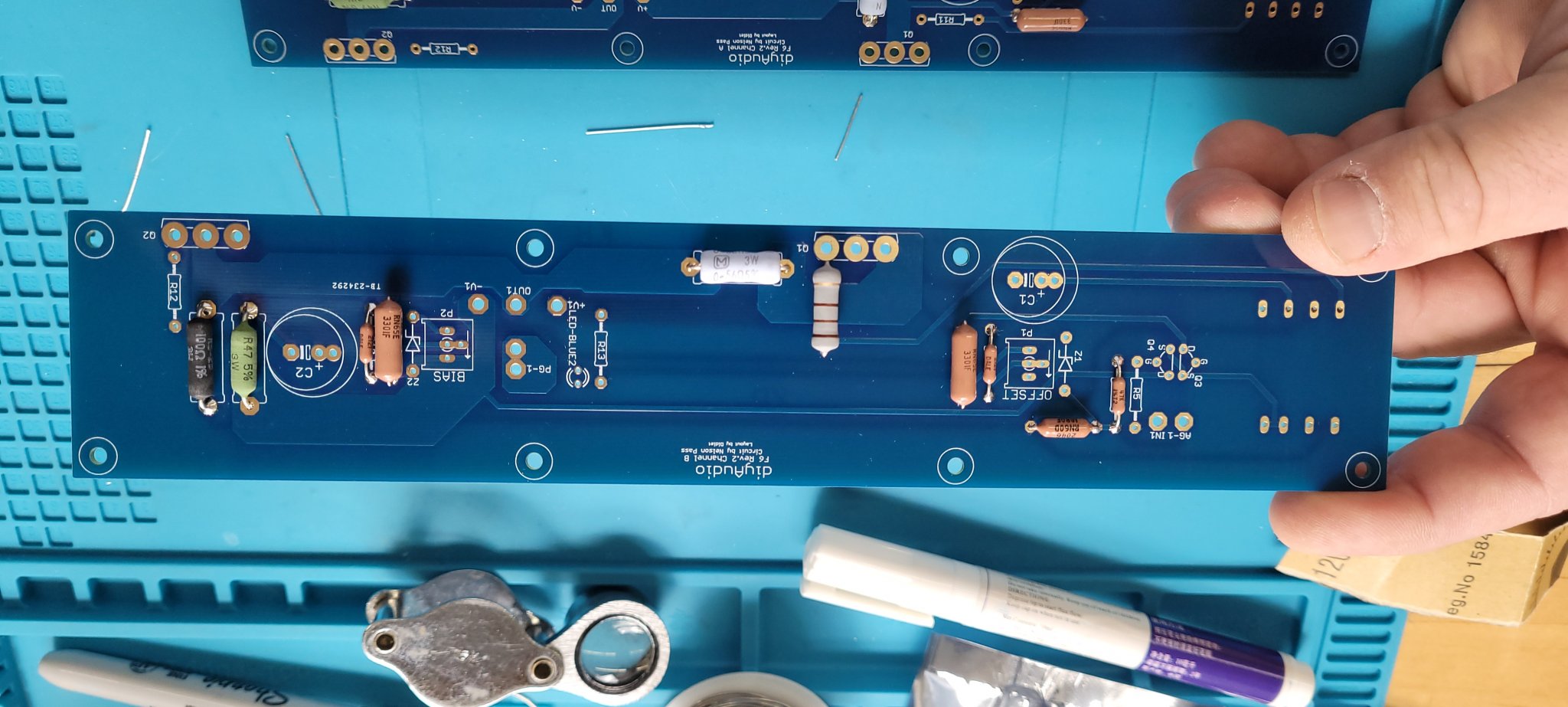

I'd just like to ask a question before I proceed. You'll notice in these pics that some of my resistors are much larger than it appears the board planned for. I had to get creative bending. I guess I ordered a higher wattage than I needed to. Aside from not being necessary, is this an issue. Im trying to learn as I go but I'm just painting by numbers right now. I was successful with a TU-8500 and then B1 Nutube preamp which emboldened me. This is certainly a bit more technical, but I figured if I'm careful I'll be alright.
Thanks in advance
Thanks in advance

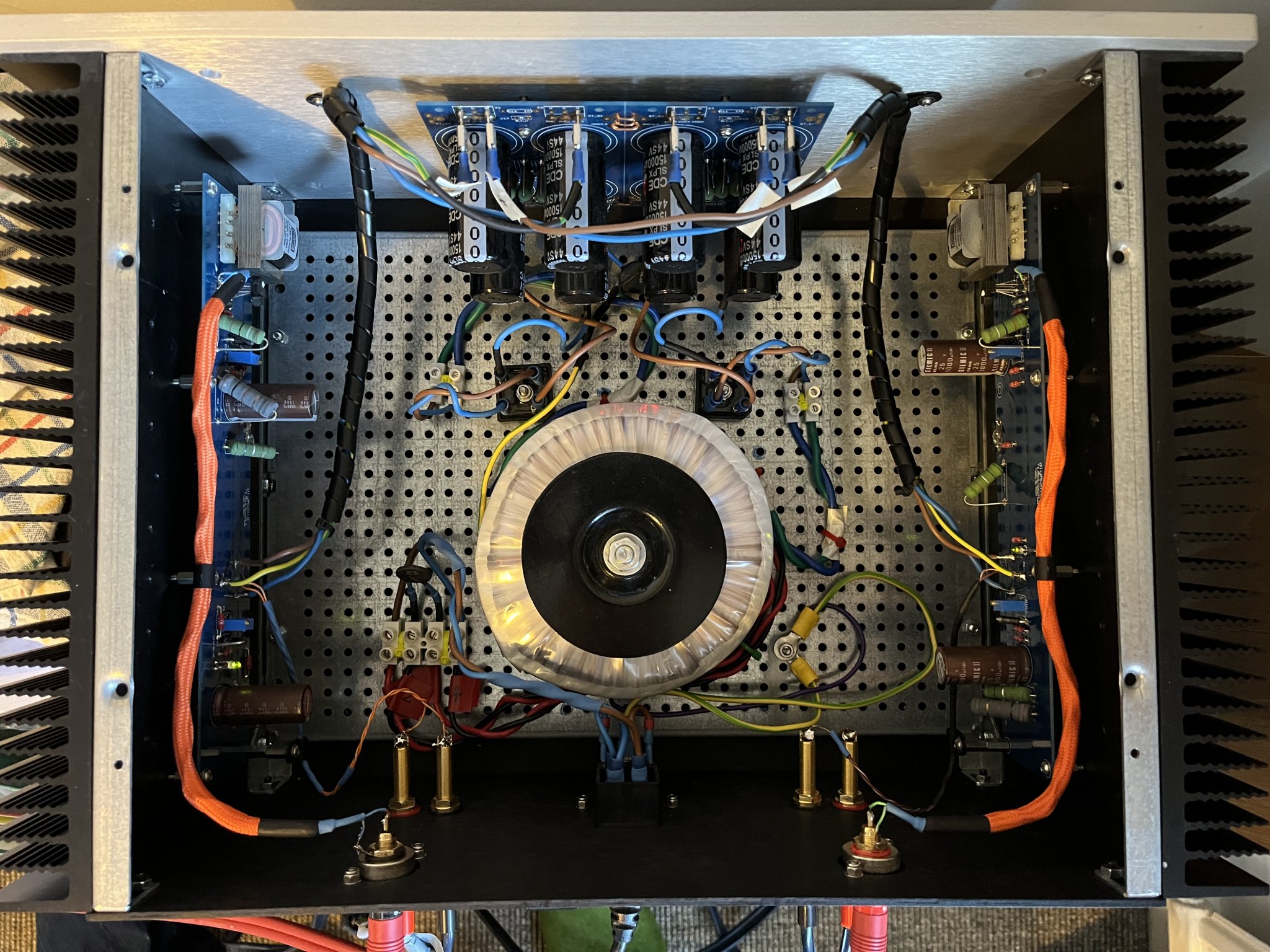

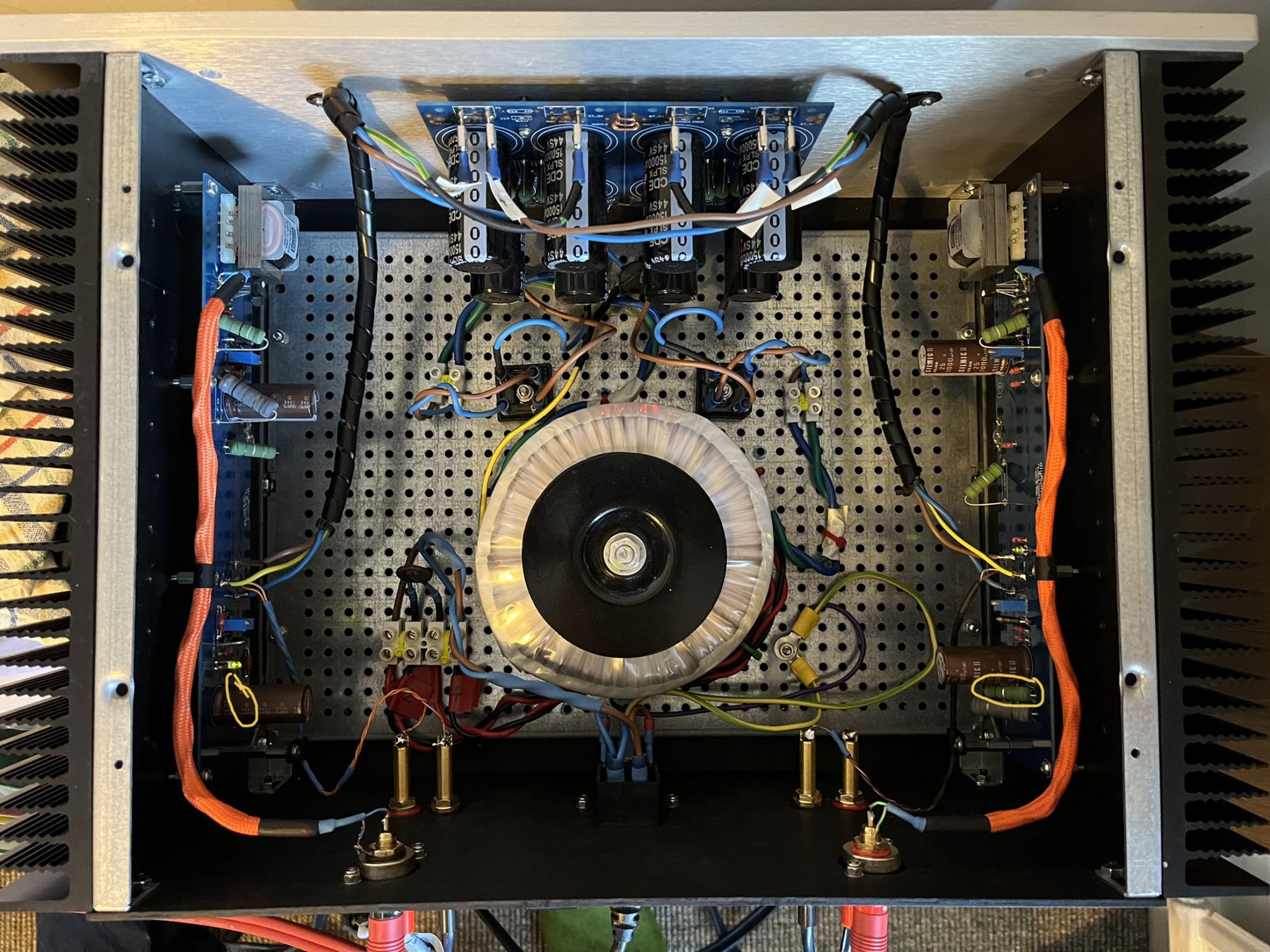

Hey folks, a quick update and another thanks. finishing this has made be disproportionately happy this week 😁
I’ve tidied some cables, but I need to address the transformer and that was a pain to fit. I might talk to a pal to help make me can or a couple of L brackets to stand it up and shield it. I can hear a buzz if I stick my ear over the case and the same tone coming through the drivers. it’s not loud and you have real close to notice. The cables outside are a rats nest too. So a bunch of thing to address in slow time.
Bias is even, 0.604/0.00 on both sides. It spent about 10 hours at 0.500/0.00 last week and the increase in bass is amazing since raising it. Well not just bass, it’s all bigger. The heat sink is about 42 degC but I’m getting mixed temps on the 2nd pin so loathed to increase the bias at the mo, until I get a better way to measure temp (I’ve got heat transfer paste on the thermistor).
I really am super stoked about it. My good lady has passed comment too, so results and plaudits all round.
Hats off to papa and the gang on here.

Yes. The (unmarked) R2’s… left hand side under the cap at the back and on the right hand side the green resistor against the cap at the back.Congratulations on your build Alistair.
Just want to check one thing: You mentioned a bias of 0.6V, can you confirm that's 0.6V across the 0.47 ohm source resistor?
1.3A bias current is a reasonable place to start. After using the amp for a while, you can try increasing the bias to 1.8A. The “standard amount“ is where you feel comfortable with heatsink temperature.
I run mine at 1.8A and +/– 26V rails. The green LED voltage ref tweak is intended to allow the amp to rach stable thermal equilibrium a little faster at higher bias.
I might have to look at the green LED mod, but tbh I might just listen as is. It’s in a sub par set up in the corner of my office and it’s blowing me away…1.3A bias current is a reasonable place to start. After using the amp for a while, you can try increasing the bias to 1.8A. The “standard amount“ is where you feel comfortable with heatsink temperature.

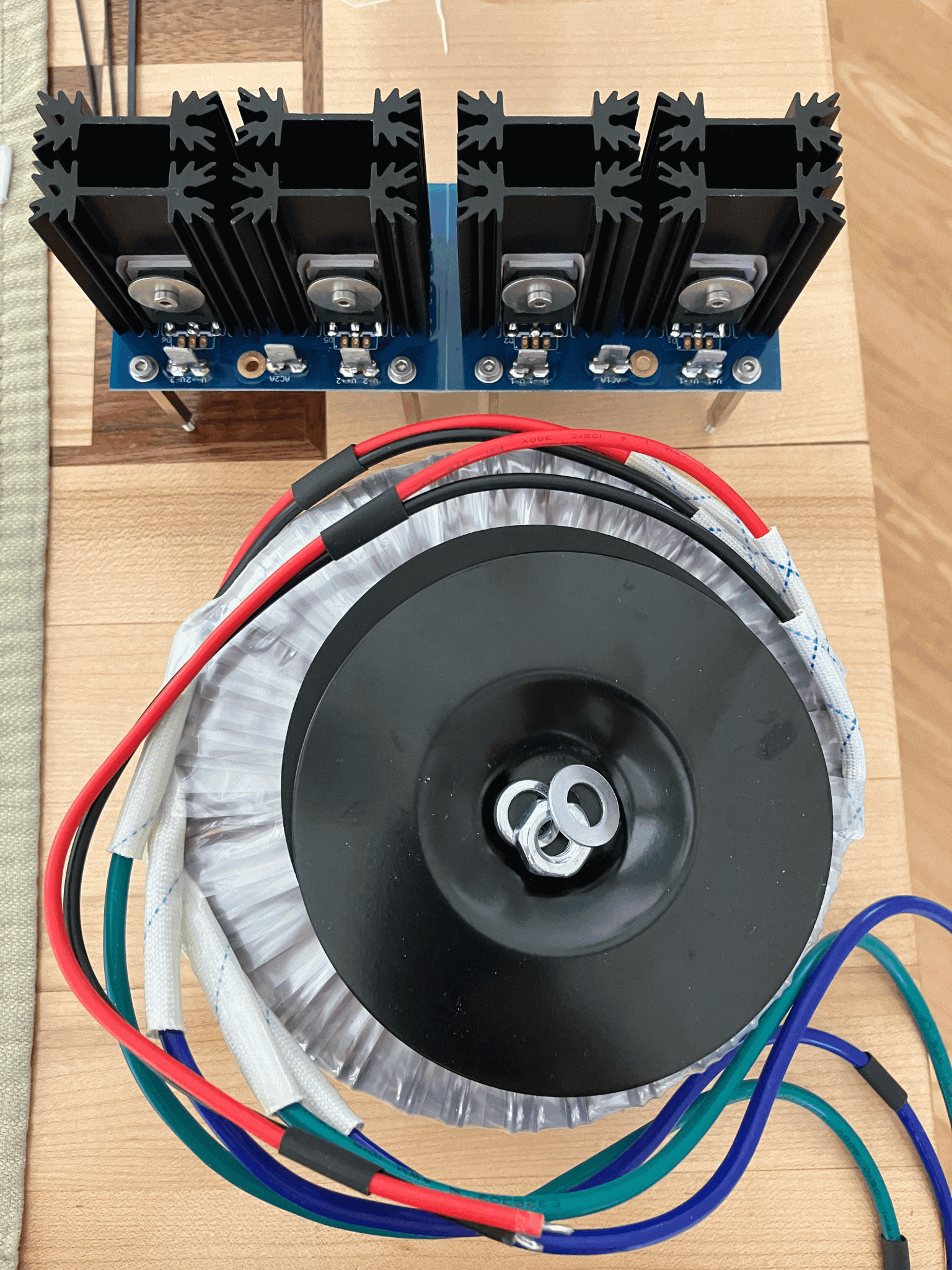

Hi folks,
Had my F6 up and running since last weekend (biased beautifully to about 0.6v, 0v offset) with the transformer simply plugged and resting outside the chassis while waiting for an L bracket to arrive. The amp sounded amazing (so much better than the Prima Luna I've been listening to...).
Yesterday, upon receiving the L bracket, I drilled the baseplate and fixated the transformer vertically after trimming its secondary leads. Things went very bad from there: turning the amp on I noticed the PSU and amplification LEDs kinda wavered strangely before shutting off. Then went back on very brightly... Before shutting back off. Now the amp won't turn on (guessing the fuse is out, have to confirm tonight).
While the amp was on, I managed to check voltages across PSU rails and things looked rather normal. AC on these was a good bit higher than when I measured the PSU unloaded, which seems like expected behaviour.
My intuition tells me it's a short, do you have any recommendation as to how to start the troubleshoot? First time builder here.
Thanks in advance 🙏
