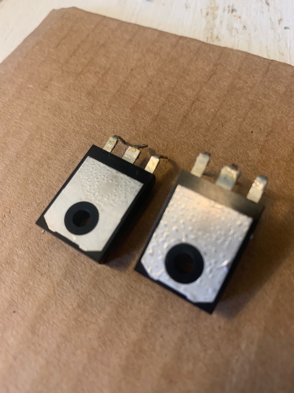

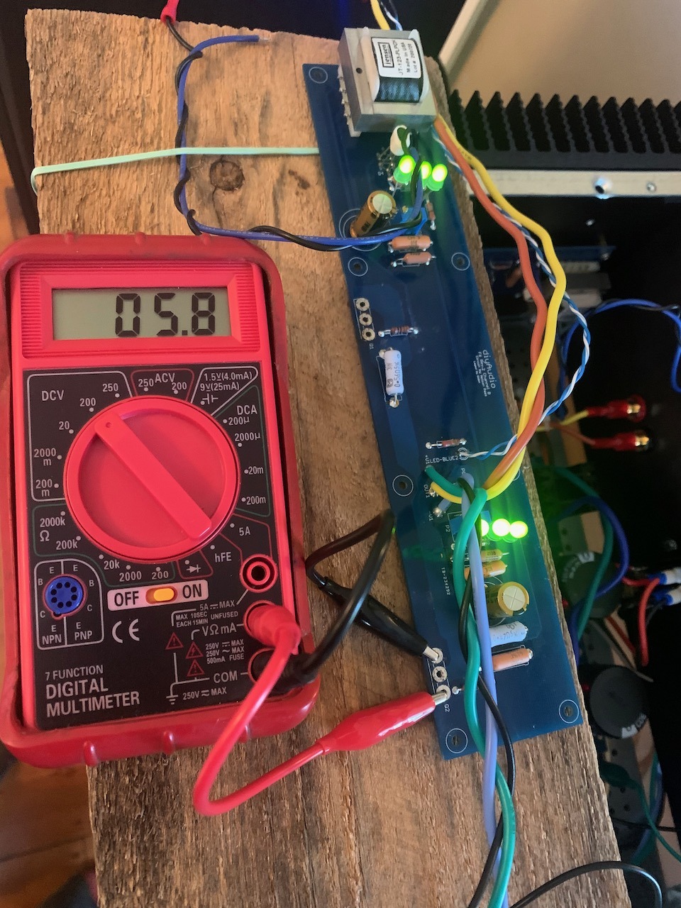

I pulled the two Mosfets last night, which may I say was a bitch of a job, getting three pins clean that close to the board, even with a desoldering tool and solder wick. In the end I found that by holding them with a handkerchief to protect my fingers from the heat I could melt and wiggle, pin by pin leaving a weakened solder joint that eventually gave way. I have not tested them yet but I ordered some new ones today since I suspect if they were not damaged to begin with they almost certainly are now!
Anyway, powered up the board, got the leds all to light and measured voltage across the gate and source of Q1 and Q2, both could be made to range from 0-5.8v by adjusting the pots, this was on the dim bulb tester so I expect voltages will increase off the tester. Voltage across the 3 LEDs 5.8. Things are looking good. Will test the Mosfets later but the undersides are a bit bubbled which does not bode well🙂 See pics.
Once again muchas gratias for your guidance.

Getting new mosfets is the right call. Anything showing thermal damage like that should not be used.
Happy that you can get 0 to 5.8V adjustment with the pots. I suggest you leave them in the 0V
positions before you install new mosfets.
And before you start on your left channel mod, also please turn down P1 and P2 so that the mosfets are off
so you don't have to worry them after the mod.
Have fun.

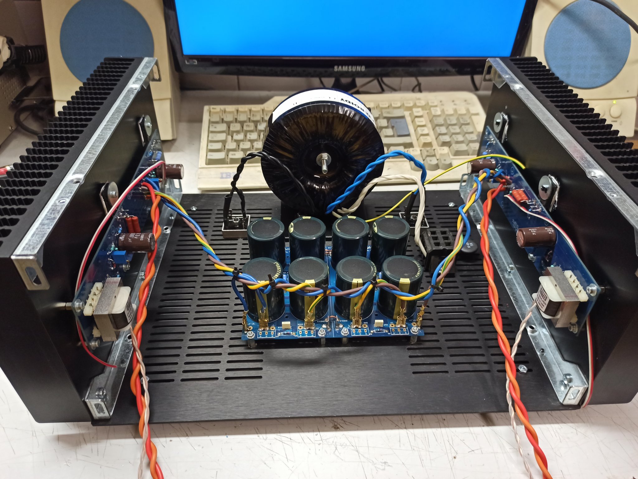

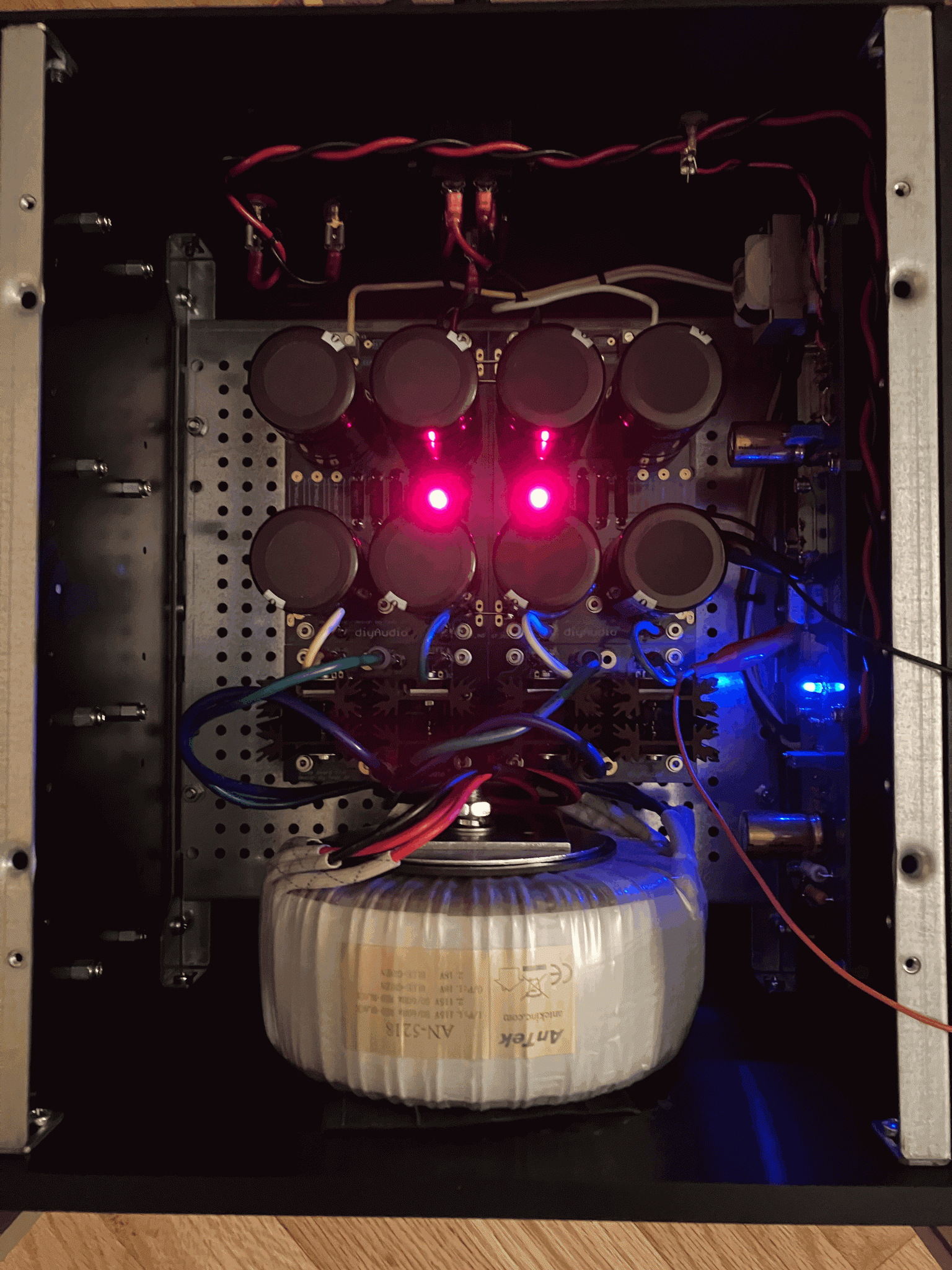

If anyone has been tracking my build, just up'ed the game on the PSU. Put in an Antek 500VA transformer and the diyAudio PSU board rectifier section in prep for monsterblocks. Real estate is getting tight.
Interestingly, the PSU output sits right at +/-24V as opposed to the PSU it replaced (Hammond 220VA transformer w/ discrete bridges) that sat at +/-26V. The bias on the transistors has shifted from 600 mV down to about 580 mV. Did not touch the pots in the install process. Offset is as much 0 as my Fluke will measure. Will rebias tomorrow morning after I let it sit some more.
Getting the right channel PSU swapped out tomorrow, I hope. Maybe next weekend will add the second set of boards to attempt balanced "monsterblocks" Will see what the offset is like between the + and - "channels" and decide the input/output configuration on the rear panel.

I pulled the two Mosfets last night, which may I say was a bitch of a job.
I desolder the legs until I can get one to move (wiggle the mosfet and watch the legs. I then load up the other two legs with solder, heat both legs with soldering gun at the same time and wiggle the mosfet out. Still a pain, but the best way I know of so far. Holding the mosfets with your hands makes it so you don't overheat the mosfet. Although they are very tough. I use denatured alcohol to cool it down if needed to.
Best of luck!
What you had in #3729 were monolithic bridges. What you have in #4137 are bridges with discrete diodes.
A couple potential reasons for the voltage change are different winding ratios between the transformers and/or a higher voltage drop through rectification.
Seems like a tweak of the bias, and you're ready to keep the covers on. Thanks for posting all the progress and questions. What a fantastic reward for sticktoitiveness. Two fantastic amps. Congrats! 😀
