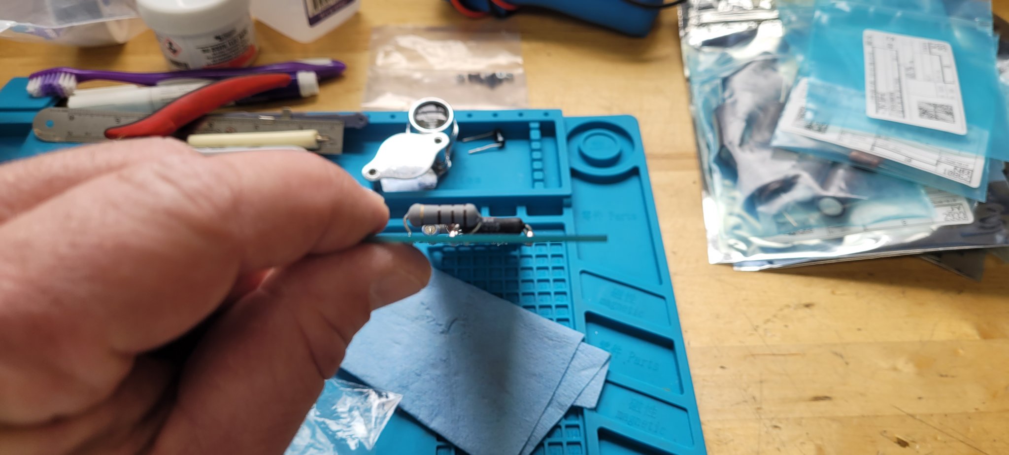

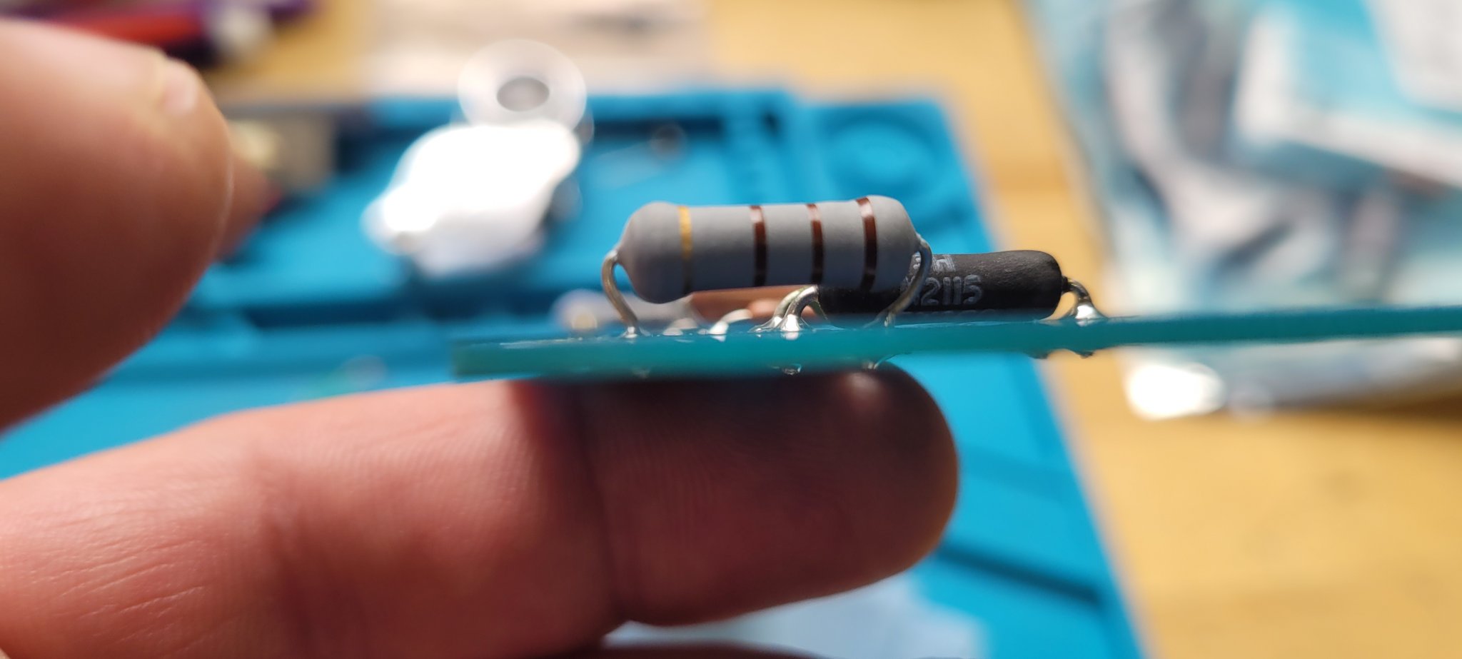

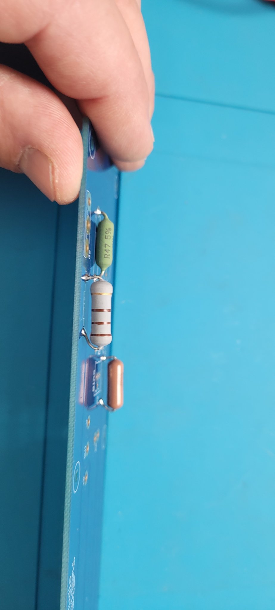

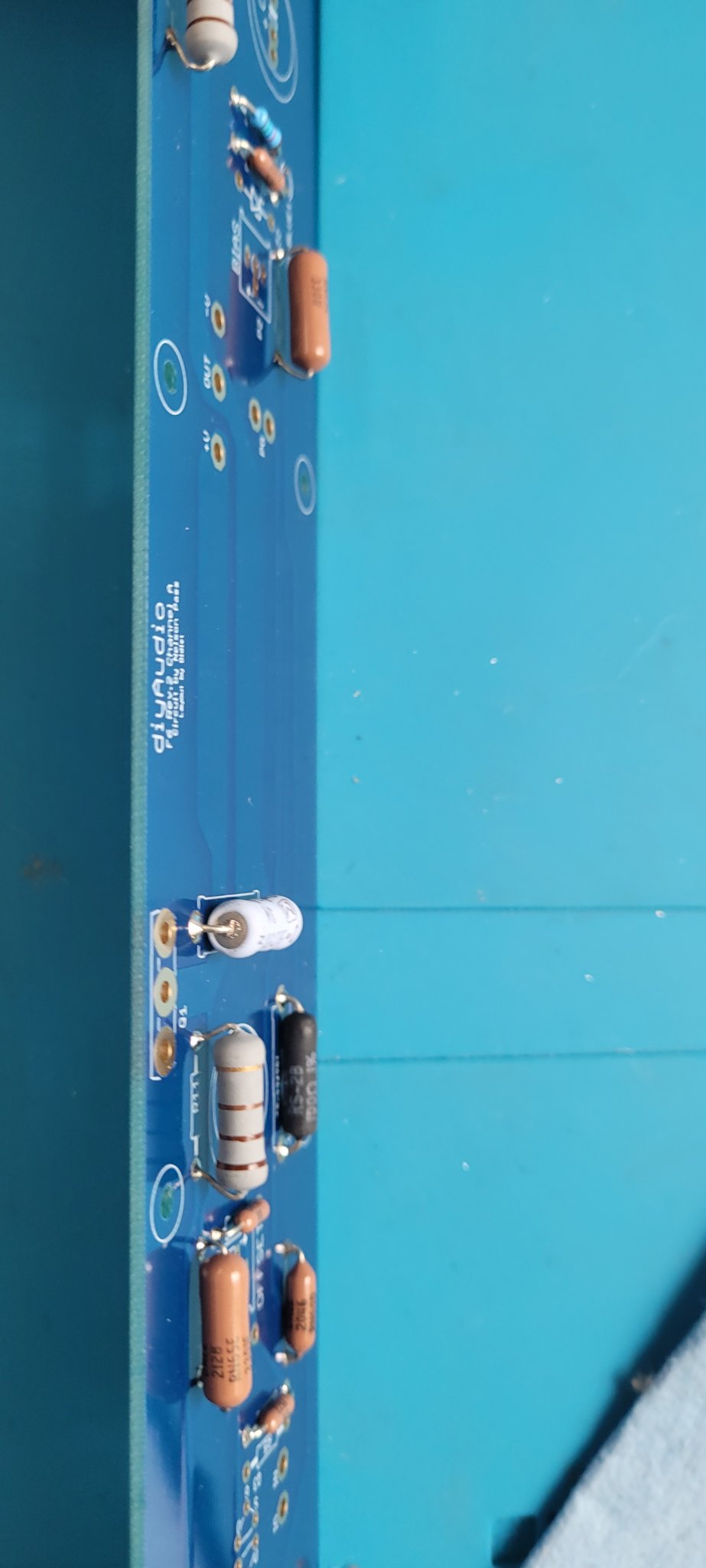

I'd say " one more question " but that would suggest I'm almost done. So, another question. I seems soldering resistors so they touch the board isn't the best idea due to heat concerns. In the future I'll hold them off, but will these be an issue. And are any of the wild bends I have in these leads an issue. I would just rather correct now rather than compromise what I hope will be a great end product.

I don't think it will be a problem. I don't know of anyone having any issues with bending leads unless the outer coating cracks etc. Most resistors on the board will be close to ambient. The 3w resisters (source etc) get pretty warm but should still be okay. It is however good practice to elevate the larger resistors a little bit.
I believe 6L6 has chimed in that he has not had "scorching" issues on the 3W resistors. I think the issue dates back to the old paper-based PCBs that didn't handle heat. I don't know what the coating was but I remember learning the hard way to raise the resistors as they would melt the coating and char the paper. I've not noticed any issues with, what I assume to be, glass-epoxy boards like diyAudio sells. Of course, mine have only been running for a few months now.

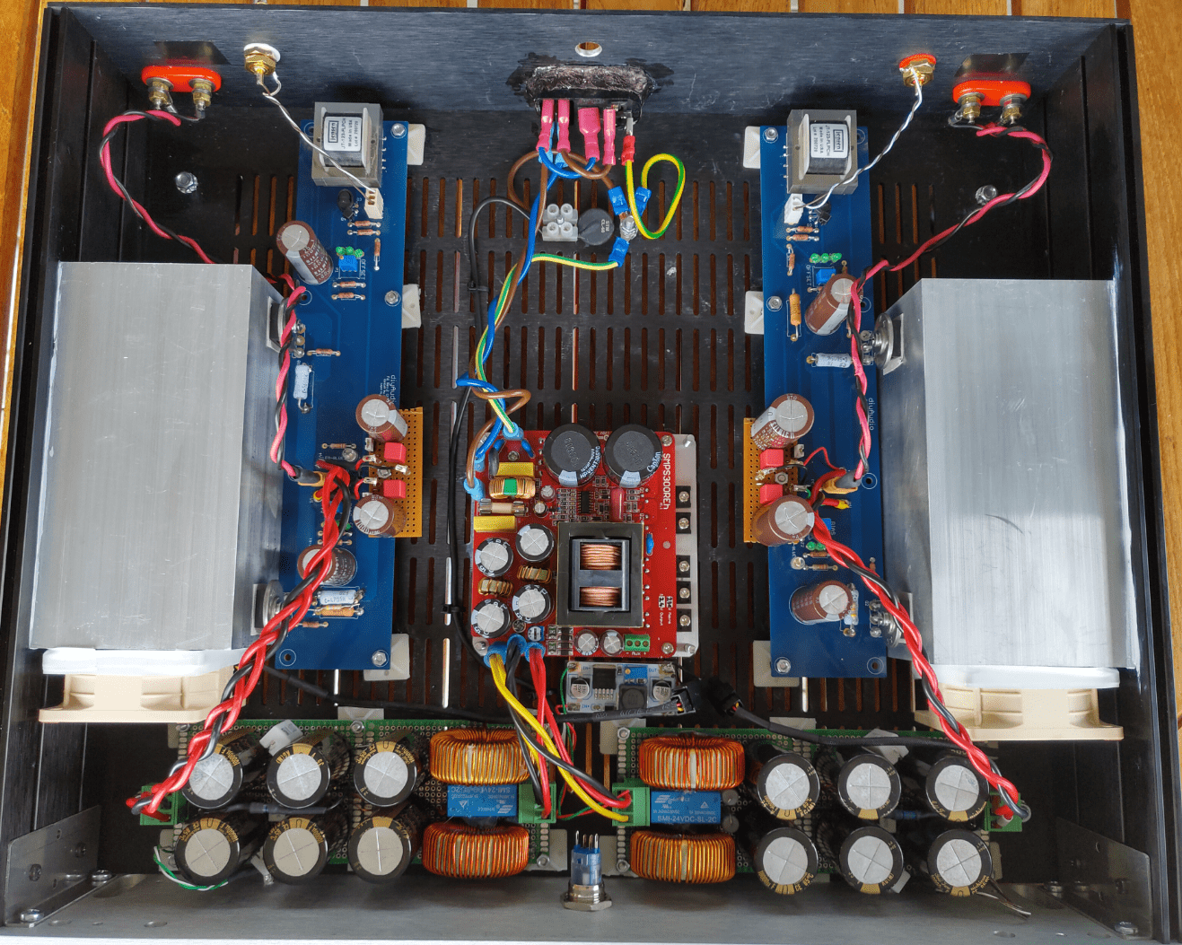

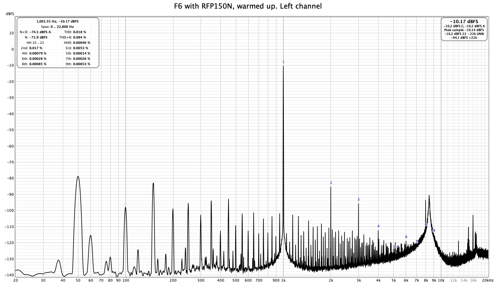

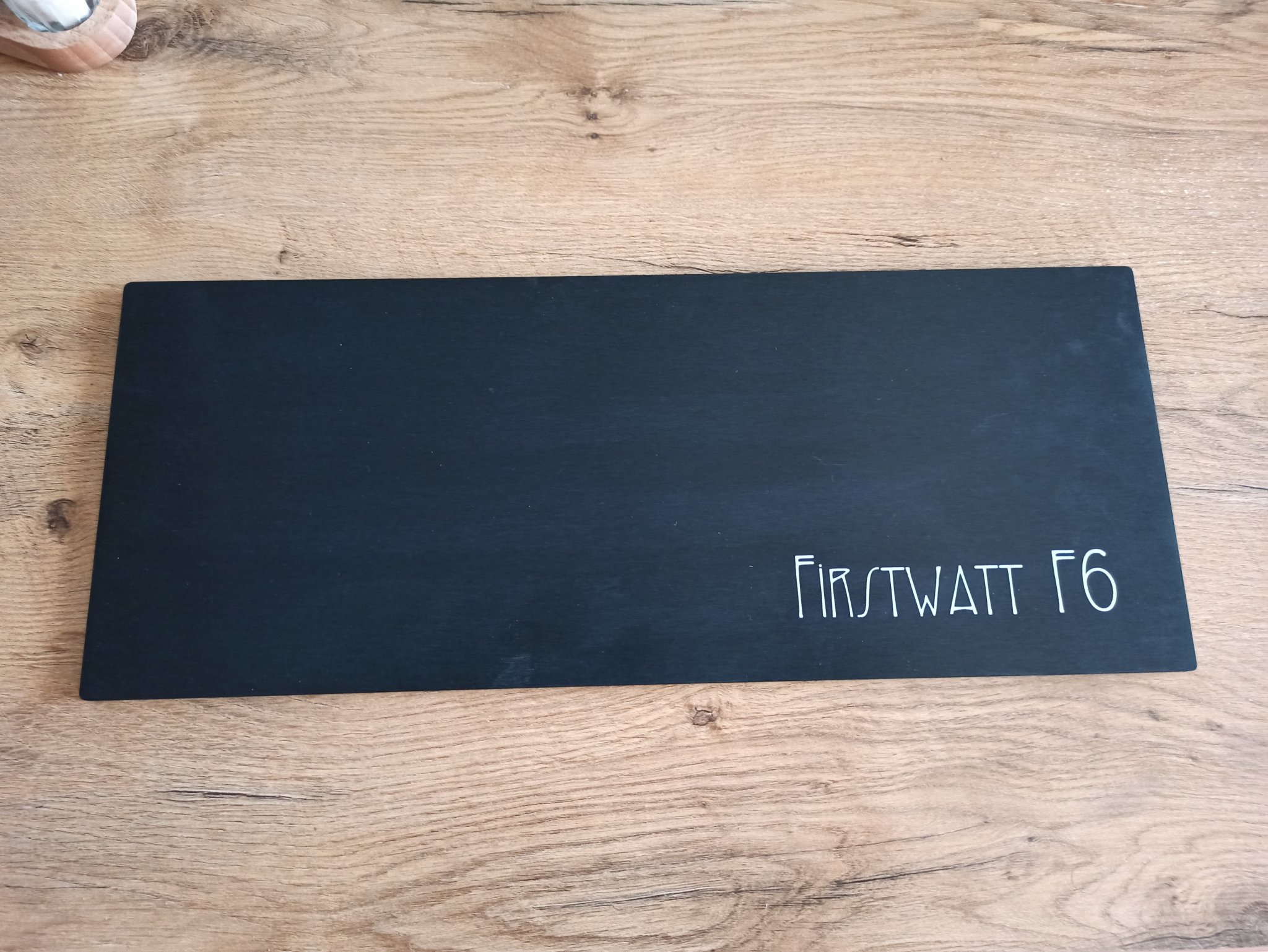

I finally completed the rebuild of my F6 today and I'm very glad I did that!
First off, replaced the cheap Chinese SMPS by a Connex SMPS300REh, then replaced the FQH44N10 mosfets with IRFP150. Also, I added a small card with extra caps directly at each of the F6 circuit boards. How much of a difference this makes is debatable, but I have the option to easily disconnect it for testing.
Replacing the mosfets was inspired by a test by @Mikerodrig27 (post #4035). I can only attest to his findings, the FQH44N10 has bass control to die for, if that's your thing, but fairly shallow mid and top end. IRFP150 has imaging, better soundstage and top end. The difference was very obvious when comparing with my ACA mini. It is still early (been running the F6 for two-three hours total). Now the F6 is on the path of putting the ACA mini where it belongs, in my study.
Objectively, using FQH44N10 gave slightly higher distortion levels and near equal 2nd and 3rd level harmonics, with IRFP150 the 2nd level is higher than the 3rd. The strange peak at about 8-9 kHz could be artifacts from the SMPS (just a guess from me). That peak was substantially higher with the old SMPS. Now the peak of the right channel is higher than the left, this correlates with higher levels of HF noise for the right channel (why?).
I will play with the power supply a bit more to see if it changes.
I couldn't stand it and got some desoldering practice. Things like that can haunt me. Especially if it sounds great, which it will if I do my part, I'll be thinking just that slight misstep will shorten it's life. Was actually good practice and it didn't cost much.

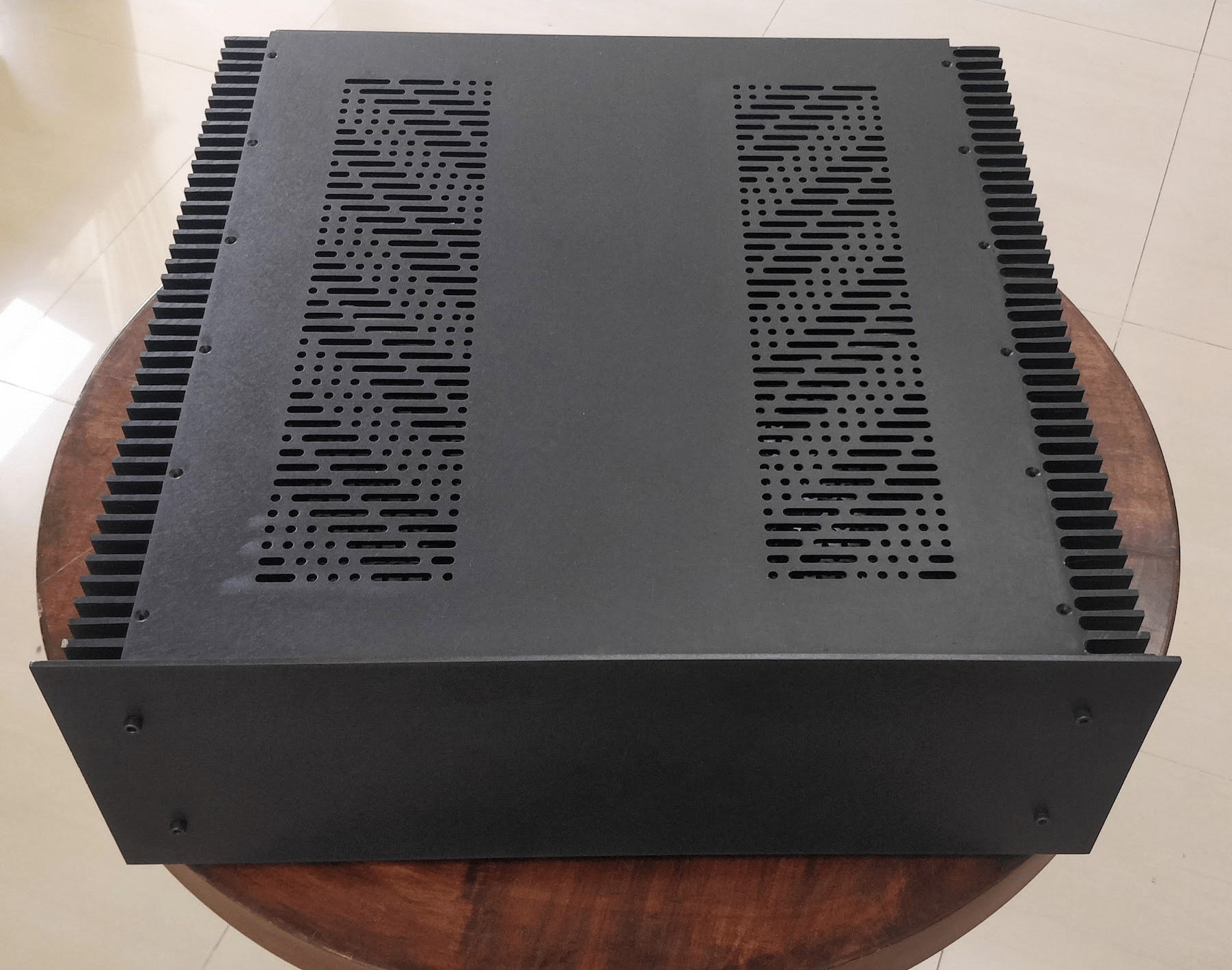

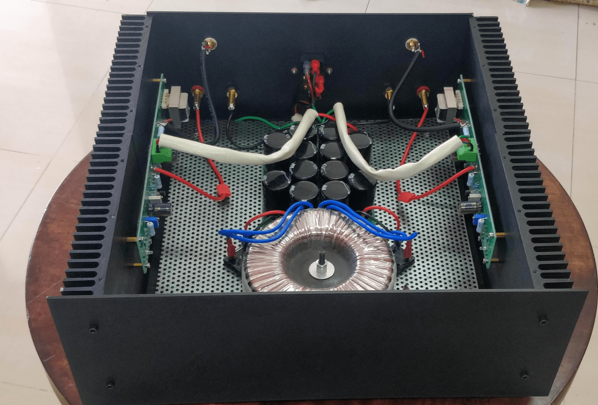

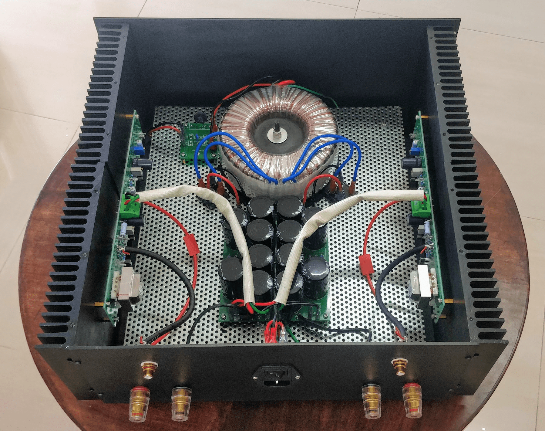

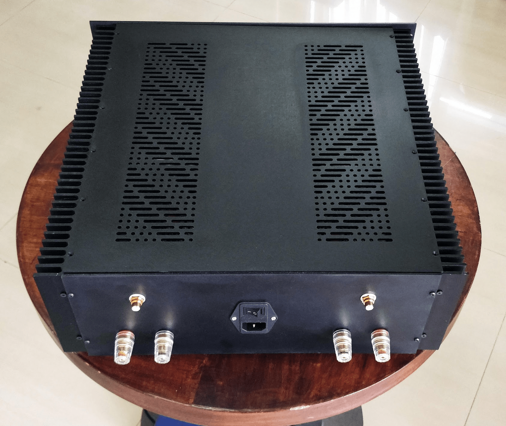

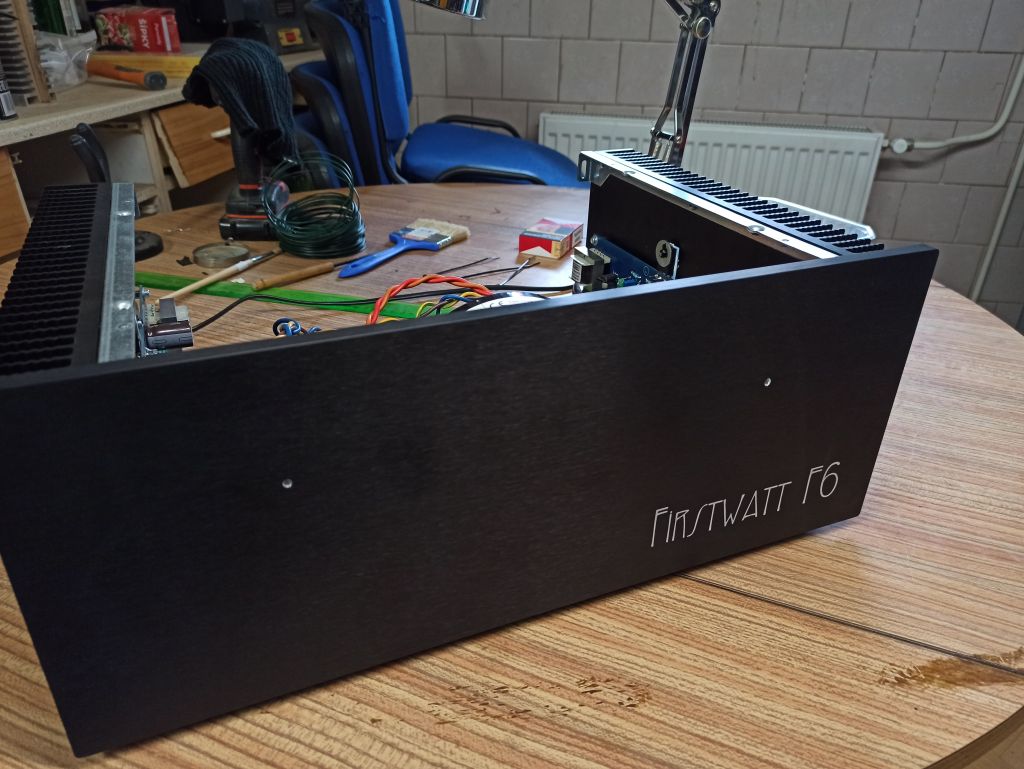

Finally completed my F6 build. This is my first FirstWatt DIY amp. A huge big thanks to Mr. Pass for sharing his design and the entire commumity here whose posts helped me and your builds inspired me. Thanks to @6L6 for the illustrated guides. I'm very glad I built this. The amp is super silent and sounded wonderful right away. Not sure if it gets better as it breaks in. Folks were not kidding when they said it gets hot. Right now it's peak of summer here with temps reaching 42C and I can barely touch the heatsinks for a sec!
The enclosure is DIY since importing the one from Modushop was getting very expensive. That turned out to be quite challenging it took the most time. It's aluminium and anodised.
Couple of questions
1. I've noticed that the bias voltage slowly keeps rising. When I set it at around 0.52V after 30 min of running I noticed that on cold start the bias is just about 0.47V and then slowly climbs up. Is this fine or should I set it so on cold start it is 0.5V and let it rise from there?
2. I've read that the offset won't remain steady at 0. It also seems to creep over time. What value is considered bad?
Sharing some pics..
Couple of questions
1, Bias alters as the amp warms up fully, it is somewhat temperature-dependent. So as long as it does settle, and not rise too high, all is fine.
2, As long as the offset is not hundreds of Mv, it's not a major problem. It should stabilize as above (eventually.)
