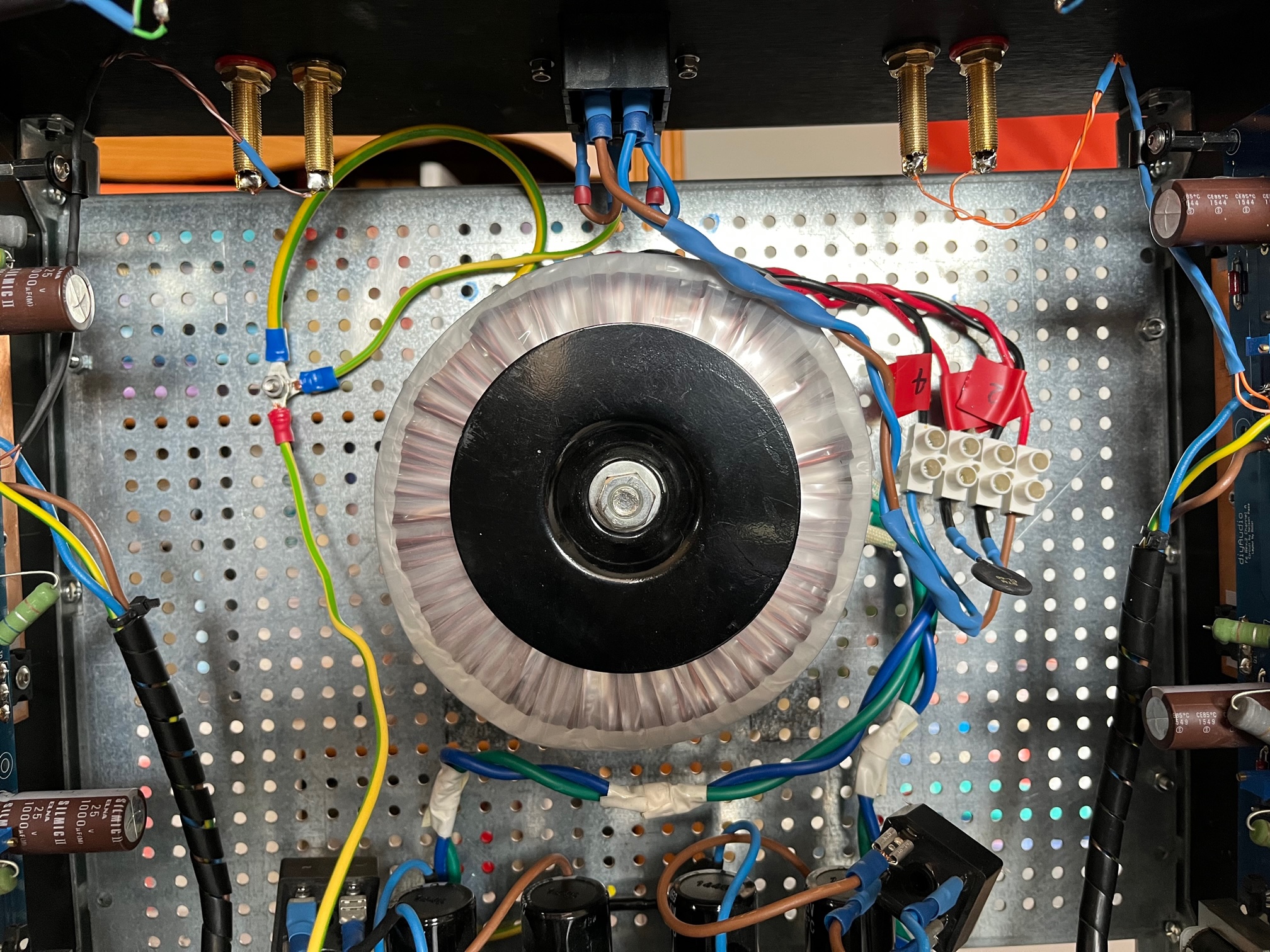

Hey folks, so I have enjoyed 2 weeks enjoyable listening. I return with a few niggles.

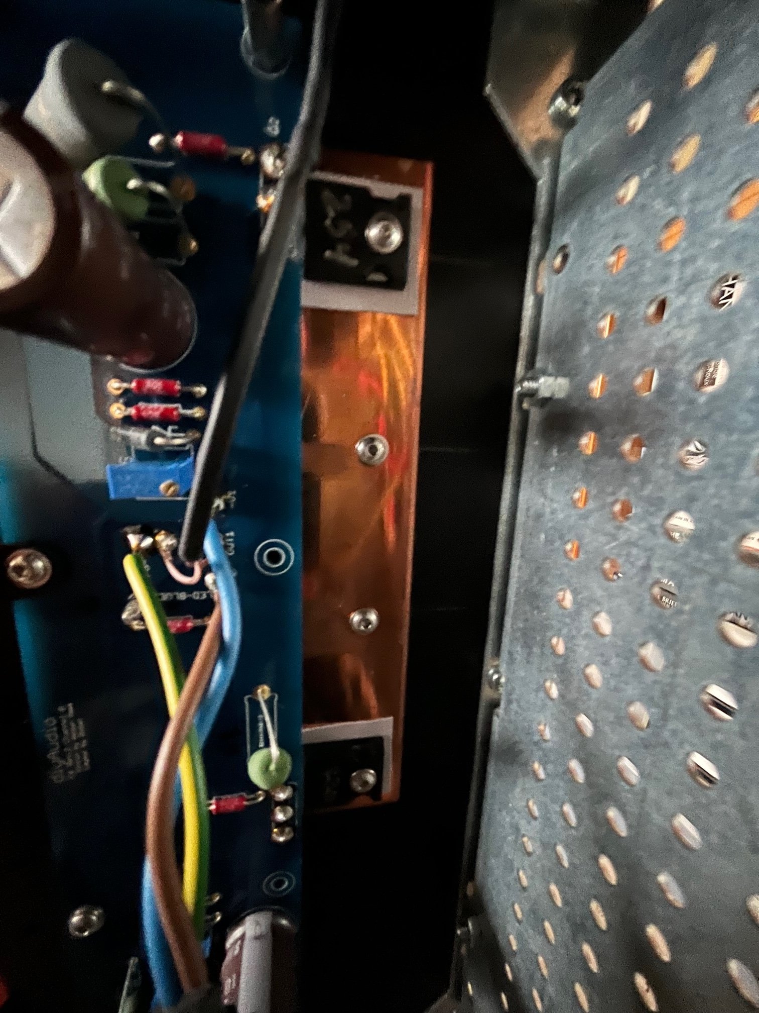

1. Heat. So in my obsession to manage heat (having read that Papa's gear runs hot) I added a primary heat sink to help spread the thermal load. I thought a copper (3x the thermal transfer of Aluminium) bar would help take the heat out of the transistors and make a bigger transfer to the main heatsink. I have a thermistor with my multi-meter and that is consistently giving a 42 deg C temp on the outside of heat sink. I don't get a consistent reading on the transistors (pin 2) - I had seen up to 72 deg C and a range of other temps between that and 40's. I've got a blob of heat sink grease on the themistor.
How are folks doing this easily/consistently? I'm biased at 0.6V on R2 and 0V DV offset (when well warmed up), so should be good temp wise.
Does anyone have any experience with my heat sink method, should I worry about the additional copper making it worse?

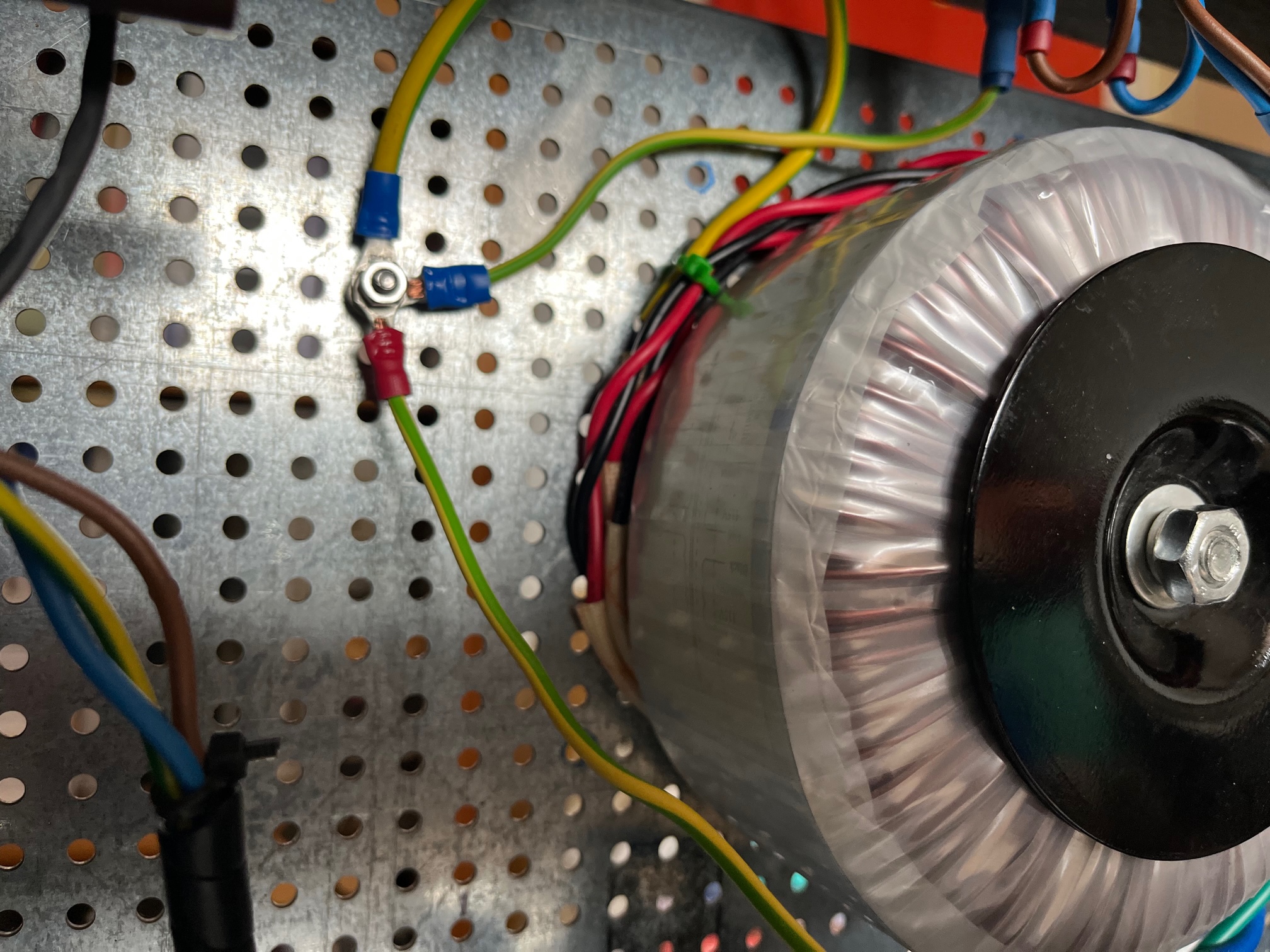

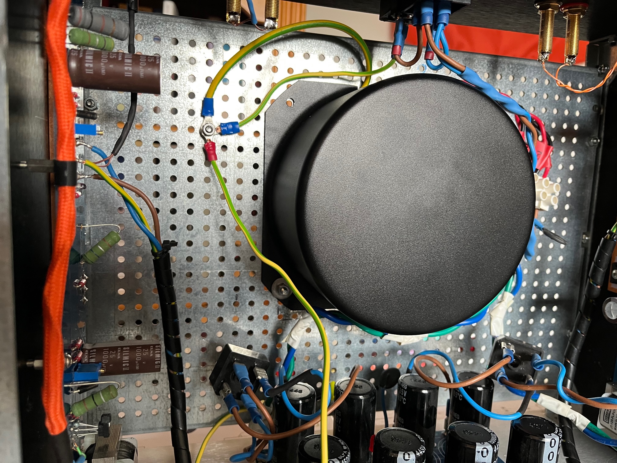

2. Hum. My other issue is a slight - mains I think - hum. The transformer buzzes audibly if you had your head near it and, if you held you head near the speaker (I've some Brynns and FH3s) but not loud - same tone as transformer. So, I thought I should put the transformer in a can. It's a snug fit - not interference, but needed helping on - don't know if that is good or bad. Before I went to trim the rest of the cables I thought I should turn it on. It appeared to me to be louder (albeit I have the base and the top off). I wondered if t was the can vibrating so touched the top (one hand in the pocket and gently) and I couldn't decide if it was hot or live - I let go and powered down... It had been on maybe 10 seconds. I've added some pics of the can on, and off. The can showed a tiny witness mark where it has touched the top of the bolt holding it to the base - just a nick of paint removed.
The blocks and rectifiers were zip tied down before I moved them to ease the can fitting. And the wires are all long as wanted to play around before I did a final trim. I do wonder if by keeping the wires close the transformer (almost under it) and that's the issue. Any wire husbandry guidance will be gratefully received.
Cheers, Al

I would first make sure that your preamp (or whatever you are using is not to blame, or adding to the hum.
Try it with the F6 inputs shorted, or with nothing connected.
Unfortunately, it may just need things / wires moving until it minimises.
Also, in pic 4 the NTC thermistor is in what appears to be a plastic connector block. That would be better in a ceramic one to minimise any risk from heat.

Thanks Colin, it was both plugged in and unplugged, should have mentioned that. So probably mains and everything need moving round carefully.
Not sure I understand re the ceramic block and where the heat is coming from. Surely a ceramic would transfer the ambient/base temp more readily as opposed to the mains wire temp? Have I missunderstood it’s purpose?
Al, if the metal can touches transformer's centre mounting bolt, you can get a shorted turn.
See fig 7 here: https://www.bicronusa.com/resources/tech-guide-toroidal-power-transformers
Thanks Dennis, clearly heat and electrocution. I can rectify that with washers to stand the can up a bit and some insulation to cover the exposed bolt (I will see if I can shorten that too).
I vaguely recall my electronic and ‘complications of toroids’ from uni, but that was 30 years ago and was studying mech Eng. The basic message was tighten stuff up as it will vibrate. Electronics was voodoo and wouldn’t catch on 🤣
