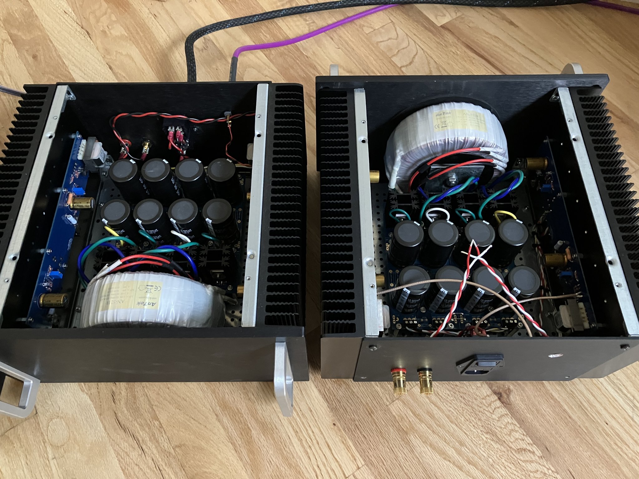

What is the formula for calculating the amperage based on the volts across the 0.47 resistor?
Got the "+" and "-" channels working in one of the monsterblocks. Taking a break to eat dinner and figure out the input/output wiring. Time to get the drill out. Maybe get one done by next weekend and finish the other during the weekend.
Reactions: 1 user
If'n I'm understanding balanced operation, I can wire this up like the ACA except tieing the negative outputs together to ground as the F6 doesn't invert polarity.
Anyone mind checking my thinking?
XLR Pin 1 goes to ground.
XLR Pin 2 goes to + input on the + (or Right) board
XLR Pin 3 goes to + input on the - (or Left) board
- input on both boards are left floating unless I have RCA jacks to tie them to.
"+" output on +/R board goes to right + speaker post
"+" output on -/L board goes to left + speaker post.
Both - speaker posts get tied together to ground.
Anything I'm missing or overlooking before I do something stupid?
I suggest you draw out the full balanced circuit of the 2 amp 'boards' before ...
ha! I'm a total silly billy. Thanks for the hint. Only have to wire in the XLR jack as I outlined and give it a go. Might be able to wire it up temporarily to give it a quick try tomorrow night. No silliness with the speaker outputs as they are already tied to ground via the PSU connection. Time to get out the drill.
Umm, for an amplifier to work as a balanced operation, both your F6's left and right channels are used to produce just the single balanced output between each amp channel's +ve terminals - if so, you will need another complete 'balanced' F6 amplifier to produce a stereo sound.
Also, if you want the single F6 amp to produce just the one balanced output, either the left or right amp's channels needs to receive the inverted signal from the preamp - this shouldn't be any problem but, and a significant BUT, is that the basic F6 amp circuit doesn't include the ability to operate with a balanced signal input so you would need to add a "balanced -> unbalanced" converter stage to the amp's input - again, this isn't all that difficult as quite a few circuits, and possibly kits, are available but it doesn't sound like this is quite what you want to do ...
Umm, 2 chassis, 4 F6 boards, 2 inputs, 2 outputs. That should cover. Just trying to make sure I'm connecting to signal ground properly. Hoping to get one of these jimmied up tonight to see how the sonics change. Still have to wire up the PSU for the 2nd one.
But back to the original question, appreciate the help. Drawing the board connections out and checking a few points for continuity got me to realize almost everything is already connected to ground. Just have to connect the XLR ground to the nearest signal ground point (which could be a RCA jack per a ZM post I found).

Have you got a Variac? It saves a lot of potential mistakes - I know this well!
Surprisingly, for some balanced amp connections, it's the grounding systems that produce a lot of problems like hum, ground returns, etc - you might check-out the idea of 'floating the balanced signal ground point' in case you need it (Bryson, etc) - suggest you try the 3 leds mod
All the best with your project, it's looking very good.
thanks, jameshiilj.
No variac. I've been doing audio as a hobby for 20+ years and have gotten very lucky. One of those items I really need to get but as much as I move around, I keep taking the chance of not having one. I dream of having a test bench setup one of these days. Currently (heh), both boards in the one chassis power up and bias up just fine. So I have high hopes (waiting to be dashed on the rocks of a short to ground, heh.)
Speaking of grounding, thanks for the tip on the floating. Hoping to try amplifying tonight. If not then this upcoming long weekend. Could be just fine and I'm overthinking it. But I will look into the floating idea. Usually when things work just fine, one learns less and you have to make extra effort via other avenues.
