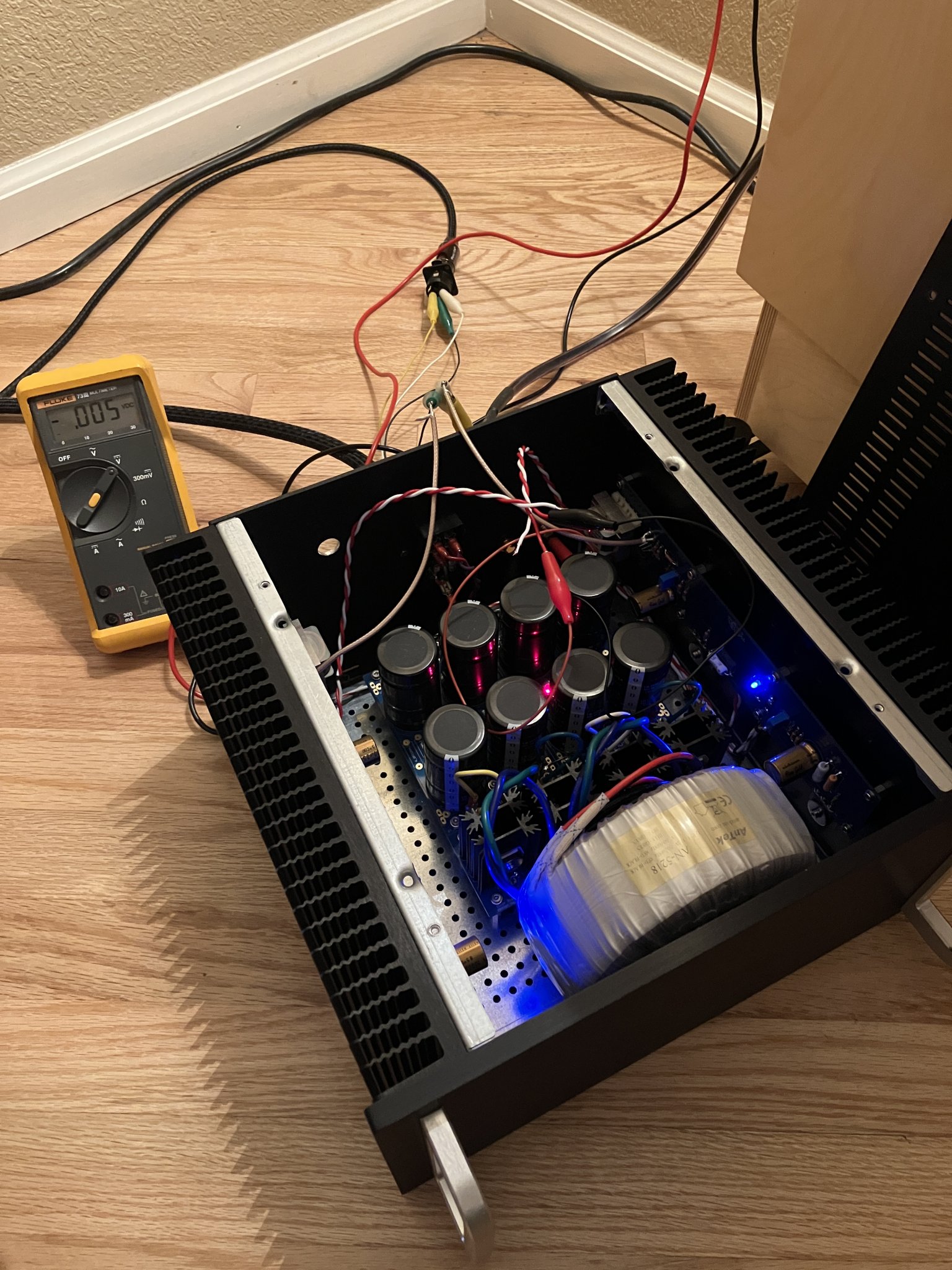

Dead quiet.
5mV of offset at the speaker binding posts.
Will drive me out of the room with the Benchmark DAC3 at 12 o'clock. Need to set the gain jumpers.
Ugly as hell at this point. Next is to perma-wire the I/O then finish the other monsterblock.
Right now, sounds very relaxed, effortless even. Lots of detail that seems naturally there. Listening to Mahler's 8th, Abbado conducting the Berlin on DG. Can't wait to get the other one running so I can see how the imaging is.Really hoping for some depth to go with the breadth.
This Memorial Day weekend is going to be a hoot.

Thrilled for you man! Enjoy it, it might the first set of balanced F6 monoblocks I have seen. What speakers? Hopefully easy load since the output impedance of each monoblock is double what a regular F6 is. Maybe in the future you can replace the MOSFETS with some SemisSouth’s!

Hiya Anand,
Speakers are Curt Campbell's Halcyons. http://speakerdesignworks.com/Halcyon_1.html
So far, the bass is more pronounced (this is with a monsterblock on the right channel and a SE monoblock on the left channel) but doesn't sound underdamped akin to the ACAs in balanced mode. For the first time, I feel the organ pedal tones on Mahler's 8th (Abbado/Berlin on DG).
Agreed. The output impedance had me cautious on expectations. I was contemplating going straight to the F5s but figured since I already had the single channel F6 monoblocks running, to try the F6s in balanced mode.
I have a couple strategies I could try if I don't like the bass once I get these done:
1. go back to single-ended mode, have 4 channels of amplification and add an active crossover.
2. design a new bass section around the MarkAudio Alpair 10Ps with either the Alpair 12PW or Dayton Audio RS225s. Thinking a sealed WW configuration but will model a few different ones to see if one bubbles up as more optimal.

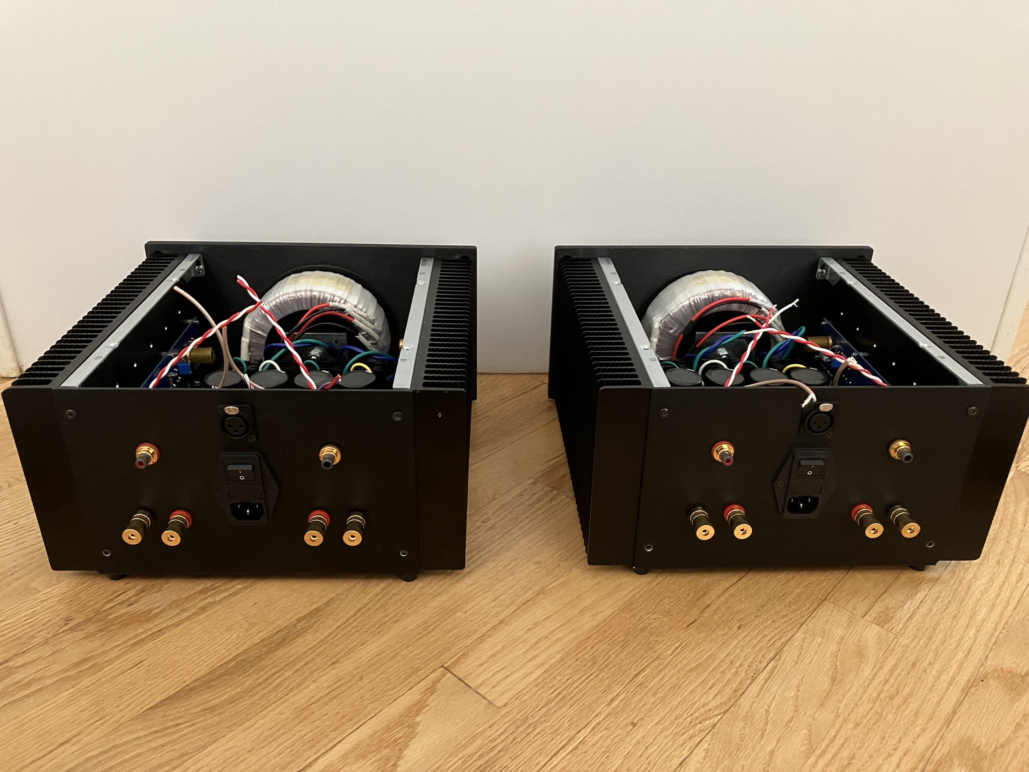

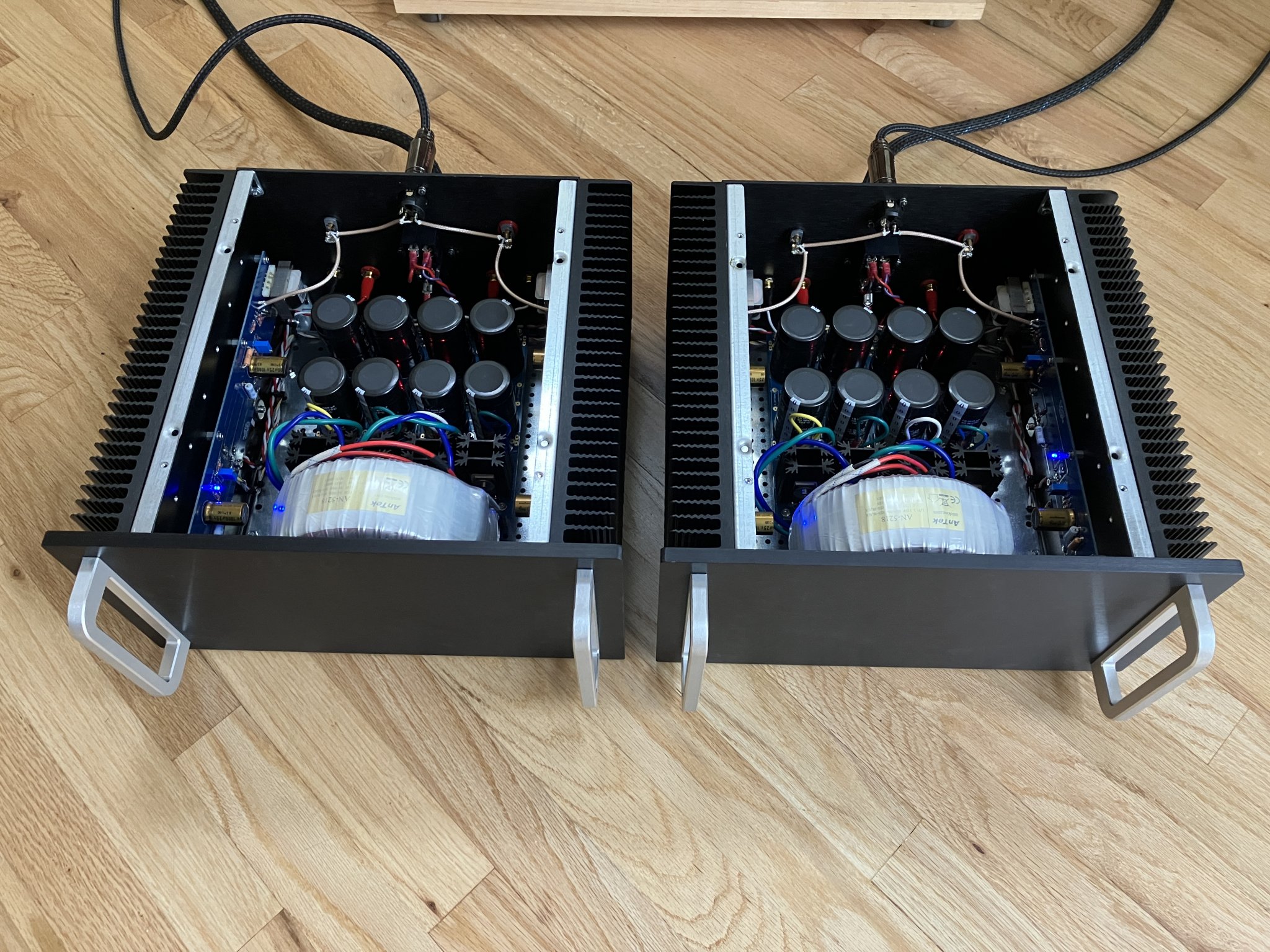

Balanced F6s are wired up and playing in the system. Total change. Level of detail is amazing. No hint of strain or hardness. Hear timbre of low end stuff like I've never heard before. Might be missing some impact but the bass is deep and still enough definition to hear the timbre of orchestral bass drums. I keep turning it up and up and up. Wound up putting the Benchmark jumpers to -20dB and the volume knob sits between noon and 3 o'clock as recommended.
It was a long weekend with much cussing and I'm glad I have tomorrow off. Definitely worth the effort and a good day tomorrow to just listen, enjoy and tap my foot. Blues Brothers soundtrack is on right now.

Sorry I haven't been in touch. Life.Absolutely fantastic!! Congratulations and well done!

..... 6sX7, Your amp looks great!!! BTW, which model case is that? It looks smaller than the 'norm' of the big 4U deluxe but I could be mistaken. Thanks.
They are the 4U mini-Dissipante units. There's a long story to getting them as I wanted to do monoblocks. @Gianluca came thru and now they are offered thru modushop.
