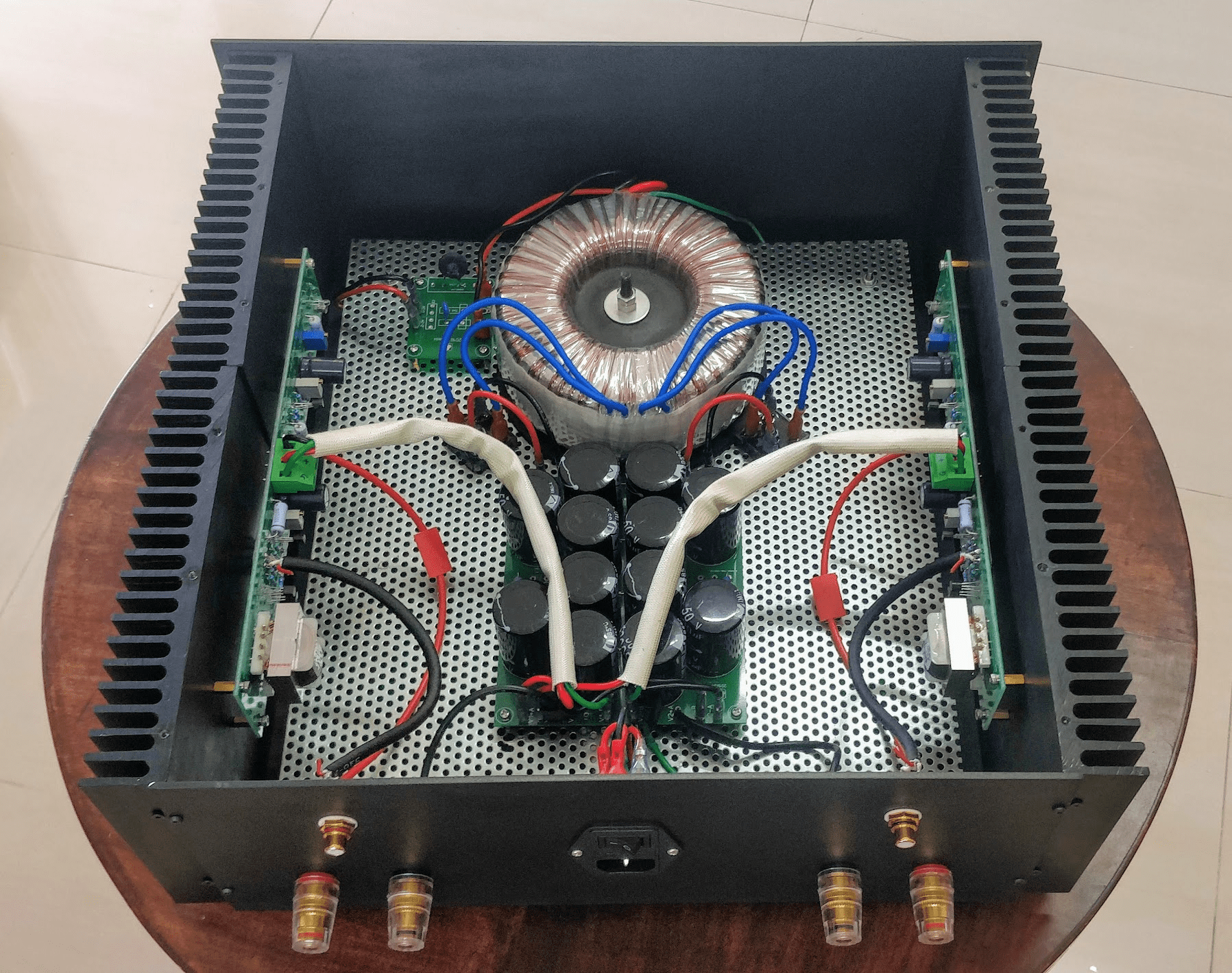

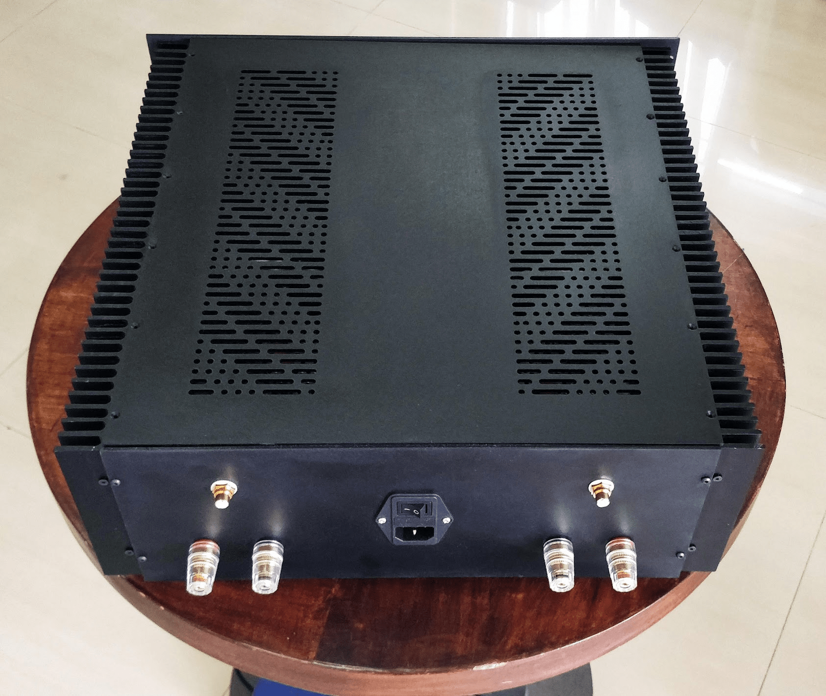

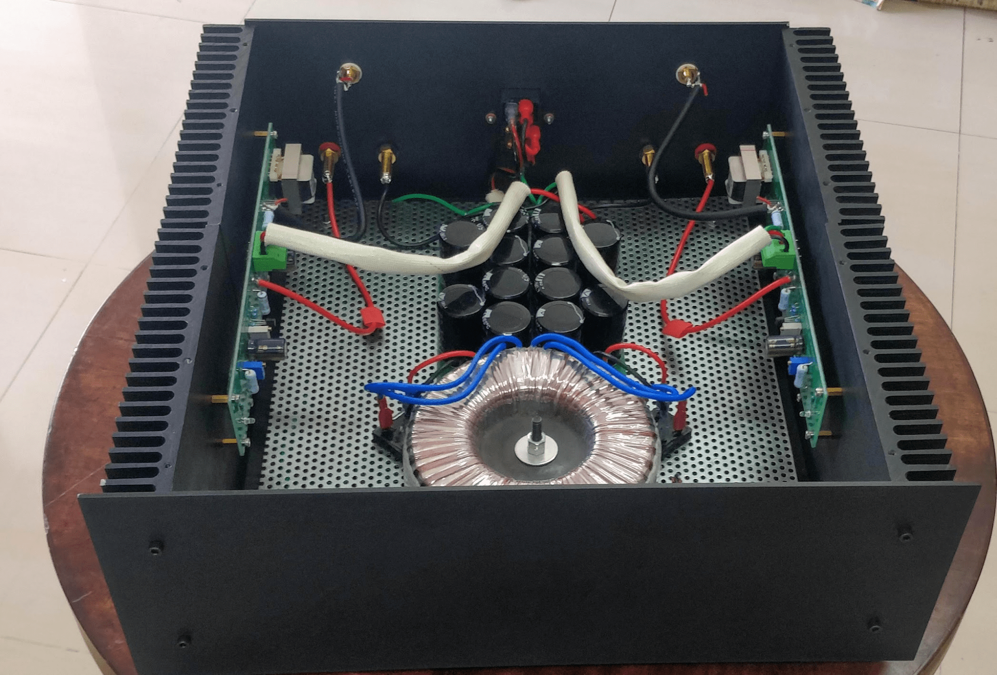

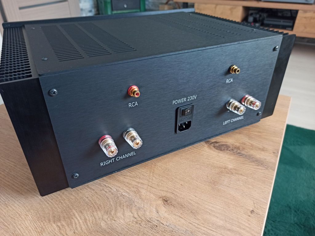

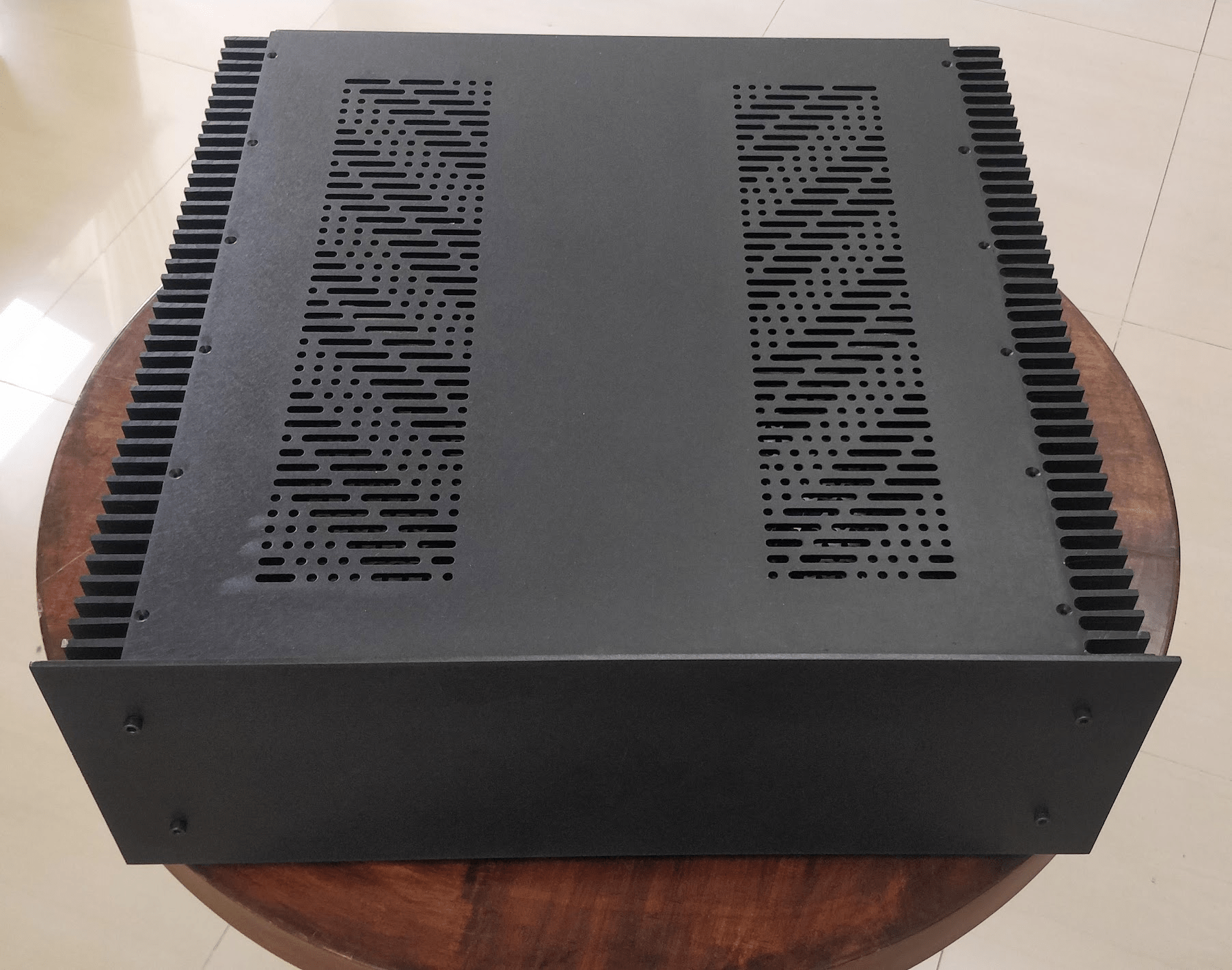

Finally completed my F6 build. This is my first FirstWatt DIY amp. A huge big thanks to Mr. Pass for sharing his design and the entire commumity here whose posts helped me and your builds inspired me. Thanks to @6L6 for the illustrated guides. I'm very glad I built this. The amp is super silent and sounded wonderful right away. Not sure if it gets better as it breaks in. Folks were not kidding when they said it gets hot. Right now it's peak of summer here with temps reaching 42C and I can barely touch the heatsinks for a sec!
The enclosure is DIY since importing the one from Modushop was getting very expensive. That turned out to be quite challenging it took the most time. It's aluminium and anodised.
Couple of questions
1. I've noticed that the bias voltage slowly keeps rising. When I set it at around 0.52V after 30 min of running I noticed that on cold start the bias is just about 0.47V and then slowly climbs up. Is this fine or should I set it so on cold start it is 0.5V and let it rise from there?
2. I've read that the offset won't remain steady at 0. It also seems to creep over time. What value is considered bad?
Sharing some pics..
View attachment 1050628 View attachment 1050634 View attachment 1050630View attachment 1050629
It is a very neat build! Could you please let me know the size terminal block you used on the F6 boards?

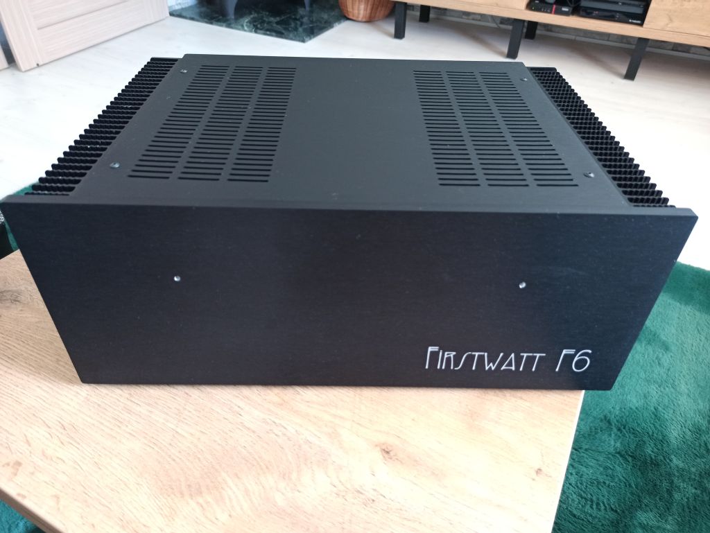

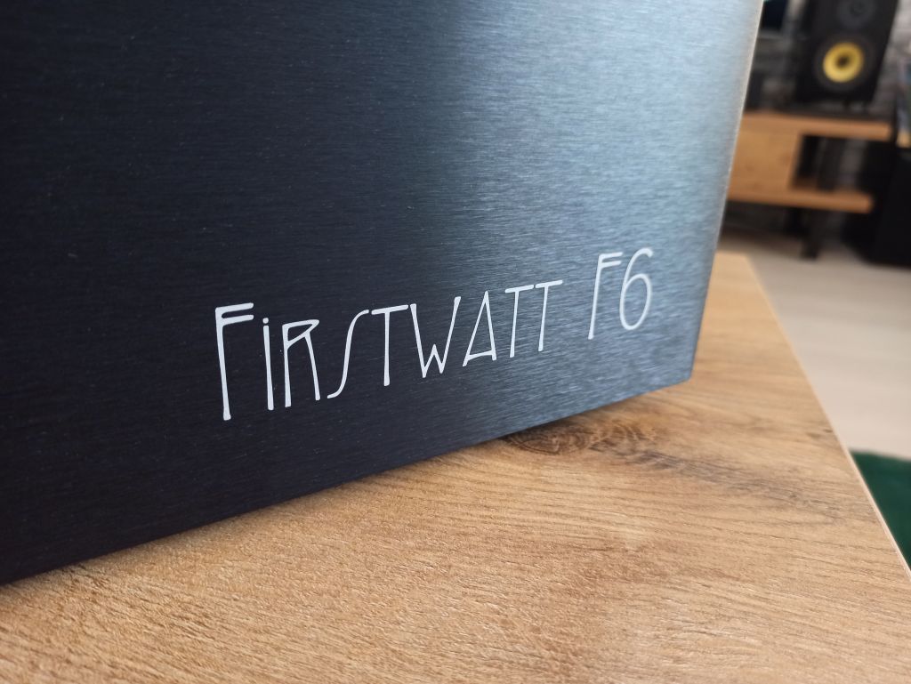

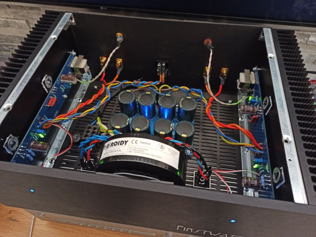

Finish.Thank you all, for your help. Sound fantastic.
