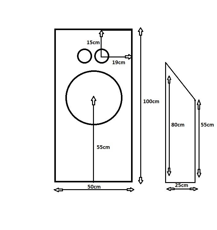

Pano,
I was hoping to do a two way with double 15" woofers, but an acceptable full range/tweeter is hard to find? Might I be better off waiting for John's suggestion for an 18" three way? My concern is that three ways generally involve much more complicated crossovers. One of the attractions of the Manzanita style build is the simple crossover.

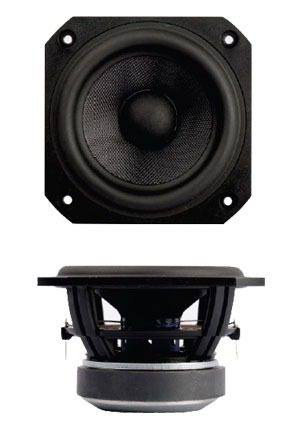

Expanding a bit on the Vifa TC9. True mid band half space forward output efficiency is around 84 db/watt/mtr. Used in an OB set up you gain about 4.5 db or so of added mid band output from the rear output, provided the baffle width is greater than 12" and you keep above 300 hz or so. The rear output will droop from around 3,500 hz up due to the shadowing effects of the frame and magnent assembly. So, mid band you have about 89 db of total output at the listening position, which, is more than enough to keep up with a pair of parallel wired GFS 15's. Where you run into trouble is with the Vifa working all the way out to 18Khz, once you input enough power into it and approach about 1/3 the rated 2.4 mm xmax the cone and suround really start to flex alot and you can hear it. Keep the volume down and it is all good. Push it hard it is going to tell you. That is one of the trade offs. The Vifa can really play full range, but to do that the cone and Xmax need to be realitively small.

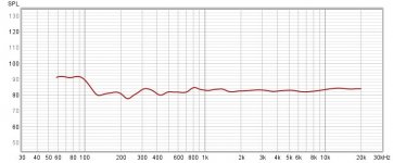

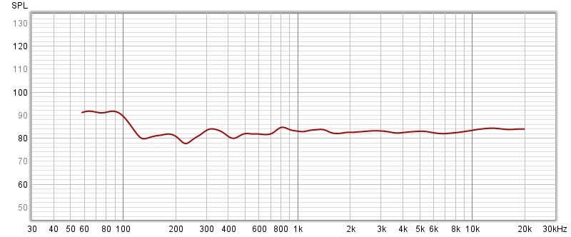

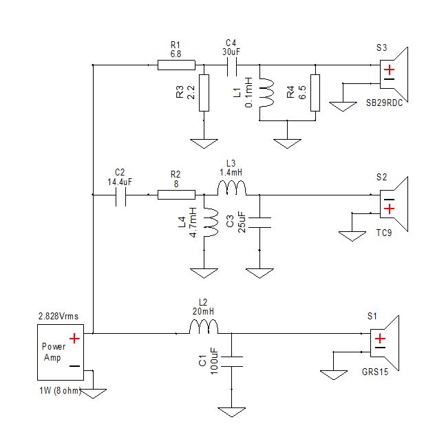

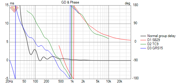

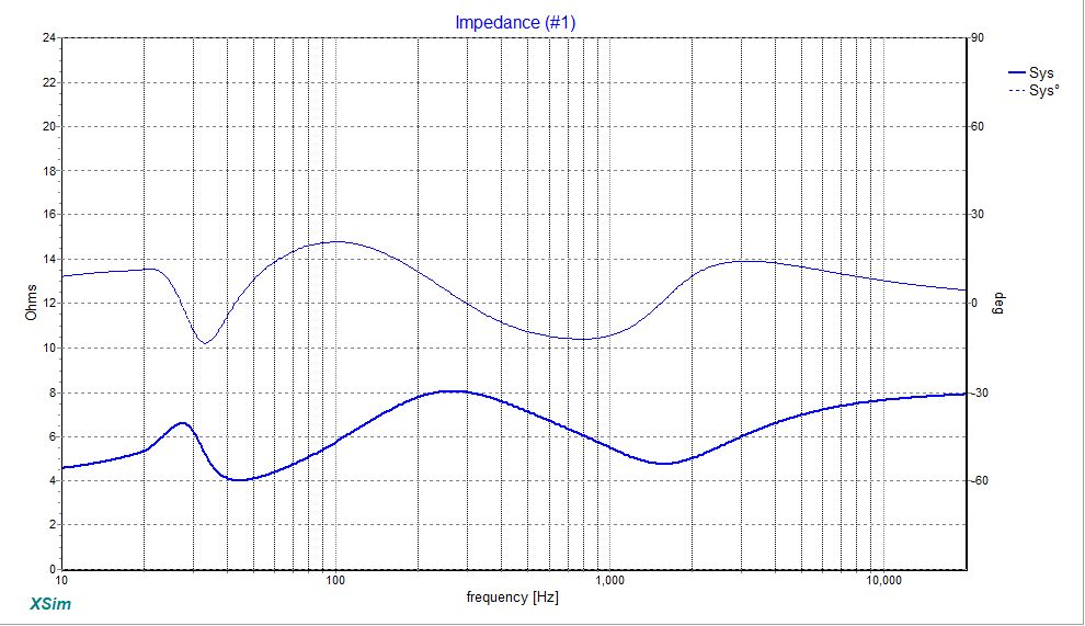

Hello again!
I wanted to share my new manzanita 3 way build..
I was taken by OB sound after I build manzanita ultra which was my first DIY build.
Although I enjoyed the sound there was part of me that wanted little bit more performance in the top end.
After playing with Mark Audio drivers (good presentation, but lot of coloration) I decided it was time to try a 3 way build.
I had pair of sb29rdc lying around so why not.. For most part I repurposed the manzanita crossover best I could, working around the few spare inductors, caps and resistors I had on my hands, hence the some weird choices.. Crossover points are around 300hz and 1800hz.
Letting the tc9 take care the midrange (instead of grs) completely transformed the sound signature.
Grs low end is still there, but midrange is much more dynamic and nuanced and speaker is sparkling with details.
Ambient feel of OB is still there, but now with wider soundstage and whole new dimension of imaging and detail.
Overall signature is silky smooth and gentle and works well with all genres, but for some reason I couldn't stop listening classical music..
Response was measured 1.5m from the speaker. <100hz bump flattens when you move speakers further from the rear wall.
btw vifa will get round plastic ring 😀
Thank you John and Pano for inspiration!
Frane

Very cool. Those look great - the feet are a nice touch. Even your impedance plot looks good. :up:
Thanks for the explanation of the evolution and modification. I don't know that tweeter, but John might, I think he has a lot of SB drivers. This just goes to show what a basically good design can do and how flexible it is.
Let's hope your experience encourages many other to start down this path.
