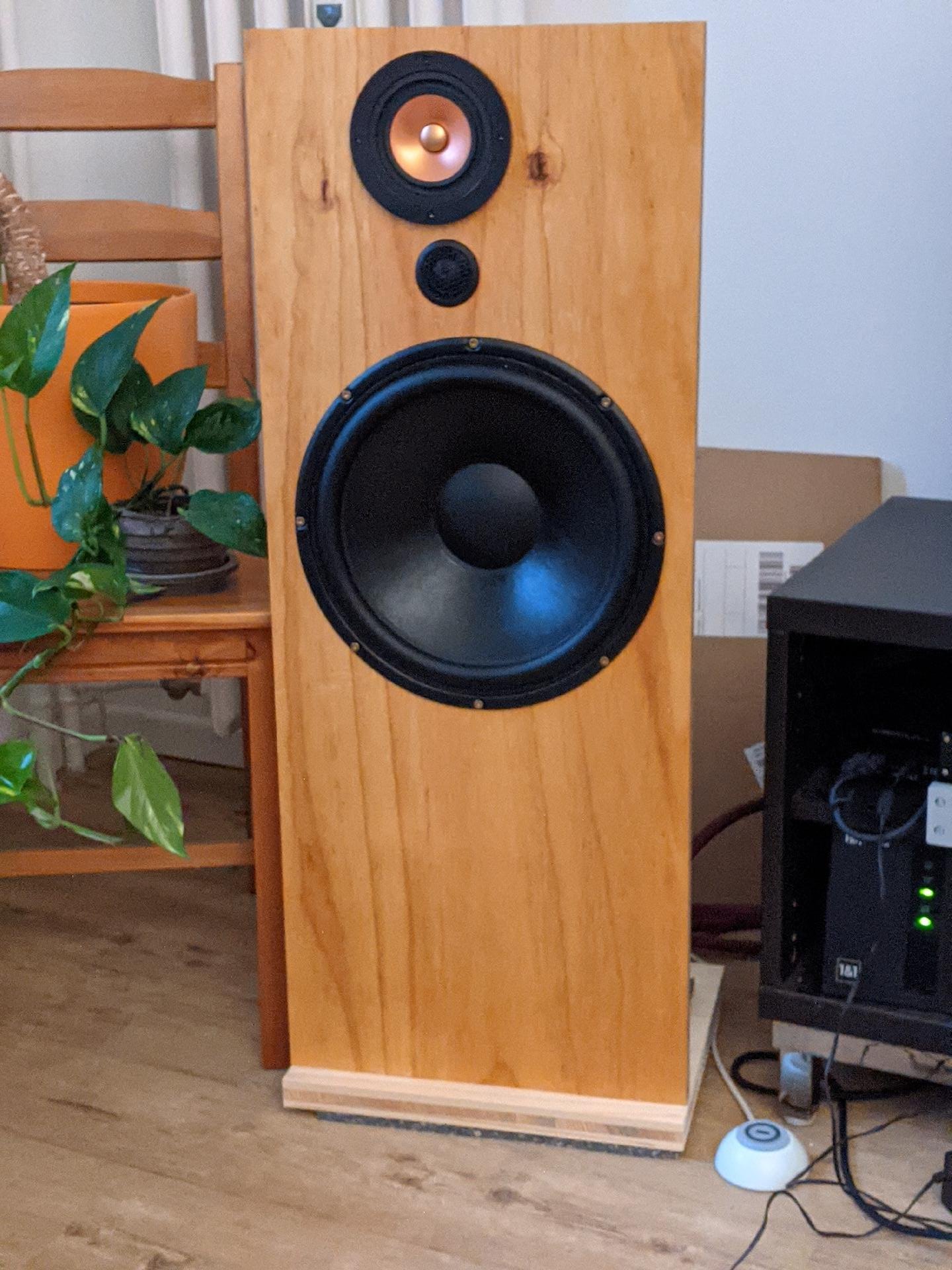

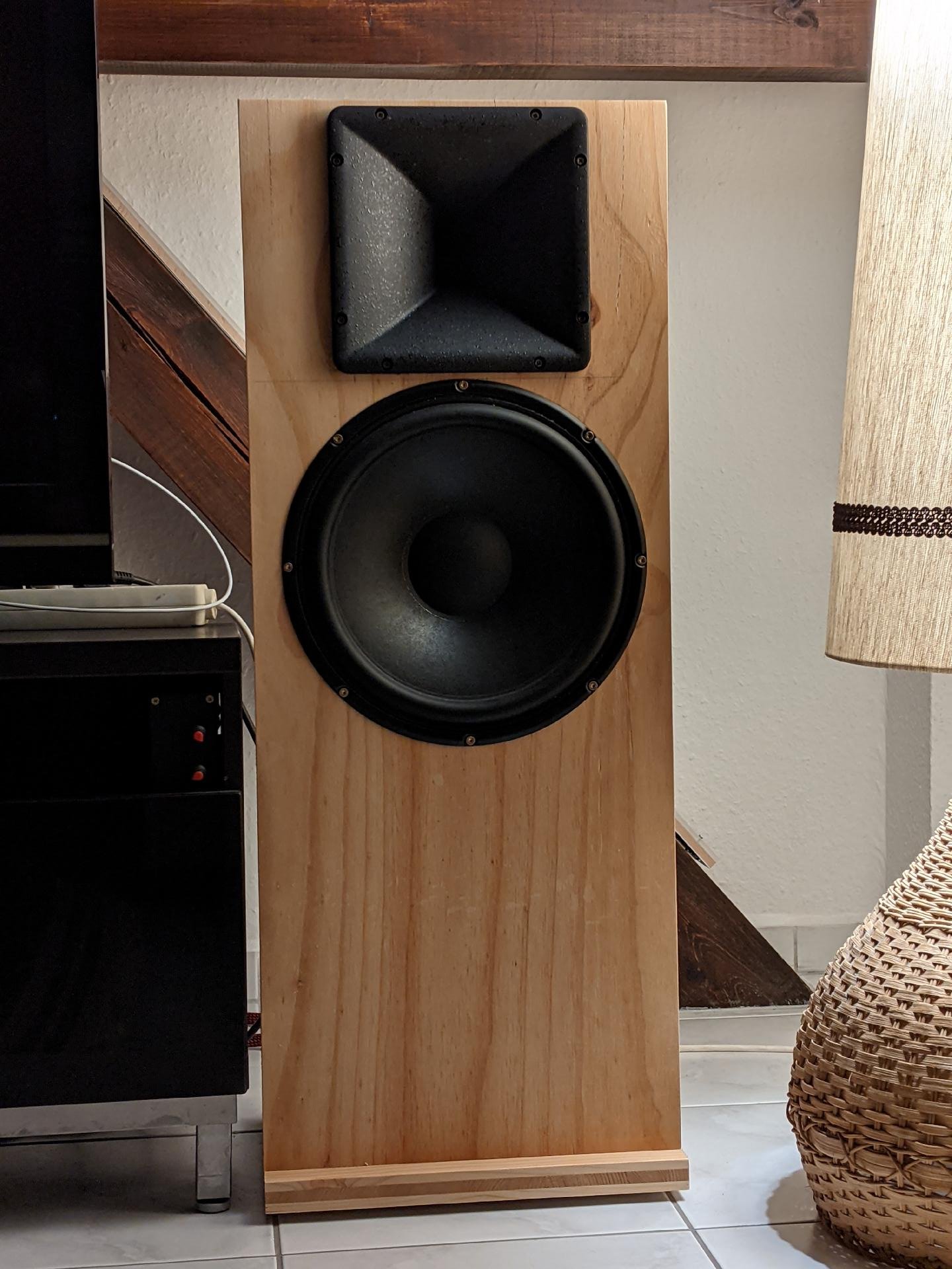

Depends on what you mean with "this design".Just wondering has anyone tried an active crossover with this design?
I use a 830669 on a 36cm baffle; don´t know if its close enough but definitely inspired by the driver choice from this thread.
(with an Alpair 7.3 XO~400Hz and Faital HF108 XO~1k)
There is no reason the active crossover cannot do the same as the passive ones presented here.
Of course you´re on your own doing it but it is not that difficult and it doesn´t cost many big ff inductors and has slightly better sensitivity.
Can´t believe I want to try go back to "boxed" speakers soon.
I sure will miss the sound of the open baffled 830669; that´s why it will probably end up in a ripole.

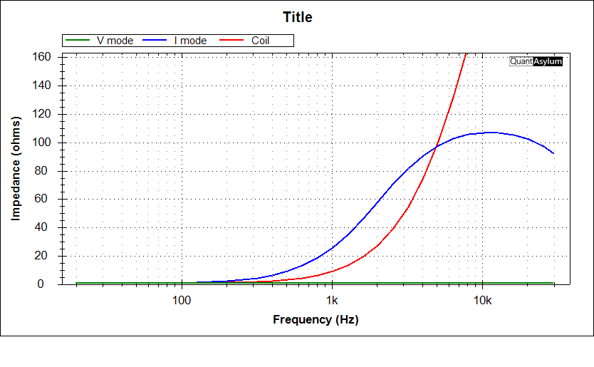

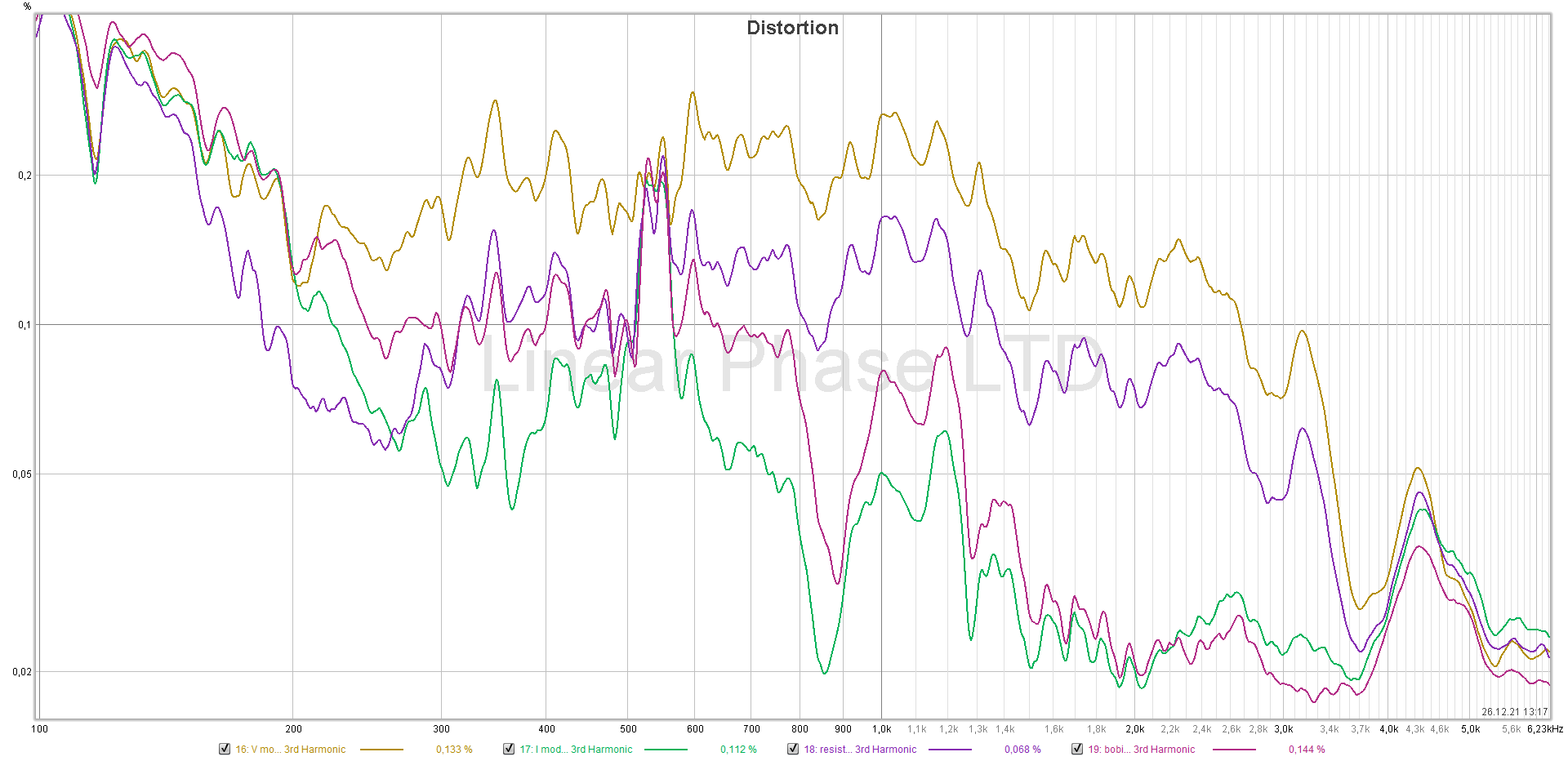

In support of what Mr. John Bush writes: Week ago two friends were having fun measuring amplifiers (voltage & current mode) on a speaker with driver SICA 5,5 H 1,5 CP.Some inside baseball... part of why the design works is due to the the big *** inductor... it is a filter that not only shapes the woofer roll off, it filters out a lot of higher end abmomalities. Can't over stress the importance of that.
In conclusion, it turned out that with the current amplifier, the third harmonic is 15 times lower... Surprisingly, with a large coil (inductor), similar results were achieved. OK, almost...
Link to thread: Measuring the influence of the output impedance of the amplifier on the speaker (Sorry guys, need to use google translate).
Some food for thinking:
Note:
graphic 18: Added 8Ohm resistor between amp-speaker
graphic 19: 1.6mH Inductor added
So, I think that big coil (20mH) in Manzanita crossover design is one of the nice, smart and key features!
Respect, Mr. Bush!
