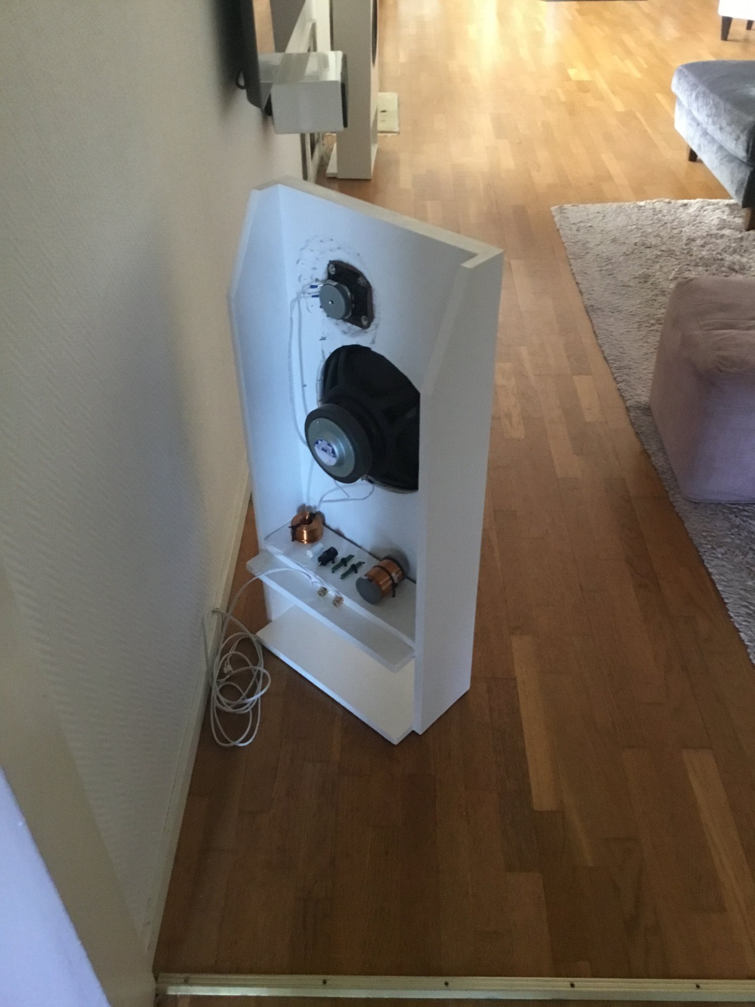

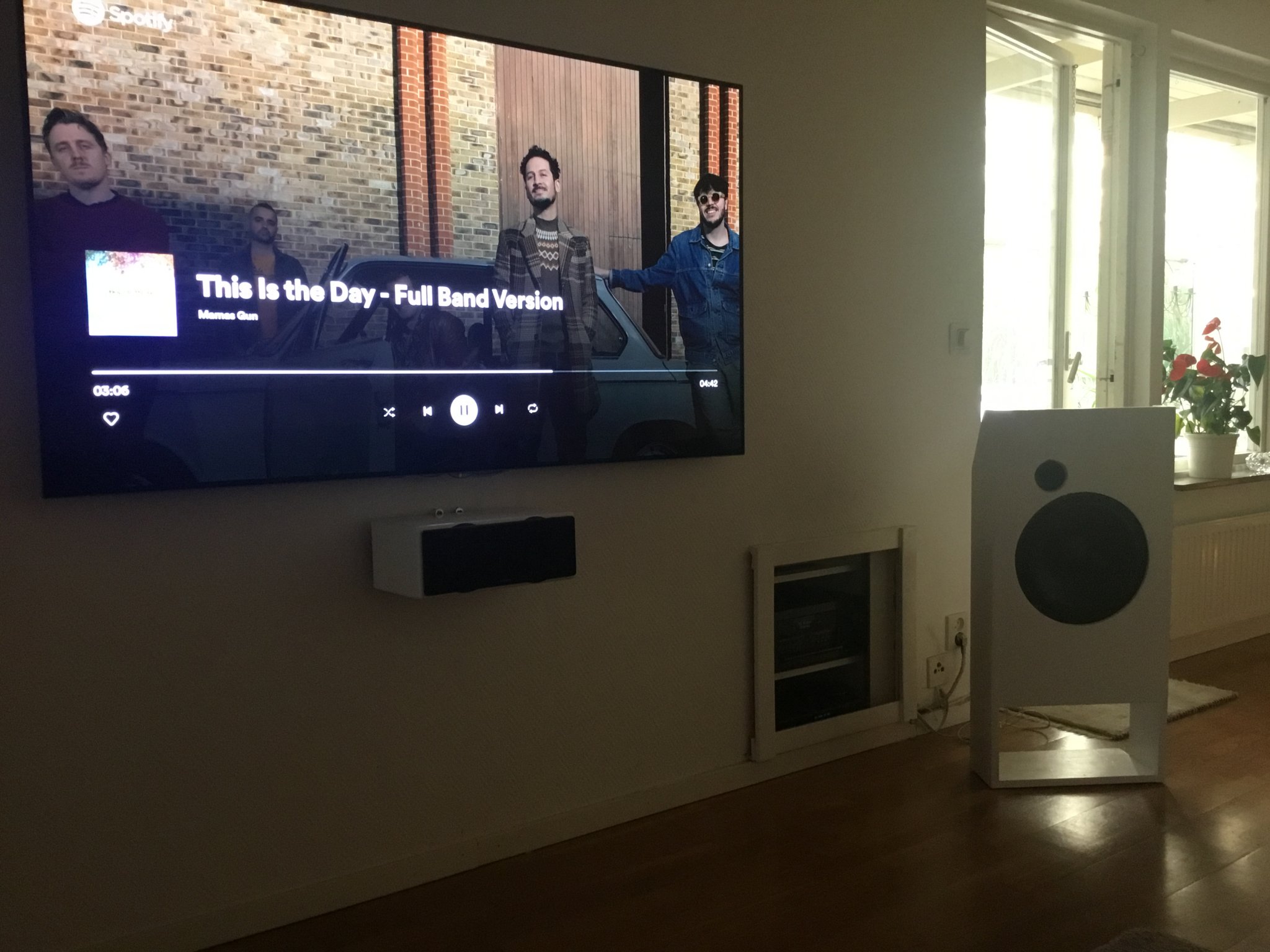

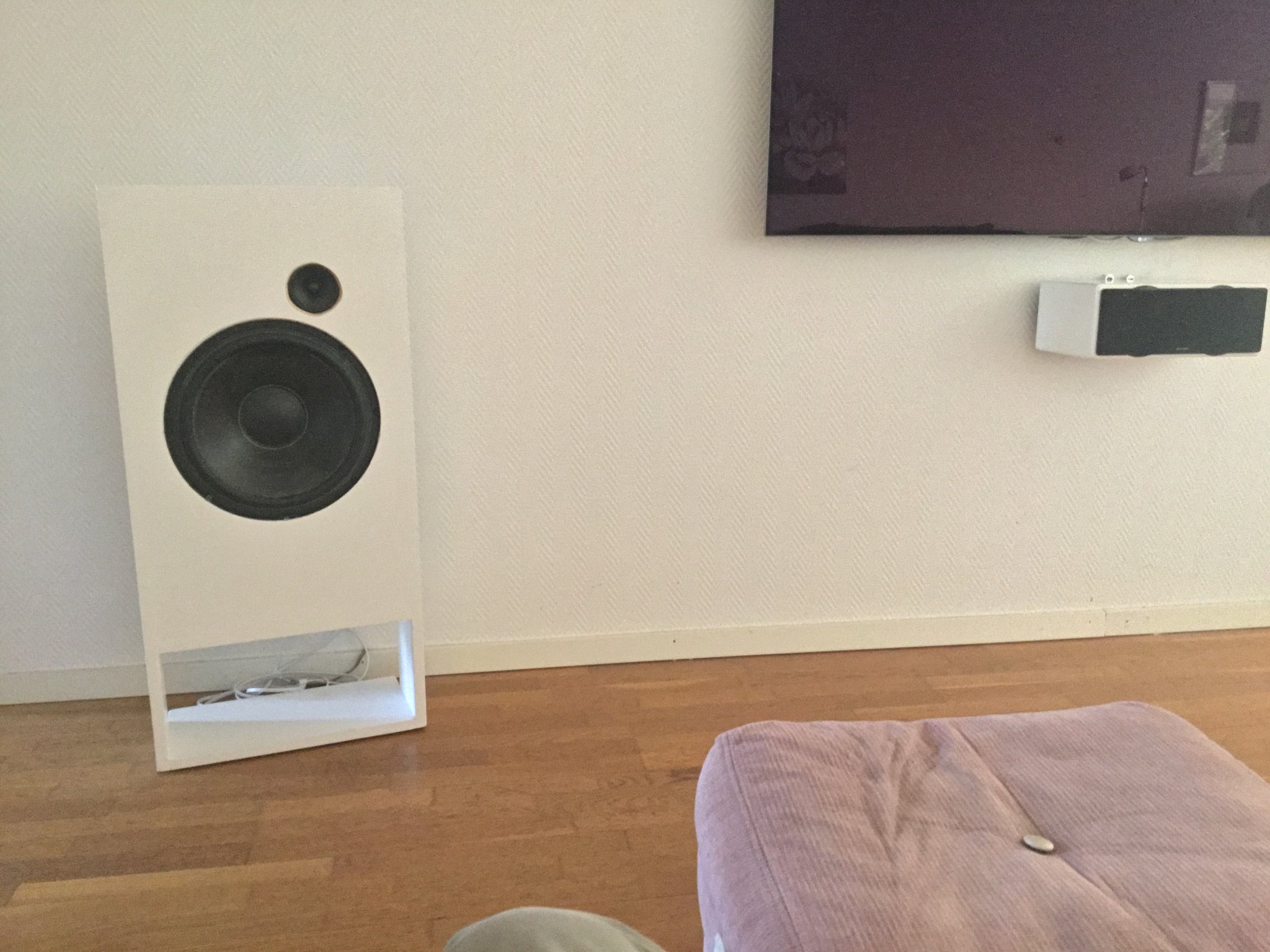

After lurking this thread for months, I am now also a happy camper. Thank you John (RIP) and Pano.

Thanks for posting and showing your speakers! Nice and clean looking. As Barry says, you might want to experiment with getting then away from the wall, you will quickly hear a difference. But the the angle they are turned, wall reflection might not be too bad. Getting away from the wall usually gives better bass.
The side wings of the baffle are asymmetrical to help smooth frequency response.

Just a quick update from my previous posts - I disconnected the 3-way crossover from the shared woofer inductor and whatever problems I was experiencing went away. It's weird as I expected components within an open circuit to hold no influence, but apparently they do. The speakers now have a beautiful balance, as I have been expecting based on all the praise I have been reading about. I probably (almost certainly) have too much midbass though, because my frame is based on the 3-way, with a solid panel all the way to the floor and 9" deep sides. The sound is thick at some frequencies. I'll play with positioning more before I go for any structure changes. They are about 4 feet from the front wall but in an open basement with the back wall 15 feet away and unequal length side walls there aren't many room modes that seem bothersome.
The tangibility of the bass though...oh man lol. Somehow they reveal more detail than I'd ever expect given their price point. Imaging is a little hazy though compared to my box speakers or my Acoustats. Great depth. These seem to require a decently powerful amp, my Pass 50w Zen struggles and distorts at high volumes with these speakers.

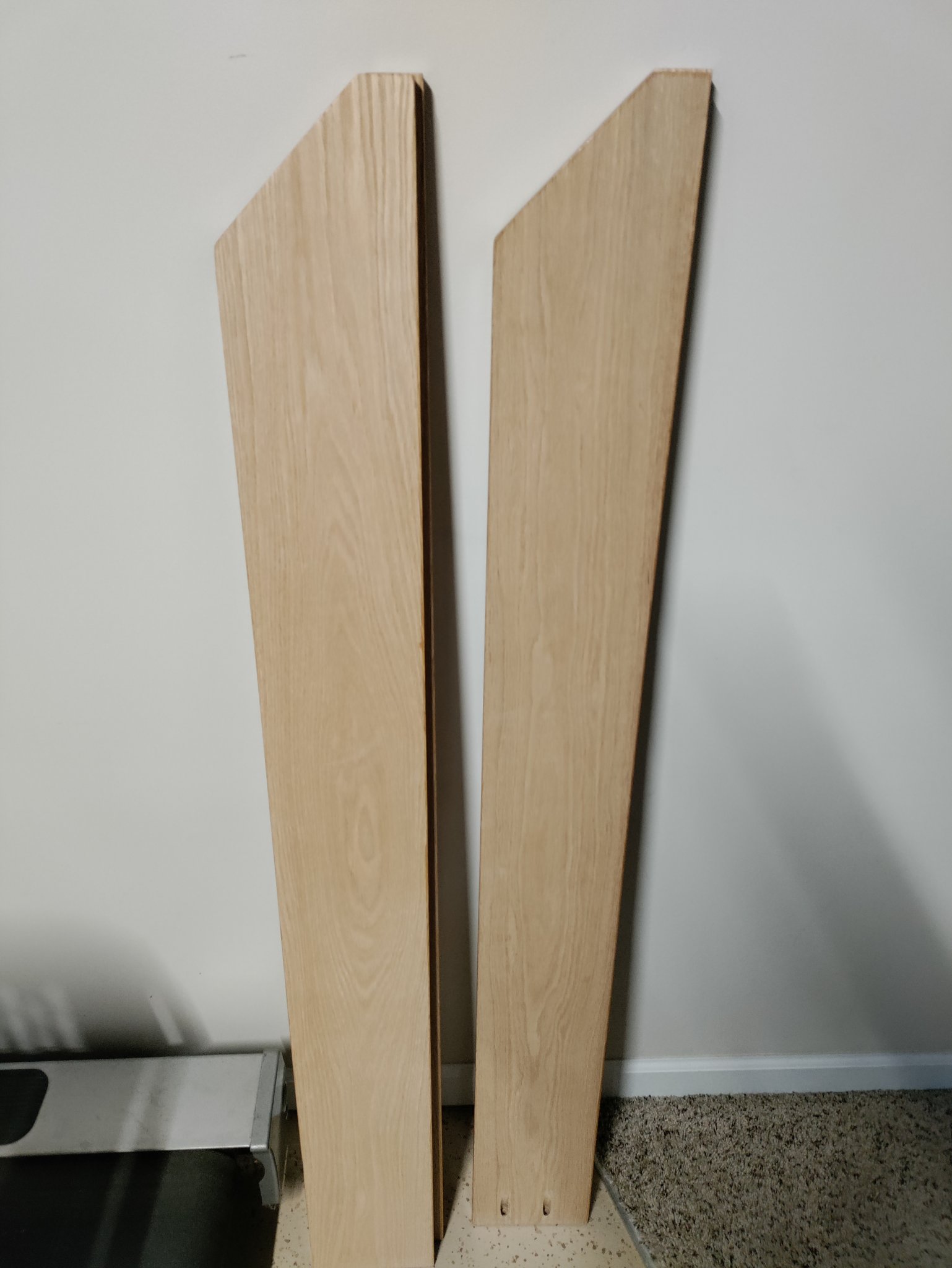

As for the wing taper, I've found no hard and fast rule. My own Ultra's have straight wings as I'm not much of a carpenter. Most of the tapered wings seem to come up to the bottom or the middle of the tweeter. Yet the one photo of the Ultra's from the Lone Star Audio Fest in 2013 shows the taper starting at the top of the woofer.
Maybe play with cardboard wings to find what you like?

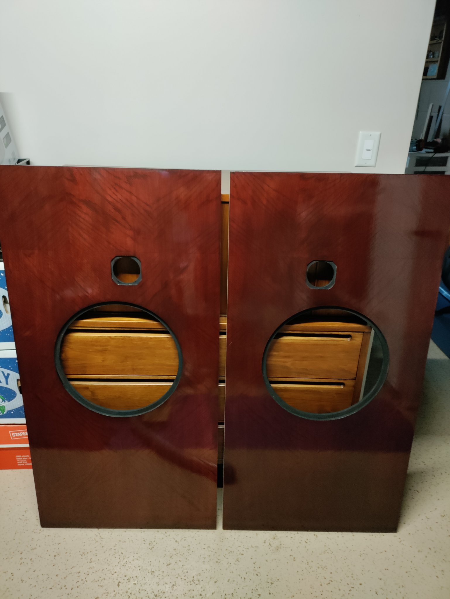

Some progress pictures. I made the baffles out of an old beat-up dining room table. It is oak veneer on MDF. The table was not big enough so I had to dowel join pieces together, sanded it all down, stained, and poly'd. The wings are solid red oak. I am making a base out of an old drafting table that are 1x's edge glued together, will put a chamfered edge on it.
I hope a 6" counterbore is big enough - I could not find dimensioning info on that.
