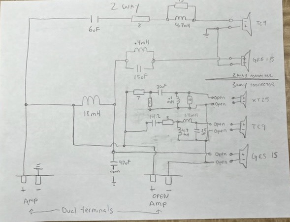

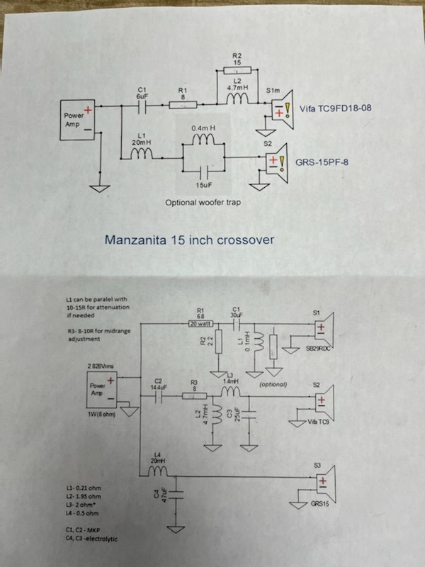

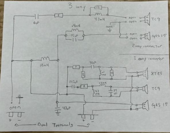

Fast, fun, Inexpensive OB project
Hey there...anybody have any ideas regarding post 3114? I posted the schematics above on how the dual crossovers are wired and used depending on whether I am using them as 2 ways or 3 ways. I recently got ahold of some Acoustat Spectra 1100s....so now I am playing around with the idea of scrapping these and using the GRS 15s as open baffle woofers for the Spectra 1100s.

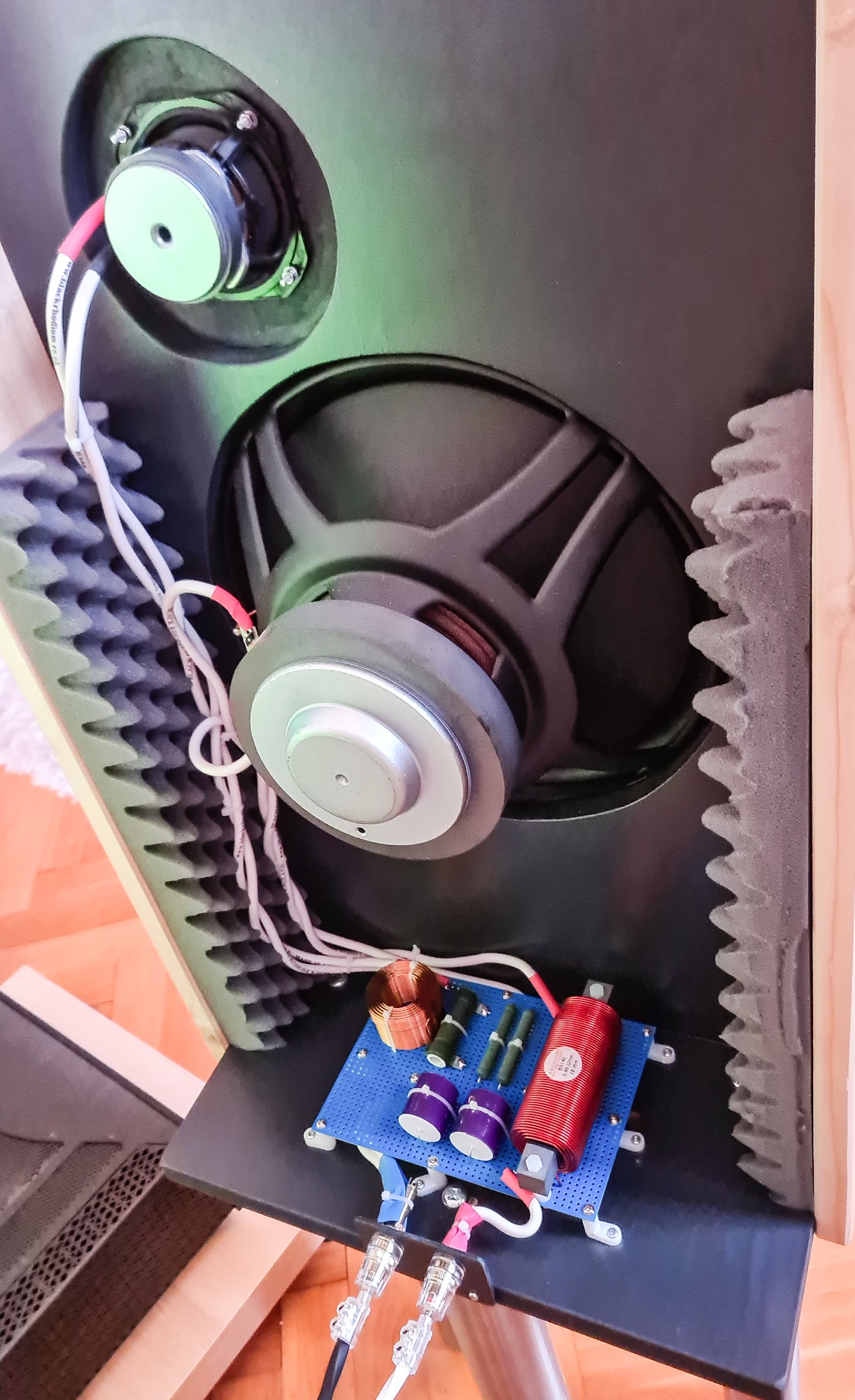

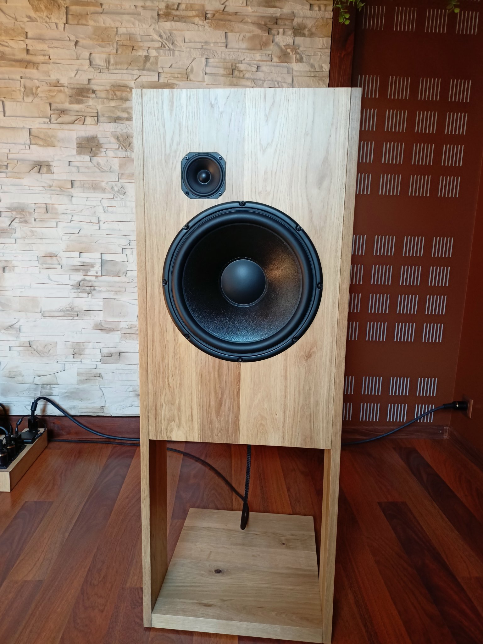

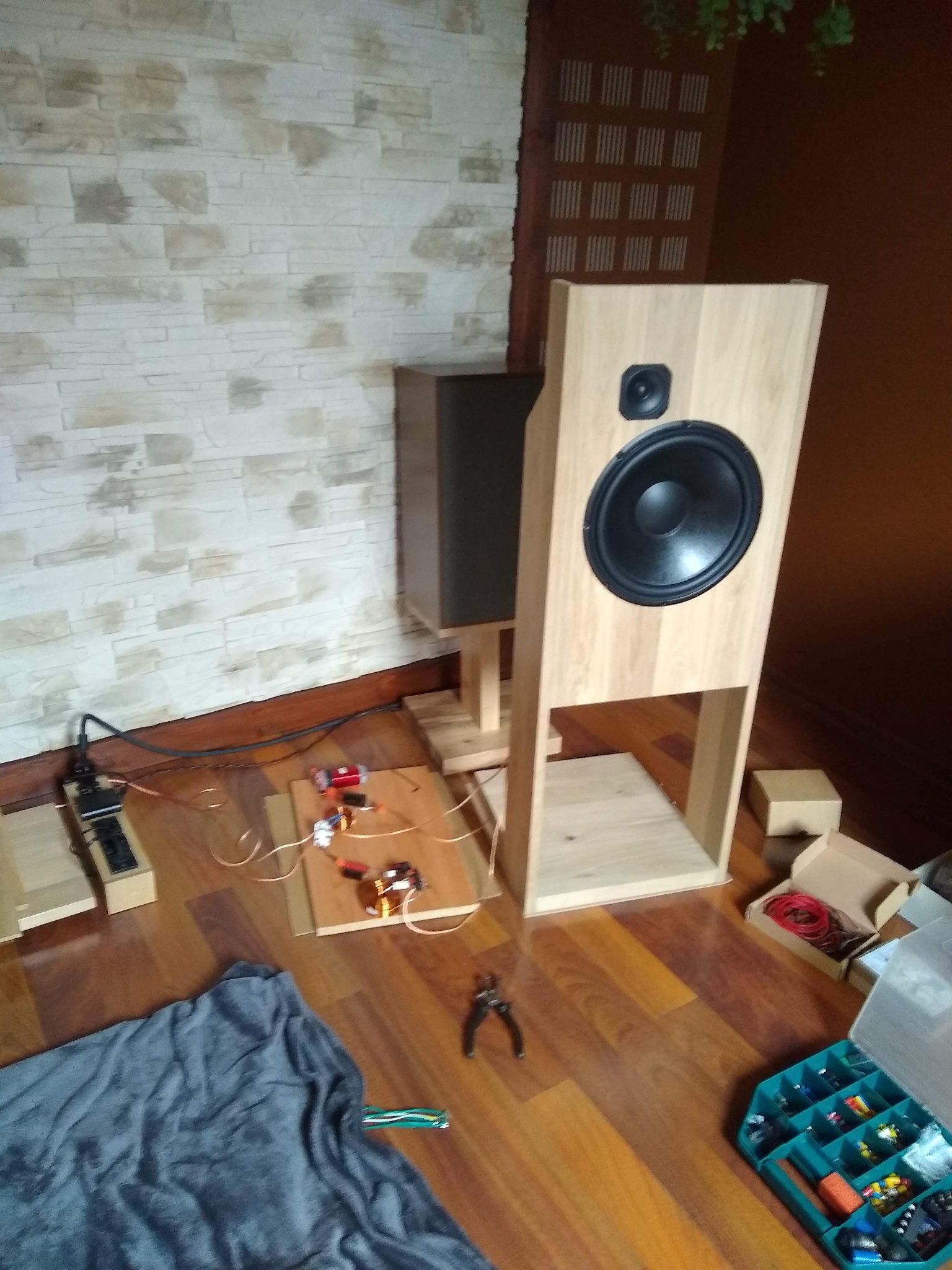

Finally, the Manzanita is finished.
Speaker terminals, 12 mounting legs for the xo in order to mount it protected against resonances, eggcrate foam for the wings (after a series of listenings with and without).
And it sings. After about 100 hours of listening the Vifa is now very smooth, the slight harshness of the first listenings is gone.
An amazing speaker.

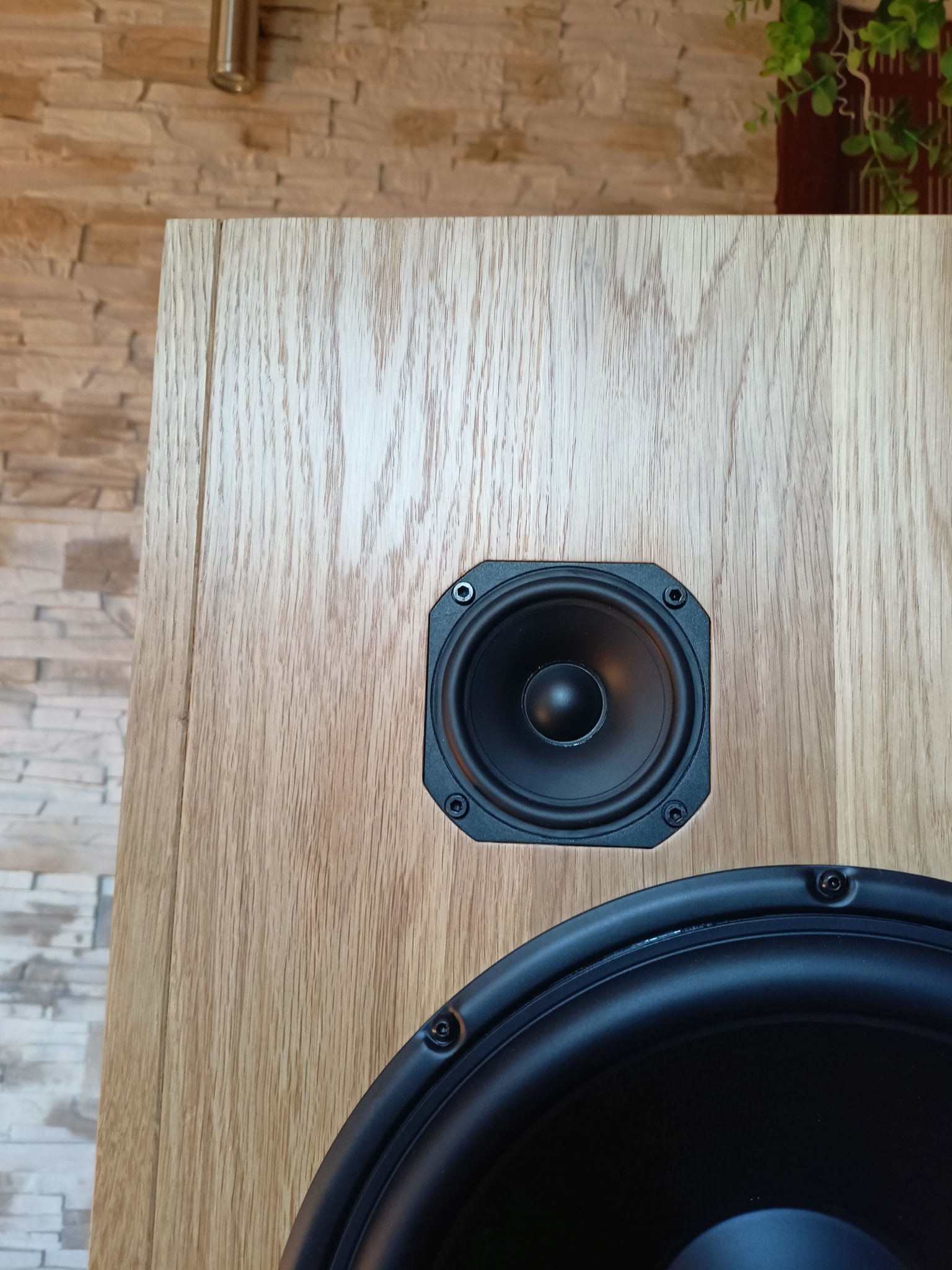

Note the sharp edges around the VIFA. It's not good... reading the thread many people had a sound problem with it. Look at my photos.
Those look very nice, and your room should have good acoustics too!
You should put those photos here in the thread.
The room is great. Almost everything sounds good here, but the OB produces a reference bass effect.
Please remember about the quality of the voice coil for VIFA. John's advice of a minimum wire diameter of 1.6mm2 for an air coil is hit advice.
The quality of the bass coil is also of great importance. ERSE works very well for me, but the perfect solution may also be: https://www.parts-express.com/Jantzen-6595-18mH-14-AWG-C-Coil-Toroidal-Inductor-255-844
There is no sharp edge, it is rounded and far away from the Vifa so it can breath without sharpness or shouting. Further, as the Vifa is mounted from behind, there is a height difference of only 8-9 mm between the rear edge of the Vifa's casing and that of the baffle. I had some baffle versions and this one works great (I had a version with a funnel-shaped cutout, but this one screamed) and I had many listenings until this version turned out to be - for me - the best. But thanks for the advice.
