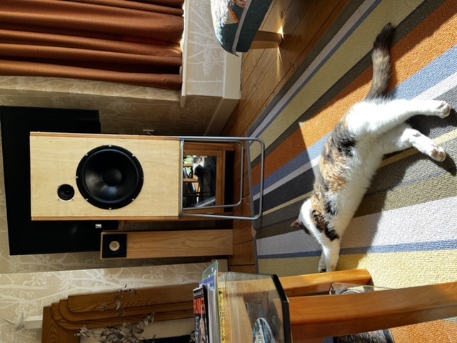

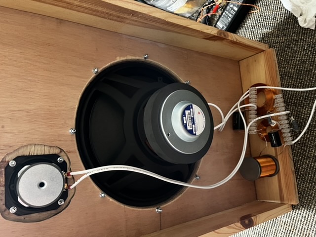

An agricultural build, but I’m using up scrap and learning to use a router. Also, the crossover is screwed together so I can play with different value bits.
I’m seriously impressed and they are just sat on the floor. I need to find something to use as stands and play with set up. The final build with have built in legs like a lot of the others on here.
Oh and despite not being an easy load, my 8W SET amp is driving them a little too loud at the halfway mark on the volume.
Thanks Pano and I’m raising my glass to John as I listen smiling.

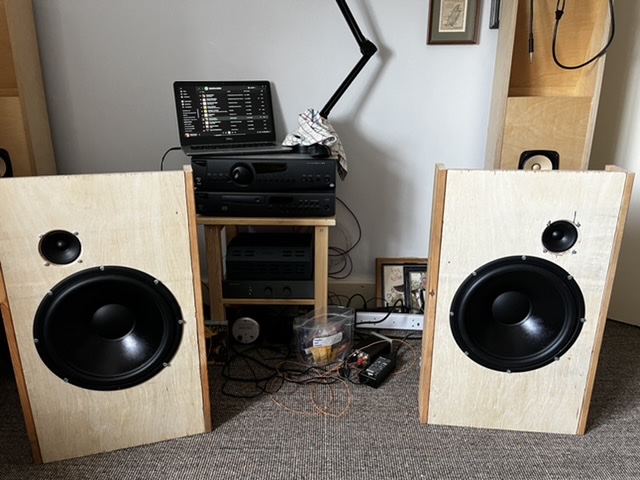

I’ve had mine on for about 8hours today.
Not perfect positioning but I at least know how high the stands should be. I think I need to tune them as the tweeter seems a little forward - well the bass seems a little further back. But on acoustic guitar and voice stuff they are fabulous. Really present. i was surprised that on my Pass F6 I really had to turn the volume up. I’m back on the frugal horns and they seem muddy in comparison.
The front room needs a layout tweak to accommodate, and a with a low WAF they need a quality build, but I think I might have won Mrs Al over on the sound front. The cat approves…

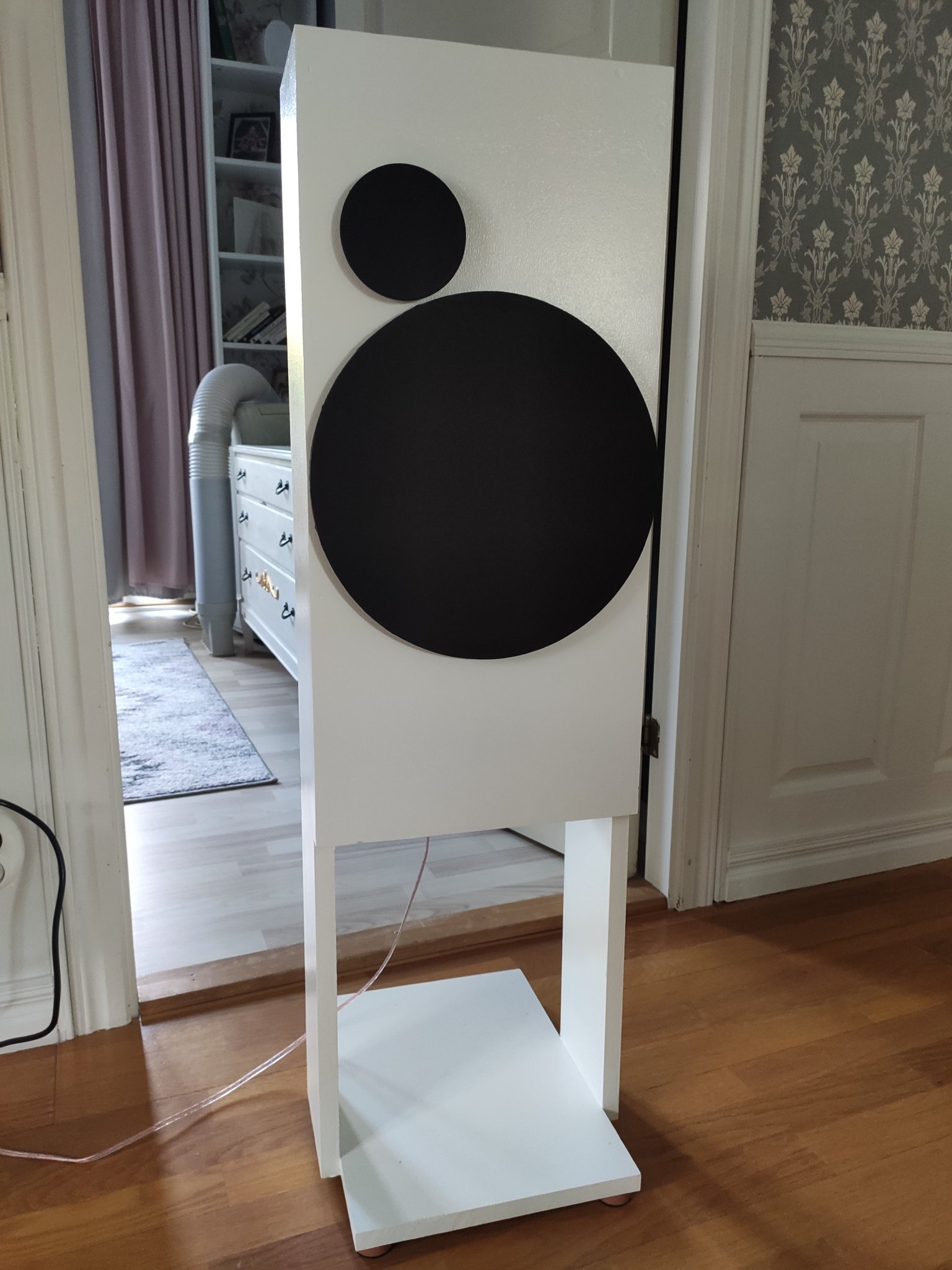

I am planning to try two other FRs, the SS 10F and the Visaton B80. I know that some changes in the xo are required, but should they also be connected with reversed polarity like the TC9? Generally, is the simulation of an open baffle xo possible in an xo simulator software?
Been away for a while, and coming back here to read that John has left us...
It makes me sincerely sad. But his legacy have left us with this amazing design that keeps on evolving. I believe that John is happy to have given us so much joy with these speakers, and that they live on.
I have been preoccupied with my work as an ILS engineer at a company that makes helicopter UAVs, so my speaker project has been suffering. But now, I have lastly finished a few things. First, I have put them on Sonic Designs sorbothane feets, to prevent vibrations entering the floor. Second, I have made covers for the elements. I milled wood rings, glued on magnets and fabric. It came out quite nice :
