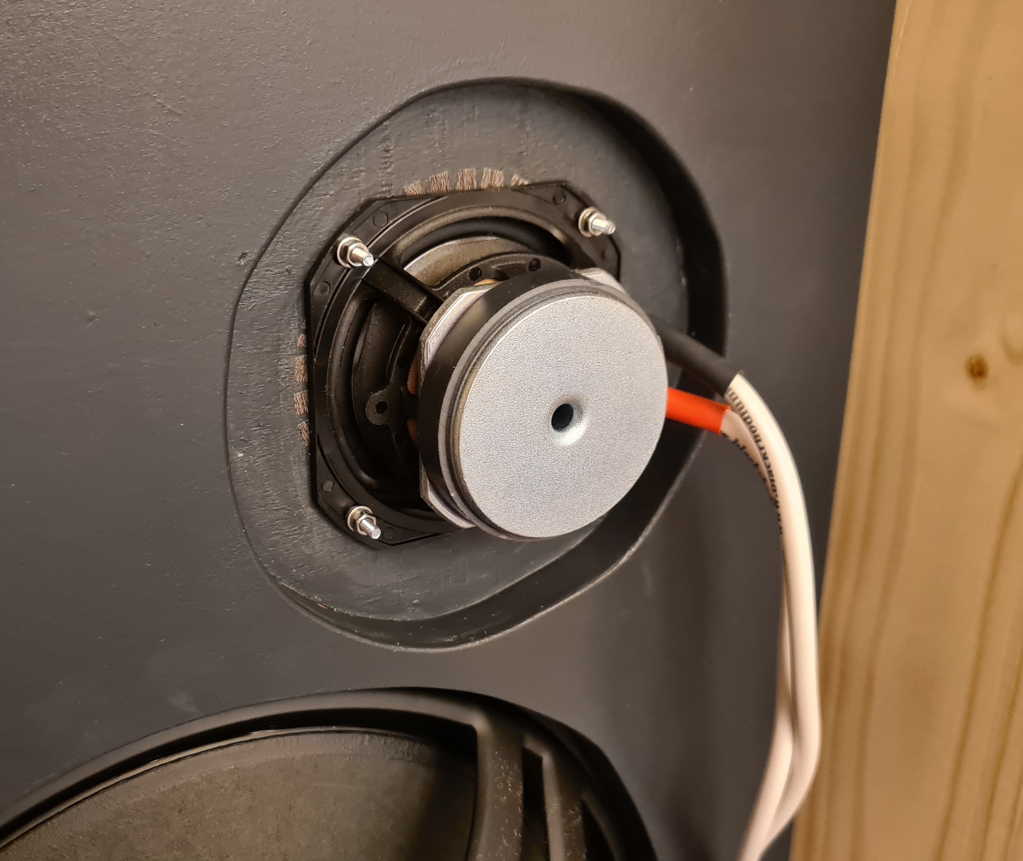

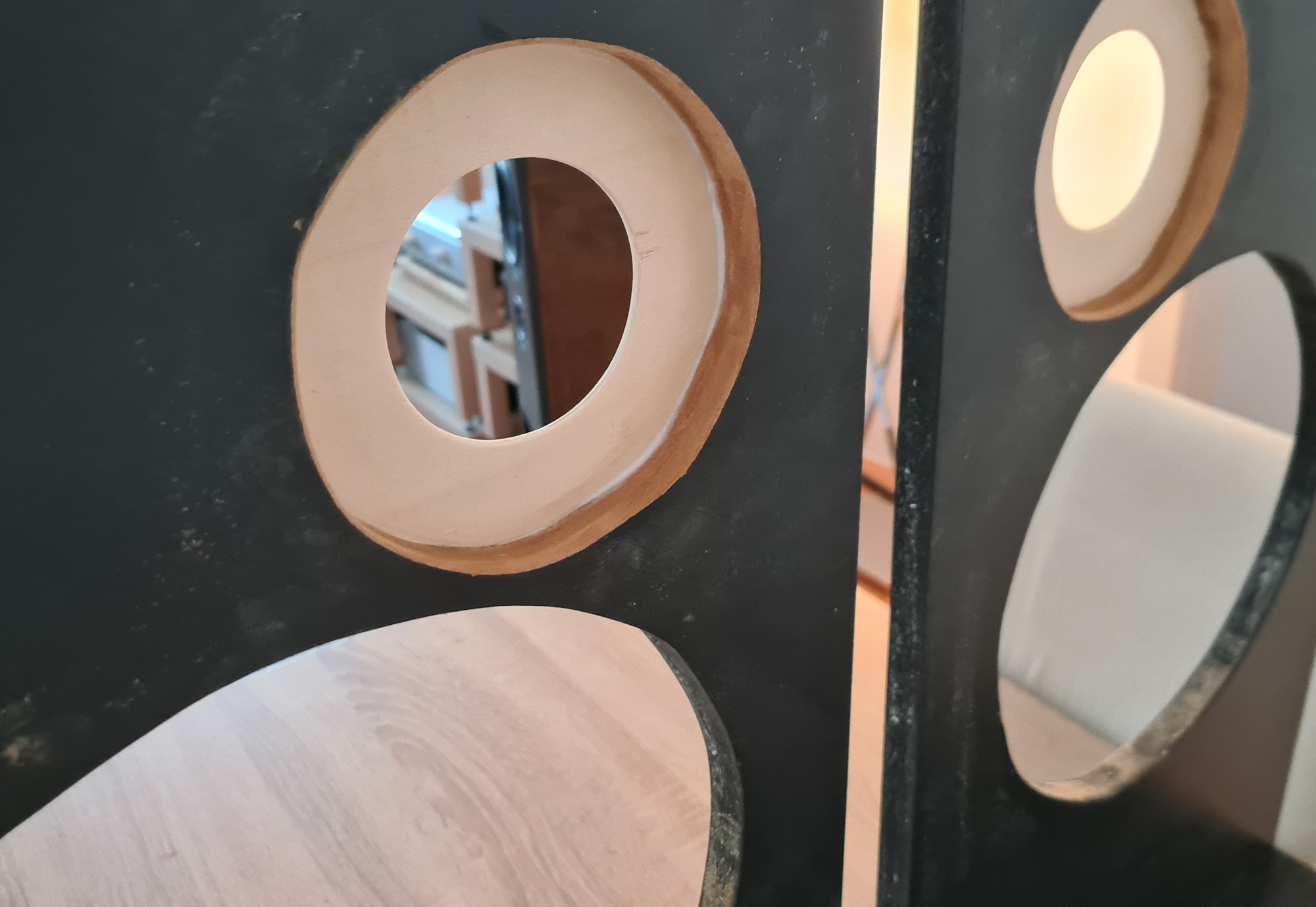

Until the new baffle material is here, I thought I can modify the old baffle. I made a cutout for the TC9 with a diameter of 133 mm, and in this cutout I sunk and glued a 4 mm ply with the exact same shape as the cutout, flush with the surface. Now the TC9 has plenty of room to breath freely.
That looks great. I did something similar on my build years back.
I also ended up adding filler to the outer edge of the cut out to smooth things out. It prevented a resonance that was there with the sharp edge. I like to think the music now gracefully slides out of the hole ...
It seemed to make a difference and it was cheap.

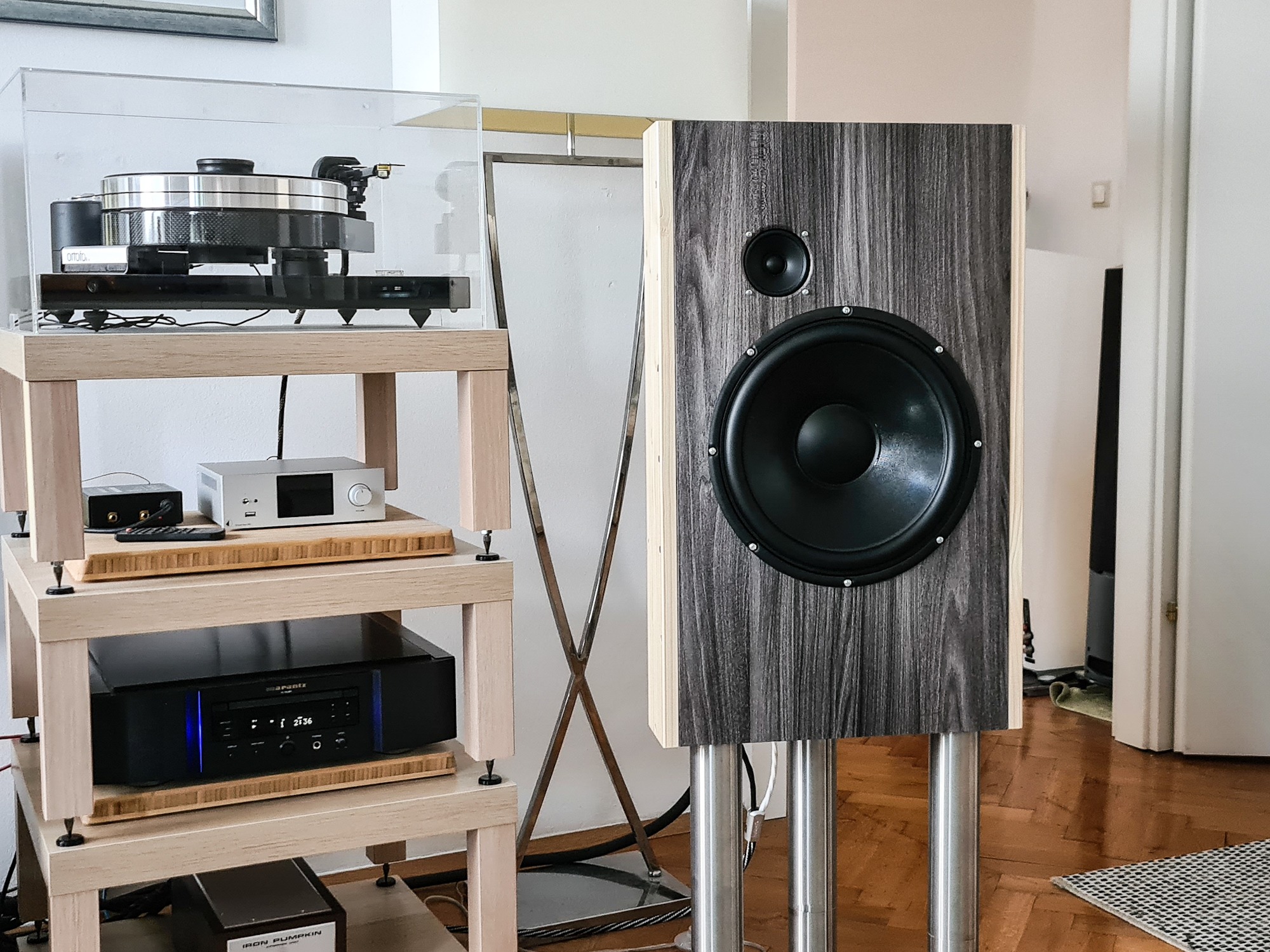

Hi, I have not been lazy since thursday and have completely rebuilt the Manzies.
The result: an incredible change, the sharpness is completely gone, they just make music beautifully.
The mids are crystal clear, the bass is deep, punchy but not boomy, the highs are very finely detailed - I'm thrilled.
That's why I decided to complete the finish, and with the ordered resistors I will only - if at all - make small adjustments.

As I wrote, first I opened up the cutout for the TC9 to more than 130 mm and in this big cutout I sunk a 4 mm ply baffle for it. So the TC9 has now a plenty of room to breath and I think this is the main reason for the huge improvement. Further, I shortened the "base plate" from 30 cm to 15 cm, and the legs are now placed near the edges of the base plate; I think the smaller surface of the base plate causes much less resonance.

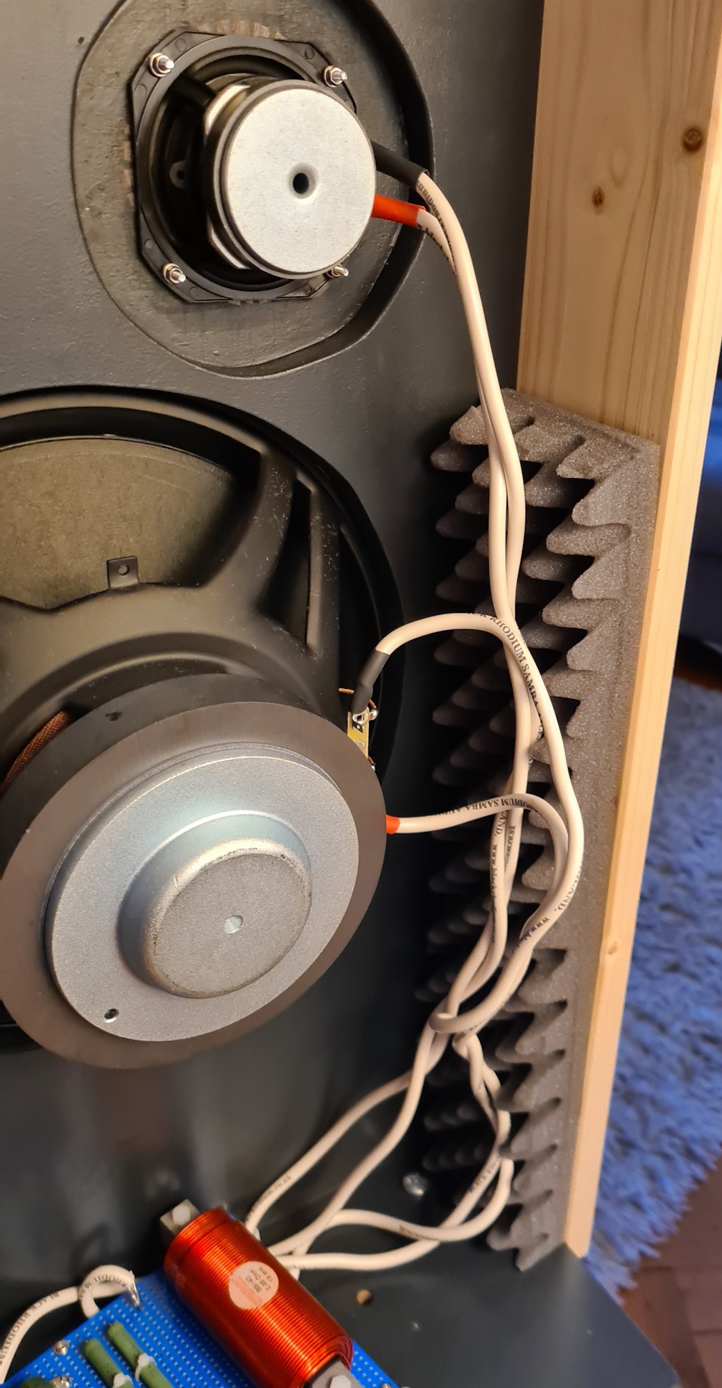

Could we see the back of them please? I’m interested as I will hopefully start my build this month (waiting on parts).As I wrote, first I opened up the cutout for the TC9 to more than 130 mm and in this big cutout I sunk a 4 mm ply baffle for it. So the TC9 has now a plenty of room to breath and I think this is the main reason for the huge improvement. Further, I shortened the "base plate" from 30 cm to 15 cm, and the legs are now placed near the edges of the base plate; I think the smaller surface of the base plate causes much less resonance.
SureCould we see the back of them please? I’m interested as I will hopefully start my build this month (waiting on parts).
The cables have not yet been finally laid, i will do it if the xo is no longer changed.
Ooh that’s neat 👌Sure

Today I played with some damping material, out of couriosity.
I took my favourite jazz cd "Moon Ray" and at first I listened to it without changes.
First change: I covered the whole inner surface of the wings with 40 mm eggcrate foam. The bass is more refined and - yes - deeper. At the same time the mids and highs are not so open. (Funny: the best of all wifes comes into the room and asks me - she has absolutely nothing to do with this hobby and with music - "what did you do, it sounds like it's slowed down now". Yes, that was exactly the same as what I was thinking.)
In the second step I shortened the foam to the height of the woofer - and yes, that's it! The bass is great, more exact (in my ears, under my circumstances, etc.) and deeper (?) as without foam. The mids and highs are now wonderful open and live again, somewhat refined, but without being "slowed down".
This density foam has no effect on bass ...Today I played with some damping material, out of couriosity.
