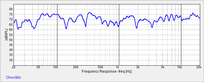

I was curious and took some measurements on my Manzanita:
Frequency response 6 dB smoothing:

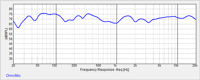

Frequency response 24 dB smoothing:

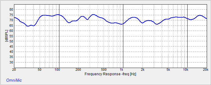

Frequency response 20° off axis 6 dB smoothing:

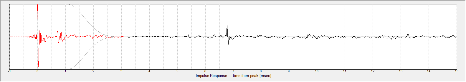

Impulse response:

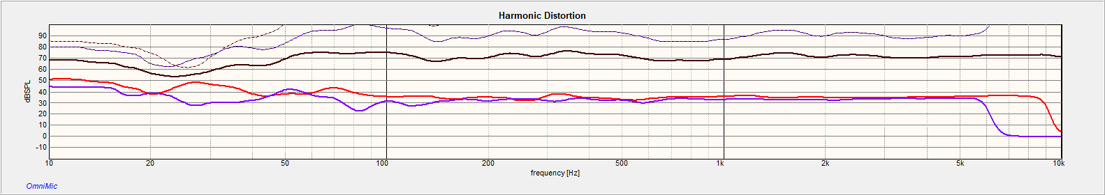

Distortion:
I was searching for the reason of the "sharpness" or "screaming", but the diagrams are okay.
However, with the sweep sine signal, in the upper mids there was an audible uncomfortable, almost throbbing area, like an echo. But I don´t see it in the diagrams, do you?

Thanks for the plots. Is that taken at the listening position with one speaker playing? The impulse would indicate one speaker.
What I do see is a rise above 3 kHz that might sound bright, but usually harshness comes lower. I would rather see a slowly falling response above ~630 Hz.
Can you export the impulse response? Not gated if you can. Does Omnimic do waterfall plots or other time graphs? REW has very good ones, but AFAIK the measurement has to be done inside REW.
What you might try is to increase the value of R2, the resistor that is in parallel with the small inductor on the Vifa. See on your plots if you can get a falling response in the top end, and listen to what that does.
I suspect it's a resonant peak, but I'm not seeing it right away. Bending down the Vifa response might point you in the right direction.
Hi Pano, thanks for your response.
Yes, at the listening position and one speaker.
There is a bump between 1 and 2 kHz, could it be the harshness?
I think I can't export the data, just make plots, but I must check it. I also think the system can do waterfall, I will repeat the measurement soon.

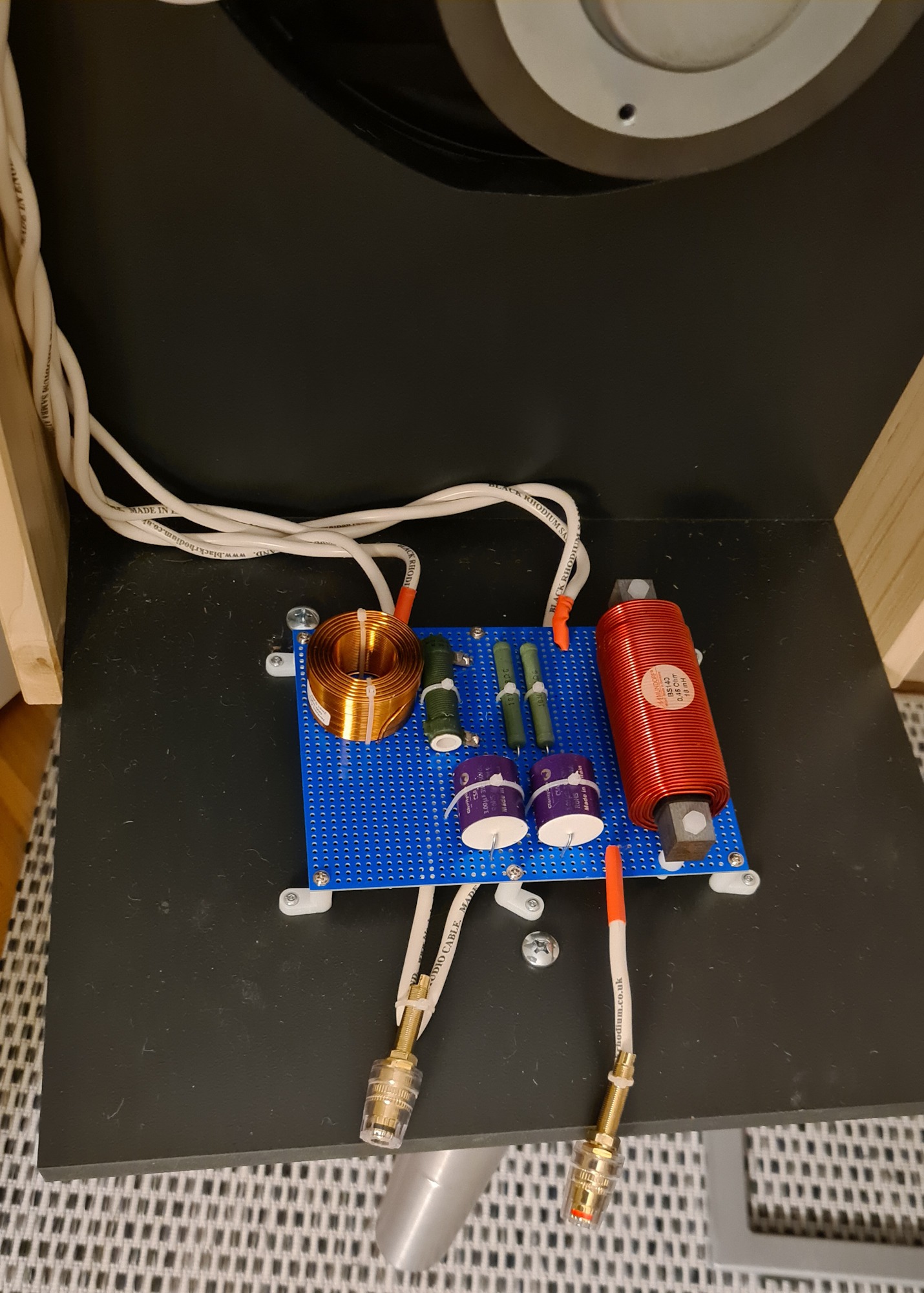

I found something interesting now, @John Busch wrote it back in 2012:
"It seems the Latest Vifa's are a bit hotter than the earlier production runs, so it seems 5.0 ohms for R2 and 15-25 ohms for R1 seem to be a better balance for most listeners."
This is a big difference to the values in the circuit diagram, where R2 is 8 ohms and R1 4.5 ohms. Why this big difference?
Because the design keeps evolving. In the latest post of crossover values, that is what John was recommending at the time. That's what I built. But I have also used rathr different values when the room acoustics called for it. OB has so much sound going out of the back and bouncing back that tuning to your room becomes even more important than with box speakers.Why this big difference?

Which values for R2 could be fine? I know, it's difficult to answer, but... should I go for 12 and 15 ohms? Or higher, or maybe for 10 ohms too? Should I think about changing/increasing R1 too? Or just try and error, because the design is forgiving?
