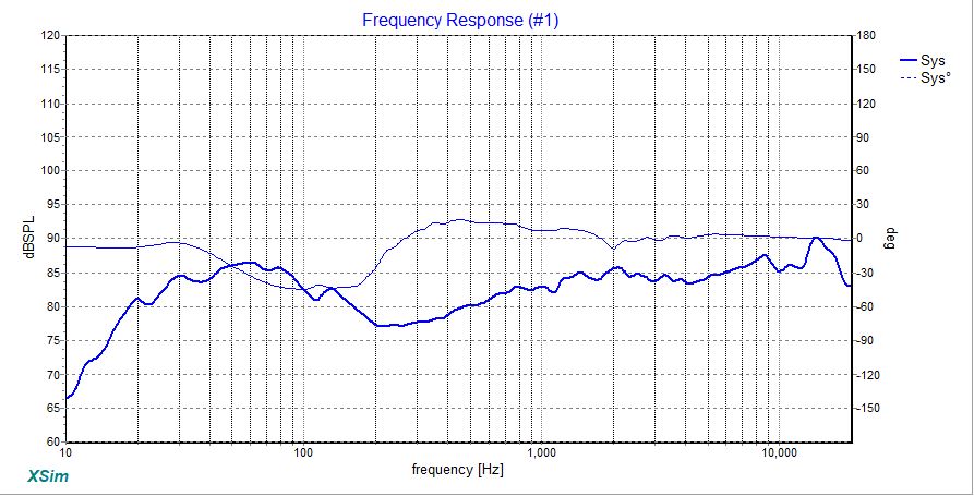

This is just a simulation, NOT measured, but it does illustrate well what happens with the response of a 12 peerless on the Manzanita baffle. It shows what happens when you put a large inductor in series with the woofer. Blue is no inductor, Red with the inductor. With no filter or EQ, we see the rising response of the woofer that is caused by the OB bass losses. Pop a big fat inductor on it, and the response flattens.
Seen here (a little bit) is the baffle peak that when flattened, makes a top end roll-off of the woofer. This sim does not show the natural roll-off of the woofer the top end which will make the roll-off even steeper.
That's the basic John Busch OB trick. You know, like the click bait ads "Use this one weird trick to fix your OB!" 😀
It works great, but you lose a lot of woofer sensitivity. Often 10 dB. But that's what you have to do to get a proper tonal balance. Too many OB builders don't understand this, or don't want to trade away the sensitivity and so end up with a poor tonal balance, not enough bass. If you want OB bass, you need either a huge baffle, or you trade away sensitivity. That's the physics of the Open Baffle.
It took me a long to to understand what John was doing, because I was so used to normal boxed woofer crossovers that work just on the top end of the woofer response. This crossover is both EQ and crossover rolled into one. I hope that is clear from the graph above.

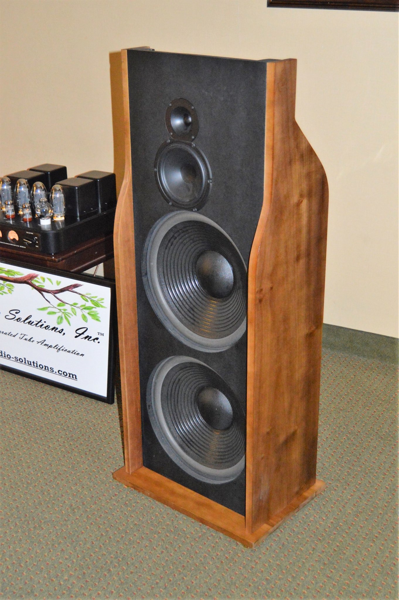

Pano mentioned the sides being uneven to reduce cavity resonances. John used a similar approach on the Widowmaker III (below) although I'm guessing a big part of the wings was to keep the size of the front baffle less wide. He had a tough time selling his speakers as they tended to be pretty large and wide. Sounded great, thought. So on the Manzi it was likely a similar attempt to keep the baffle smaller while keeping the bass intact.
