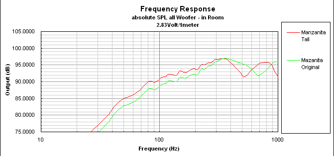

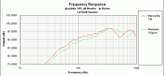

Paniomaic, the plots shown in my last posting are " in room " measurements. They show what the speaker does AND what the baffle does AND what the room does at a SPECIFIC position of the speaker AND the mic.
Please don't interpret too much from them. It wasn't meant to be scintifically but just to have a good startoing point for own experiments on a active setup with the Behringer DCX2496.
It shows that there is relative good balance obtainable with not very much effort. And that the original XO can be translated to active amping with remarkable little change.
It was a "quick and dirty" setup though, within half a day – included buying the material and producing some sawdust - heavily based on measurement and not so much on listening. Though it turned out pretty well, everybody is invited - and actually SHOULD – tweak it to his / her taste.
The brightness expected isn't there, maybe the result of the rear tweeter ( IMO its ALWAYS of benefit so I didn't even try without ) but the tweeter for me was too early unless I delayed it.

Bratislav, no need for correction at 300 Hz - its an artefact.
I did some FFT measurements that exclude the room.
Naturally it reveals a lot of details one normally doesn't like to see, though we have to keep in mind that a good looking FR has NOTHING to do with good sound from a speaker.
This plots show the Peerless SLS12 without XO but with the high shelfing EQ.
What can be seen is that there is NO stored energy at 300 Hz. Though the window used limits the valid FR range to above 300 Hz – indicated with the yellow bar at the X-axis – we would see a severe peak for sure.
What jumps into the eye are the resonance in the cone break up region.

panomaniac said:Hey Michael - that's great!
I'd love to hear your version, but the hills of Austria are just a little too far from the hills of Hawaii. =)
Nice work. And thanks so much for the graphs and measurements - they go a long way to explaining what is going on. What is the crossover software you use?
I'm suprised at how flat you got it. Just seems to be a peak at 3Khz. Cone break-up? Baffle nasties?
My main question would be this:
Given that your measurements show flat (more or less) at 1M in front of the baffle, do they not sound too bright in room? Is there a lot of mid energy coming off the back of the Peerless and filling the room?
The original pair have a big midrange dip in the crossover to counter the midrange energy coming from the back. I see that your soft crossover does the same thing, but the resulting FR looks a lot flatter than I would have expected!

Thanks for the graph, Pete.
Yep, that looks about right. Making the baffle taller gives you a bigger F-peak and some more energy in the mids. That's going to change the tonal balance some, so you may, or may not want to juggle crossover values a bit. Looks like about 1dB difference, so it shouldn't be a big deal.
When (or if) I find a good answer to the shift, I'll be sure to post it.
Just for fun I ran the response of the Peerless woofer on 2 different baffles sizes to compare.
Green is the original baffle, Red is a 1M tall baffle (puts the tweeter at ear height when sitting).
As you can see, only about a 1.5dB gain. So it should be easy to handle. Maybe just a smaller resistor on the tweeter to make up for the slight gain from the 12".
Note that the graphs are before any EQ and the side wings are not accounted for.
