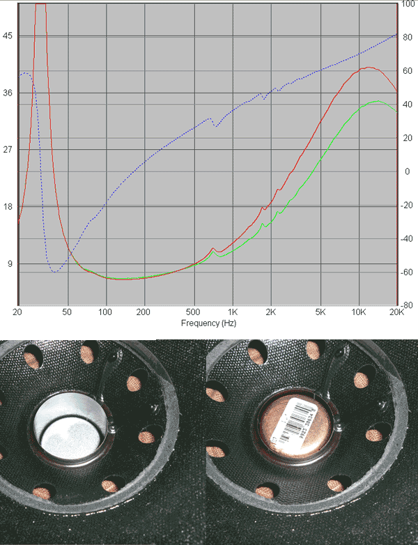

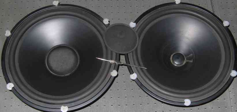

"......................has anyone tried to remove dust cup and put phase plug in SLS 830669 ......................"
This got me wondering. I had removed the dust cap from an 8 inch driver and with a phase plug it did sound better than the stock unit . Some of the 'cuppiness' was reduced.
So I took my 12 inch Peerless 831859 driver and wet the glued area of the dust cap ( cloth) with Amyl Acetate. After 20 minutes I put another round of the solvent with a thick paint brush. After another 15 minutes I carefully pried up one end with a sharp pointed rod ( from an old compass set ). You can see it in the picture. The end lifted up after a few tries. Then I pushed it in further till that bit lifted off the cone ( poly prop ). Then I just slowly pushed along the 'needle' all around the edge of the dust cap and the whole thing lifted off. Cool ! I had to clean up the residual glue. It seems to be rubber based or similar.
I have an 18 x 35 inch baffle on which I wanted to try out an OB with either an 8 inch or a 12 inch bass mid. 12 inch for mid seemed a bit tough.
However with what I hear on the 12 inch I think I should try it out.
It sounds better without the dust cap but not enough to work without a crossover. However at average listening levels I don't hear any 'shoutiness'. More 'cuppy' I guess.But not too bad at all.
The pole piece seems to be covered with something black. Could it be a copper disc ? When I tap it ,it is sounds plasticky. Anyway I'll put on a plug and see what happens.

I guess that small cap also needs to be removed. How you'll install phase plug otherwise. Do you have a phaseplug already?
I was thinking to melt tin into bullet shape, refine it with file, and attach that plug with termal glue to pole piece.
or maybe it's possible to find copper or aluminum rod with appropriate diameter.
I'll mould a plug out of candle wax first . After I have decided which shape to use I'll make it out of wood or have it turned out of aluminum.
That plastic (?) cap I found is unusual . All pole pieces I have seen so far are bare ( flat ) metal. However I'll stick the plug with double sided tape for now. Only if I decide to make it a permanent fixture will I glue it with something stronger.
ashok said:However I'll stick the plug with double sided tape for now.
You might find a couple screws in the base of the proto plugs a better temporary solution.

terry j said:then wouldn't there be many more straight from the manufacturers
I'll let the pros tell you the positives and I'll handle the negative. Removing the dust cap exposes the voice coil to the environment. It can't have a positive effect on the longevity as I see it. Mind you, my speakers are often flapping away like a boring guys lips so there's not much chance of Mr Grit getting in there and spoiling the party.
EDIT: Always remember to store your drivers face down. You don't want the gravity monster dropping dust bombs in there.
Planet10 : Thanks for that suggestion. Actually I already planned on that but the cap on the pole piece seems to be fairly thick and is non magnetic. So the 'force' is not much on a fairly large sized screw. Maybe it's OK for initial testing if the plug is not heavy.
The plug will affect the HF response. For my tests done by just listening , here is what I found.
1. There is more HF and so music sounds better . Remember this is a 12 inch driver.
2. Some cuppiness in the mid range drops without the dust cap and gets even better with a crude phase plug.
3. A crude phase plug lifts the treble some more and transients sound crisper.
4. My opinion is that voice certainly sounds better without a dust cap and better with a phase plug.
5. You might want to keep in mind that this stock driver appears to have a pretty flat frequency response and no severe cone break up indications on the frequency response graph.
6. The plug should affect the off axis response and I think it should improve it but until I test it I can't say for sure.
7. I can't say now how long the plug should be or it's prefered shape. I've seen convex and concave cones and also long tubes that end up as a stump ! So one will have to try out all aternatives .
Quick guess is a plug with the same diameter of the pole piece and half the vertical depth of the cone ( from the coil top to the front of the cone). Then half or three quarter the length from the front of the plug made into a curved cone . Most are fairly rounded.
Even on a filterless listening test the stock driver sounds pretty good without any 'shouting' or rough sounds in the upper octaves. MANY smaller drivers tend to be 'noisy' beyond their normal operating range. So I'd give this driver a big plus on that .

terry j said:is there any real reason that a phase plug will improve things?? If it was some sort of 'universal law' that a driver would always sound better with a phase plug then wouldn't there be many more straight from the manufacturers?
Yes, there are reasons why a phase plug helps in many cases (not in all cases).
Inside the voice coil above the pole piece an oil can resonance occurss. Removing the dust cap decreases this somewhat. The prime purpose of the phas eplug is to fill the hole and leave no room for the resonance to occur.
Further, if long enuff it decreases the distance acrtoss the cone (pushing radial resonances across the cone by an octave, and depending on the shape it will affect the HF dispersion.
Reasons for manufacturers to not fit phase plugs include momentum (big maufacturers tend to be very conservative), they increase cost, and as Cal pointed out, dust.
dave
yes indeed, holes create air turbulence and increased distortion (I measured it).
I just taped them with simple electrical tape and all went back to normal. main reason for cap removal is addition of shorting ring and phase plug. the problem is how to secure phase plug and ring, maybe with thermal glue..
