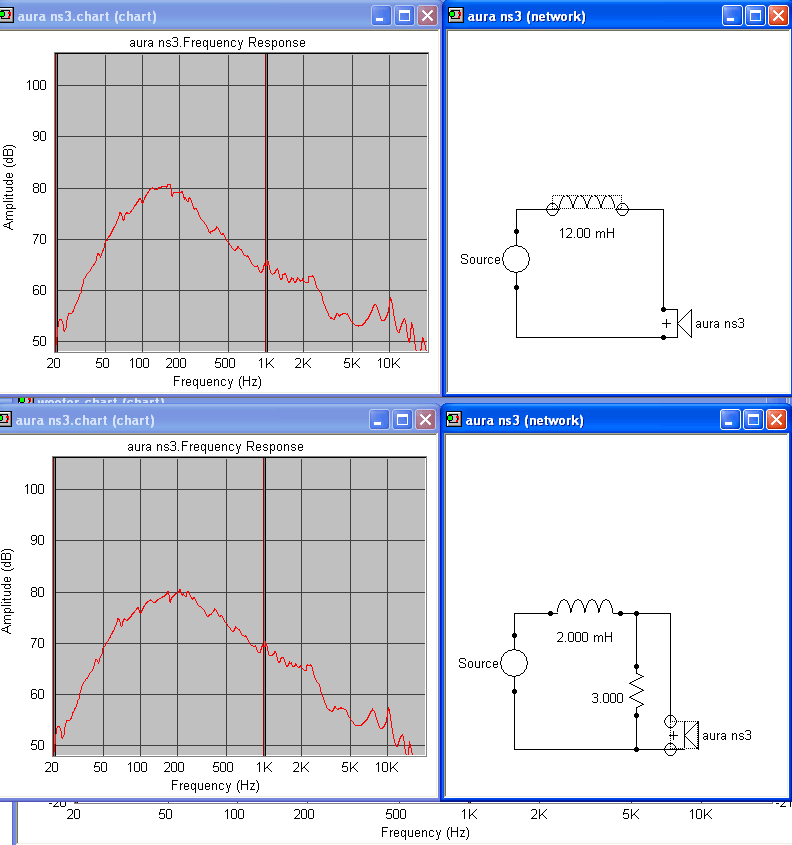

stripped top damping layer from cone
slit cones
sprayed with damping spray
red impedance curve is before, green curve is after mods
slit cones

CLS, yes, fs is lowered because of added mass.
i noticed that after all these mods there is much less ringing at high volume.
even though there is almost no cone breakup, these woofers still did not sound too good, when played full range. because of large paper cone energy storage I guess...

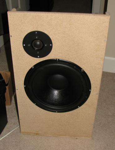

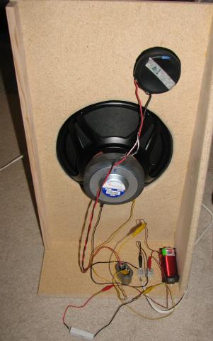

I built a pair of these for myself yesterday, see pics below.
Not using the same tweeter, I've got the old ScanSpeak 3806 installed. The monster tweeter - alas no longer made.
Sounds great with just a 13.5mH coil on the woofer and 5uF + 5.5R on the tweeter. Crossover point is about 1100Hz, acoustic.
As the cutout for the SS3806 is so large, I plan to try a few small cone drivers in its place. E.G., Fostex, TB, Aurasound, etc. Will probably cross them 2nd order HP at about 1100Hz.
My hope is to find a nice, big, open back "tweeter" to mate with the Peerless woofer. That might encourage a few more people to build this fun speaker.
Stay tuned.
