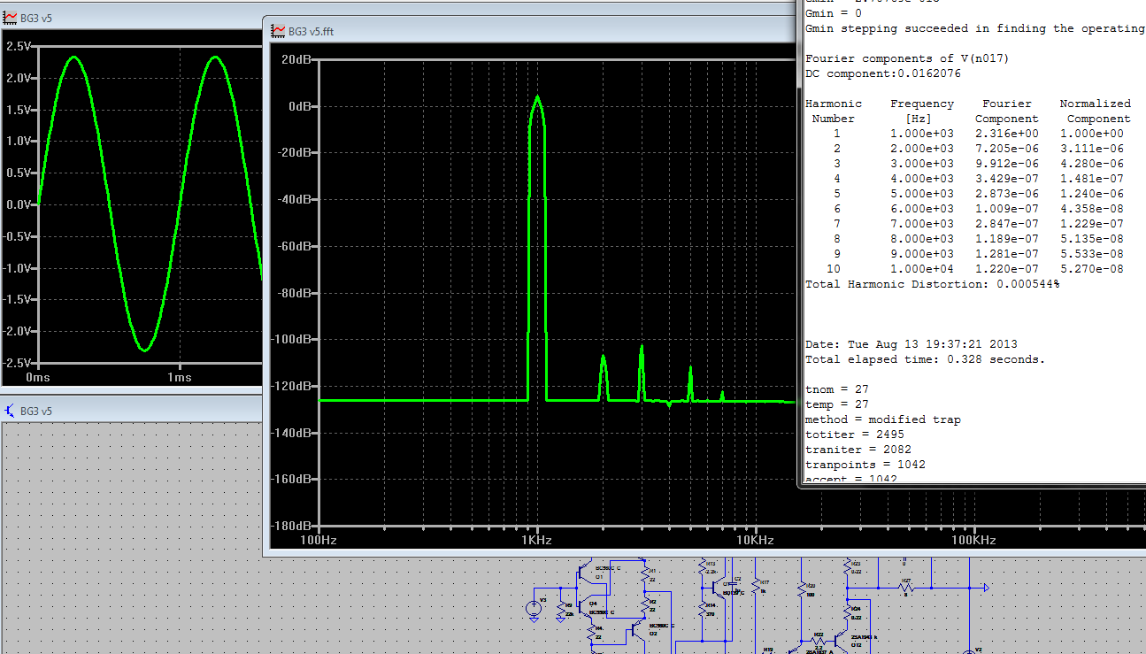

But BG1 is not the lastest amplifier :p
BG2 Mini (has been released few weeks ago), and now just passed first tests the BG3 - diamond input + TEF amplifier (first impression is really nice).
Simulation of BG3 bellow (measurements later on), after I will finish it i will release schematic.

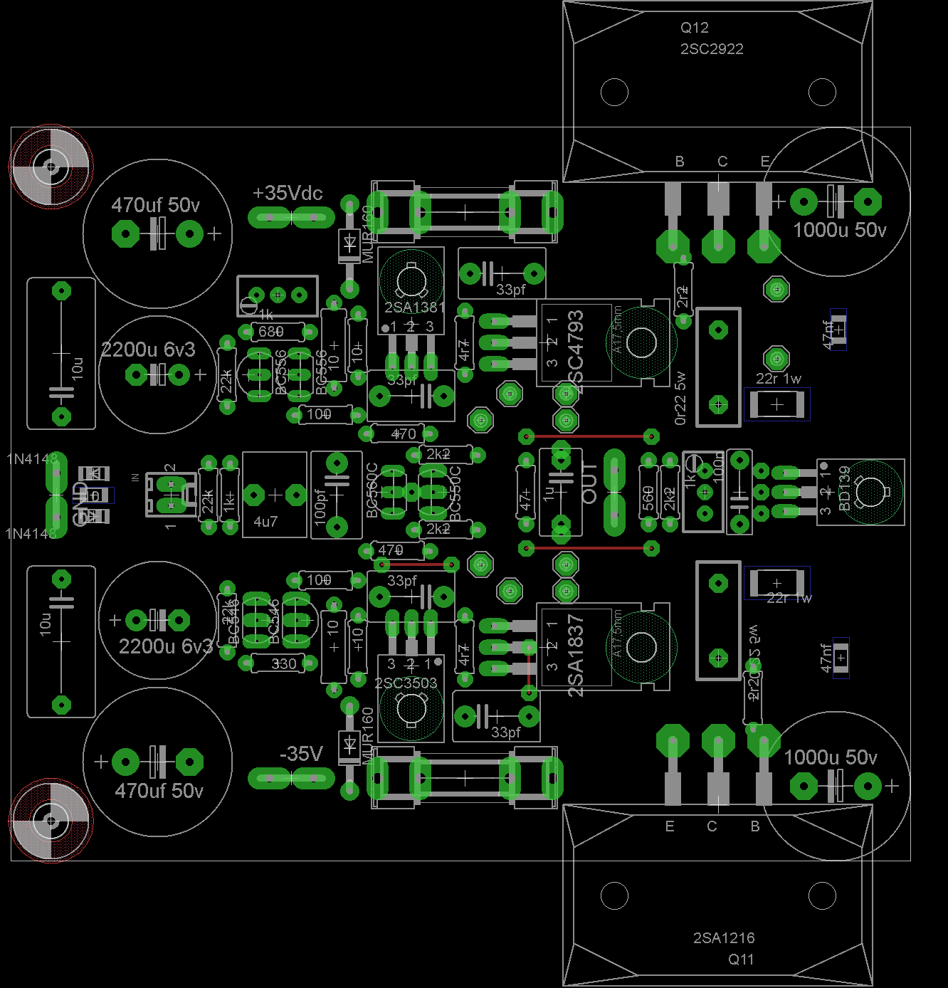

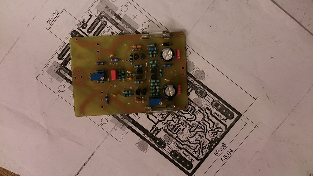

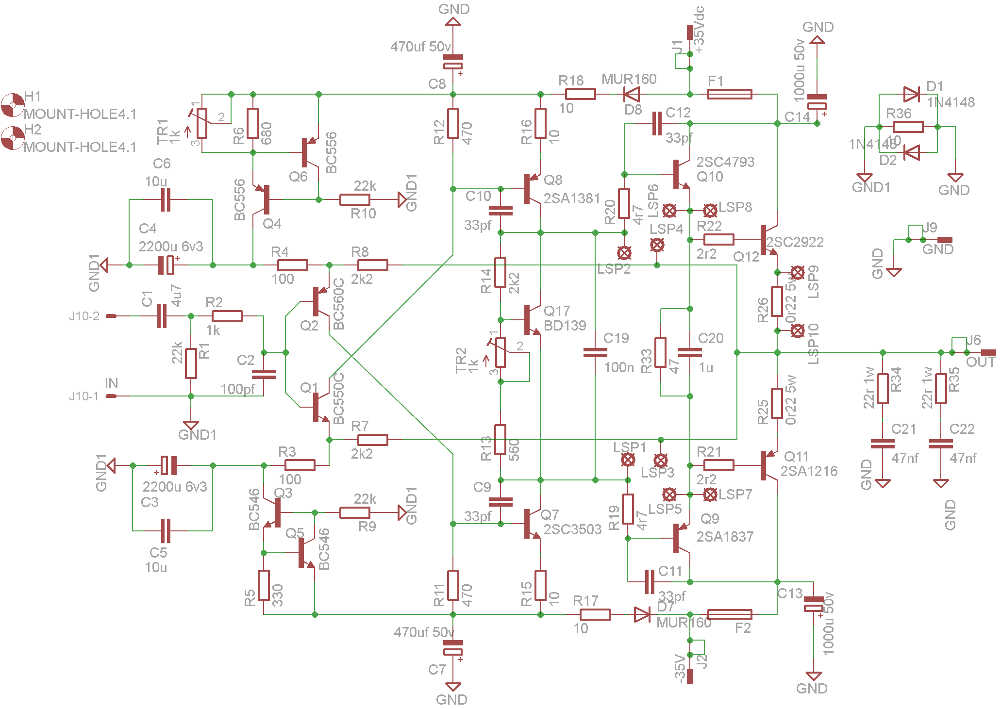

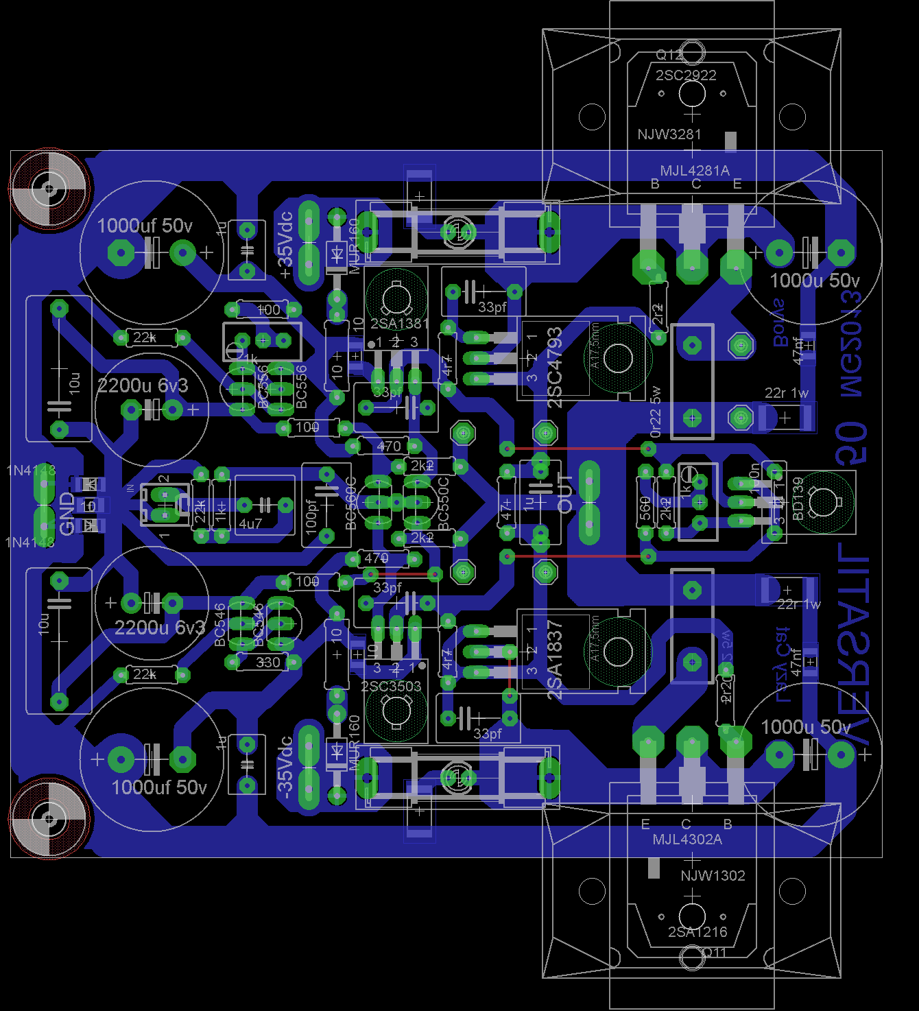

TR1 (1K) and R6 (680) should be in series. If they are parallel, there is possibility to equalize voltage of the base and emitter of transistor Q6. You can decrease R6 to let say 100R and keep value of TR1.
That is correct.
The original idea was after you set up the offset replace the trimmer with resistor if you like.
In one word no need for both.
Greetings G
Yes but, before power up the amp You must set trimer/resistor combo to 330r, after that you will need only couple of turns to set the offset (I think is safe enough)
Second trimmer (bias) set at max value before powering the amp.

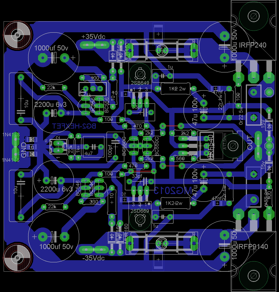

Could you provide a schematic based on BG2 with mod in bias area for 2sk1530/2SJ201 use?
Marc
I will draw tomorrow evening (but I think You mean BG1 with Toshibas cause BG2 mini is VFA simple amp).
In bias area You do not have to change anything, in case You can not get mosfets polarized you can replace 560R (lower one) in biasing circuit with 100R.
In my case mosfet toshibas are from group O and I have to get approx 4V between gates to get 100mA o/p bias.
For 2sj201/2sk1530 I would keep BJT transistor in bias servo, bias is approx 30% overcompensated.

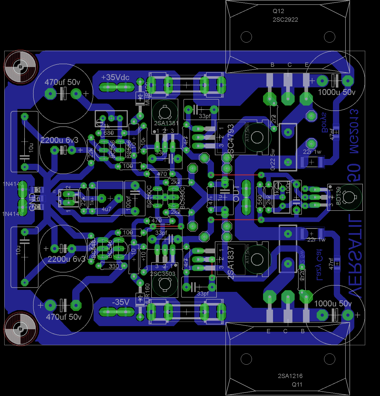

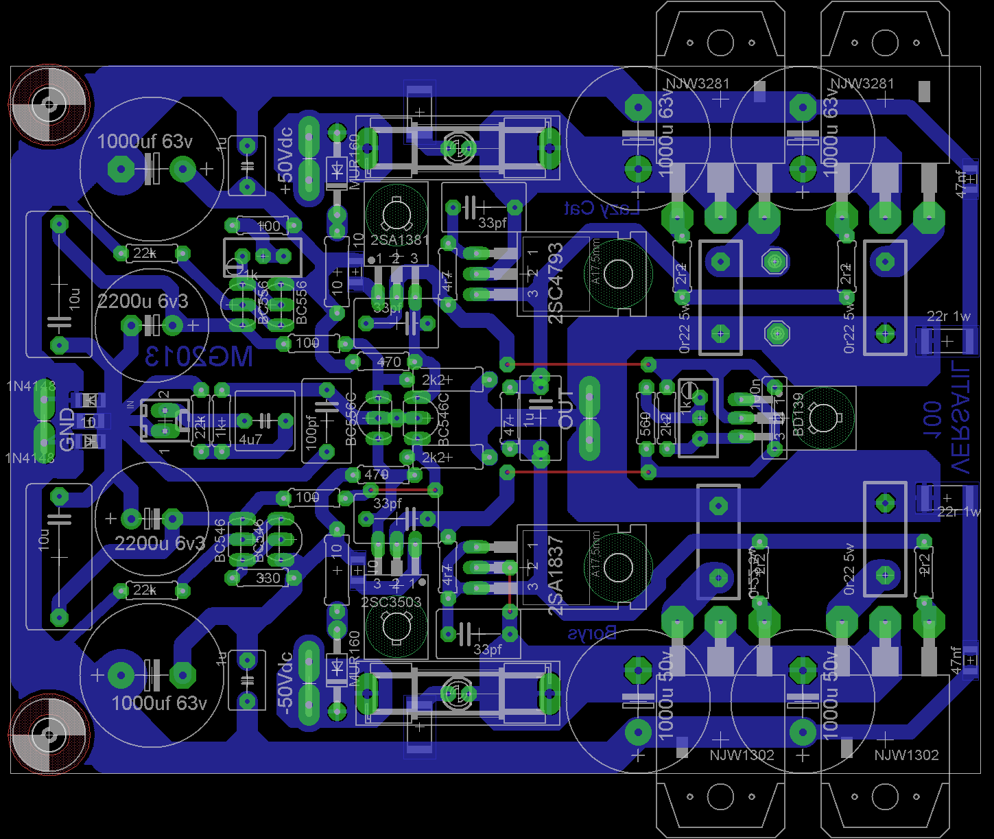

During my holiday i take my computer with me and continue to work on versatil version. Next week i will order some more epoxy to eatch Versatil 50 (one paire output) with MJL4281/4302 in test, Vesatil 100-3P (2 pair output) with MJW3281/1302 and BG2 Hexfet with one pair IRFP240/9140. Today i cut some MDF for Versatil 50 enclosure.

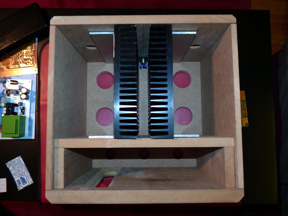

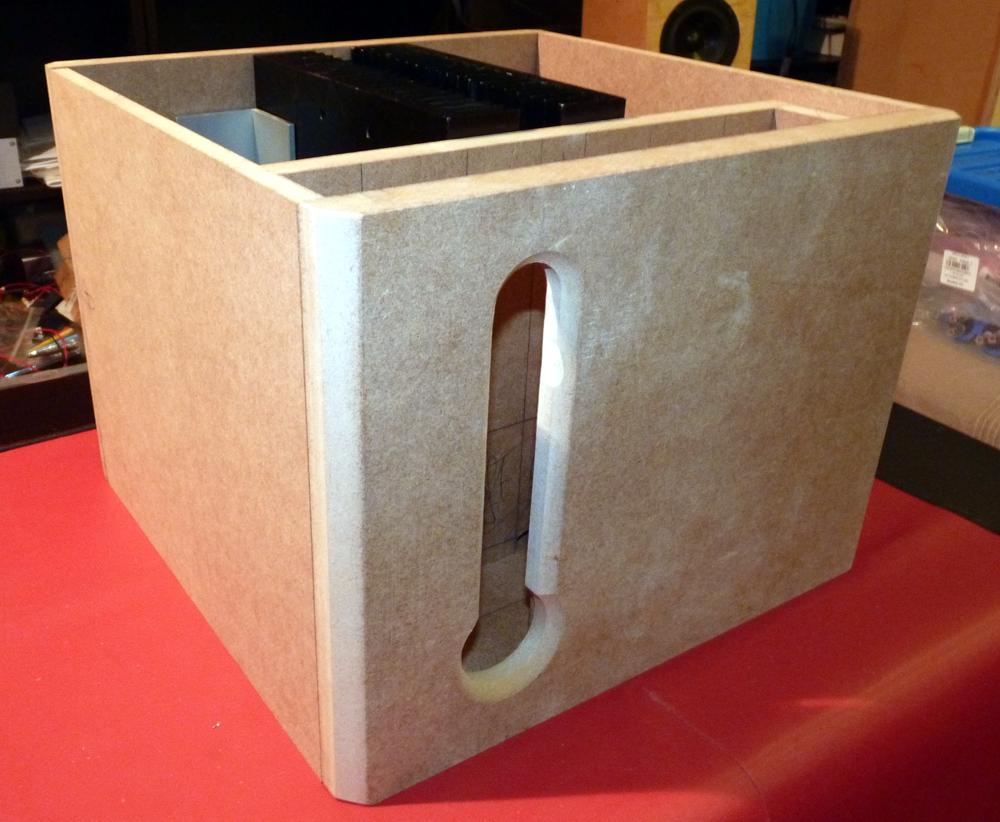

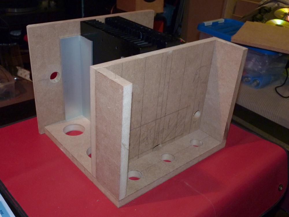

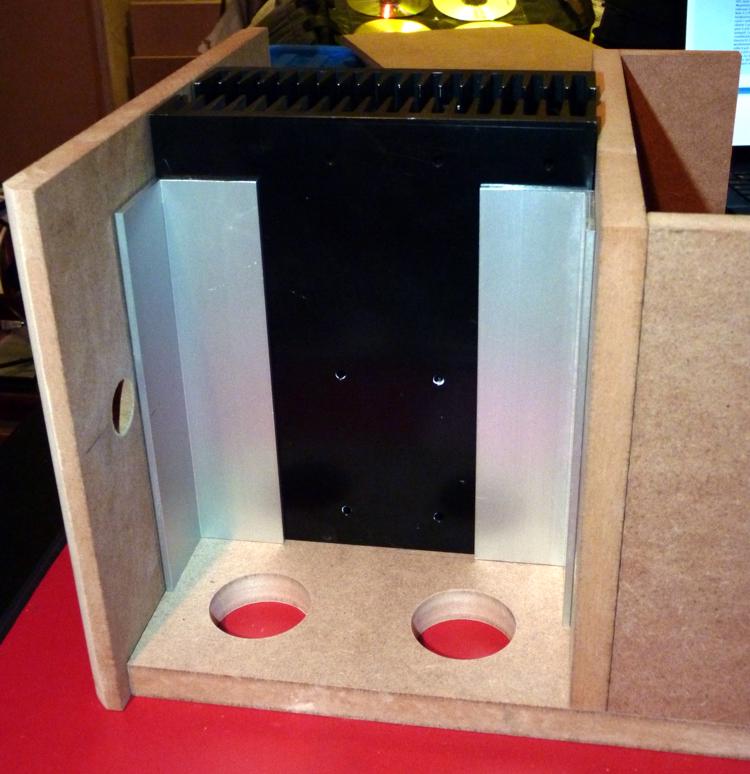

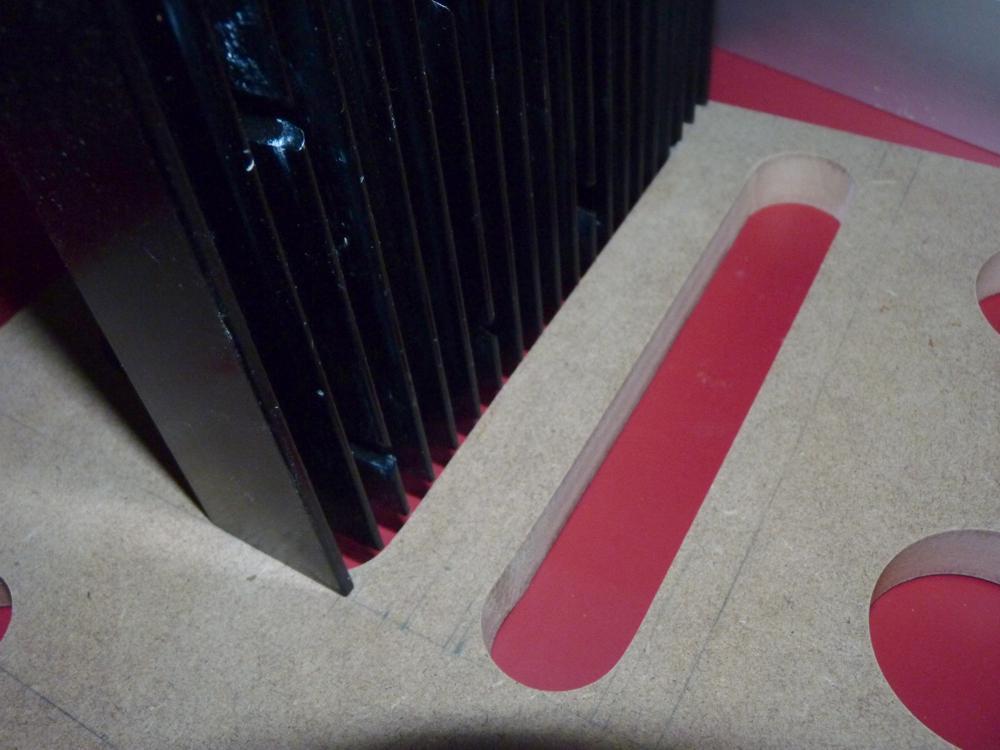

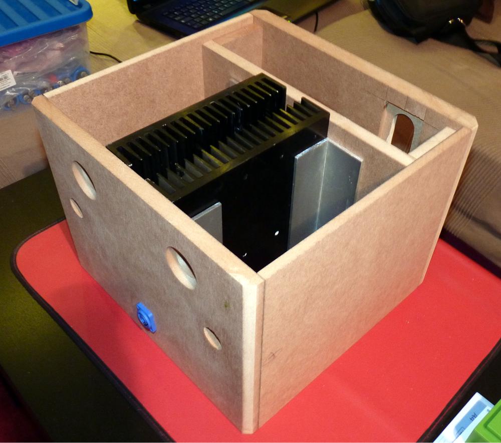

Today, i finished the cutting and routing job except top cover (i need to buy one more MDF pieces) on Versatil enclosure. The front compartiment will hold the 2 trafo and soft-start. I routelarge hole in the bottom plate to have good air circulation on heatsink.
Next step will be some gluing and than two layer epoxy resin and go for glossy black finish.
