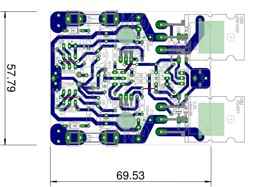

Hi gaborbela!Marc those PC boards design and quality just awesome!especially known is all hand crafted
Congrat..
Today I made the layout for the LatFet version, I have some high power dual diy EXICON and Class D mosfets, I would like to test those to.
I do have a 39-0-39V 600VA transformer for that project.
If your Capmu. work with these topology well I will use that to get some voltage drop for the one pair LatFet.
To replace the BC550/560 high Hfe BJT I still need to look around on the market and also the JFet has to be replaced by BJT.
So the lay out still need some adjustment, not 100% ready.
I separated the SGR from the main GR.
I took some of your idea for the layout, it helped alot - thank you!
Soon I'll start to make the PC boards so I can test all 4 VERSION

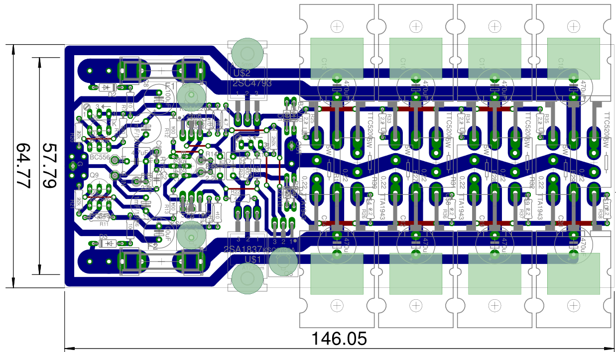

Please give show Top brd in pdf (PCB-top) of the amplifier.
Thank you!
Audio amplifier BJT with 2sc5299/2sa1943
PCB-layot and PCB-botton,
cheers!![cheers :cheers: :cheers:](https://files.diyaudio.com/forums/images/smilies/cheers.gif)
Power BJT!Hello
These layout for LatFet version only!
The tread about HexFet, or Power BJT.
What type do you want to build, please let me know- may be I or someone from these forum can help you.
We must know what do you want to build, already existing material etc.
Greetings Gabor
cheers!

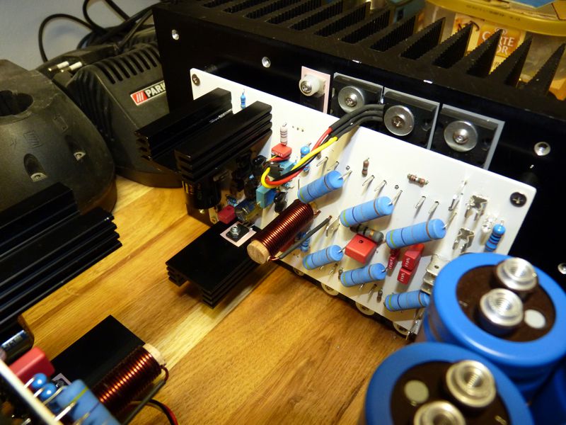

Ghost22
Bellow version that I am running with 4 or less output pairs.
For 200W I suggest to use 2 pairs of outputs.
BJT:
Do not solder 4 diodes (D1,D4,D5,D6)
Mosfet:
Solder diodes, and replace 2,2r base stoppers with 100R gate resistors.
Some tweak in biasing circuit may be required.
In the picture of my amp there are 2n5xx1 transistos soldered - they are reversed to BCxxx ones. If you need smaller pcb - cutt earth around the board and do not solder the caps next to the o/p transistors. PCB is for 4 pairs, trim the board before for 1,2,3 or 4 pairs before thermotransfer. Amp is very easy to assemble.

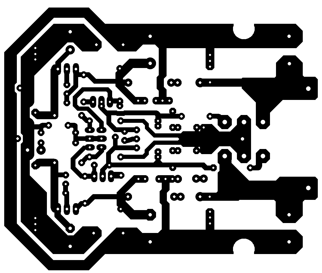

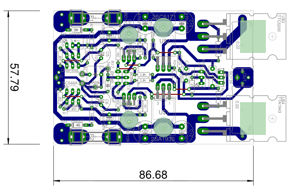

Hi Borys
Can I use your pcb with one pair 2sc5200/2sa1943.
If could, so can you post this layout in PDF file and Eagle file
Thanks.
For one pair of outputs there is another version of pcb.
You can use this above with one pair too. I will post evening time eagle file for you.

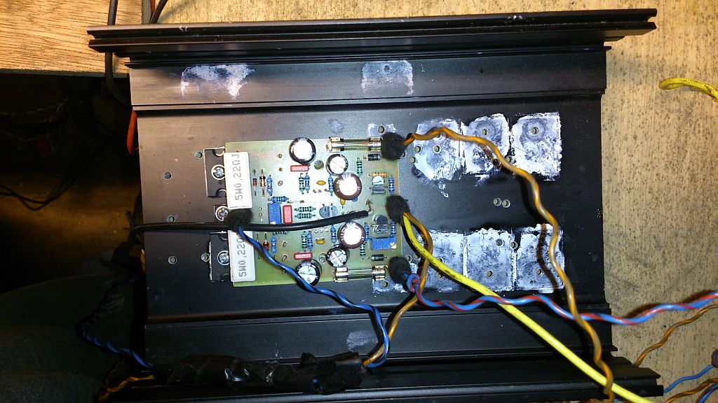

Bellow bg1-bjt and BG1 mosfet (without the drivers).
BJT version with drivers can be used with mosfets too, just replace base resistors with 100R and putt zeners from output to gates of mostets (I didnt have time to putt them).

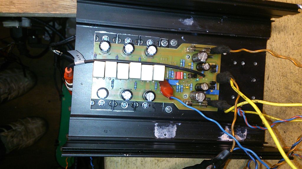

What about the sound of this?
Regards.
Thimios.
The core of the amp is vssa based and this one has good opinion.
What diffrence I found is bottom end is better presented (prapobly due to BJT at output).
The other diffrence I found is the amp without signal is dead quiet.
I think Idefixes was listening this amp bit more than me. I have to finish my speakers first to do proper A and B test. Overal it it very simple and good sounding amp with good kick on bottom end (bjt)
