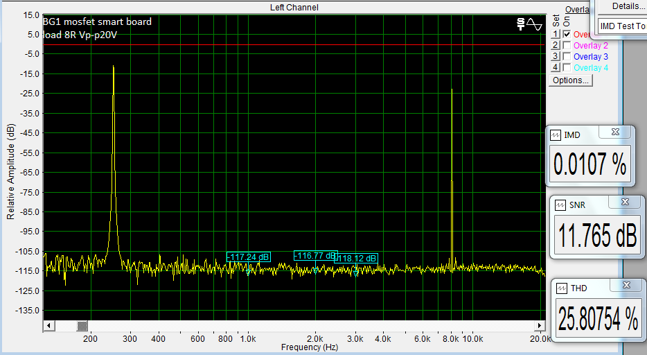

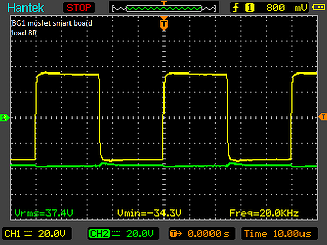

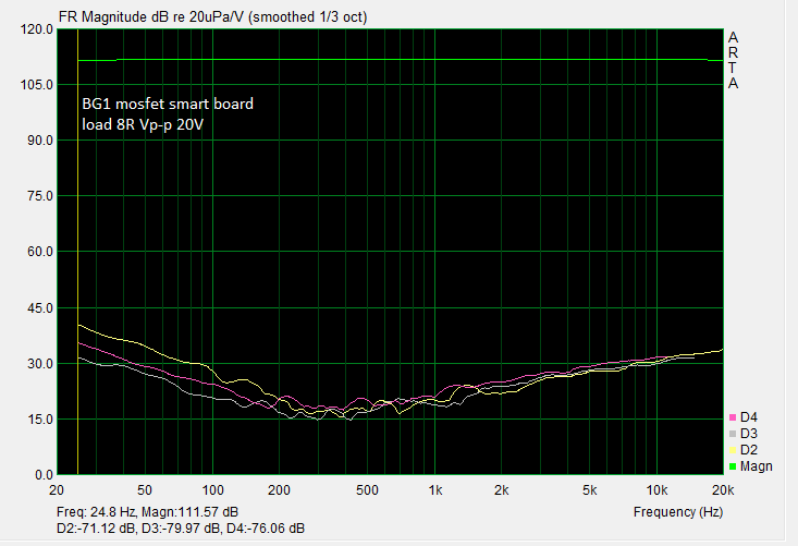

FET-hex explendit amplifier

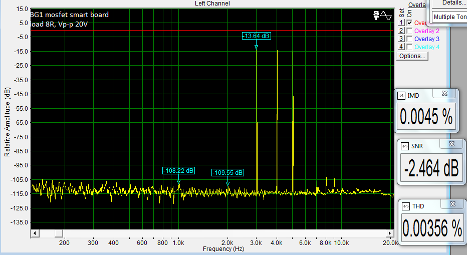

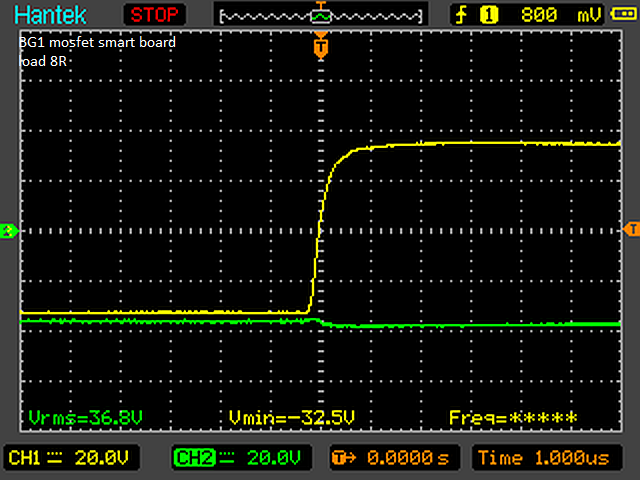

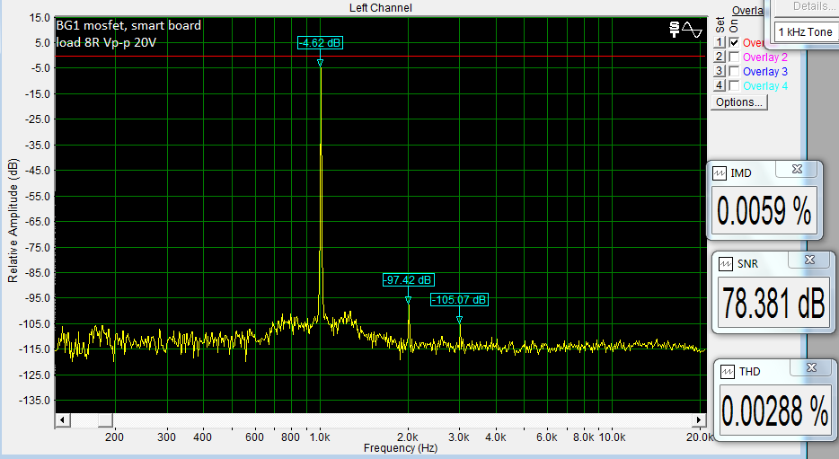

Rest of the pictures for board from post 604 --> BG1 mosfet (smart board).

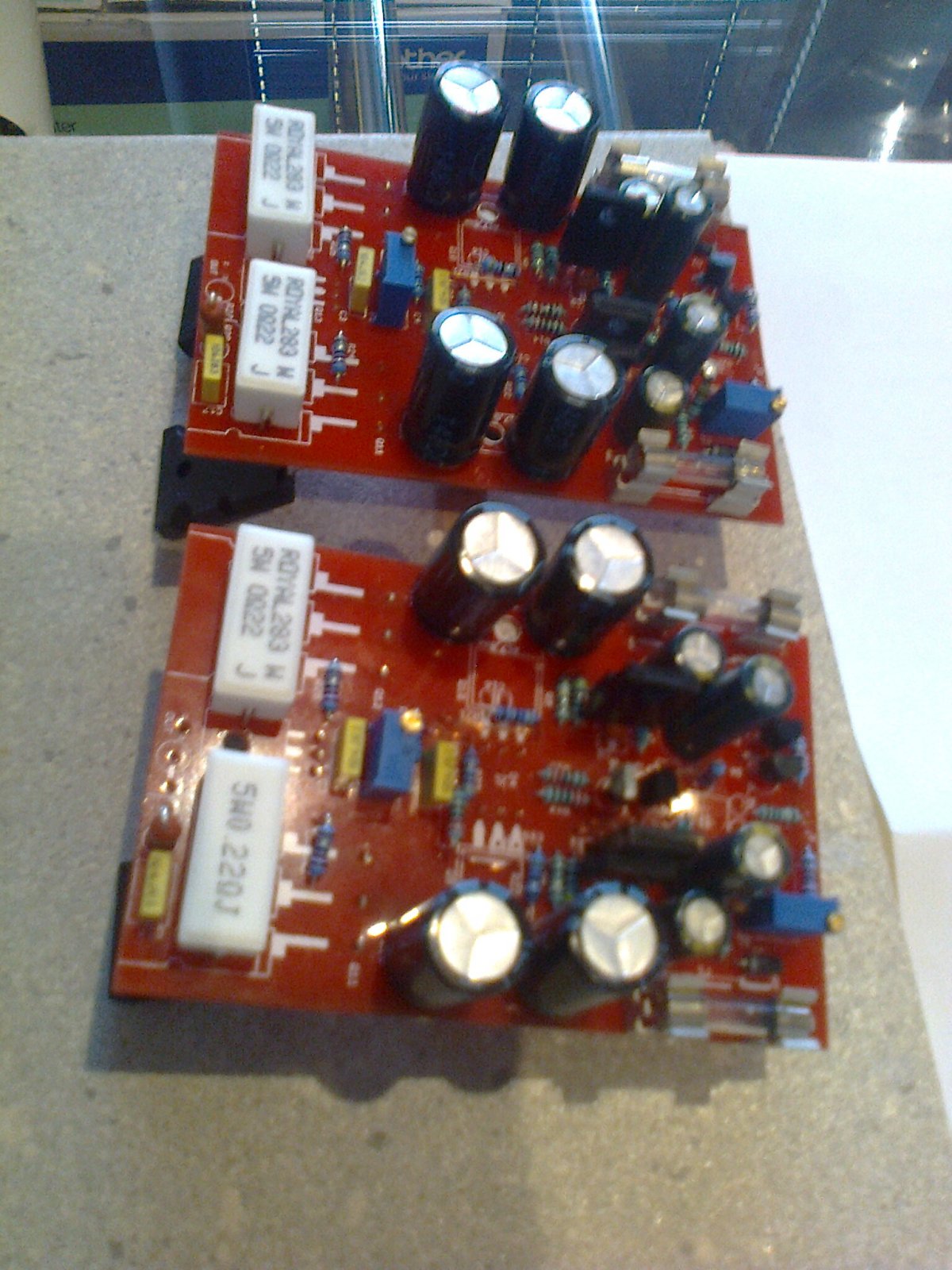

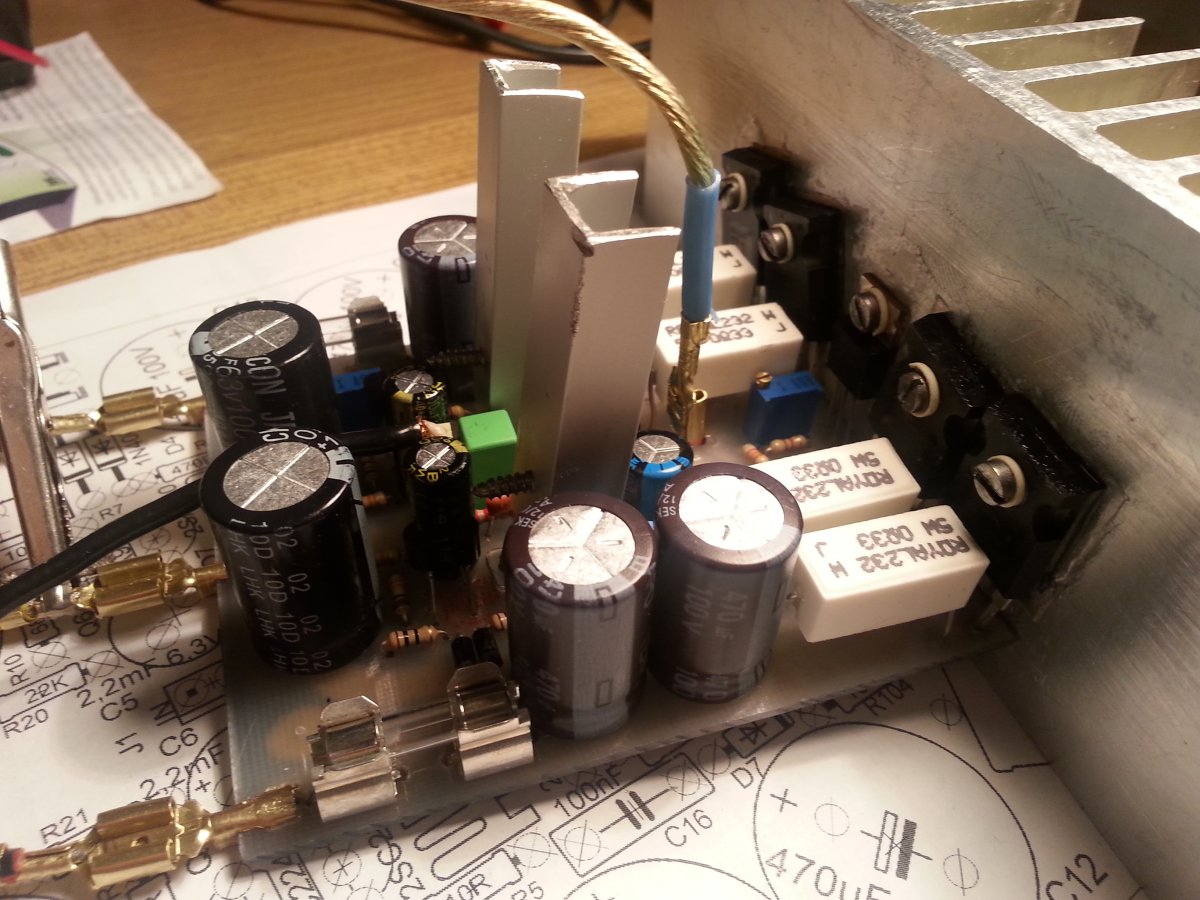

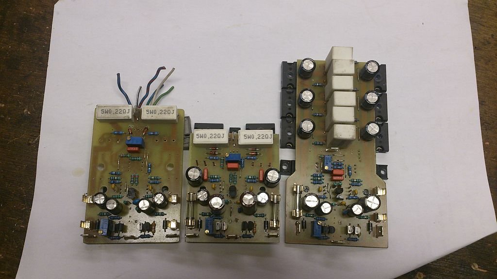

Hi all, it pass a bunch of time that parts are soldered on Versatil PCB (=BG1-MJL with new gnd layout for first stage and same caps profil as LC-VSSA (nichicon and 10uF MKT)).
Recently i bought 2u SMPS300RE and this week i decided to put all together. That i do and all i can say is that combo is amazing, really outstanding combo. It outpass all what i done up today....
Yet it's time to install it in decent housing...i bought some Hifi2000as i lake of time to custom one and i hat to see all these wire in air...
Marc

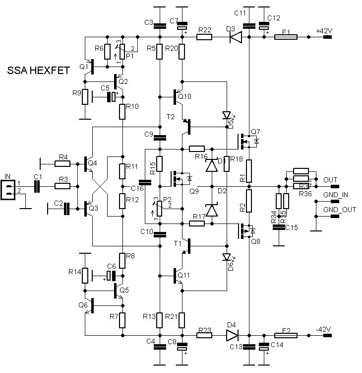

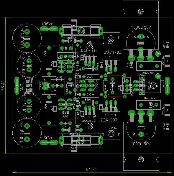

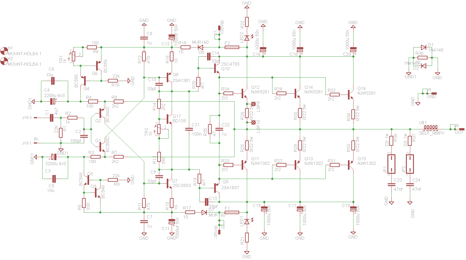

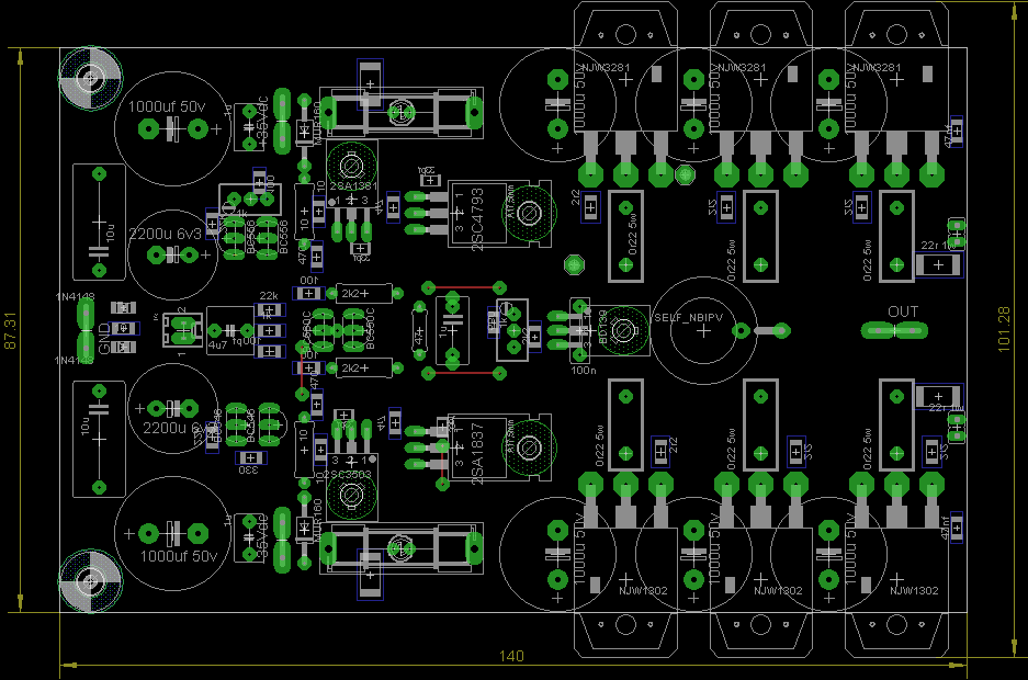

Hi Marc
To which sch (post nr.) this amp is related? Maybe I can look to propose some improvements, you never know hehe :magnify:
Congratulations on nice built, enjoy :cheers:
Hi Marc

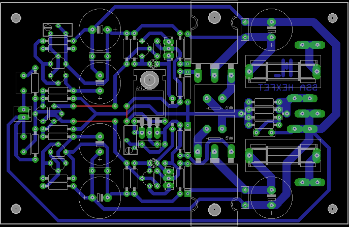

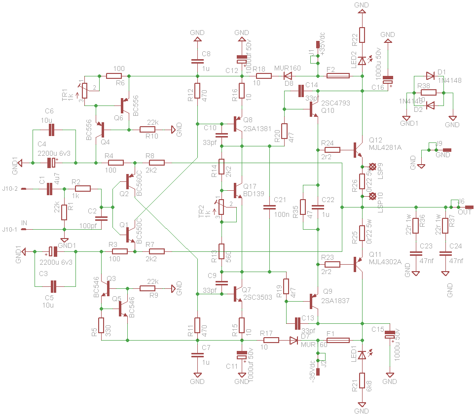

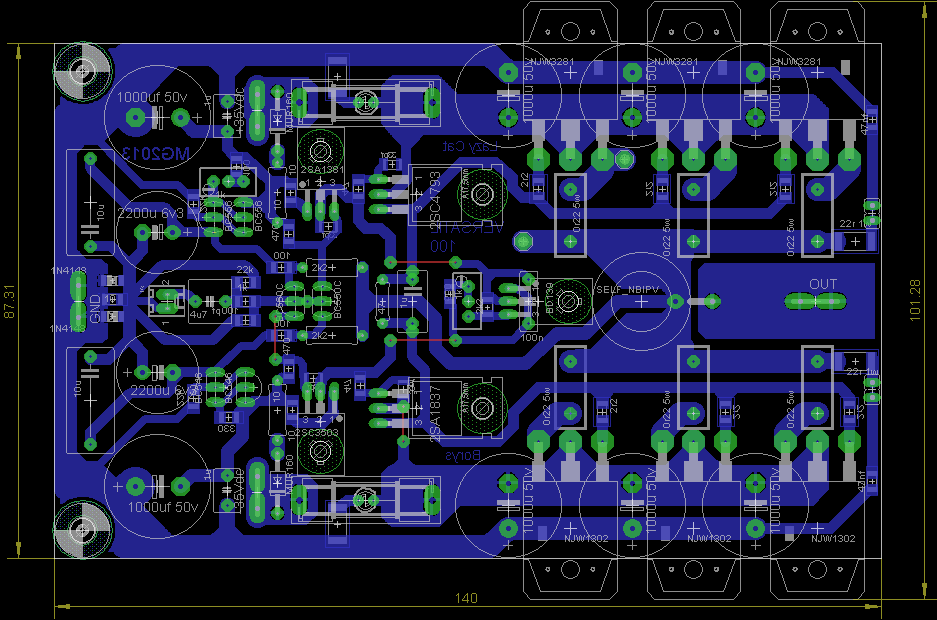

Hi LC
Here the version that'running with one smps300re pro chanel and next the 3 pair version (don't pay attention to rail voltage indication, caps voltage rating and BC type for input stage BC560/550c wil be swap to BC556/546C)
Marc

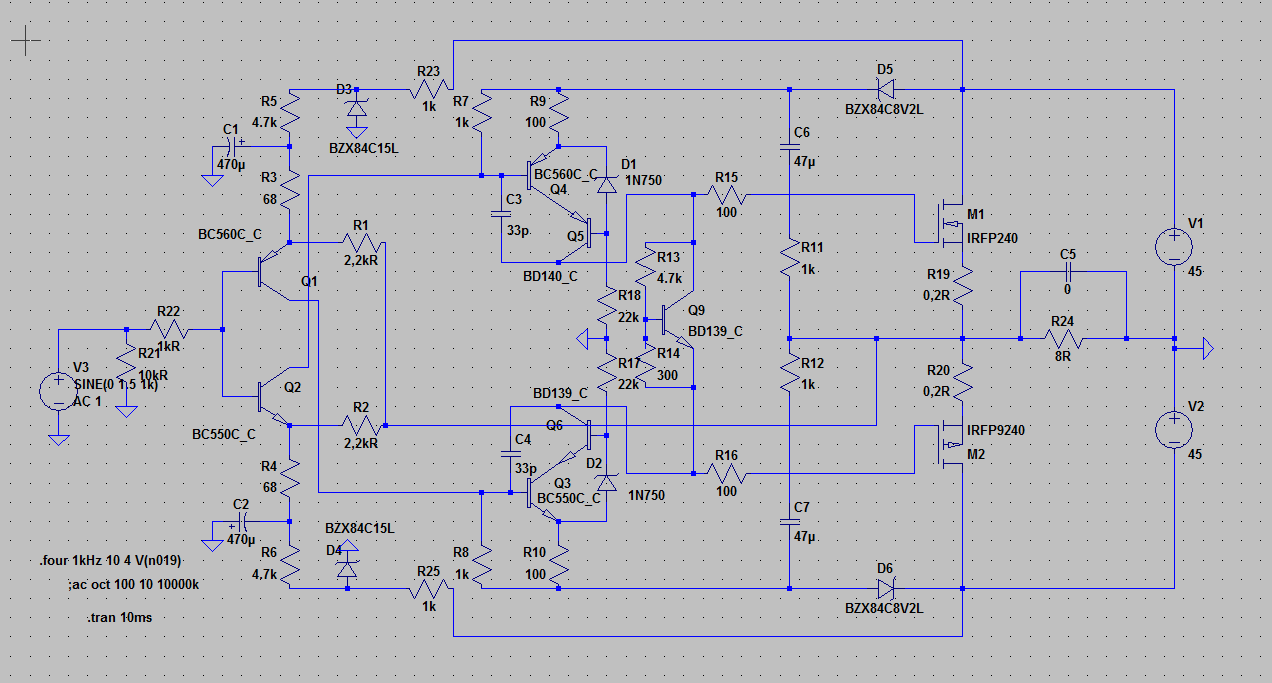

Idefixes
I have some idea If you are interested for tests. I will draw a schematic with cascoded vas, on the symulations there is visible improvement so maybe You can inplement 2 more transistors and few more components ?
The other amp I have tested with different o/p stages and got quicker basss response on that voltage stage.
Regards
Idefixes
Regards
For sure you propose...The improvement i'd like if it is possible is the tampco for VAS transistor as they are on main heatsink (TLVH431 like).
Bass response actually is quite impressive in density, speed and details...i can't see how it could significantly better...
Marc
nalimko33
Nice job. I have putted cascode too but it would be recommended to put set of the drivers just behind the cascode.
The cascode biassed from the emiters ''likes'' the ground reference so it would be prapobly better to use two diodes and two resistors with GND connection in the middle.
If you are going to use single biasing resistor for cascode --> use biasing from rail voltages.
Versatil 50 - PCB
Bonjour Marc!
J'ai actuellement un DX Super A qui fonctionne à merveille mais j'aimerai bien me lancer dans la construction de l'amplificateur décrit sur ce fil en version bjt. J'hésite encore entre votre version avec les Sanken et la version "Versatil 50" et je me demandais s'il vous était possible de diffuser votre .pdf du circuit imprimé pour cette version (Versatil 50).
Merci!
__________________________________
Hello Mark!
I currently have a DX Super A that works wonders but I would love to get into the construction of the amplifier described on this thread version bjt. I still hesitate between your version with Sanken and "Versatile 50" version and I was wondering if you could broadcast your pdf. Printed for this release (Versatile 50) circuit.
Thank you!
Bonjour Marc!
Merci!
Hello Mark!
Thank you!
Hi you could send me a email through forum to discus It. I think that if you have original thank you can try it, but my though is that MJL version is more reliable and soubd like a charm.
Marc
