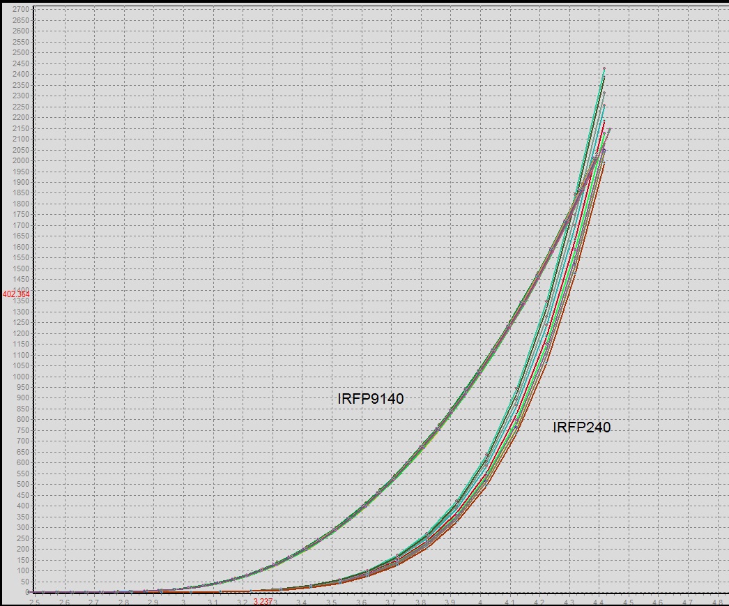

I recommend irfp240/9140 as a pair, just take a look at rdsON and rest of the parameters (input capactance etc), they look imho most similar.

Pleas take a look at input capactance too, there is no need to use different resistor for N and P channel in this case. I have tested this pair at very high speeds and everything looks very symetrical !! (pair 240/9240 in amplifier at very high speeds and capactive load doesnt do the job as good as 240/9140 pair, i did not read this on internet but tested it on the bench with scope).
I vote for 240/9140 as a best matching pair...
Are you sure?
It`s more like the other way around..
240/9140 is a better match for audio, provided the voltage rating of the latter is kept in mind.

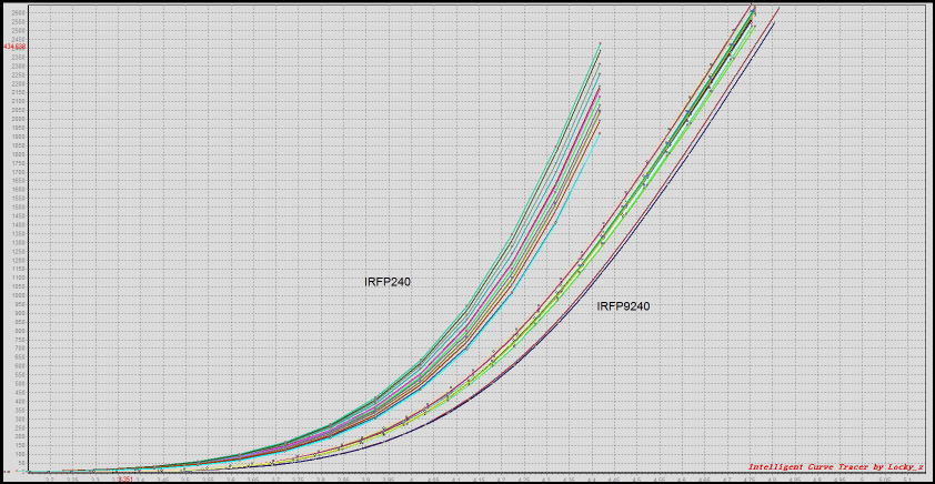

And graph for 9240/240 ?
Didiet
If you have a chance please check high speeds transients of the above transistor pairs. THD on pair irfp240/9140 is very good and amp behaves really good on square tests. I will test later on irfp240/9240 pair as suggested. (I remember I had some unsymetric scope measurements with those).
