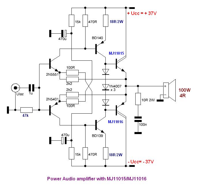

Acca's circuit is a class B amp. So the output stage is still in cut off mode. Adding a BD139 bias spreader will be required only if you want to run it in class AB mode. Then you will also have to deal with bias stability issues.
Acca's circuit is stripped down to a bare minimum and if that sounds good enough, then it's a great find. Has no adjustments and seems to be stable without additional components. This might be device specific I guess. So better use the circuit with parts as shown.
If you really want the bias spreader you could remove the diode string and put in the attached circuit.

Rreplacement with MJ11015/MJ11016?
You can change 27R to 18R in BD's emmiters
This will change VAS current from 7 to 11mA

Instead of Darlington transistors BDX33C/BDX34C be used MJ11015/MJ11016?
If you use them gave her some change in the schematics?

So the schematics with Darlington transistors mj11015/mj11016 should be like this:😉

Hello Acca,
What's the changes to the amplifier (output current, biase current?) in using 3 diodes and using 2? Can you calculate this?

Yes,my stage is biased in class B,so not current on output transistors.
You can use this MJ's
I tried to use two diodes.I don't hear any changes in sound.
In voltage feedback amp,this is very big difference.
No good enough,only good sound 😉
You can add miller caps under board,if unstable.
I don't add this because it's stable (I watch on 'scope)
Hello Acca,
Thanks,
WP
It's same.
Output bias is always zero.No current through output transistors.Maybe it can be calculated when use datasheet (Ube vs. Ic).I don't take care about it.Sound is good in both versions.I'll make another one amp today (with real heatsink,and tonight I'll post pictures).
