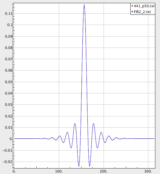

On the filter R&D front:
I've done the filter co-efficents using the v3 settings but sweeping phase for Minimum (p=0) through to Linear (p=50) in increments of 5. v1-3 are all done using p=30. I'll get around to making up filter files for these later today.
I had a quick play around with Octave's FIR2 routine and found I can get very similar but non-identical results to what SoX produces using b= to set kaiser-window beta.
I was about to post up batch of v3 filters when I had a listen to the -p0 version...
I had a suspicion that the minimum and intermediate phase weren't quite as sexy as the cheers leaders would have you believe. You only have to have a peek at the step response to see what is going to happen.
Changing phase doesn't remove ringing from the filter, it simply shifts it. And there-in lies the rub. If you move all the pre-ringing energy to after the impulse you double the amplitude of the post ringing, and that means the overshoot doubles too. Barf.
