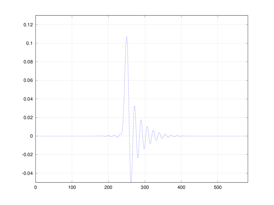

I was about to post up batch of v3 filters when I had a listen to the -p0 version...
I had a suspicion that the minimum and intermediate phase weren't quite as sexy as the cheers leaders would have you believe. You only have to have a peek at the step response to see what is going to happen.
Changing phase doesn't remove ringing from the filter, it simply shifts it. And there-in lies the rub. If you move all the pre-ringing energy to after the impulse you double the amplitude of the post ringing, and that means the overshoot doubles too. Barf.
This plot shows the step response of the filter coefficients.
attachment.php
Orange is p0 (-M) , green p30 , and blue p50 (-L).
-p30 sounds ok using volume control, -p0 was just plain awful.
It would be possible to drop the gain on these filter but the output is going to end up very low.
I've attached the folder of filters but be aware that anything less that p25-30 is likely to distort badly.

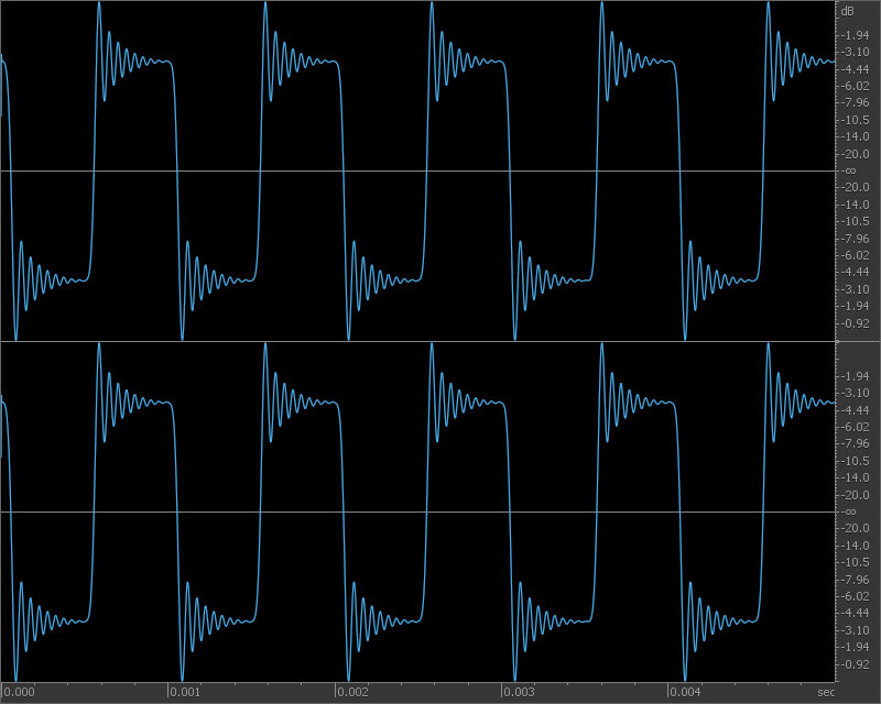

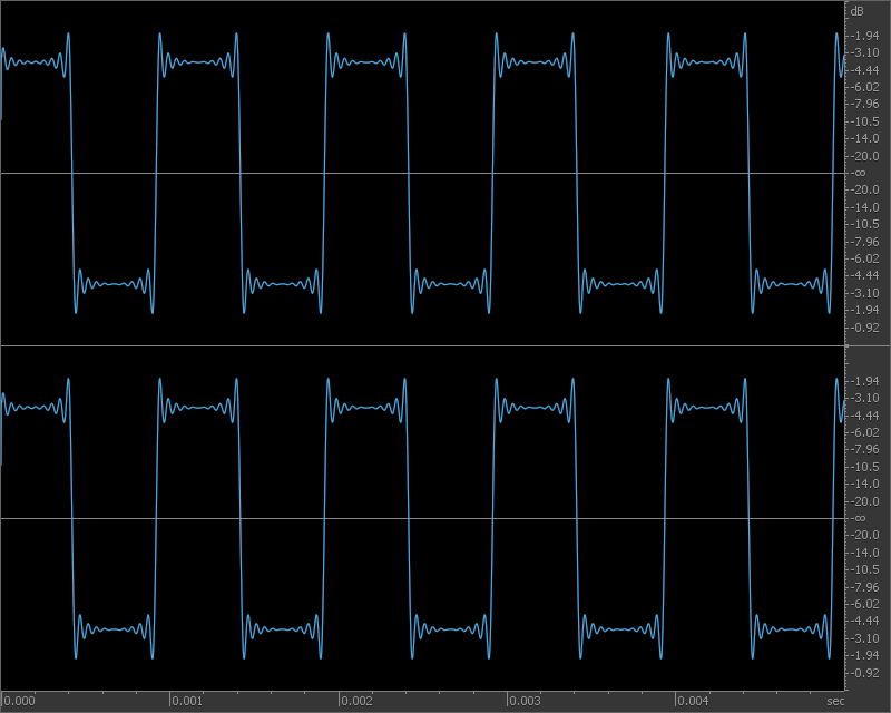

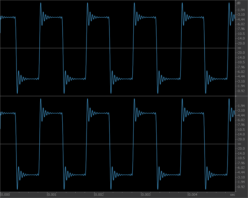

Don't know what was happening on my system then! With p0 trumpets sounded like someone playing a kazoo. Odd.
I think the intermediate and minimum filters potentially "hype" the signal due to the increased overshoot.
To check this I did a "worst case" test with the filters applied to a 1kHz square wave using SoX. Using p0 as a benchmark I found I had to set the gain to 5.75 to prevent clipped samples.
The rms level of all the output files was identical at -0.79dB, however there was significant difference in the peak level.
p0 = 0dB True Peak
p30 = -0.43dB True peak
p50 = -1.75dB True peak
I can't measure any significant difference "true peak" in up sampled audio, but there may be a perceivable difference when listening.
It's interesting that with square wave test the trailing edge is rounded off at p0, p30 has small amounts of ringing prior to the trailing edge that give a slightly "sharper" square.
cheers
Paul
