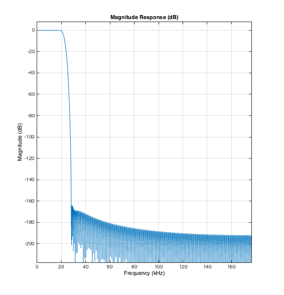

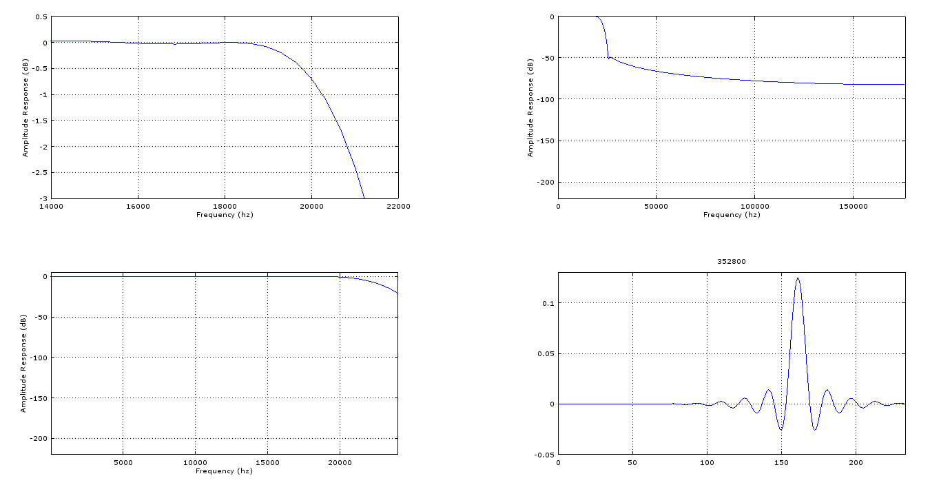

  • 1021filtN3.skr.zip
    1021filtN3.skr.zip
  • 1021filtN3.txt
    1021filtN3.txt

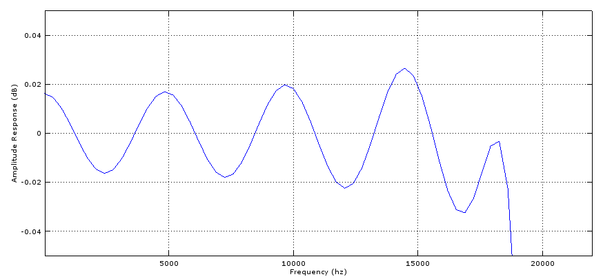

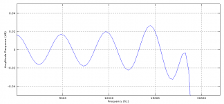

Nice find TNT. He do some explanation on that site in a way that made a dumb nob like me get one tiny step further into understanding. And I will find use of his Op-Amp filter app in a boom box project I have slowly evolving.
On the other hand Paul’s latest filter once again slam me to the floor telling me I’m not just a dumb nob, but plain stupid.
I try to plot all the filter posted just to see if I learn something from the plots and exercise doing them.
Code:
Header from text file
dam1021,44100,8,1,233,8
Text file has 323 coefficients where every 8. value is zero. I thought zero was a valid coefficient value? Anyway as a test I removed all lines with zero. Now I have 283 coefficients.
These plots confirm zero as a valid coefficient value. But then I’m not sure I understand number of coefficients in Paul’s header in the text file?

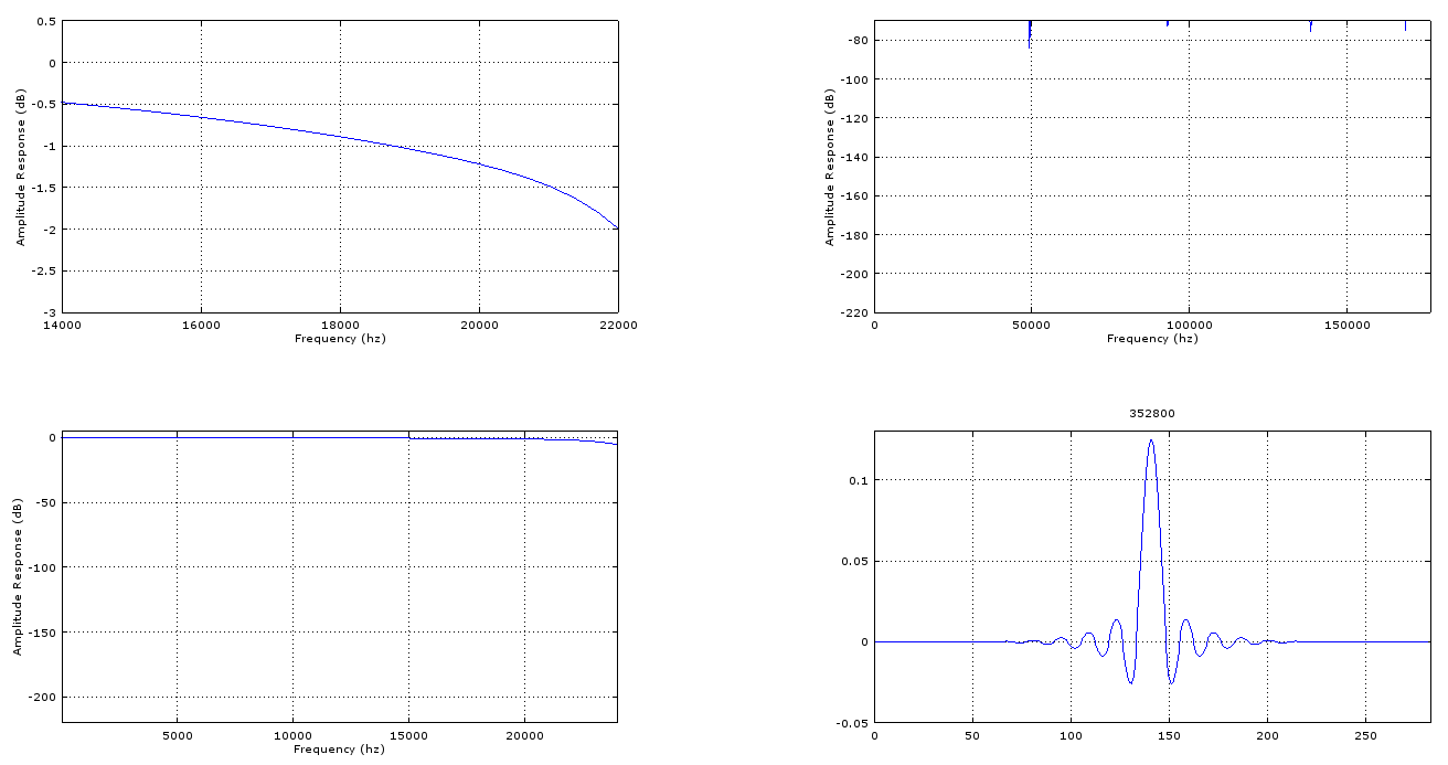

He enters the vallues in the header manualy and fliped the digits, the correct header is
Code:
dam1021,44100,8,1,323,8
See the 48kHz variant where it is correct.

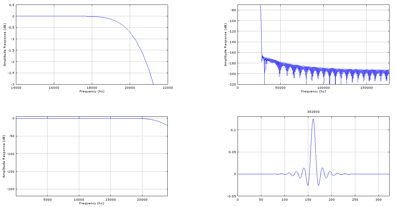

You're probably correct. If we assume this is just Paul keeping us on the alert. And we assume mkrom use the first 233 coefficients the result are in some way interesting.
Someone with the skills to do text parsing with SoX (no not Simple Outline XML) should come to rescue.
In a perfect world we would then feed SoX a script parsing dam1021.txt and create plots for all the filters inside. Not only for visualizing, but to also do a sanity check on the file as mkrom does not implement any failsafe.
I believe it will prove to be very useful when we later on get options to select between 4 filters for each fs and more people start posting their favorite combination files.

Nope, I can be a bit numerically dyslexic at times.
I only listened to 44.1 for a short period and thought it sounded a bit odd 😉 Spent most of the evening listening to 48kHz which sounded pretty nice, and prompted the post, and the odd ball comment...
BTW the key feature of the Nyquist filters is the zero's. Rather than having vanishingly small 0.01-E-09 the coefficients are placed directly on zero axis. They are an integral part of the filter so leave them there.
BBTW I got sick of the missing filter functions in Octave and in a moment of weakness bought a "home" license for MATLAB plus Filter toolbox and DSP toolbox...

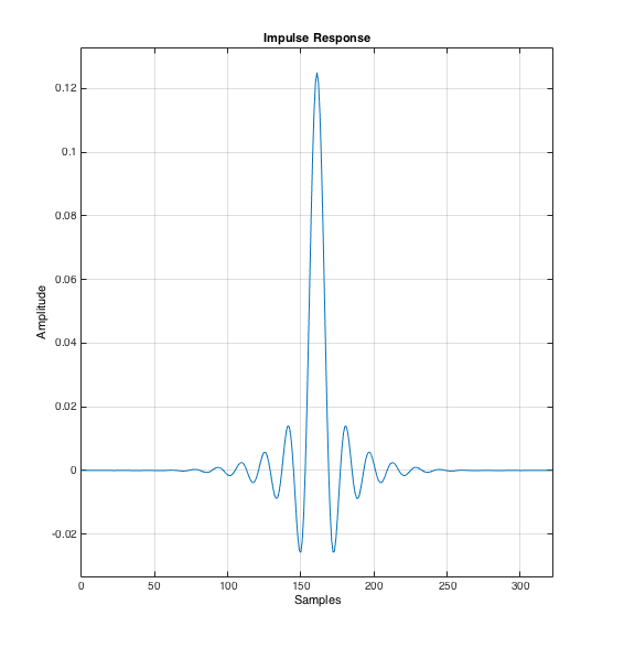

Corrected N3 filter attached.

That the main coefficient is (scaled) =1 is only the minor part of "retains all original samples".
The main thing is that all coefficients that are a 8,16,24,...- steps away from the center are zero. That guarantees that the 8-times upsampled signal convoluted with that filter contains at every 8-th position just the original sample.
Moreover this, "every 8-th coefficient is zero" (but one which is 1) is the only way to "retains all original samples" (with a 8-times upsampled signal).
If "that one nonzero" coefficient is not 1 you have the original samples in every 8-th position ... with some gain.
