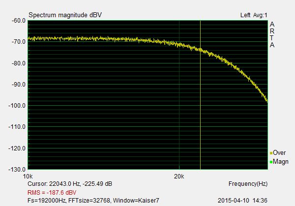

I did a quick test on the DAM response today using white noise into the Konnect 8.
The response was a flat line right though the audio band to 20kHz with the NQv3UG version. There were no apparent peaks, bumps or roll off to account for the lack of high end reported in some quarters.
I've done a test with a version of the 44.1 filter quantized in the Matlab filter designer (those guys must love me, another module required for that, and another $50. bah!! We only work so we can fund our hobbies, right?)
It gives a very slightly different shape to the noise floor at the DAC outputs and minor (as in possibly 1-2dB) difference in some harmonics and peaks. Hard to spot however. I suspect there isn't too much to be gained, but there seems to be something about the MATLAB quantised filters....
Sorry about the naming btw. NQ = nyquist UG = unity gain, qnt = quantised.

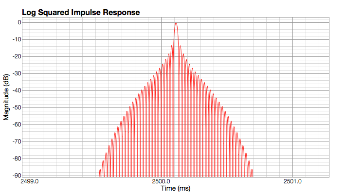

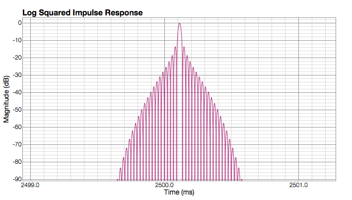

Add: Basically the impulse response we've been looking at is telling you SFA about the filter, except in the broadest brush strokes. In other words, nice for marketing brochures or Hifi magazines but not especially informative.
The Pflaumer patent has turned out to be pure gold, even if though I have zero interest in replicating his filters designs. Thanks vuki!!!
So, the Nyquist filters have had a reprieve.
I should now be able to tune these filters based on the information mentioned above.
For a starter, this version should have a bit more HF emphasis than the CRaPMagic filter (as a point of reference) but I can tune up or down as needed.
log squared impulse response for the last Nyquist filter (purple) and current version (red) attached for reference.

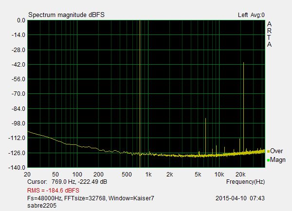

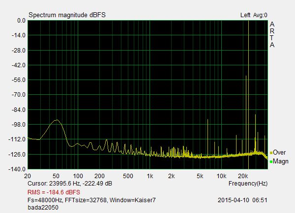

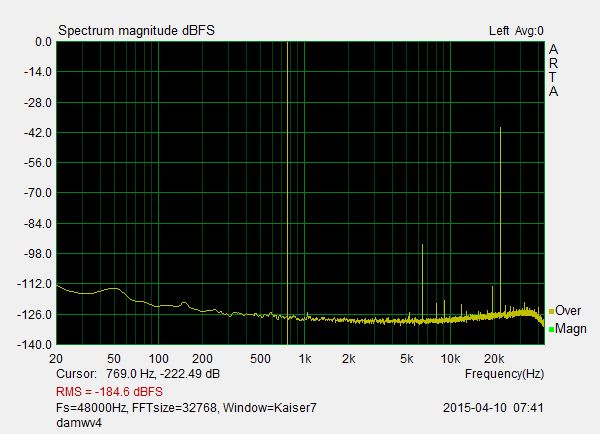

Mesurements of 22050 sinus:Bada, dam with sharp IP filter, dam with IPv4P30, Sabre 9018 with slow filter. Output level was same on all dacs (measured at 1khz and white noise). Sabre dac was measured with 192khz input sampling rate vs 96khz for the rest. Sondcard was terratec DMX6Fire USB.

So vuki, you have 8 khz spikes from both your quite different DACs. That would rather point to a measurement artefact or common external interferer to me.
PS Whats "Bada"?
Yes, 6,5+8+9khz spikes are probably measurement artefacts or interference. But the point was to show 22050hz signal level, which in Berkeley Audio Design Alpha (bada) dac isn't as low as suggested by the Pflaumer's patent.

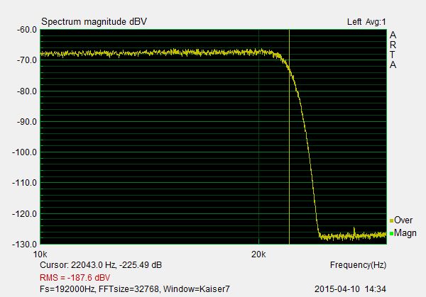

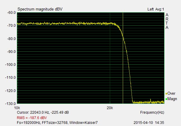

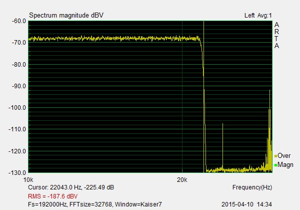

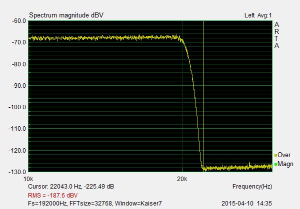

A good way to pick up filter curve is with two equal amplitude tones at 19kHz and 21kHz, or 20 and 22kHz. Any difference in level at the output is due to filter roll off.
The other way is to use gaussian white noise as an input - it has a flat distribution and if you do FFT on the DAC output you'll see the filter curve.
Thank you!
Bada, Dam1021filtNQtb65, Dam sharp IP filter, Sabre sharp, Sabre slow
