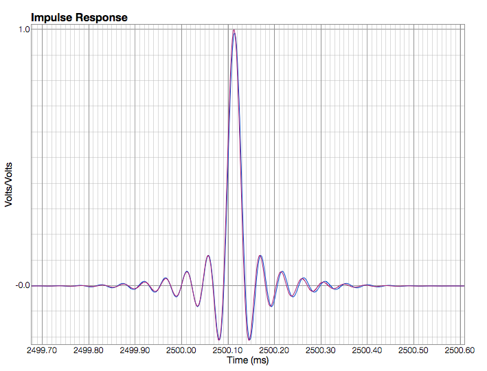

As example, I've overlaid two impulse response - purple shows the "hf rolled off Nyquist filter" blue the CRaPMagic (which a few people seem to like).
What does that tell you? The purple trace is slightly shorter and has marginally less ringing, so should we assume this sounds "better"? In some regards it does but it's pretty compromised in tonal balance to my ears.

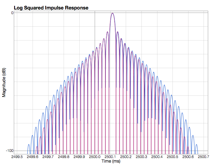

So what happens if we look at the two as a Log squared Impulse Response...
We can immediately see that the CRapMagic has slightly more "time smear" at lower amplitudes. It's not much - I'd guess something like 0.1ms difference at -100dB - but it is enough to alter the tonal balance and the perception of the amount of "detail" in the recording.

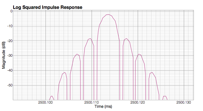

I was doing Fuzzmeasure measures from 0 to -50 dB of LSIR, and filters I liked were those that accumulate energy in less milliseconds above those -50 dB.
I put these measures in the last two PDF.
All shorter filters comply this, like NOS filter.
But there can be long filters if are designed to concentrate power than -50 db in less milliseconds.The filter 1021filtNqF2.skr measure very well, and sounds great. It was a very good impulse response in dB, superior to the rest of filters impulse except NOS and sound very nice, no strident, no disturb.
And if they are short sloping upward than downward, above -50 dB, is better, like IP or apodizing filters.
