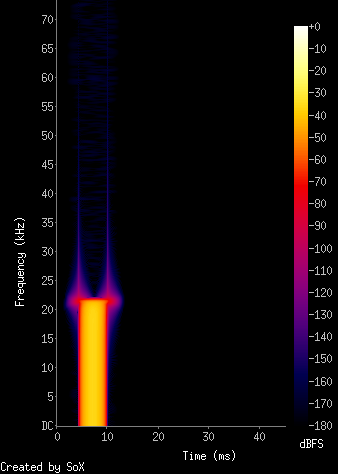

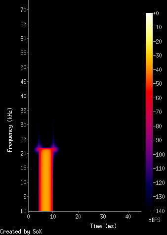

Some thoughts on IR spectrograms and time smear detection.
I think they should be done with a broader perspective: FR up to 100k and at least 120-140dB of dynamic range.
85dB is insufficient - too flattering, we can't really see the ringing.
The analyzer software do some averaging, so the real amplitudes are at least 30db higher.
140dB is more revealing, "log squared" 🙂
Examples below (done with SoX).
IR of an IP filter, upscaling from 44k to 352k, 85dB:
Nice! No ringing 😀
If we dig a little deeper...
With 140dB we start to see something.
Finally, full scale DR:
Now we see everything, even the dither @ -140dB. The ringing starts from around 17kHz and should be inaudible.

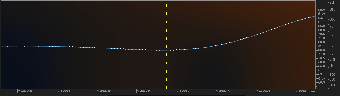

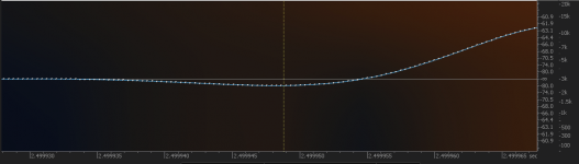

The spectrogram is done with Isotope RX which uses Auto adjusting Short-time Fourier Transform, and the window is a Kaiser beta = 20.
Remember that I am analysing the single sample after if has been up sampled using FIR1 and FIR2. There are well over 1000 samples within the length of the sample, not just one...
Attached is a screen shot of the very start of the ringing of an impulse showing the sample points. Obviously there a few more than one.

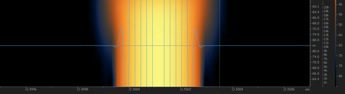

The highest level of the main body in the spectrogram is actually -12dB, so -30dB is a bit wayward.
But all that rather misses the point. I'm treating the spectrogram as a potentially useful schematic for visualising the effect of the filter settings, not as some absolutely accurate measure of impulse behaviour.
The relationship is a bit easier to see with the impulse waveform zoomed so -85dB (approx) is the minimum on the amplitude axis. The edges of the main "body" match the start and end of ringing.
attachment.php

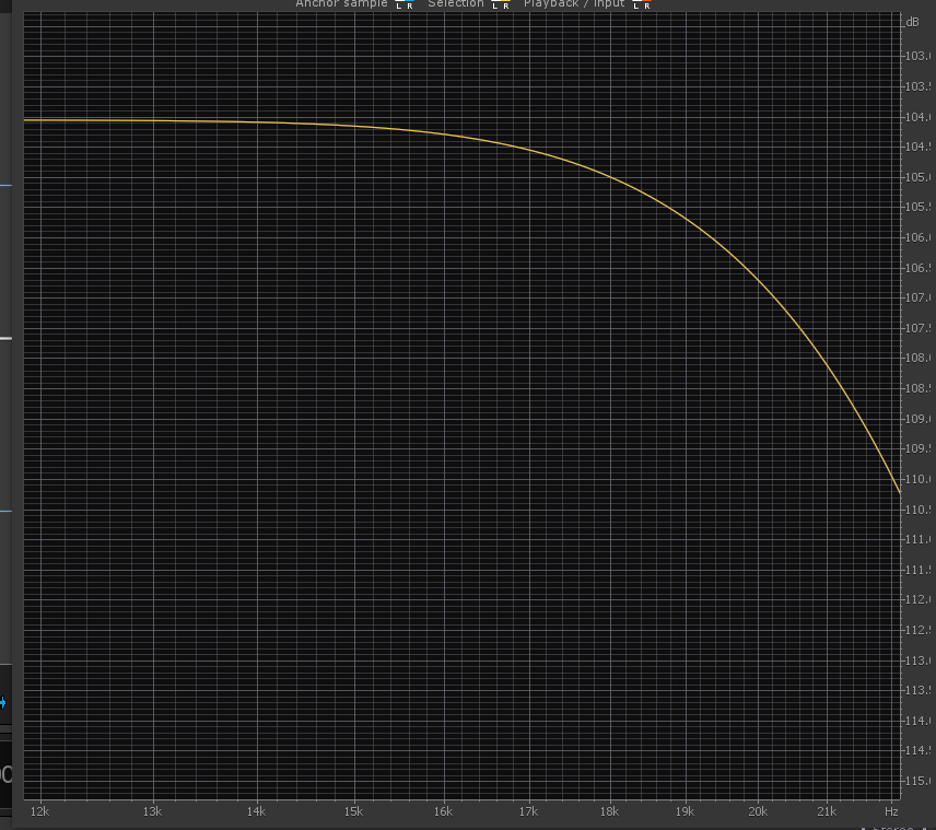

For what it is worth the onset of "spread"/"smear" is related to the start of roll-off in the filter. The filter has very low levels of roll-off at 13kHz and the "body" spread begin around this point.
attachment.php

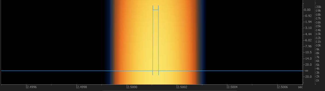

A question for you and zfe...
If this is just frequency related artefacts from the window function, why is the spectrogram of the NOS filter clear of any "smear", and only shows the main body with sinc roll-off causing a narrowing of width?
attachment.php

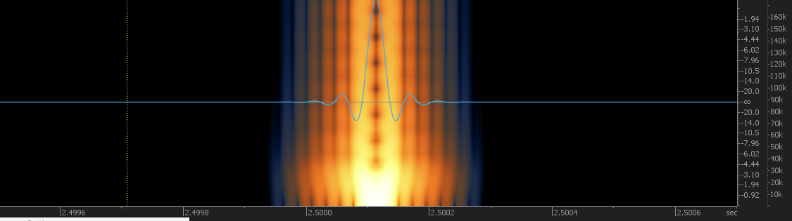

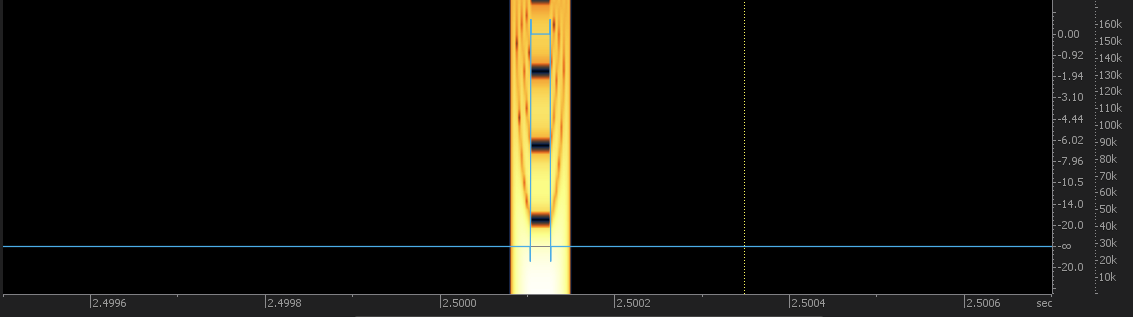

Impulse .wav attached.
1. The blue line is the impulse waveform as plotted by RX. The spectrogram is at the same zoom level and position.
2. FIR1+FIR2
3. ok had a second to do... after all.
C128 and NOS with rectangle window and 176.4kHz, but a bit like walking back 25m and saying "It's OK, I can't see your wrinkles in the photo now..."
  • NOSb.wav.zip
    NOSb.wav.zip
