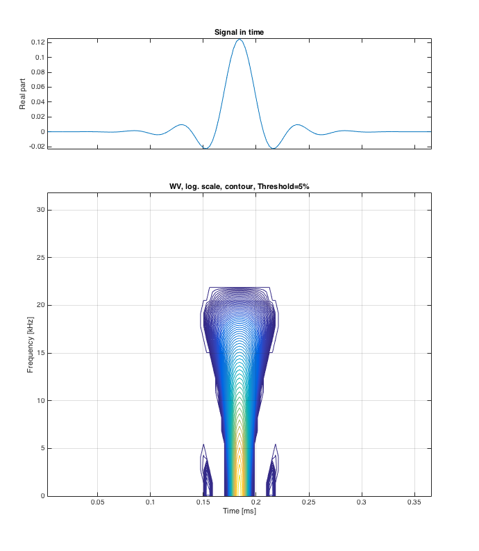

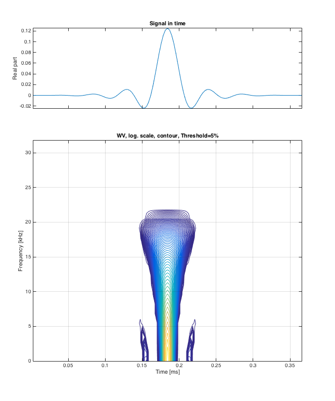

I've been trying to find a way to visualise the impulse in the time-frequency domain as I'm convinced this is more informative than time domain or frequency domains. There is a paper on the dirac site which indicates that only time-frequency domain adequately represents perceived frequency response.
This is a Wigner-Ville contour plot done with the time-frequency toolbox for Octave/Matlab from TFTB -- Time-Frequency toolbox
This a plot of the C128_100 impulse. It seems to show similar information the STFT plots, but less cluttered. There is a mesh plot that can be done which show the impulse in 3 dimensions but it doesn't translate well to a static image.
