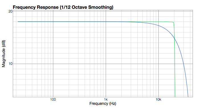

The NOS filters are also 3.5dB louder than most of the other filters I've put together. If you don't factor that in there is a good chance you are just being swayed by the added loudness.
NOS is also pretty rolled off even at 3kHz which is why I think it's attractive to a lot of people.
Blue = New NOS, Green = DarkMPBW.
